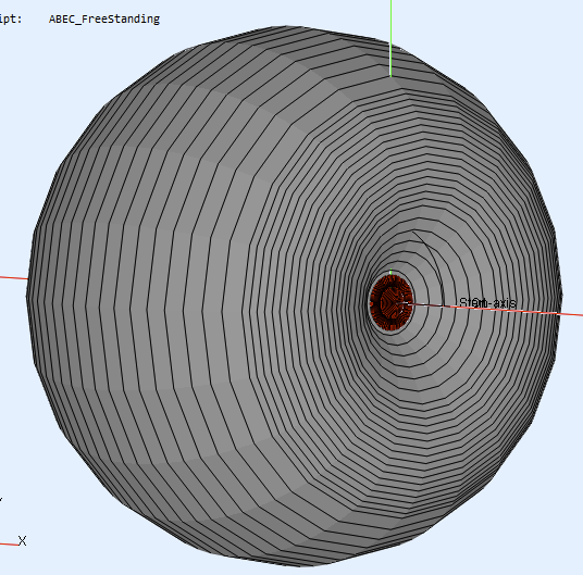

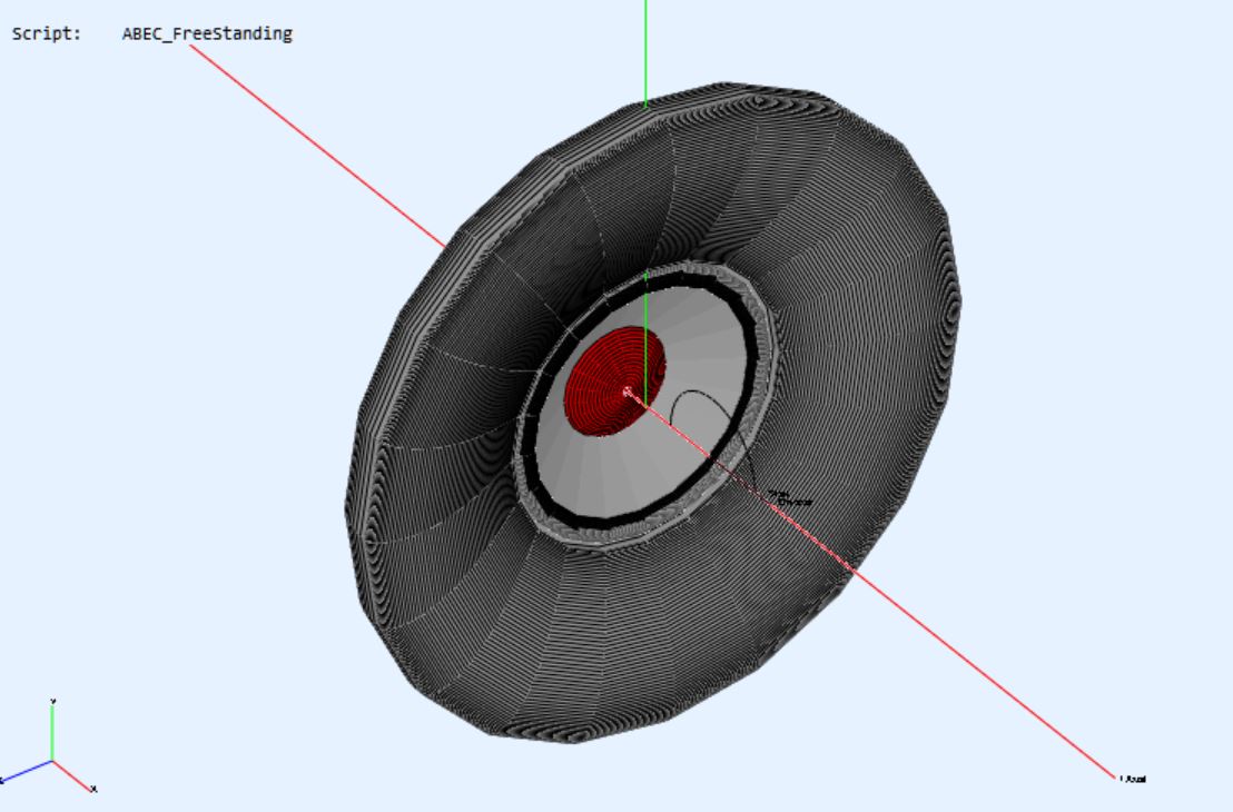

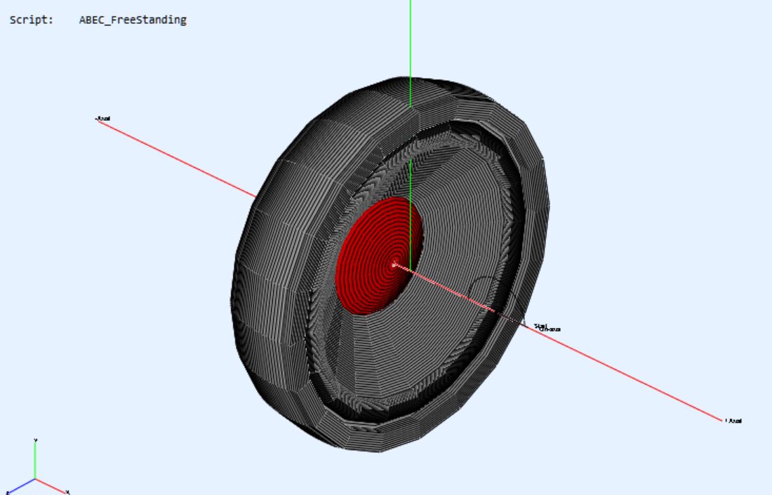

It seems I got axisymmetry to work though with the whole thing user-defined, and meshing problems I had are gone. The enclosure in ABEC however looks pretty rough to me and there doesn't seem to be a way to control the resolution. Not sure if that's screwing up the results or if I'm missing something else...
The mesh frequency parameter is what controls much of the resolution in CircSym,
ABEC.MeshFrequency = 40000, it can be set higher without too much time penalty. It is only solving in one axis so the way it shows as segmented around the axis doesn't matter.
Mesh.LengthSegments will change how smooth the curve is represented by the points which can matter too
Your driven element looks very strange, I would start there to see what is going on.
Reactions: 1 user
Problem is, I also have the waveguide user-defined. I can match a small R-OSSE and a Bezier to the coaxial profile but it's kinda burdensome and I keep failing to make the Bezier work from the Desmos script anyway...

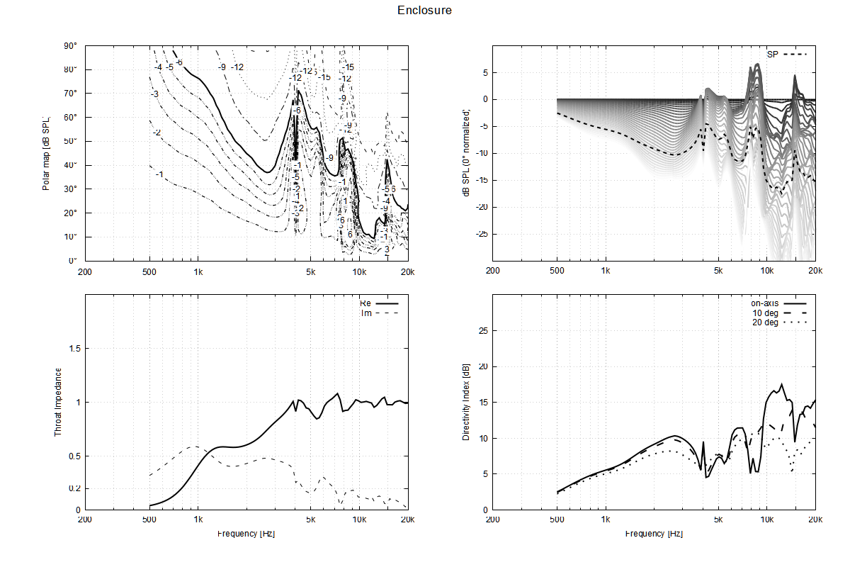

View attachment 1217600 View attachment 1217599
Your results are weird because the interface is in the wrong place, likely it's set at a point that's closer than where the baffle actually is
Reactions: 1 user
So it looks like Mesh.LengthSegments is what matters in CircSym.
It's set to 1 since I'm only simulating the source without a waveguide. Changing the last numbers defining the points seems to have a minimal effect
Yeah I don't mean the look around the axis, but the radial steps (which aren't super bad but could be better for sure).
I can't change LengthSegments simulating only the source. I also tried simulating the coaxial cone instead of the tweeter (Velocity set to 2) but the results are pretty much the same so I guess I'm doing something fundamentally wrong.
There's no interface defined as it's not required in a freestanding sim. I tried adding it but it made no difference.

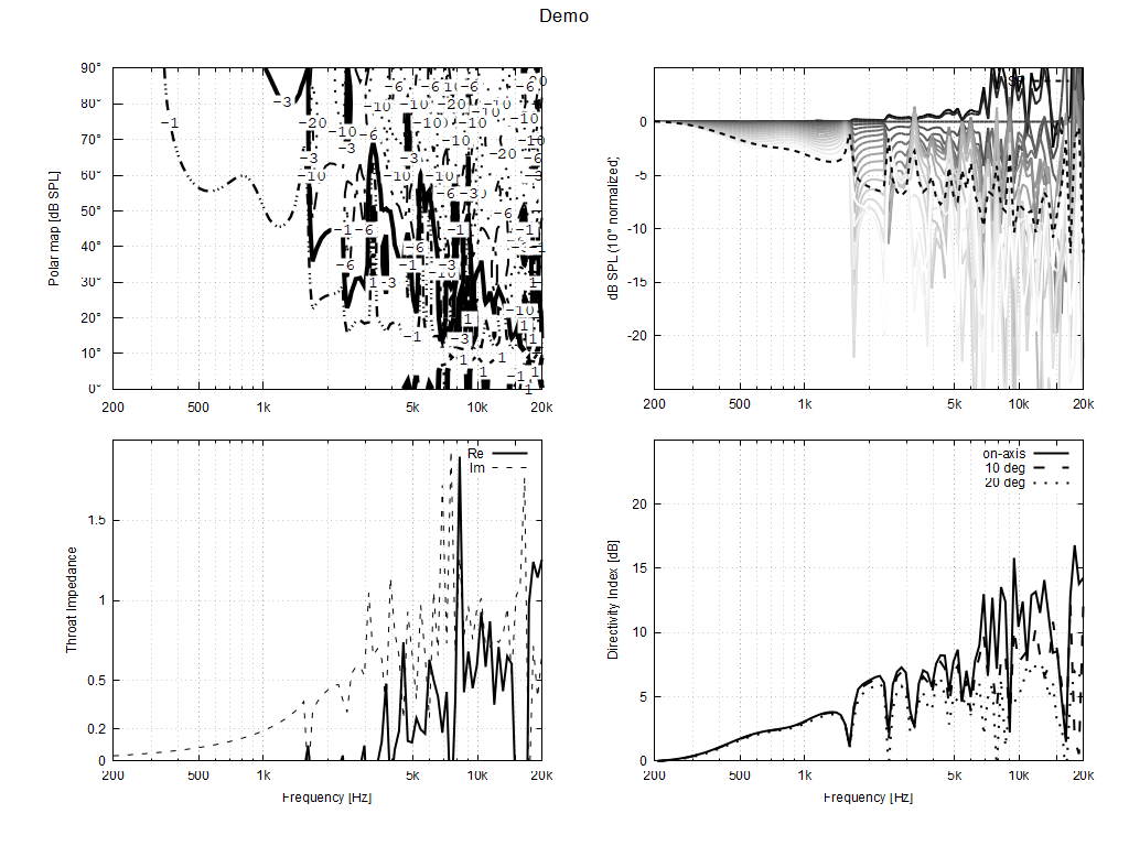

Here's a slightly simplified example giving similar results
Code:
Length = 0            ; [mm]
Source.Contours = {
    point   p1  4     0    0.5
    point   p2  0     12   0.5
    point   p3  -1.26 50.5 0.5
    point   p4  -97.1 0    0.5
    cpoint  c1  -16 0
    cpoint  c2  -14.8  30.8
    cpoint  c3  -35.9  0
    arc   p1 c1 p2  1.0       ;tweeter
    arc   p2 c2 p3  0         ;woofer cone
    arc   p3 c3 p4  0         ;enclosure
Mesh.LengthSegments  = 1
Mesh.SubdomainSlices =
ABEC.SimType         = 2
ABEC.SimProfile      = 0
ABEC.f1              = 200    ; [Hz]
ABEC.f2              = 20000    ; [Hz]
ABEC.NumFrequencies  = 100
ABEC.MeshFrequency   = 40000    ; [Hz]
ABEC.Polars:SPL = {
  MapAngleRange = 0,180,37
  NormAngle = 10    ; [deg]
  Distance = 3      ; [m]
Report = {
Title = "Demo"
NormAngle = 10
Width = 1024
Height = 768
Output.ABECProject = 1

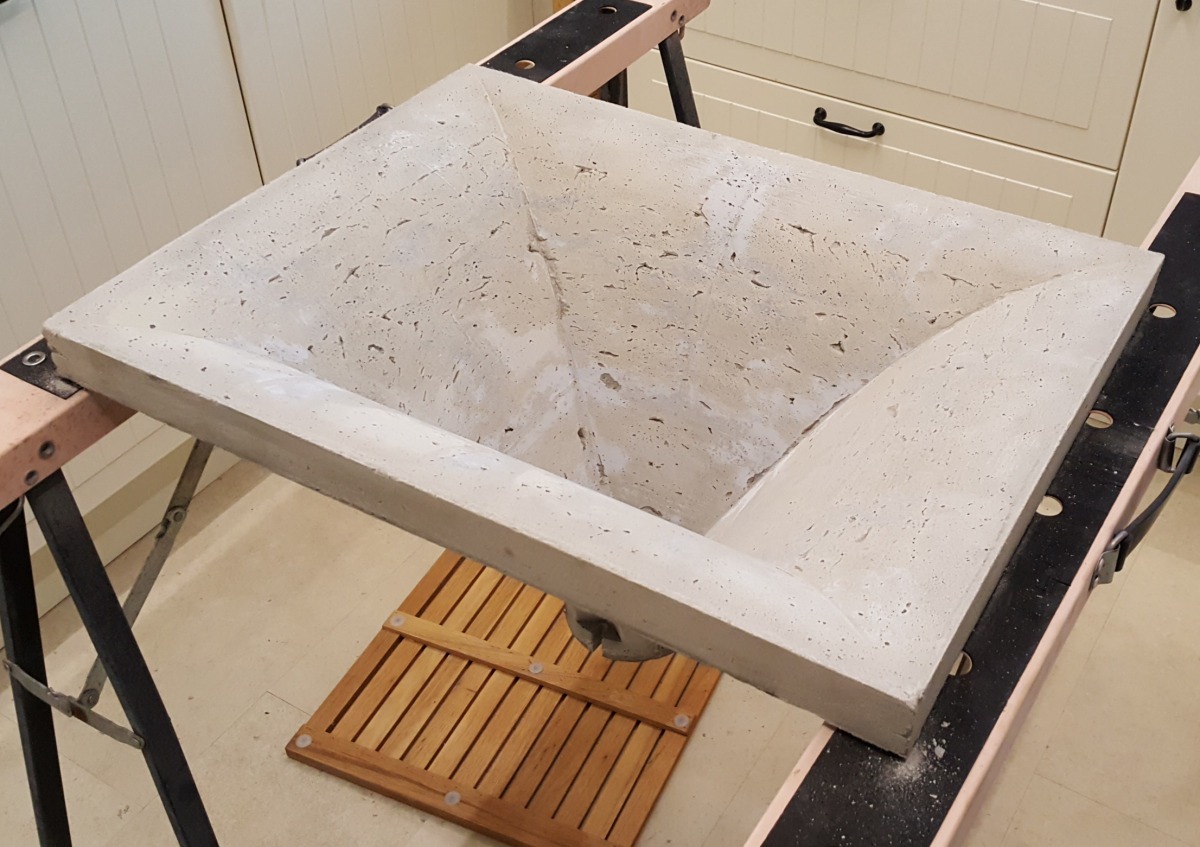

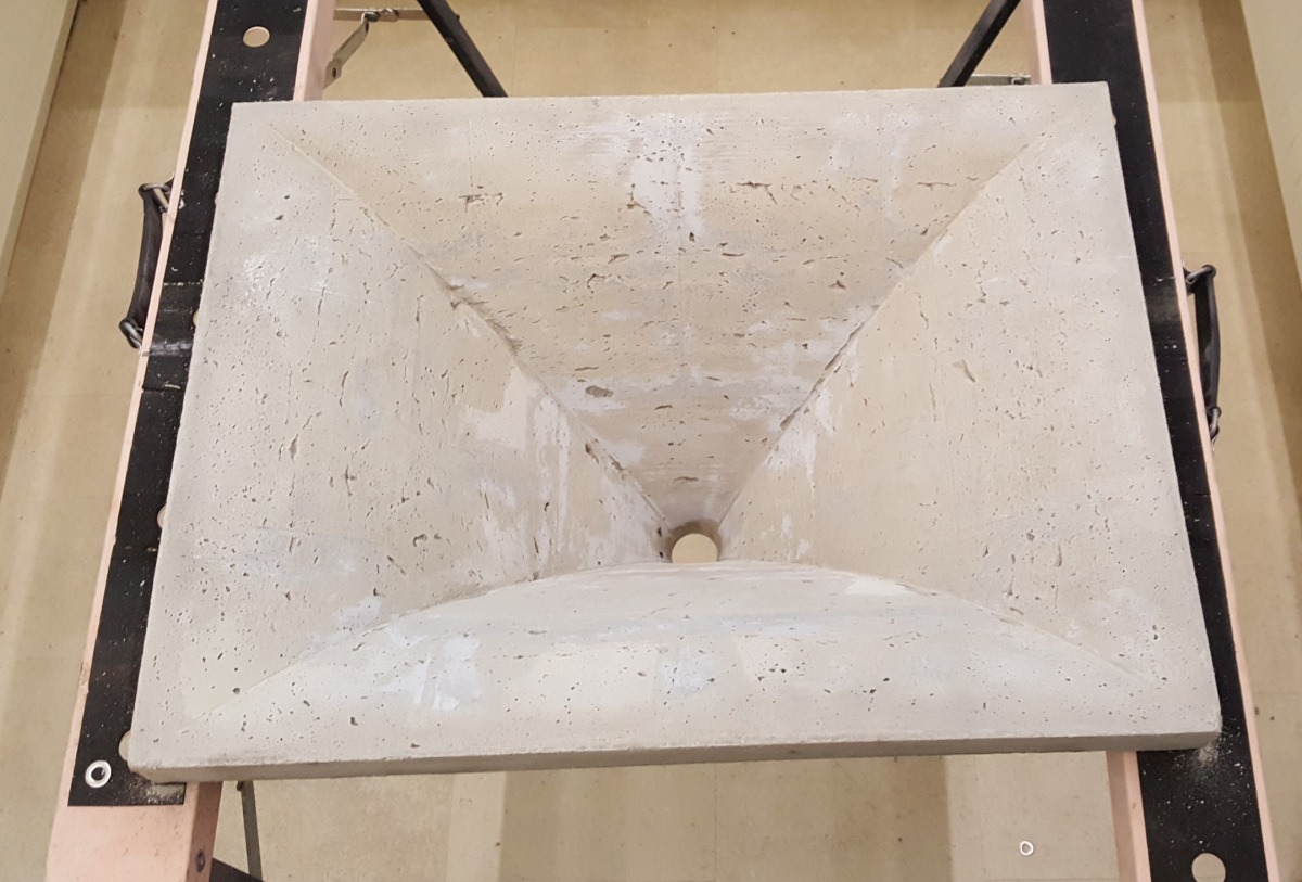

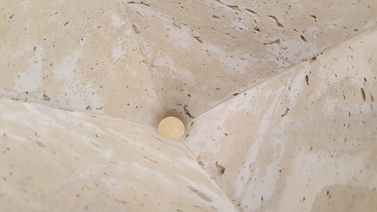

The concrete horn, right after demolding -
I never pass up a chance to post Zoolander memes even though the horn isn't finished yet. Excited to see another concrete horn in the thread. Looking forward to learning best practice with concrete + forms and molds from everyone who makes them. In addition, this shape as well as the ATHex allows additional materials. Also especially curious to see how concrete and other materials affect measurements because I'm currently struggling with measurements on a single enclosure I want to match with two different R-OSSEs. Earl Geddes mentioned how the horn material/construction can cause sound artifacts but I won't understand it until I see a practical example.
