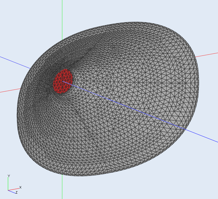

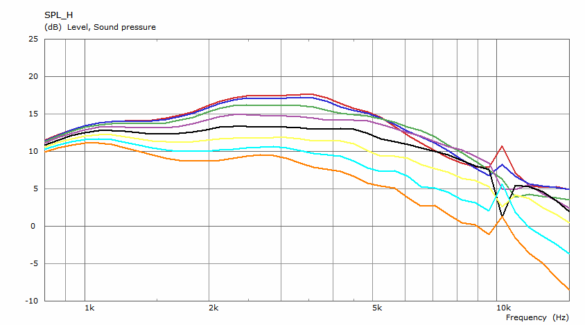

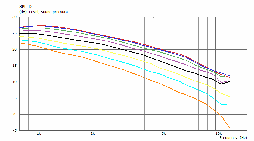

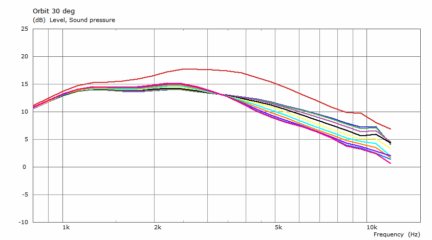

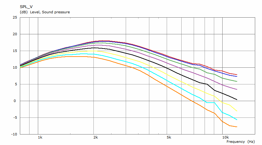

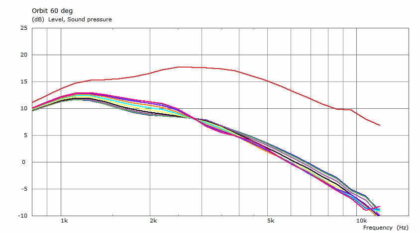

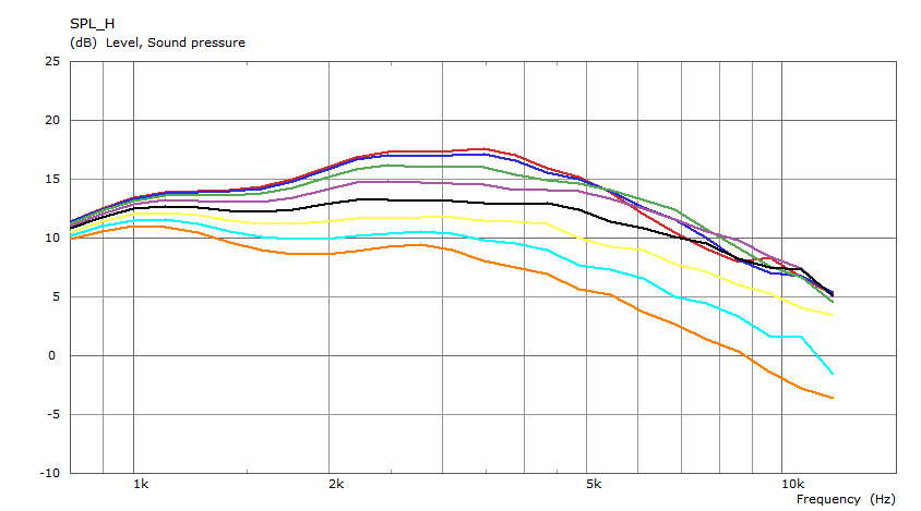

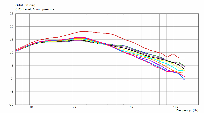

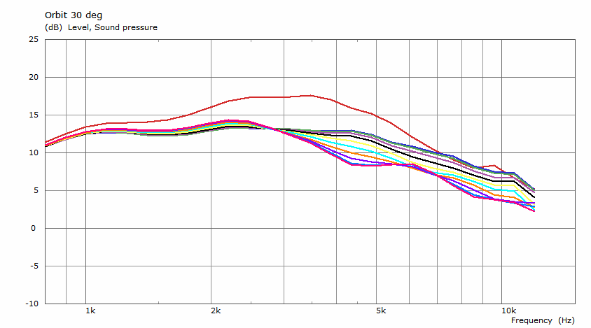

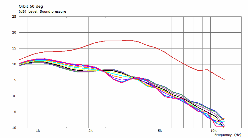

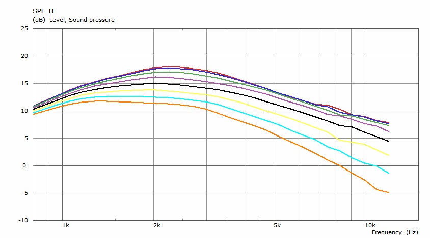

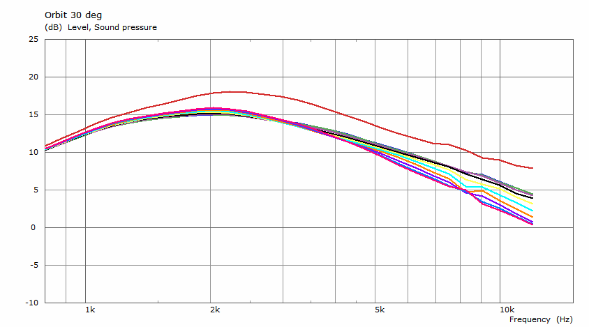

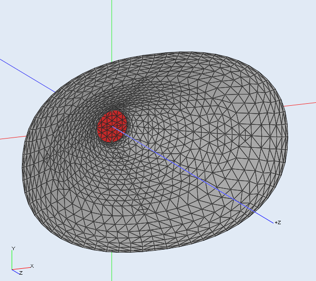

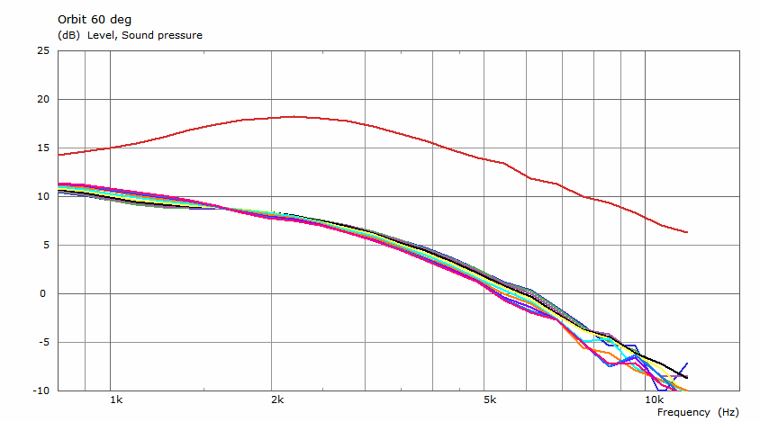

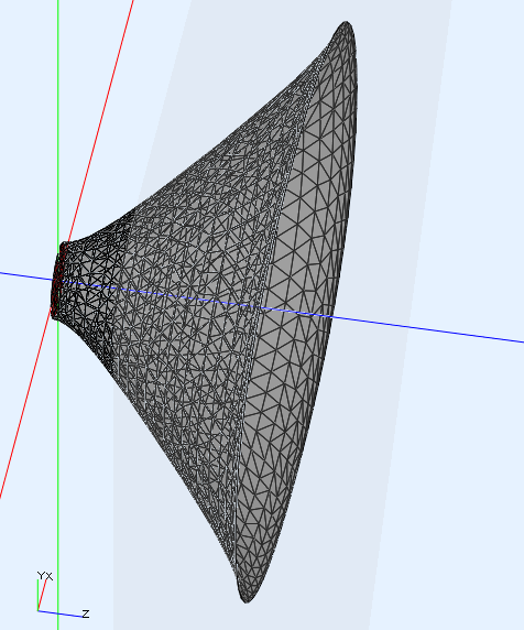

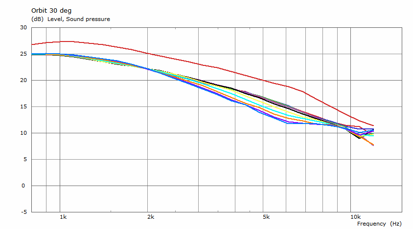

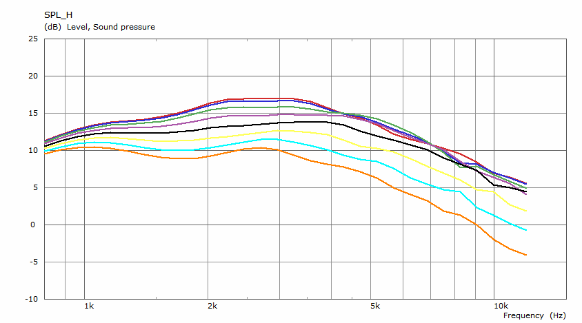

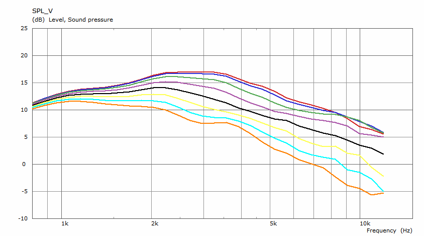

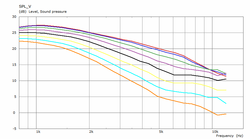

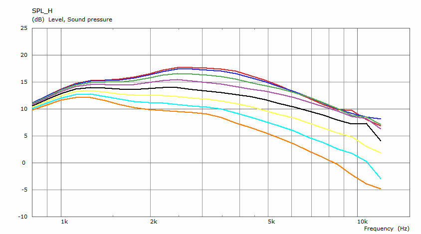

To get more perspective, this is for a small elliptical waveguide (8.5" x 6") -
And as a reminder of what influence a good termination has -
(BTW, this will be a good demo project - calculates in less then a minute.)

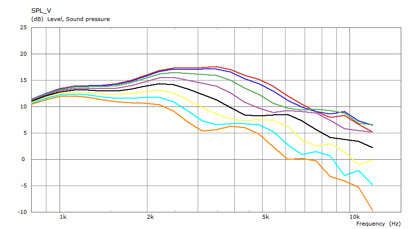

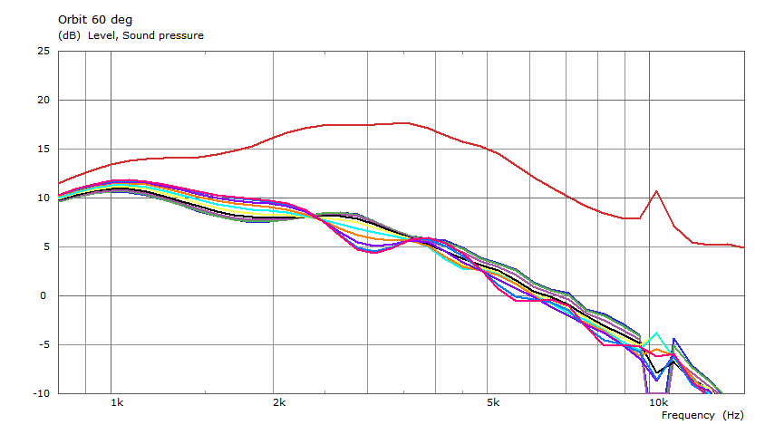

A slightly more refined mesh with more frequency points, 20 minutes. Oh, these numeric glitches are annoying (I have a suspition about the subdomain interface shape playing a role)...

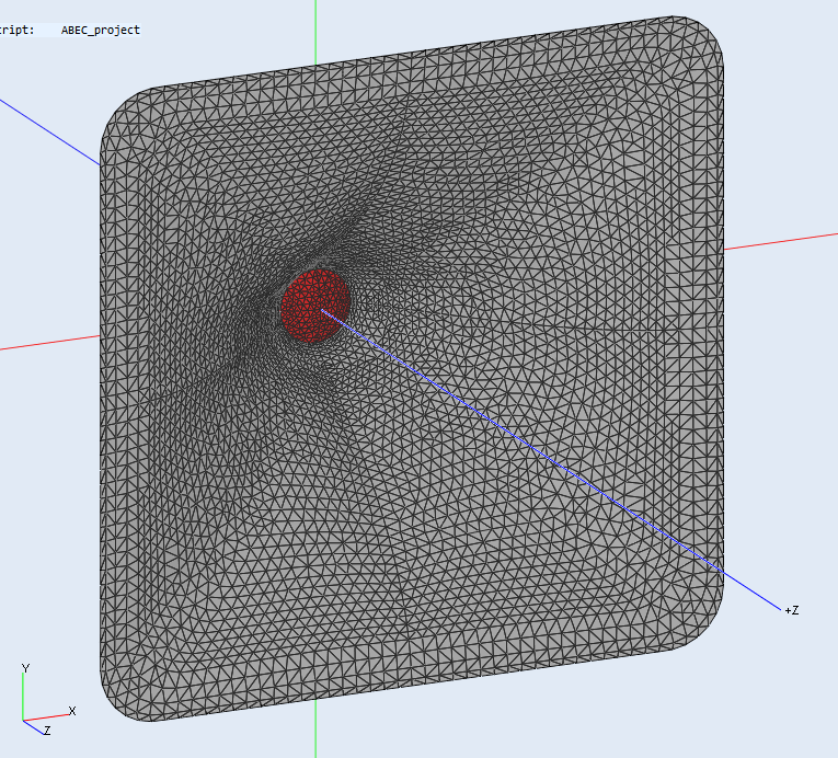

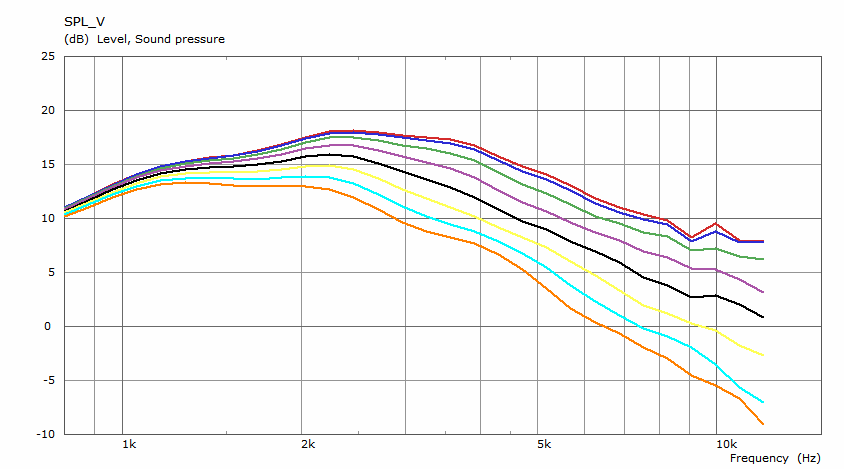

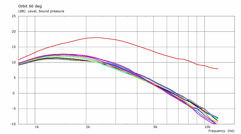

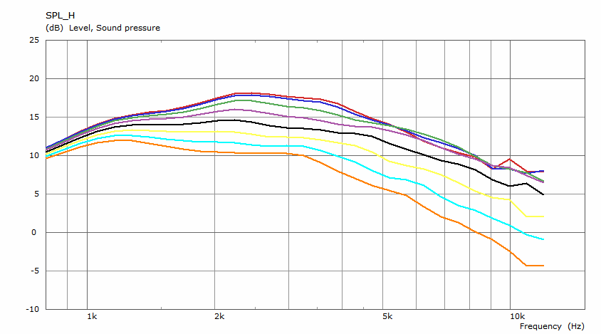

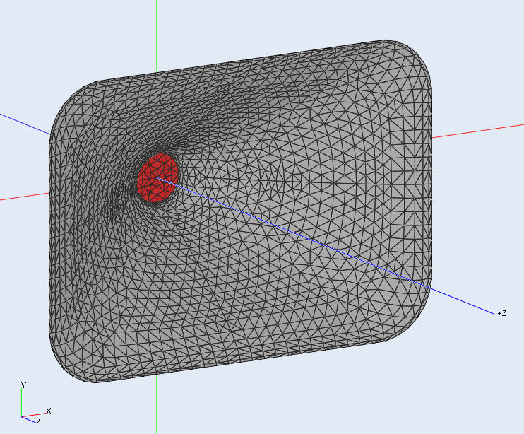

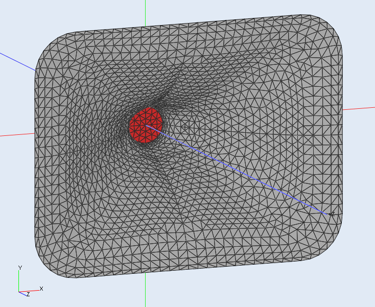

The same shape (with the same abrupt termination), only morphed to a rectangular outline of the same width and height -

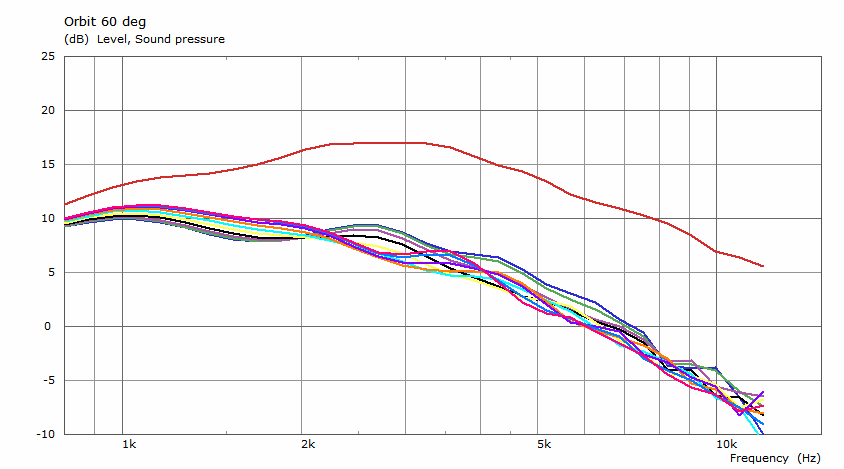

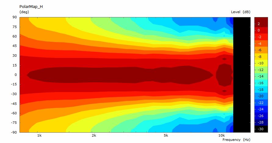

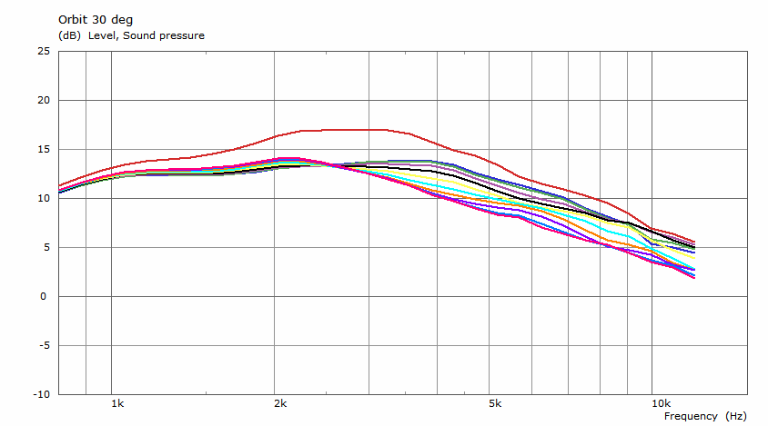

Finally, a better mouth termination added back. Now this is extremely clean. Compare it to the original purely (super)elliptic here.

Is that pattern flip in the orbit 30deg image around 3khz, where the lines flip order?
Rectangular waveguides seem a lot better than round, it is cool to see these graphs and compare. Altough, round is easier to make without cnc/3d printing.

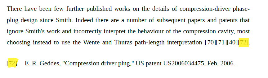

... That disertation seems to have missed my patents on phase plug design, that's disappointing since there is a lot of good info in those patents, including a critical analysis of Smith's work. As a Professor I am very passionate about literature searches. When good material is missed, you have to wonder how much else was missed.
Jack Oclee-Brown in his doctoral thesis mentions one of your patents but also states that it is wrong 🙂 (page 114)
Honestly, I don't know for sure what he means but maybe you could spare a few words (?). Or do I read it wrong?

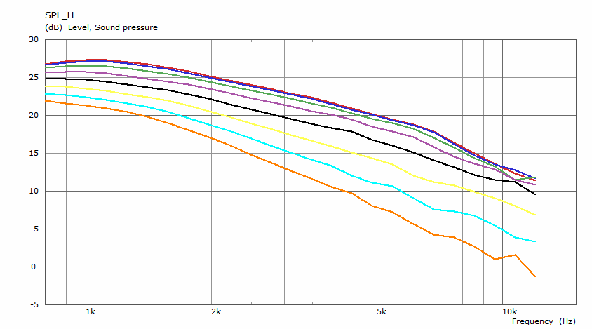

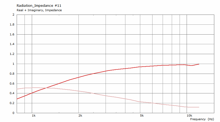

This is for a 50 mm dome (vibrating axially) in a conical throat -
