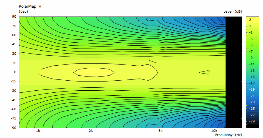

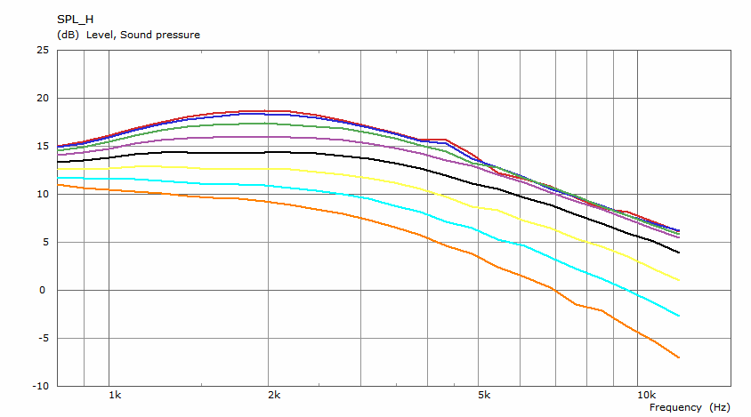

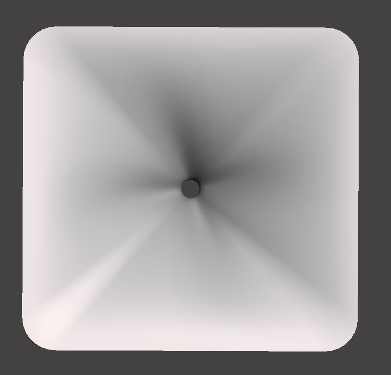

It's actually better on diagonal (SPL_D chart). This is 14" wide, 1.4" throat. The cyan line is for 45° off axis (7.5° step).

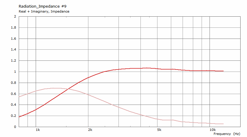

I suppose, revolutionary improvement would mean
* Flat acoustic loading from 200-300Hz and up to the last audio octave (e.g. like Heavise or step Sigmoid function).
* Constant directivity in the same frequency range. (I suppose beamwidth of -+(20-30)° in all directions would be ok, at least for home audio).
*Horn-related acoustic nonlinearities would be comparable to that of the direct radiator.
*Perhaps, some kind of numerical criterion should specify a minimum value of HOMs amount.
"Revolutionary design" should improve all the point above at the same time. But as we know, "the horn reality" is completely different. Numerical optimisation helps to find a certain balance of contradictory horn parameters 🙂.

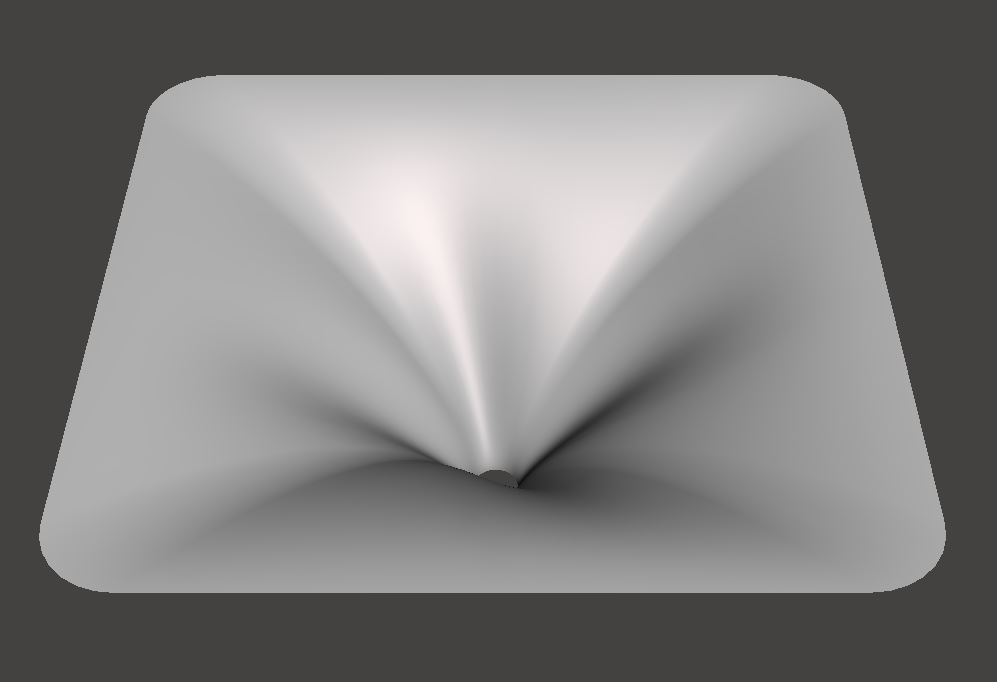

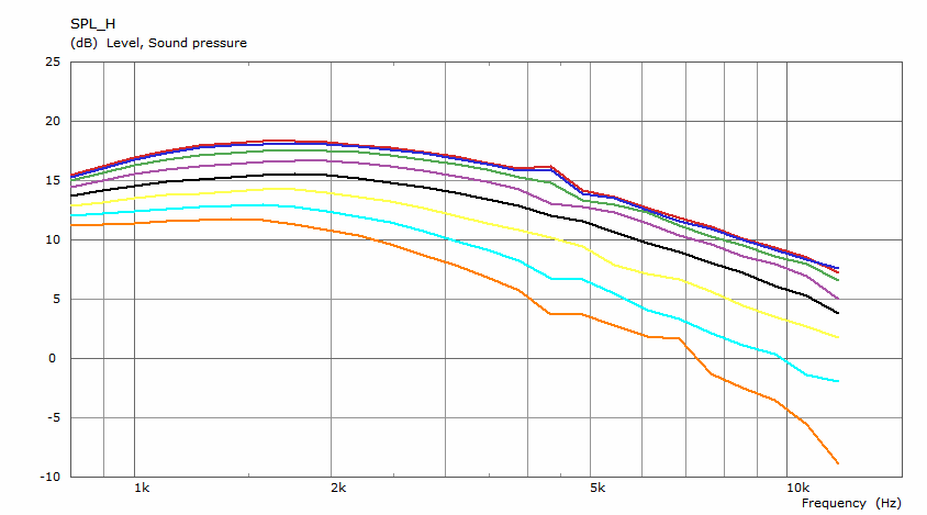

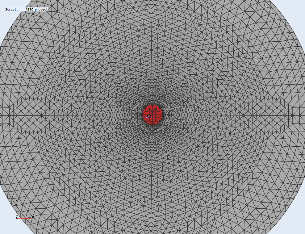

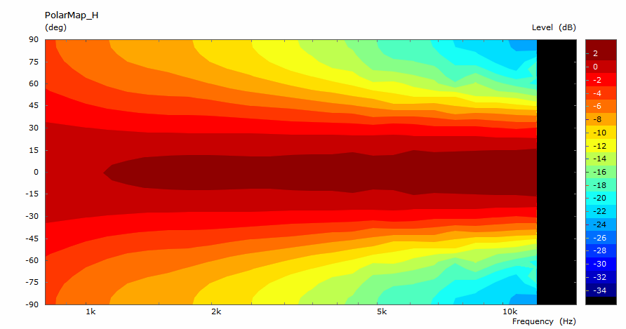

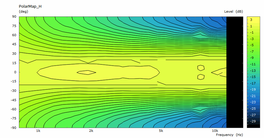

So, this is 16.1" x 15.5" horn, 1" throat. There are obviously some wiggles from the analysis as this was still only a coarse setting. Otherwise pretty good, isn't it.
Again, cyan line is for 45° off-axis.

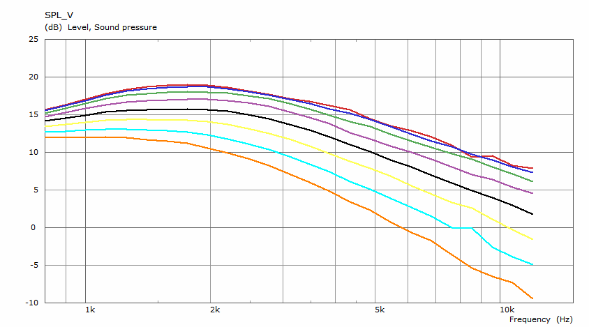

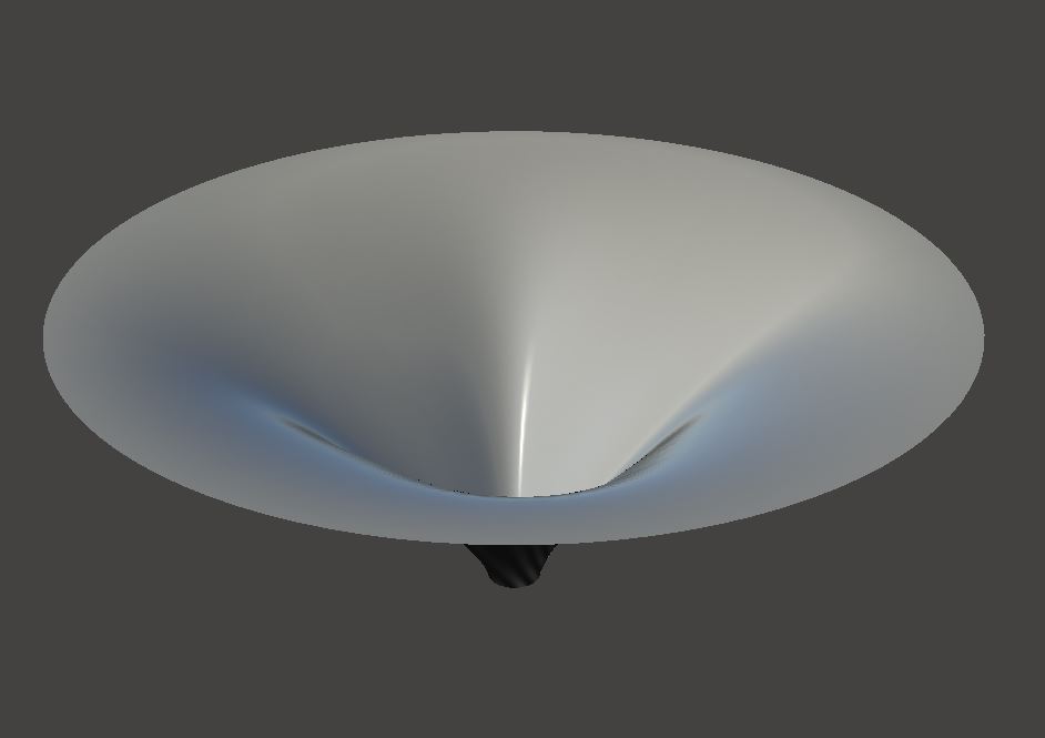

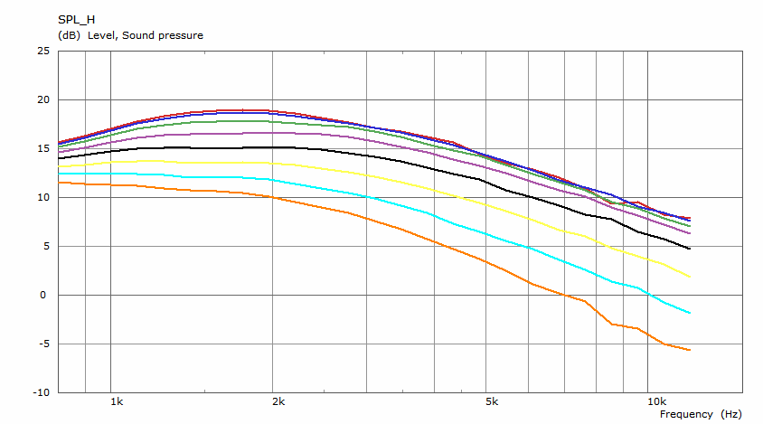

The same for a circular one (16.2") - there is a very slight narrowing just below and around 2 kHz compared to the rectangular one.

It probably isn't serious but it isn't nice either. This is what striked me the most - how perfect is the rectangular one in this regard. Not seen so often.
The parameters are the same. I'm not sure about the effects on different shapes.
Is the pure OS wg the "old one" (52cm Ø)?
No, this is a different one, about 16" across. Matching in size the one before.
Basically what is done here are protrusions and grooves made in the surface but not in a symmetric manner. When you directly compare the pure OS (on the left) and the one with grooves, the latter is a bit better. Not a huge effect but definitely in the right direction.
My comments would be (in order)
* since loading is almost irrelevant to performance, I don't see this as very important.
* this is achievable now with a no-compromise design. Its the size and other details which when compromised create the performance degradation.
* since the acoustic nonlinearities in the waveguide are insignificant, this isn't very important.
* as the design becomes less diffraction oriented, the driver dominates the generation of HOMs. Hence, this is not really an aspect of the waveguide that is of concern. It is, of course, a big concern in waveguides where HOM generation is not taken into consideration, but for the "perfect" device we are talking about, the HOM generation in the waveguide is dwarfed by that generated by the driver.

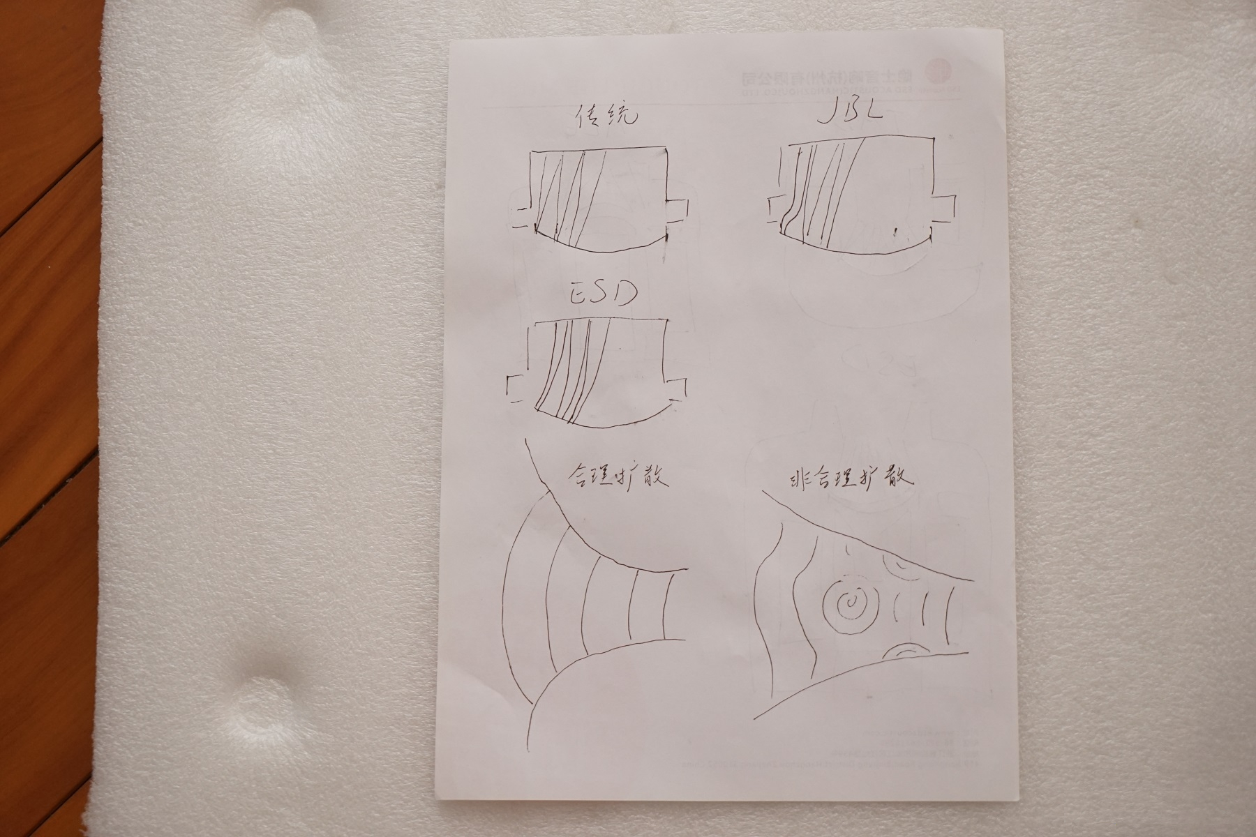

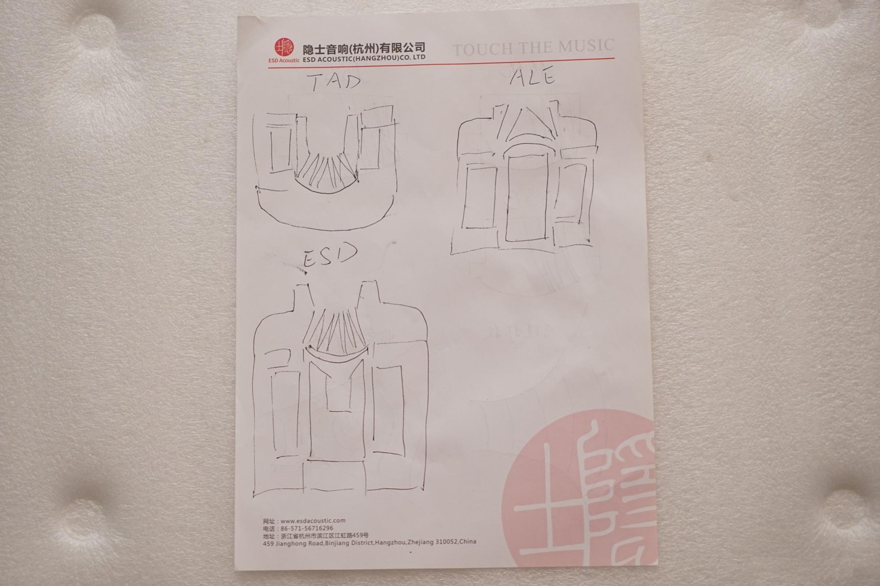

So far I have only seen one (exotic) manufacturer, or rather his son, who seems to have taken this into account when developing custom driver / horn combinations. These are clearly modern revisions to Salmon horns and companion drivers, but an interview with the guy revealed that he extensively modeled, simulated and optimized the drivers (phase plugs) and horn interface(s) in COMSOL in order to suppress the modes.
