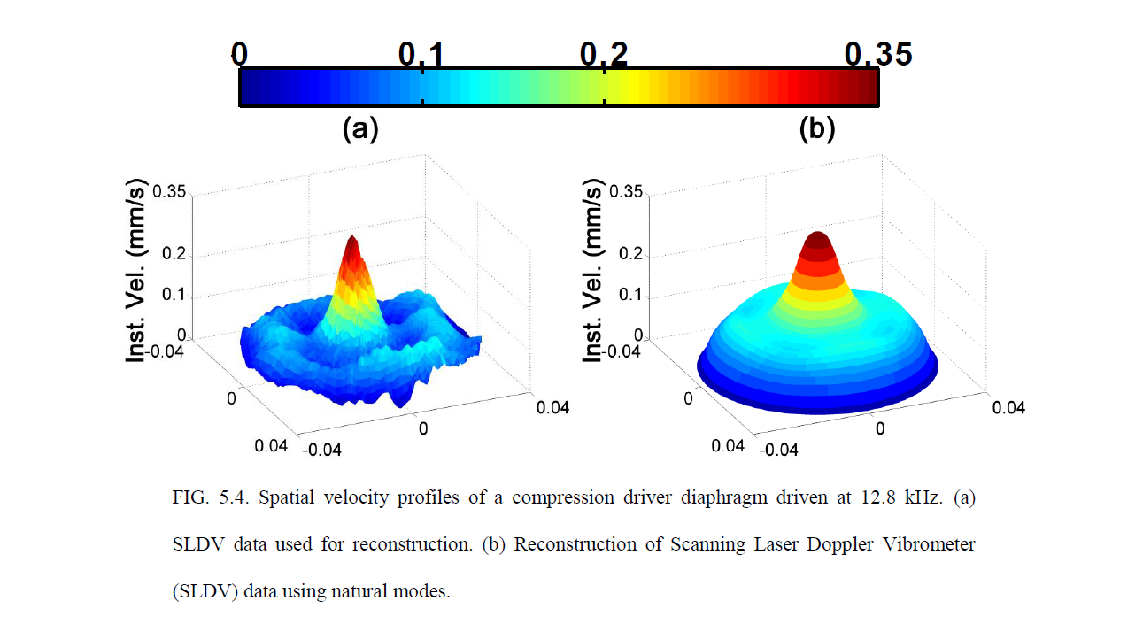

- I tried to estimate a typical speed...from the first break-up modes...and it seems to be only a several times...the speed of sound in air...
This reminds me of an issue that I have wondered about for a while.
I have seen presentations about the use of different materials in compression driver domes (mostly by the beryllium salesmen).
They compared the difference in speed of sound.
But if break up is into bend modes then that is not the correct comparison.
Stiffness for a bend mode doesn't scale linearly, so less dense but less stiff materials like aluminium should perform better than titanium even if the stiffness to density (hence speed of sound) is practically identical.
You probably do need a full FEA do this realistically.
Probably not much use unless you can fabricate your own compression drivers so I never followed it up, but thanks for the reminder.
I had hoped to eliminate excitation of the bend modes but I now realise this is not possible.

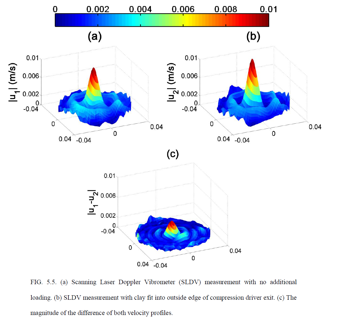

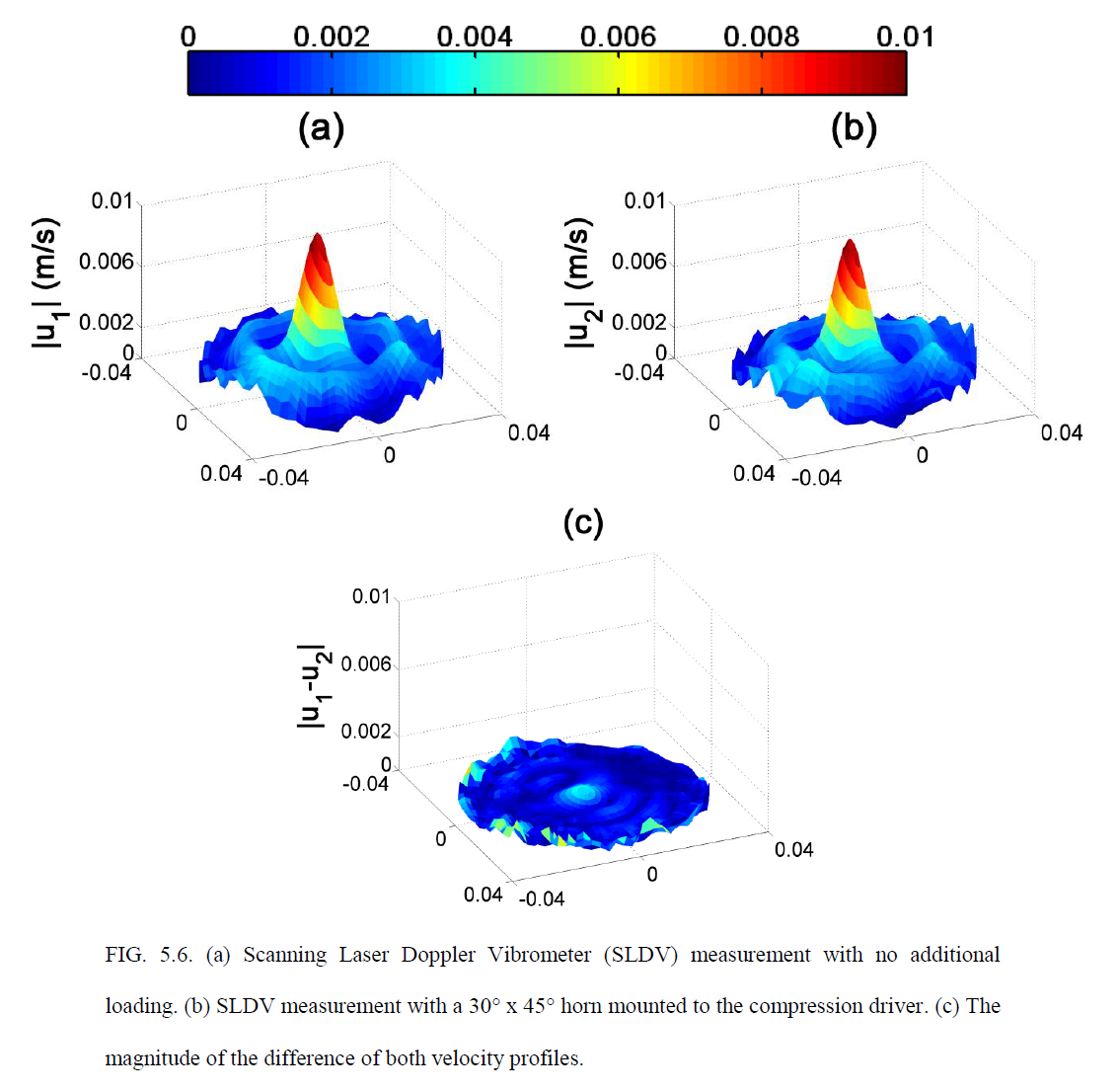

2 Examples:
I just looked at this closely and noticed it shows little evidence to support the idea that the circumferential (AKA rim) modes are excited much.
The FEA shows the possible rim modes, as expected, but the actual laser data is fairly axisymmetric.
The laser data looks a bit noisy, but initial impression is that I don't see much evidence of excitation of rim modes.
Is it clearer in other pictures in the paper?
It does, however, nicely demonstrate Earl's point that the modes are not those of the classic circumferentially clamped membrane.

A couple of comments.
I agree with Dave that we have to be careful with sound velocity since in a plate there are two types of modes, both compression (in-plane) and bending. Both exist and can couple with each other. At LFs this effect is small but at higher frequencies, it can be much larger. Hence axisymmetric drive can couple to nonaxisymmetric modes through this coupling. Again, this is a fairly small effect, but can happen.
Also, the wave velocity of bending waves is dispersive, meaning that it is not constant with frequency. This also complicates things to a very large extent.
Lastly, I have seen waveguides that are quite comparable to a pure OS, but I have yet to see one that is notably better.

Scanning Laser Doppler Vibrometer (SLDV) data of an Electro-Voice ND6 without and with horn.
Spatial velocity profiles of a compression driver diaphragm driven at 12.8 kHz..jpg386.4 KB · Views: 320
Comparison of the compression driver with and without clay in the outside channel of the driver .jpg499.5 KB · Views: 158
Comparison of the compression driver with and without the horn.jpg495.6 KB · Views: 159
