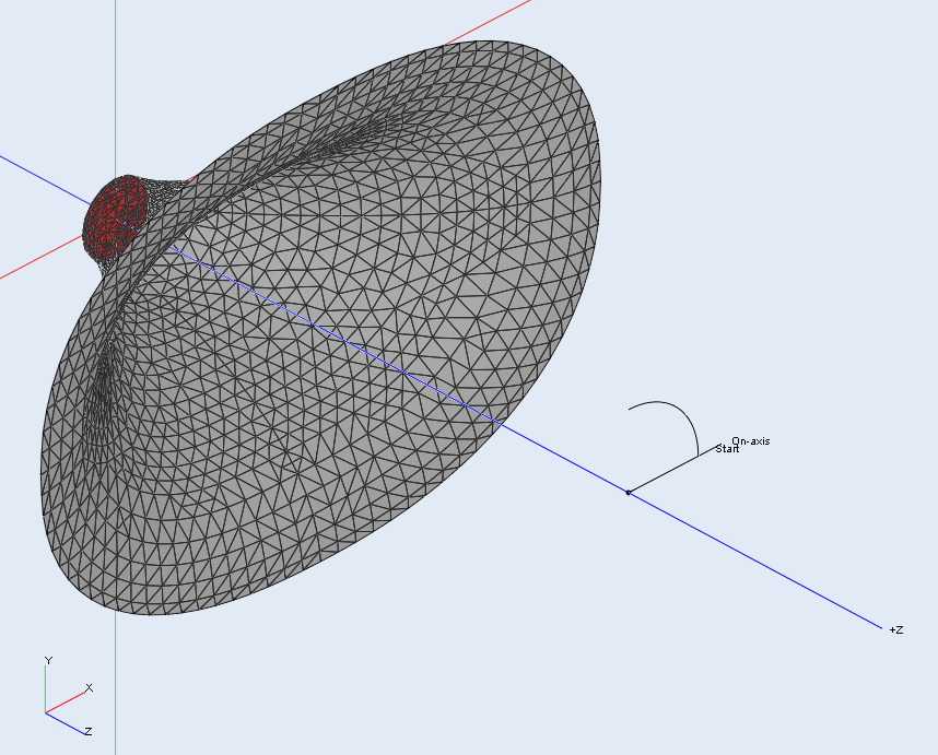

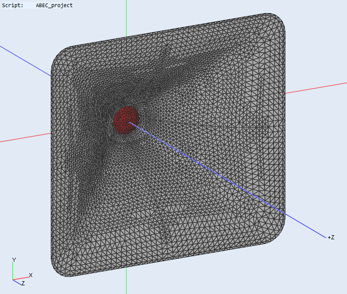

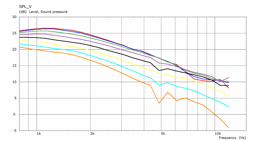

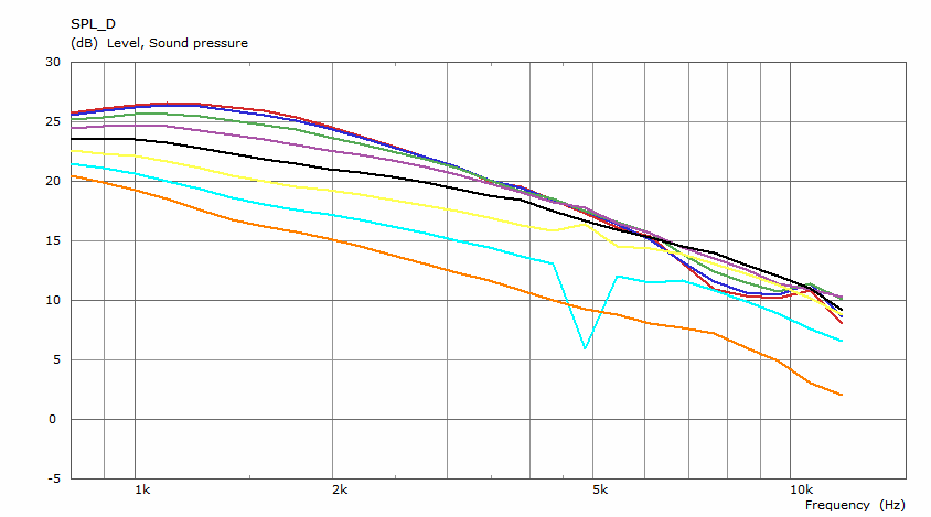

Yeah the diagonals seem to be better than horizontal very often 😀 Maybe there is an anomaly? Abec determines the diagonal by some algorithm? How about parameters that result 5 or 8 corners so there would be "diagonal" shape at the horizontal plane?

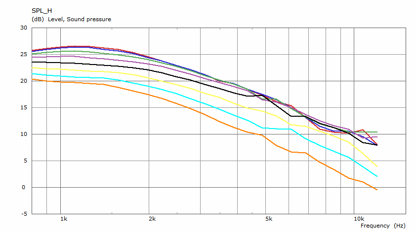

As far as I know it really makes no difference in ABEC whether it is horizonal, diagonal or whatever - these are just data from SPL probes placed at will.Yeah the diagonals seem to be better than horizontal very often 😀 Maybe there is an anomaly? Abec determines the diagonal by some algorithm? How about parameters that result 5 or 8 corners so there would be "diagonal" shape at the horizontal plane?
- This is from the last example but for a slightly more "conventional" shape (still thinking about using a compression driver via the open back side).

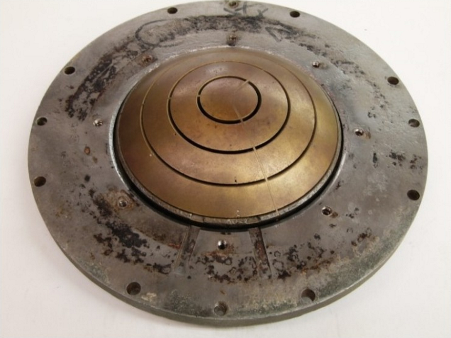

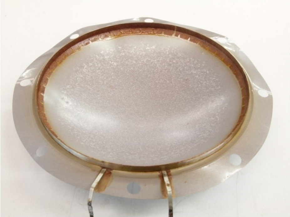

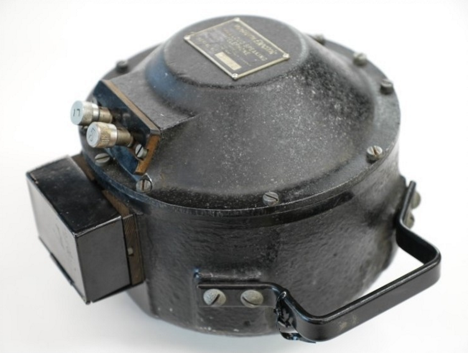

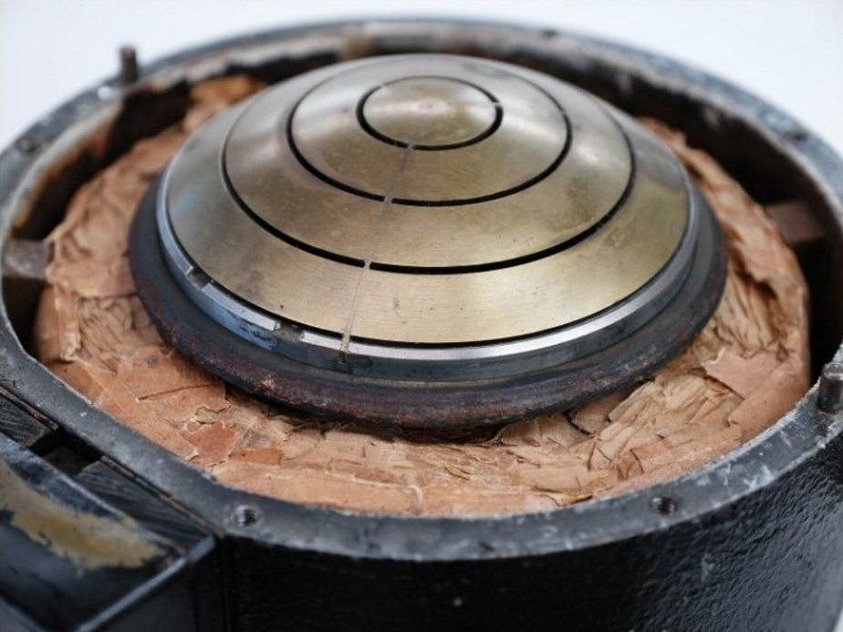

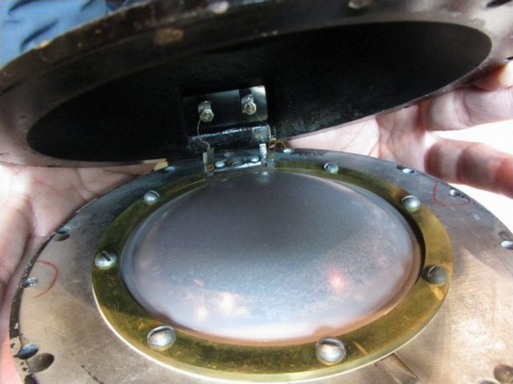

E.C. Wente and A.L Thuras - A High-Efficiency Receiver for a Horn-Type Loudspeaker of Large Power capacity (Bell System Technical Journal, 1928)
Part I:
Part I:

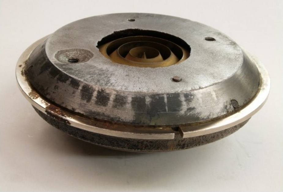

E. C. WENTE. 2,037,187. SOUND TRANSLATING DEVICE. Filed March 28, 1933.
The godfather of all modern compression drivers.

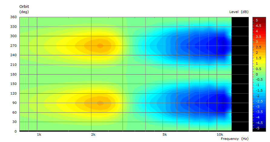

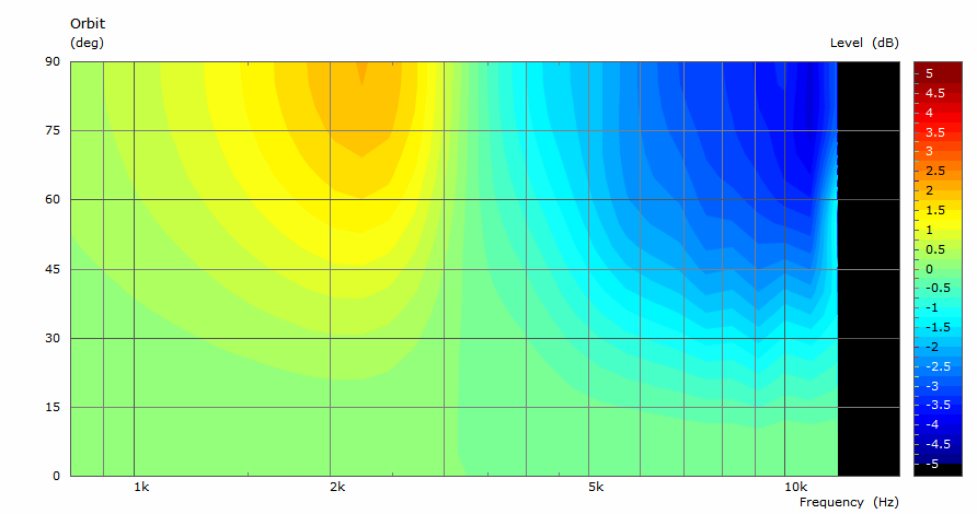

- Would the orbit presentation as a polar map made more sense?
This is an example going from 0 to 90 deg anti-clockwise, normalized to zero deg.

Could be the full circle. Not sure about the readability.
Looks like 2 sources 😉

Simulate both?
Yes it is. I wanted to wait for the polar plot where it is more clearly visible (see the one above). This is also one of the arguments for (a more) axisymmetric device.Is that pattern flip in the orbit 30deg image around 3khz, where the lines flip order?
Attached is the complete ABEC project.ps. could you share abec simulation related setting of the 16"+ waveguide you posted recently? I'm getting errors if I try to simulate bigger ones as I posted in this thread some time ago. Thanks!

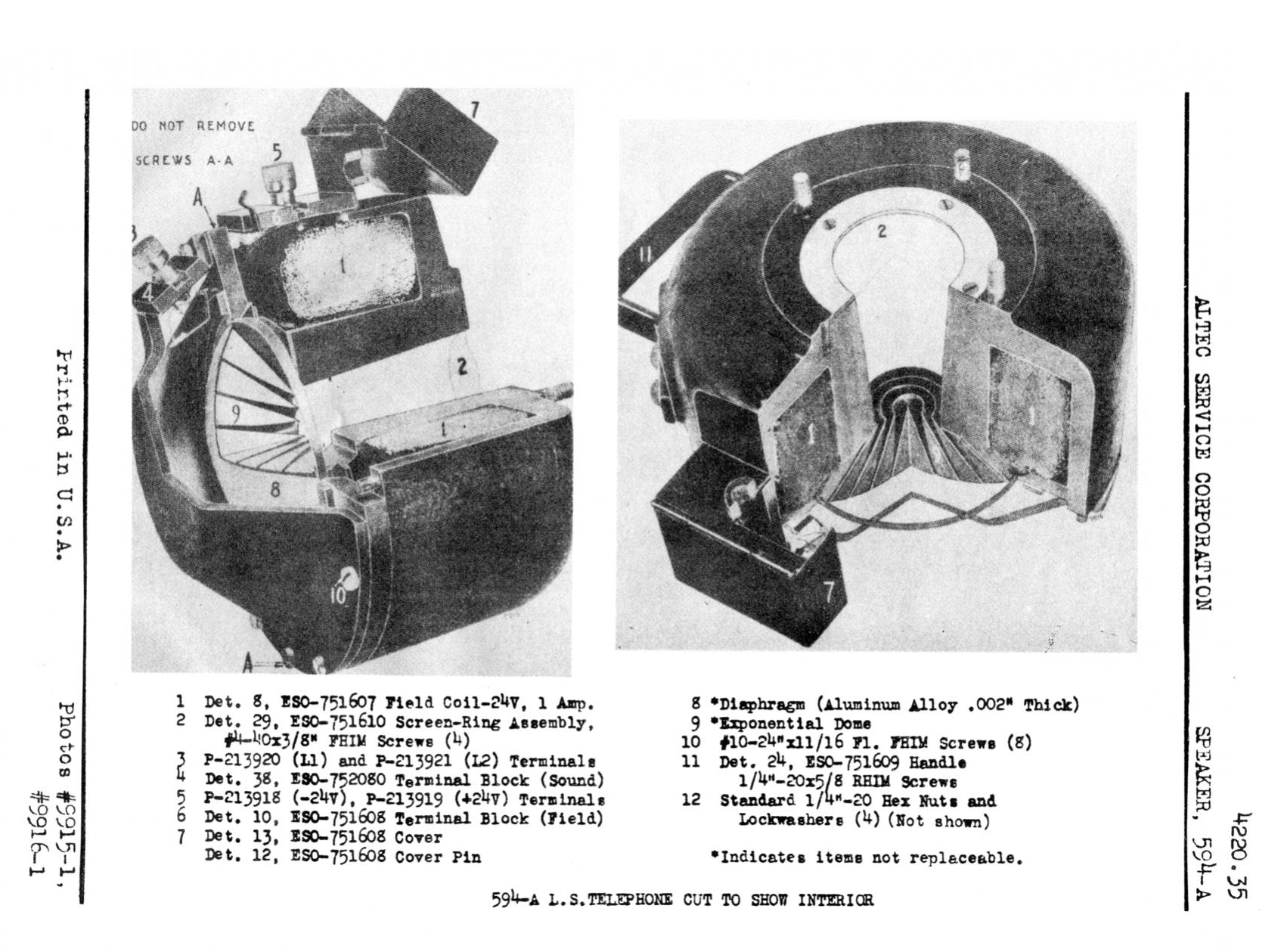

To finish the history lesson:
"Around 1954, the Altec Service Co. NY, City, sold 594-A for $69.00 with original blue/gray diaphragm which is the most perfect sounding driver. RCA 1930's Photophone HF horns provide full acoustic loading down to 150 Hz which is essential for Zero Horn Honk performance with cross over in the region of 250 to 300 Hz. JBL also manufactured simliar horns.
For what it's worth, a two way theater horn system delivers a huge wave front with excellent uniform frequency response every where in a well designed listening room with 10 watts or less of amplifier power__Single Ended amps, Anyone? The movie theaters prior to the 1950's were capable of magnificent concert hall acoustics with room sound reverberation quality.
The JBL model 2440 is the professional version of JBL permanent magnet model 375 driver. Both of these 594-A clones with identical original JBL Aluminum diaphragms come very close to 594-A.
The actual measurements of 594-A with the blue/grey diaphragm are dead flat up to the mass break point around 7,000Hz with a roll off at 6 db / octave plus or minus 0.1 db all the way to 20,000 Hz.
You can tip up the response 6 db / octave above 7,000 Hz with one RC in the amplifier to provide flat response to 20,000 hz. Performance of 594-A with the "repair" softer "Cream color" aluminum diaphragm come close; however nothing sounds as clean and real as the orignal blue grey version.
The blue /grey diaphragm color which looks like it "just clawed its way out of hell" is due to the Western Electric heat treatment resulting in extreme hardness of the special duraluminum alloy no longer available unless you put up $100,000 up front for production startup."
