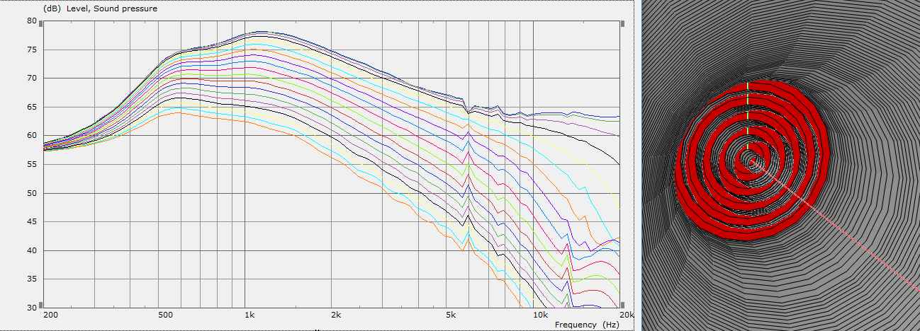

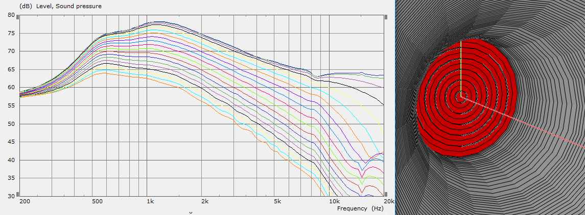

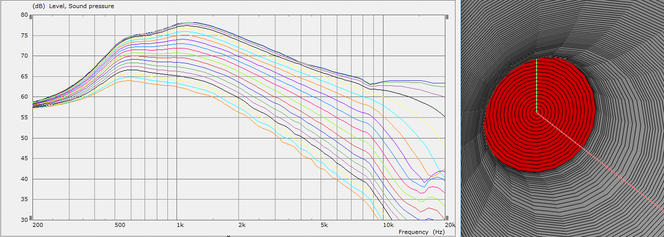

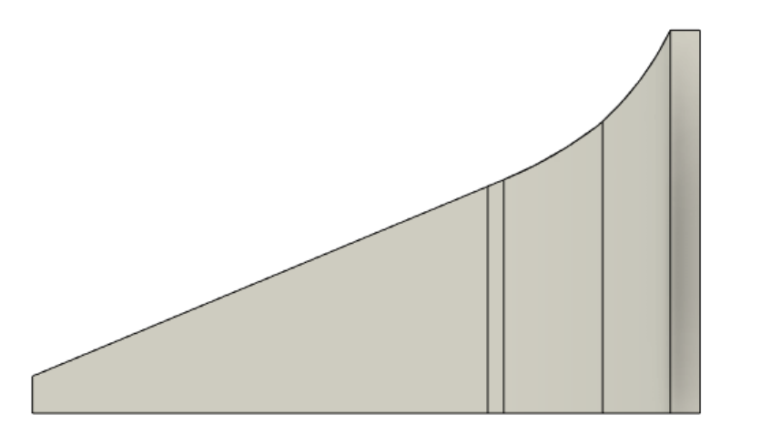

Probably the best result I obtained, the most free of numerical artefacts -
Flat source alone:
With added rings:
So to speak, "I can't see that device doing much of anything", as Earl said.
- ABEC project attached. I'm open to suggestions.
Flat source alone:
With added rings:

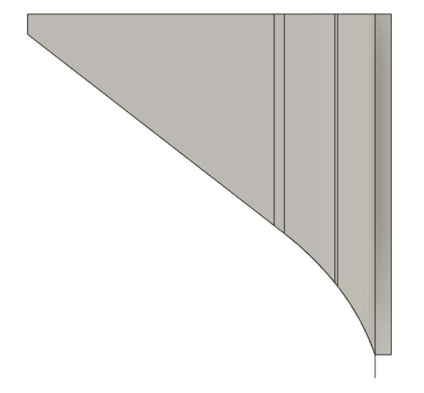

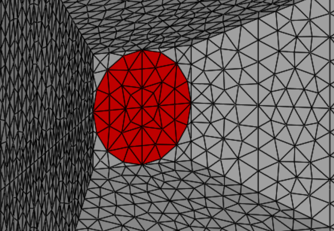

Just a sanity check with the rings 1mm high - this really shouldn't do anything at all, and it really doesn't, i.e. the simulation itself should be correct - there are actually seven subdomains, each ring interior as a separate one, not a simple model at all.
sharing the results of his “50 cent part” with the DIY community are not part of the Klipsch business model.
I agree with Marcel, without some real data, I'd have to assume that the sims are correct. If this really worked well, then I would expect any company to show the data as an advertisement of the feature. Not so much if it didn't work too well.
Sounds very suspicious to me.

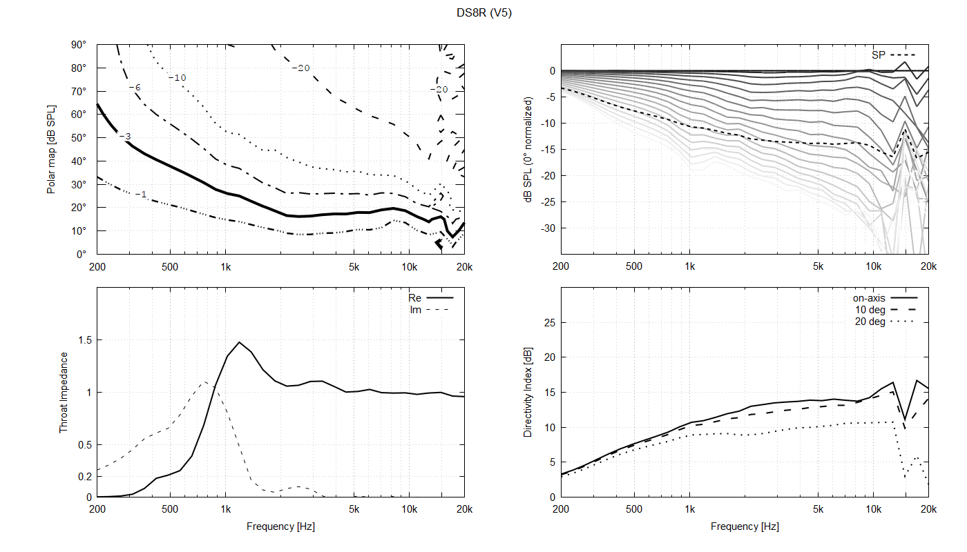

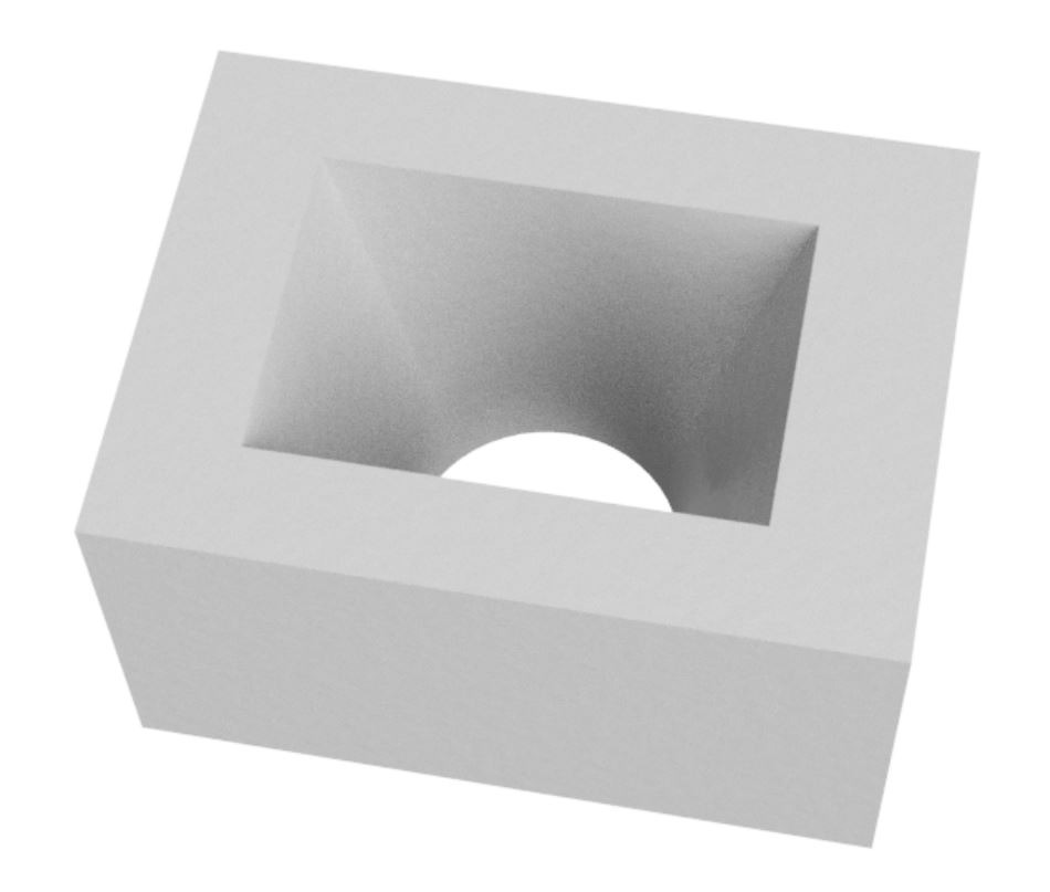

Returning back to the 2-profile geometry, I've found a way how to import the circle-to-rectangle adapter into Fusion, retaining the sharp corners -
Flat or bended boards can be smoothly attached to this interface...

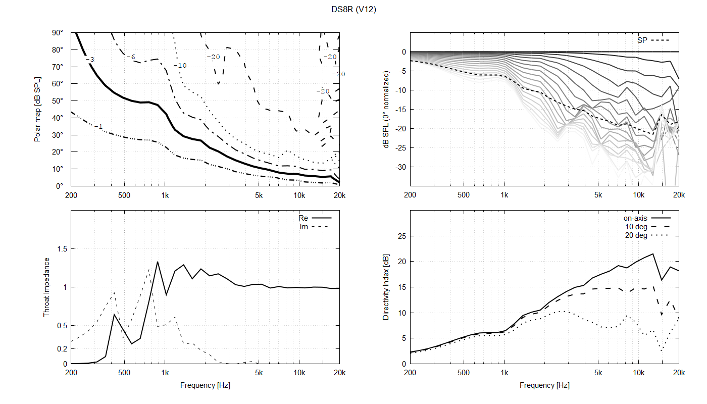

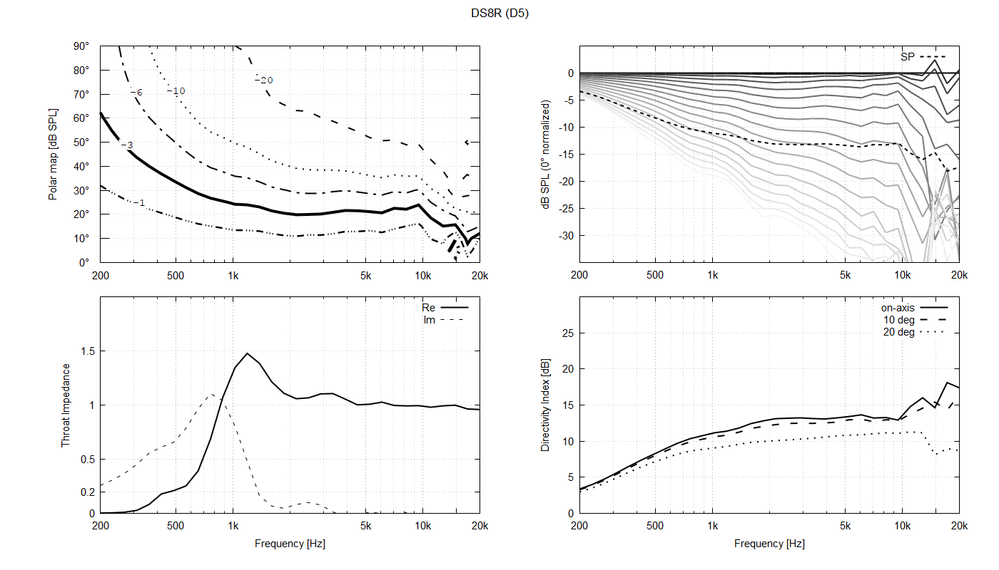

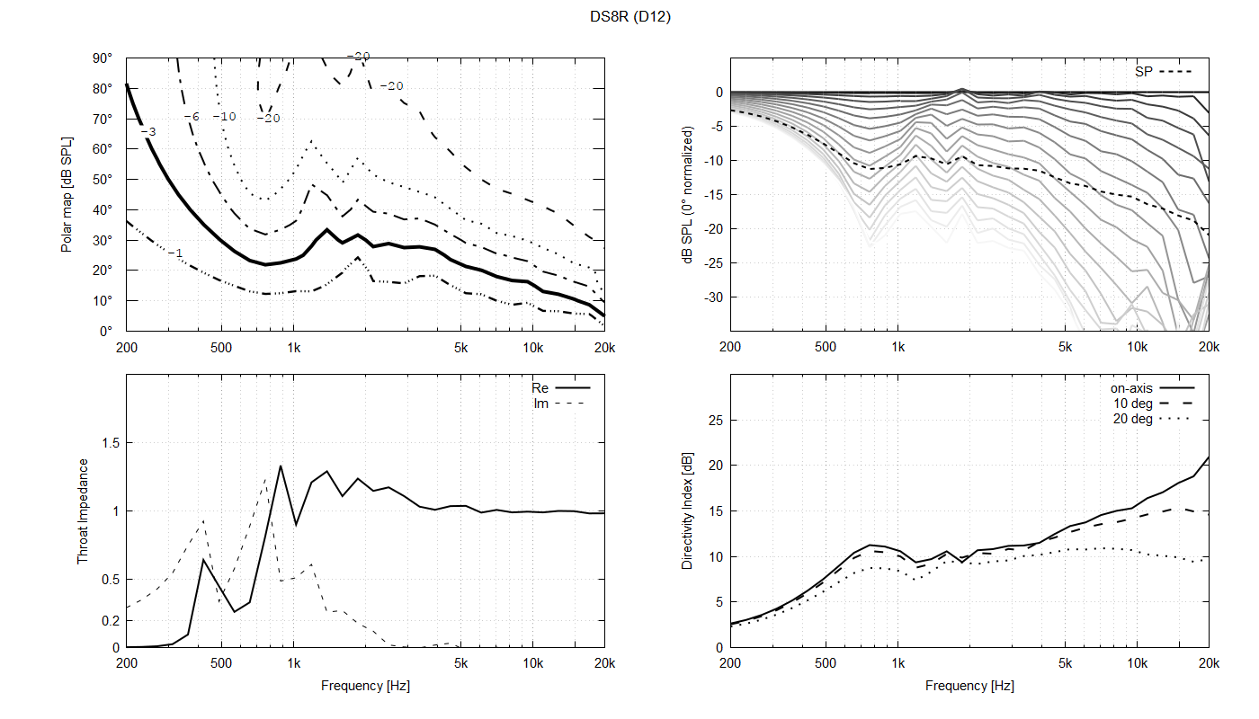

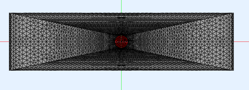

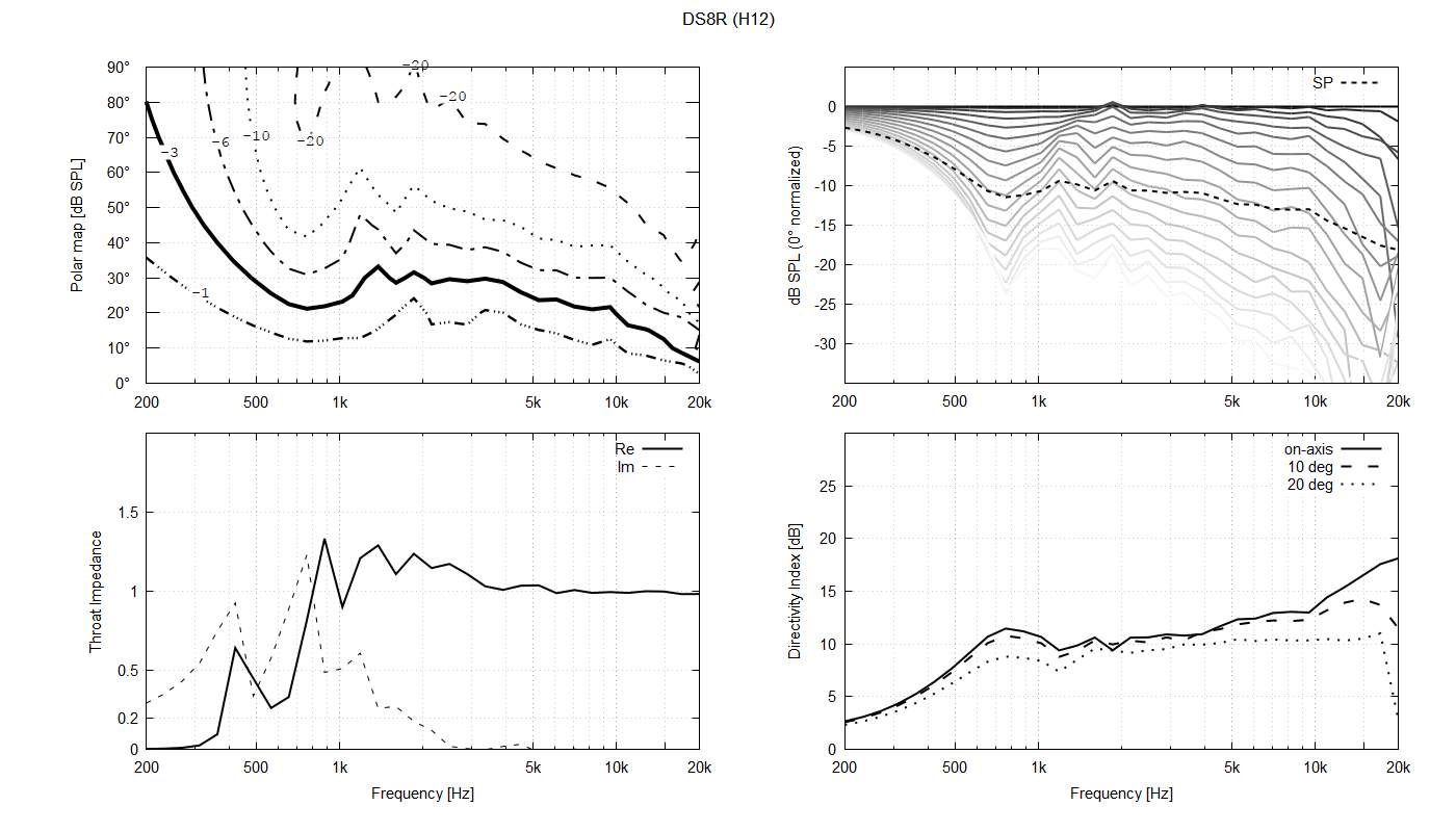

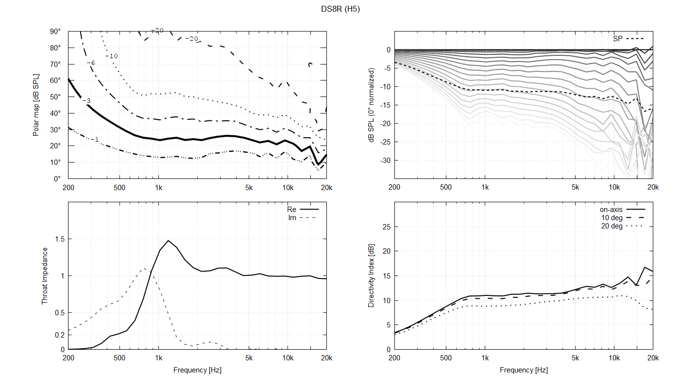

Just tested a 2-profile geometry with mouth folding. The simplest approach was to define a R-OSSE profile on the diagonal with a defined inclination.
Horizontal, vertical, diagonal (garbage above 10 kHz):
To repeat, by "2-profile" I mean a shape composed of a symmetric pair of two flat or bended boards (easy to make in any size) + a short circle-to-rectangle throat adapter.
This is interesting I am working on multi driver throat adapters at the moment and the only process for generating them I can think of is to create a point cloud in matlab/octave and then fit a surface to that, this is not ideal though as the geometry is quantized. I am not a CAD expert though. My throat adapters preserve the horn area expansion (exponential), incorporate bends (for multi driver) and also perform round to rectangular transition. Have you any thoughts on a better way of making them?Returning back to the 2-profile geometry, I've found a way how to import the circle-to-rectangle adapter into Fusion, retaining the sharp corners -
By garbage I meant it's not reliable data (too sparse BEM mesh). This was 1.5" throat, BTW. Actually, I don't think it will be any worse than anything else above 10 kHz.
You mean other than via a point cloud? I'm not sure what are incorporated bends, that may be an obstacle, but if you are able to cut the adapter into slices of known geometry, it's easy to import the whole (interpolated) surface into e.g. Fusion 360 - I have a new and pretty universal import script for that which I can share.My throat adapters preserve the horn area expansion (exponential), incorporate bends (for multi driver) and also perform round to rectangular transition. Have you any thoughts on a better way of making them?

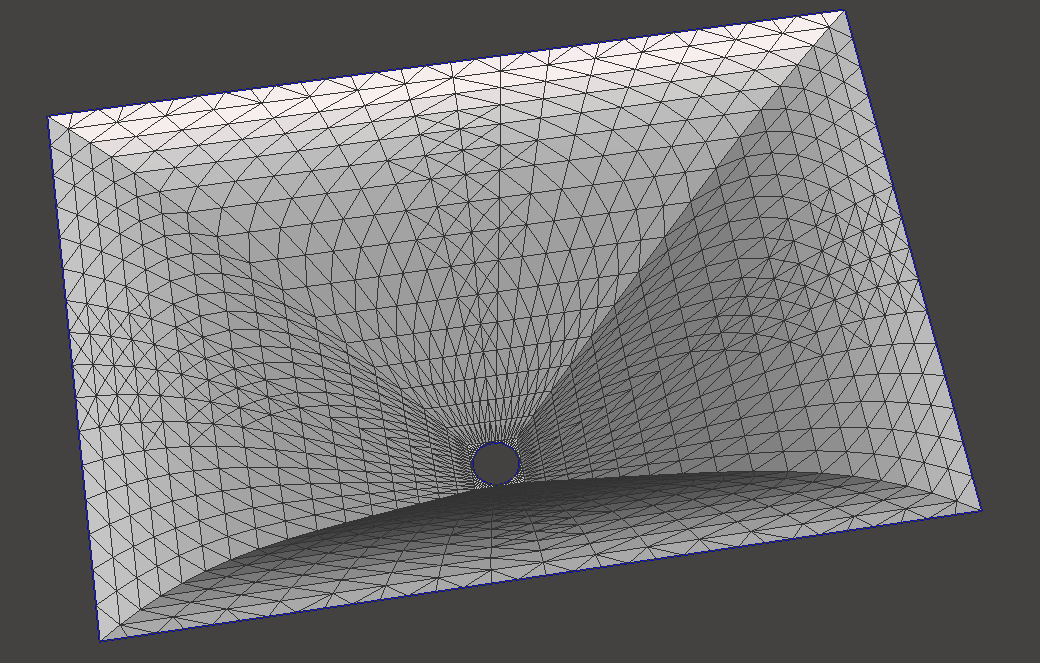

There are many ways to make it worse. One of them is to increase aspect ratio of the mouth. This is the same diagonal profile as above, I only changed its inclination to 12 deg (mouth 700 x 180 mm):Just tested a 2-profile geometry with mouth folding. ...
This sounds like it would work with my bends as well. The bend is just a simple radius (I don't know if this is optimal, it just seemed like a simple thing to try first)You mean other than via a point cloud? I'm not sure what are incorporated bends, that may be an obstacle, but if you are able to cut the adapter into slices of known geometry, it's easy to import the whole (interpolated) surface into e.g. Fusion 360 - I have a new and pretty universal import script for that which I can share.

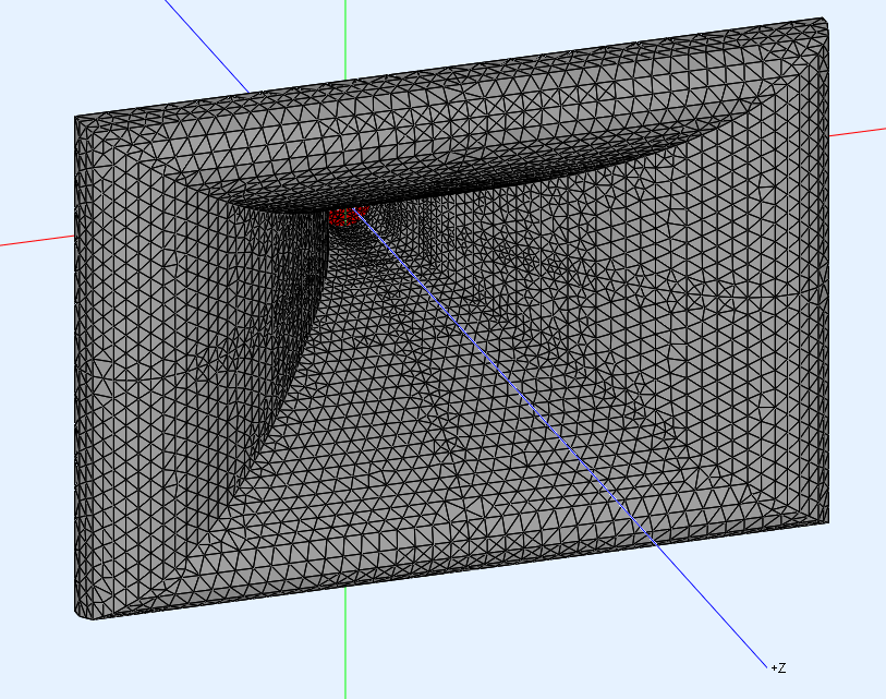

Should be easy to fit with two OSSE profiles. It's possible with the 4.9.0 pre-release: https://at-horns.euI got the K-402 geometry [...]
For those willing to pursue this kind of geometry, this would be a project template (replace the numbers by your best fit - I didn't try):

For the ABEC mesh (Output.ABECProject) it's fine to set the adapter size the same as the throat diameter:
Throat.Diameter = 50 ;[mm]
Horn.Adapter = {
L = 0
Width = 50
Height = 50
Segments = 1
i.e. there will be no spaces between the source disc and the walls -
For the STL output (Output.STL) this doesn't work yet.
