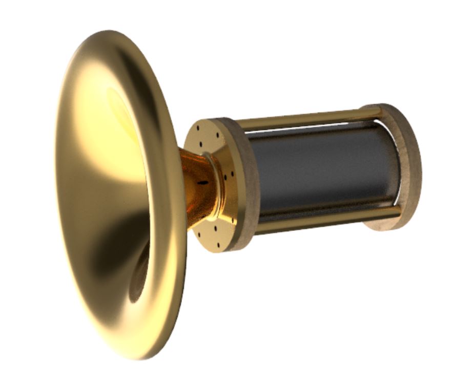

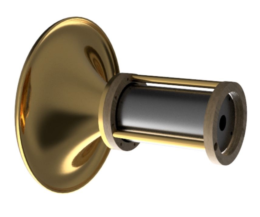

BTW, I've found a way of mouting a free standing WG (ST260 style) that I'm finally pretty happy with -
(Colors may change.)
