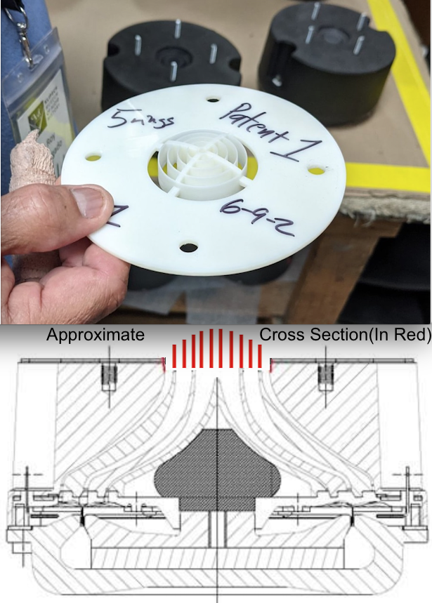

Roy Delgado’s dome shaped 5-ring “Diverging Acoustic Lens” in the throat of the Klipsch Jubilee K-402 horn (1002 x 648 x 422mm W x H x D) using the Celestion AXI-2050 is claimed to widen the very high frequency to match it’s 90 degree horizontal pattern.
The three semi-planar (flat?) wavefronts exiting the driver’s phase plug on the driver side of the lens presumably diffract in more of a spherical wave front through the elliptical lens exits.
Still have not been able to find any actual “before and after” polar or spectral decay measurements, only positive subjective reviews.
Wondering if you could (would) include the effect this type of parallel rings have on horns you have simulated?

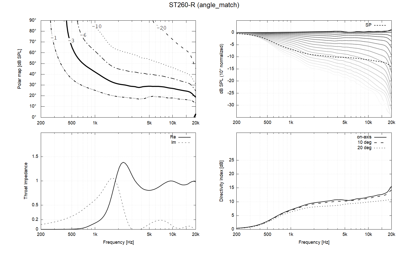

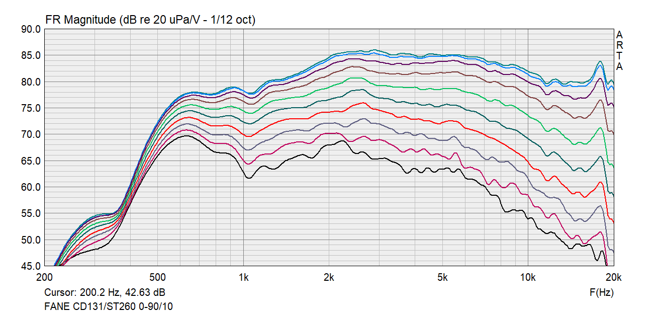

I had a chance to do some measurements today. Here's FANE CD131+ST260:
Makes me wonder, what more do we want? Something a bit bigger perhaps.
That driver works beautifully in the waveguide. Have you measured other drivers with this, if the wavefront shape (modes) make any problems on the very top, or are all this nice?
I'm afraid I'm not equipped to do it in a meaningful way, so I leave that for others.Any chance to see any distortion figures of this combo ?

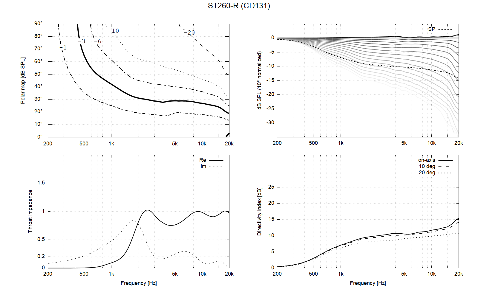

It's not even a perfect match. This is a simulation of the above device, including the 18mm conical exit section of the driver.
Exit angle of the CD131 if 27°, waveguide opens at 19° -
In this case it seems that the decrease of acoustic impedance around 4-5 kHz actually helps to make the frequency response flat in this region.

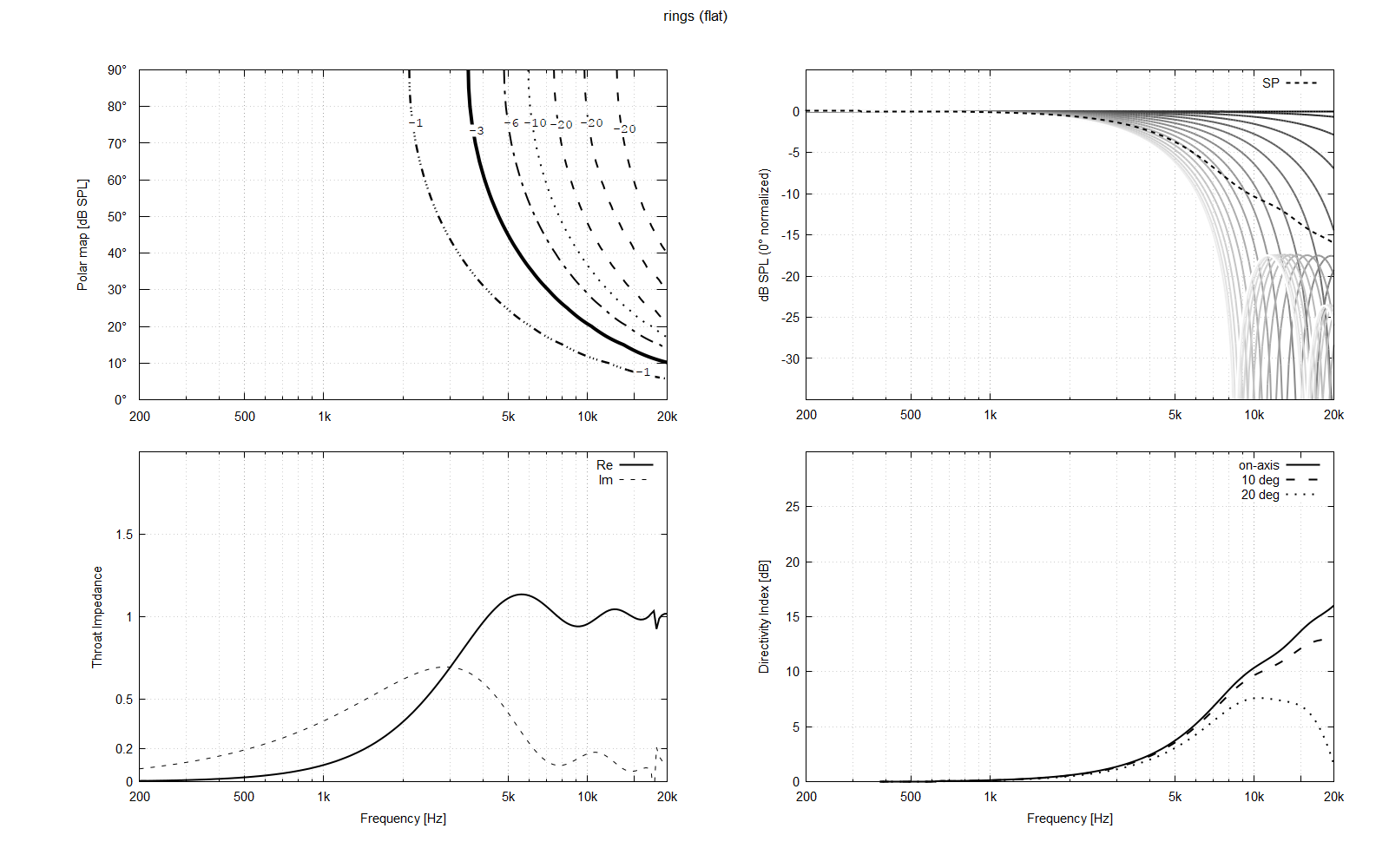

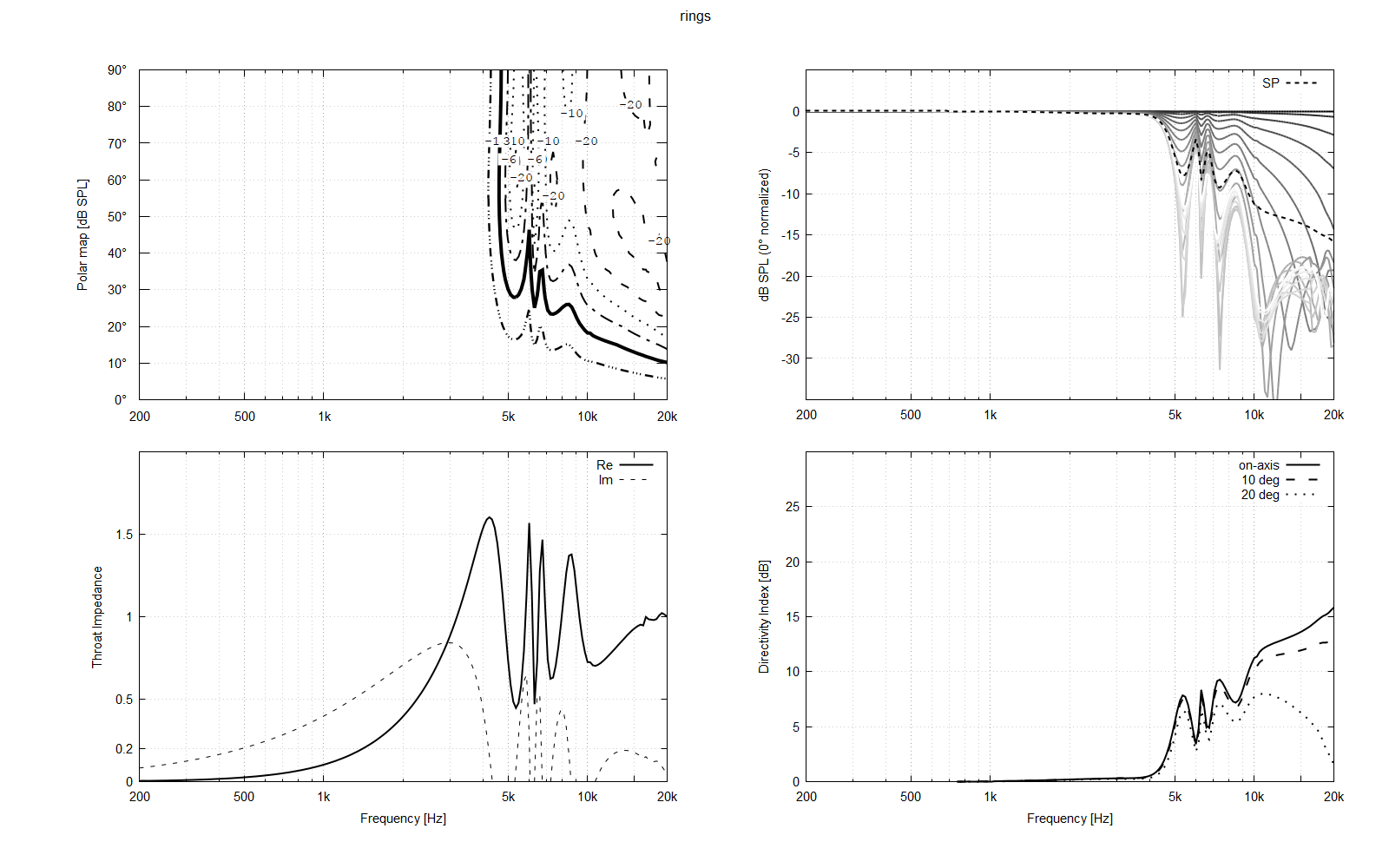

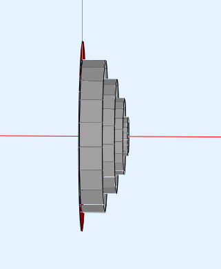

This is a simulation of a 2" disc in an infinite baffle, without and with the rings shown:
I only don't know how reliable is the simulation here. It doesn't seem as a complete garbage so there may be some truth to that.
It's pretty obvious it doesn't create a spherical wavefront at HFs because it doesn't modify the path lengths for the individual rings and I find it difficult to imagine how it's supposed to work or what should be the right conditions.
Anyway, up to 4 kHz it (somehow) works like a charm, i.e. it actually does decrease the DI to almost nil. Now I wonder if different positions and lengths of the rings could shift this higher, that would be a real magic. At the moment I'm a bit sceptical.

Mabat,Anyway, up to 4 kHz it (somehow) works like a charm, i.e. it actually does decrease the DI to almost nil. Now I wonder if different positions and lengths of the rings could shift this higher, that would be a real magic. At the moment I'm a bit sceptical.
Thanks so much for the simulation!
Interesting results.

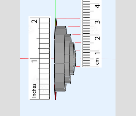

In Roy Delgado’s 5 ring divergent lens, diameter of the center ring appears equal to the distance (around 4.5mm) between each surrounding ring.
Last night DIYaudio member Itusler sold something similar looking, his photo makes the center ring more visible:
Your four ring lens spacing doubles at the center, from around 5mm(3/16”) to 10mm(3/8”).
Similar to a 2” disc “beaming” an octave lower than a 1” disc, diffraction from the wider center ring would be only about half the beamwidth of the surrounding ring’s pattern, which may be the cause of the uneven response above 4kHz in your simulation.
Hope to see how equal ring spacing compares to your results posted in #10376.
