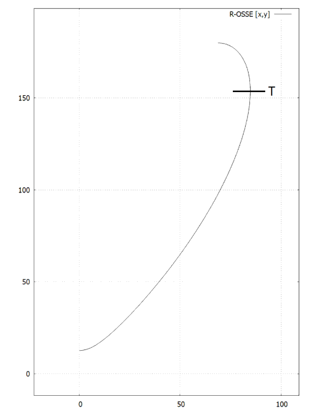

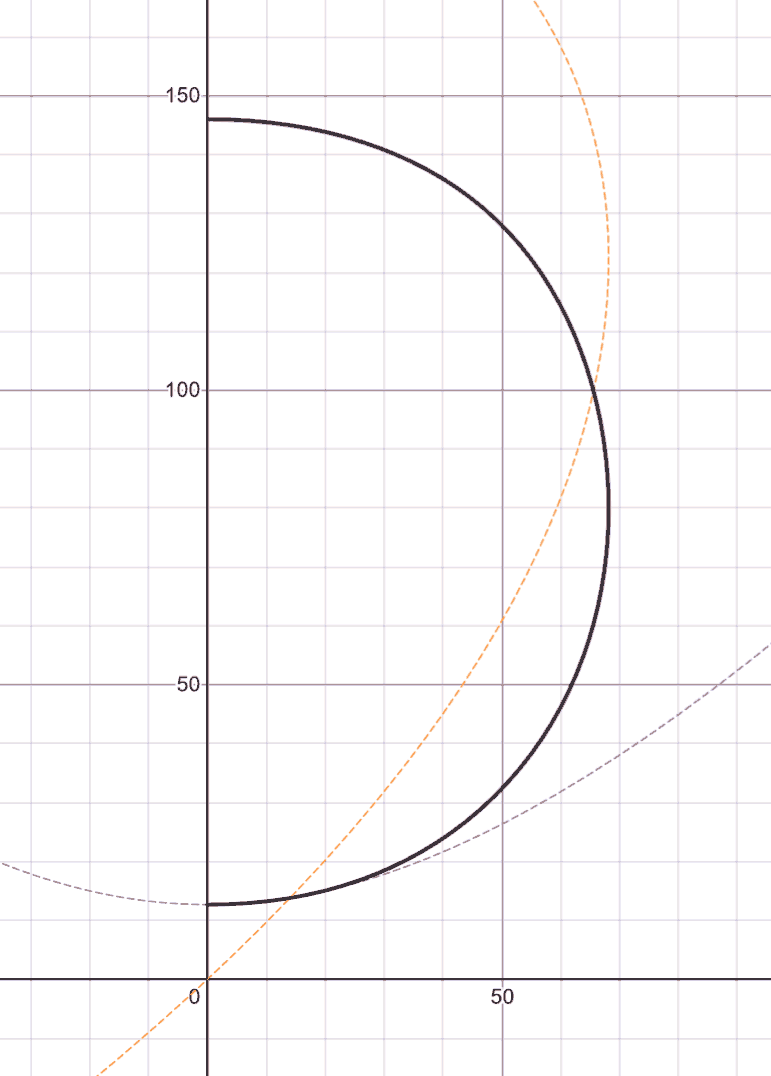

Now here is my conjecture -
If you took the below shown axisymmetric waveguide profile and placed it in a flat baffle of an enclosure (in such a way that the baffle round over would match the contour in the cross section), it would perform worse than the corresponding axisymmetric waveguide free-standing.

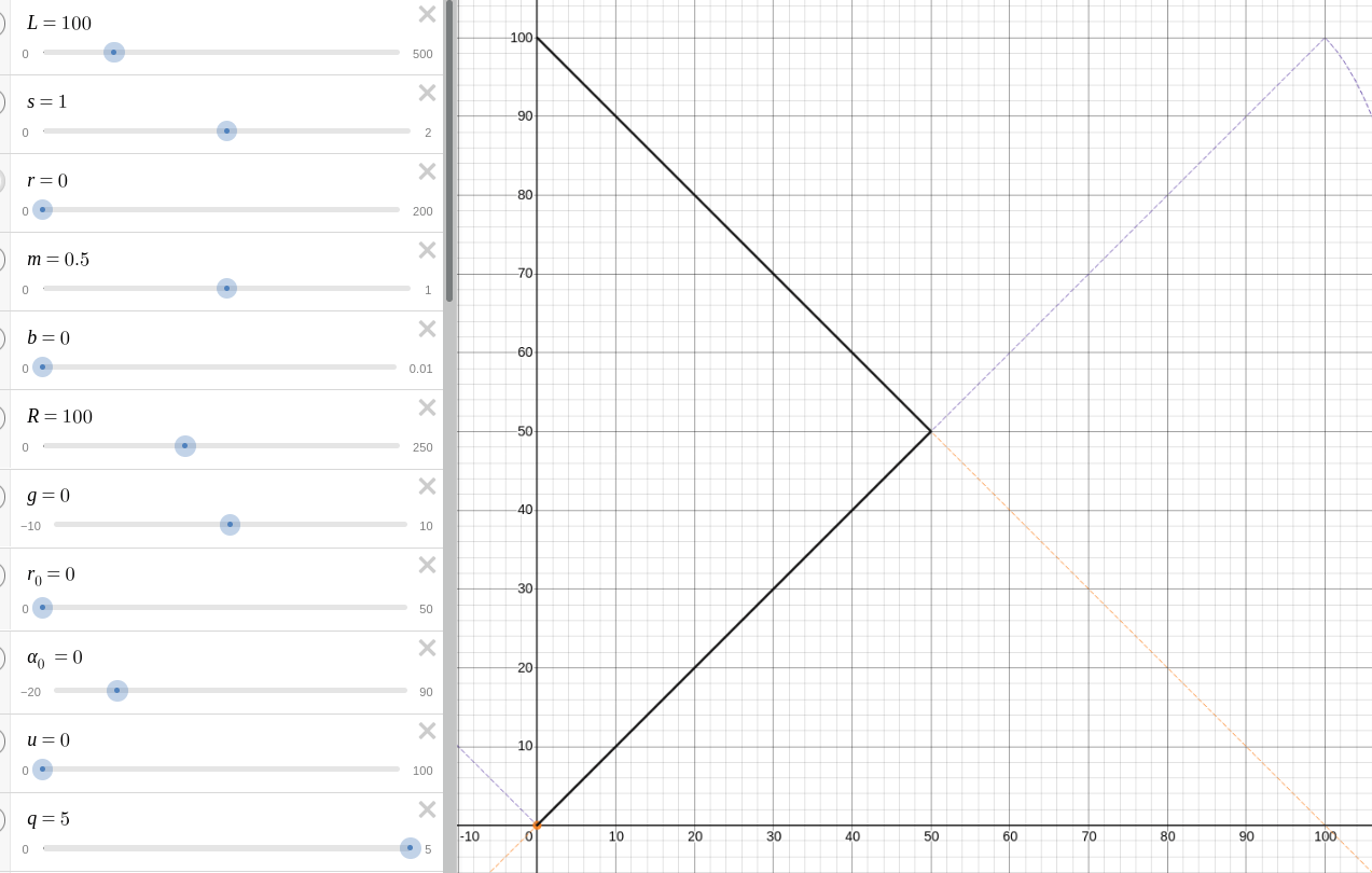

BTW, with this setting of the parameters, the contour is still a simple pure OS - a useful sanity check.
- So someone with the access could put this formula into COMSOL optimization loop and find the best termination for an OS waveguide. (We probably wound't be very surprised but it would be nice to have it confirmed. I claim it can't be very different from the CE series - for a 1" throat, that is. For bigger throats it should be done differently, IMO.)

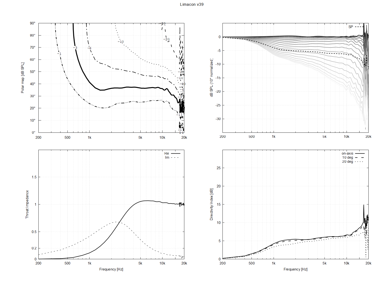

A revisit of Limacon v39 with Ath 4.8 and the reporting feature. Please see attached Mesh and ABEC settings used to generate the gnuplot.
Limacon v39
Superformula based waveguide with a 10.5deg exit to match the HF10AK.
380 x 280 x 114mm (Term.q = 0.995)
Code:
Mesh.AngularSegments = 120
Mesh.LengthSegments = 20
Mesh.CornerSegments = 6
Mesh.ThroatResolution = 2.0 ; [mm]
Mesh.InterfaceResolution = 7.0 ; [mm]
Mesh.InterfaceOffset = 5.0 ; [mm]
ABEC.SimType = 1 ; infinite baffle
ABEC.Abscissa = 2 ; 1=log | 2=linear
ABEC.f1 = 200
ABEC.f2 = 20000
ABEC.MeshFrequency = 1000
ABEC.NumFrequencies = 100
ABEC.Polars:SPL = {
  MapAngleRange = 0,90,19
  NormAngle = 10    ; [deg]
  Offset = 115       ; [mm]
Report = {
  Title = "Limacon v39"
  Width = 1600
  Height = 1200
  NormAngle = 10

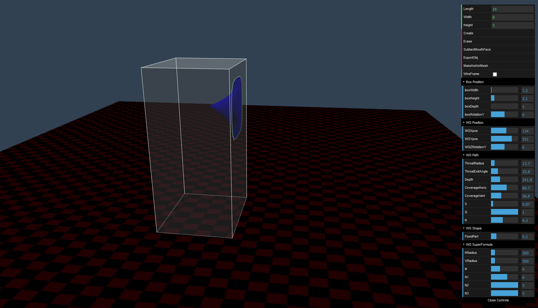

I made an app using BabylonJS.
create the size of room
set speaker box size
set speaker box position within the room
set waveguide position on baffle
set waveguide params
substract the box and waveguide from the room to create the air space.
use HXT compiled with emscripten to create a fine tetrahedral mesh of the air / horn surface interface.
https://gitlab.onelab.info/gmsh/gmsh/-/tree/master/contrib/hxt
apply BabylonJS gpu physics to the tetrahedral mesh
assume box and waveguide are hard rigid surfaces
introduce a vibration on the mouth exit surface
watch the propagation of impulses in slow motion
I'm in the process of creating planes and surfaces to capture the polar data.
Realtime changes. 🙂
I hope to add the woofer cone position and shape too.
