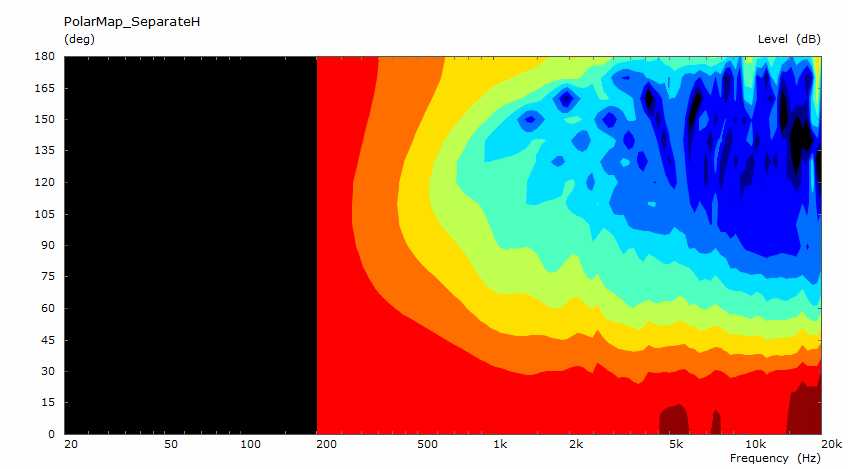

The name mabat gave to the throat plug with channels. External Shaping Plug (ESP).Dumb me, what is ESP?
I assumed you knew. Much has been written by JMLC.The diffraction is not only "distributed", it's also lower, IMO.
It has a weird rising spread after 15k that I can't seem to get rid of.Certainly not bad for a 2" throat.
You GOGO MabatYes, it turns out it's not so straightforward to design a perfect conical horn for a spherical source. It still requires some experimentation. I've been quite busy lately so I can't pursue this further myself. In the meantime, I at least implemented variables into the script "language" so I'll be able to perform some pretty complex optimizations, including the ESP parameters. There's still a lot to be achieved, I think.
