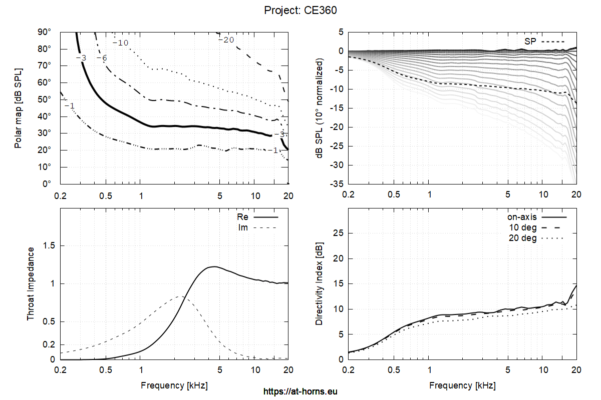

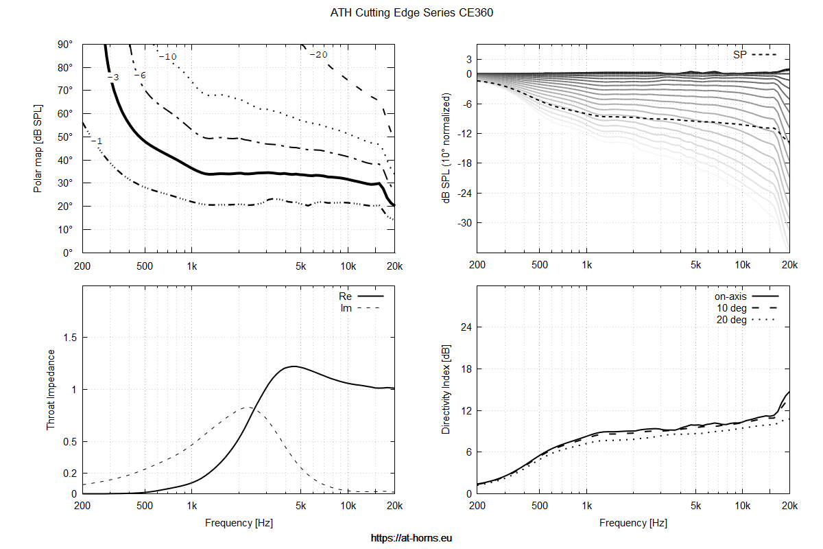

I wonder whether Marcel further changed the configuration vis-a-vis the published one, or whether there is regression in the code between Ath-4.7.1 referenced by Marcel's script and Ath-4.8.0. Regardless, I am rather satisfied with my progress.
There must be some slight change to the script or setting in the officially released CE360 and the one that was used to produce the graph. The Rad Imp and the directivity above 15K are different and it is not due to the Ath versions as far as I can see as I get the same result on 4.7.0 as you do on 4.8.0.
Comparison gif attached

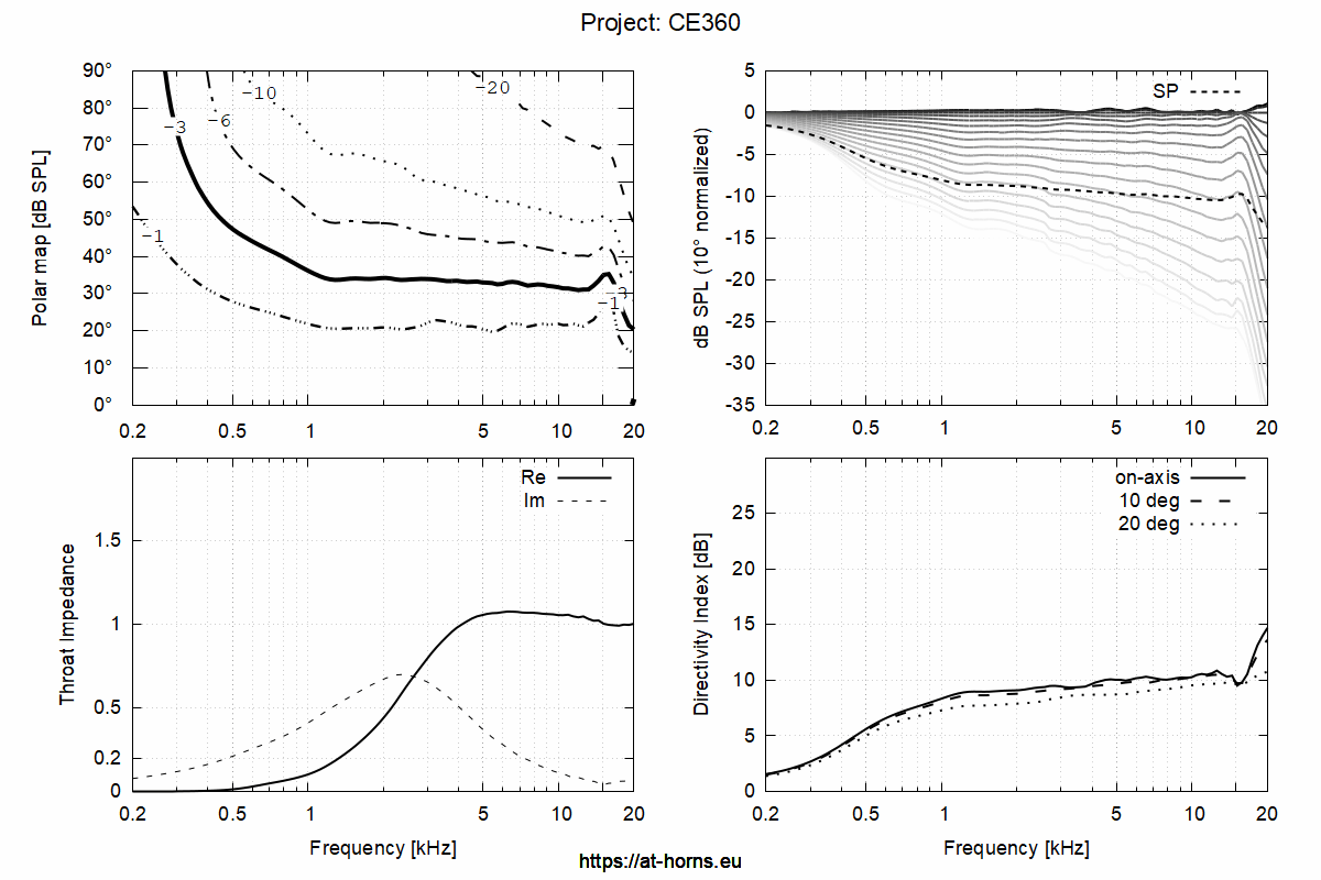

On my website the plots are for a flat source but that also means that the throat angle was set to zero (as is stated there). The published script has a non-zero throat angle, hence the difference. This is something to be adjusted for a driver used, that's not a fixed property of the waveguide. So all the simulations are "correct".
The ABEC.Polars::Offset item is an important one for an infinite baffle case, to not to get behind the baffle plane. In a free-standing case this has much less importance and I doubt it was the real cause. But I don't have an idea what that could be either.
I would not have guessed this to be the reason as in many previous simulations I did not notice a big difference but it is obvious here.
In case it wasn't clear my post was not meant to suggest an error, just a point of difference that was not due to the Ath version used.
I was not referring to anyone's post in particular, I just wanted to clarify the matter. The differences are due to different throat angles.
BTW, when simulating for a non-zero throat angle, the source shape probably should be set to spherical (Source.Shape = 1) as the best bet, but I'm still not quite sure. Without a real wavefront model this is just a game anyway.

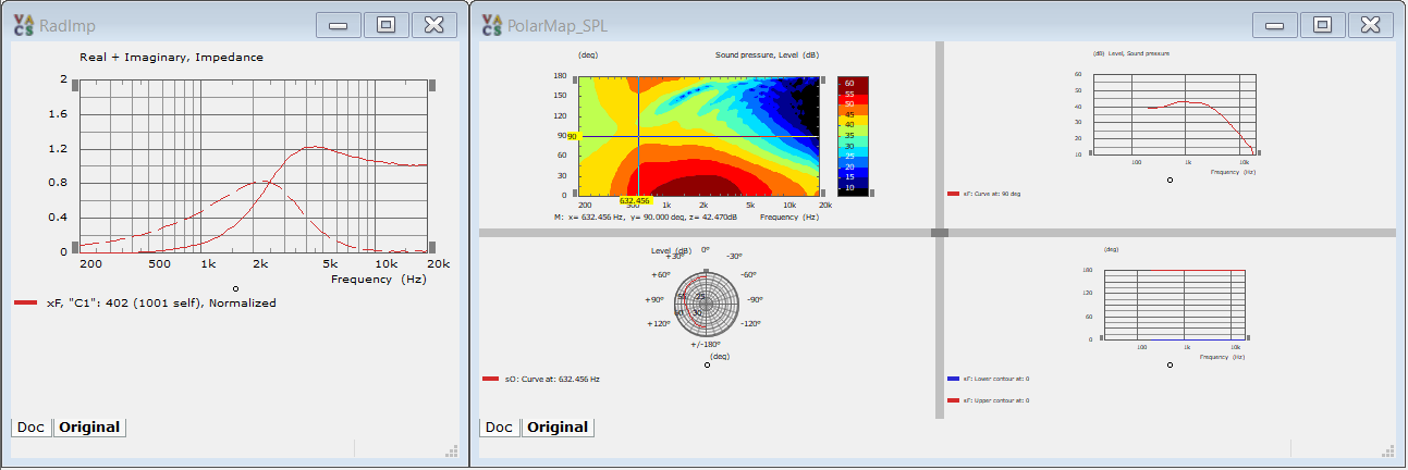

so why, if one omits both the Normalization and the Offset for free standing wave-guide, the SPL is not depicted?
That only seems to be the case for you, I am not sure what is going wrong.
This is the line I have in my configuration file to generate polar data, no normalization and no offset, works fine as attached

thank you for your attempts to help. Could you please do me a favor, download the configuration file M_80.cfg from post # 9,066 comment out the Normalization and Offset by semicolons and execute it? I have just tried, and again obtained the SPL spectra as in post # 9053.

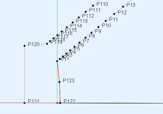

You can display both node and element IDs in ABEC visualization (Views->Structure->Nodes, Element indices) so you can orient yourself (it also helps to switch-off the Symmetries). It really is simple - the nodes are defined as "<node_id> <z_mm> <r_mm>" and the elements as "<element_id> <node_id_1> <node_id_2>":
Nodes "Nodes"
Scale=1mm
1 0.000 12.700
2 0.423 12.728
3 0.916 12.773
Elements "SD1"
RefNodes="Nodes"
Subdomain=1
1 1 2
2 2 3
Hi Marcel,
thank you for the visualization. I have a false impression that I start to understand. Looking at the picture:
the nodes P122, P123 are approximating the source, correct? But, what is the purpose of the nodes P120, P121? Could the node 121 be omitted and and node P120 lie on the x-axis directly below the node 119, that is on a line parallel to the y-axis?
P120 and P121 are there to represent the space a compression driver would take, you could, leave them out and go straight back to the zero line.
