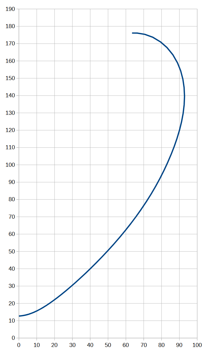

What might be appreciated by many, I think, is if someone devised a simple direct way of calculating a smooth rollback. Obviously the OS-SE formula itself doesn't allow that as a function y=f(x). We would need to go parametric ([x,y] = [f(t), g(t)]).
I could publish my rollback algorithm but that's just a quick&dirty way of utilizing the discrete profile representation I have inside Ath. I'm not sure it would be universally useful. The basic idea is to smoothly increase curvature along the profile, whatever that may be.
With just the OS-SE and an infinite baffle, you're still only half way there...
As a first step we could take an existing profile curve with rollback (e.g. the CE360) and plot its x(t), y(t) components as functions of length along the curve. That could show us what's needed, perhaps something easier to work with than the Fresnel integrals...

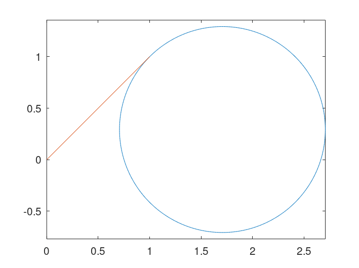

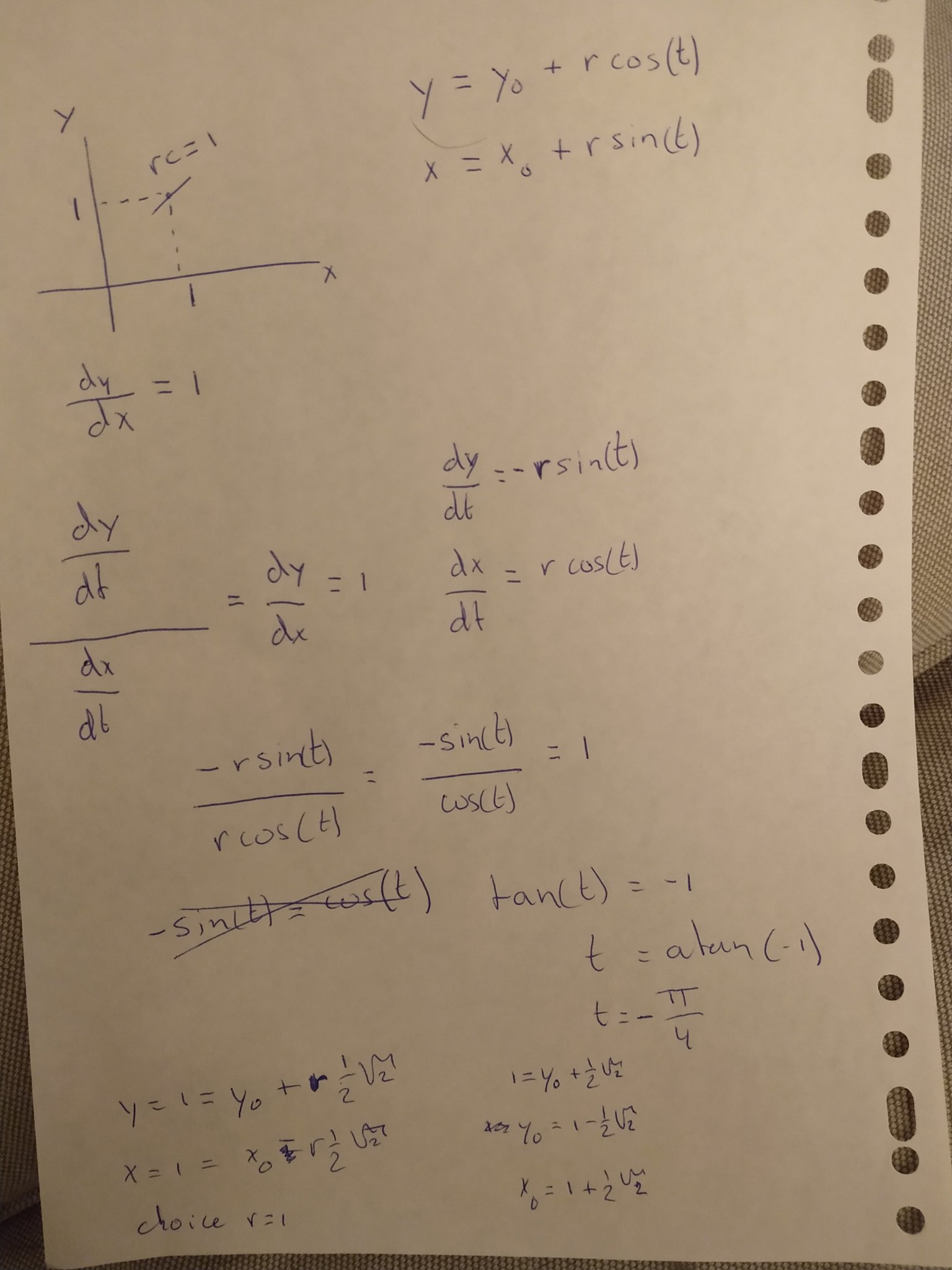

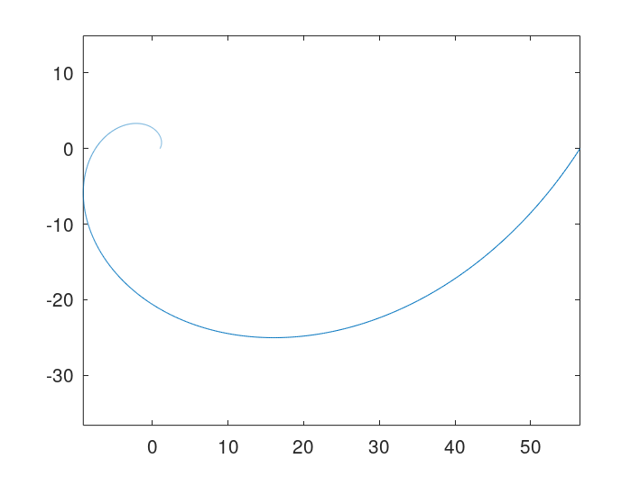

I assume the first part is OS. What are f(t) and g(t) (generally, before matching) for the second part?
I'll give it a go. No guarantees though 🙂
I don't have enough information to answer the question directly. So I'll use all degrees of freedom to get the discussion started:

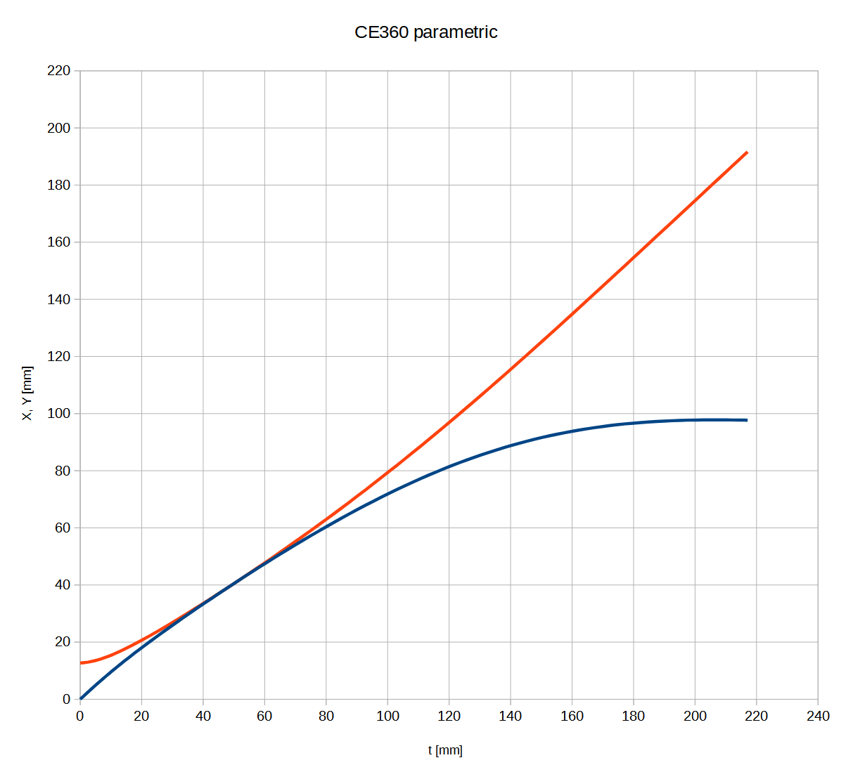

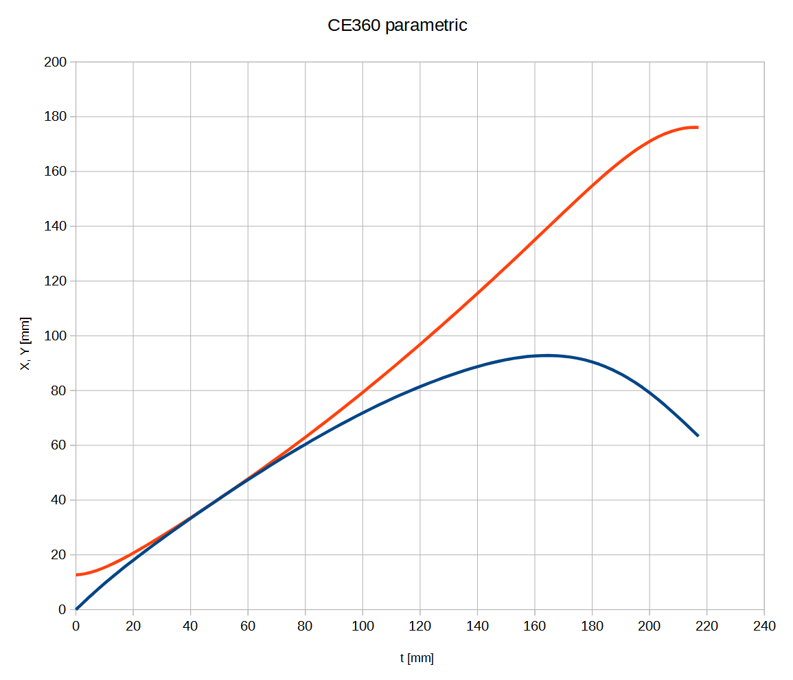

This is what I meant - these are the x(t) and y(t) functions for the CE360 profile, i.e. including the rollback (t=length along the curve).
One would need to construct these two functions as some convenient (analytic) approximations.
- Maybe some sines and cosines would do 😉

Well I have all I need. I just thought it might be occasionally handy to have a complete profile with rollback in a form of some easy-to-use, parametric analytical description. Of course polar coordinates would work too.
But I guess it won't be so easy.
Looking at the picture #9,154, the red curve could be a blend (weighted average) between two hyperbolas and for the blue curve a somehow skewed parabola could do. I might try after all. I just thought that for someone mathematically inclined here this could be a challenge. Remember the equations could bear your name (if they were pretty enough) 🙂
