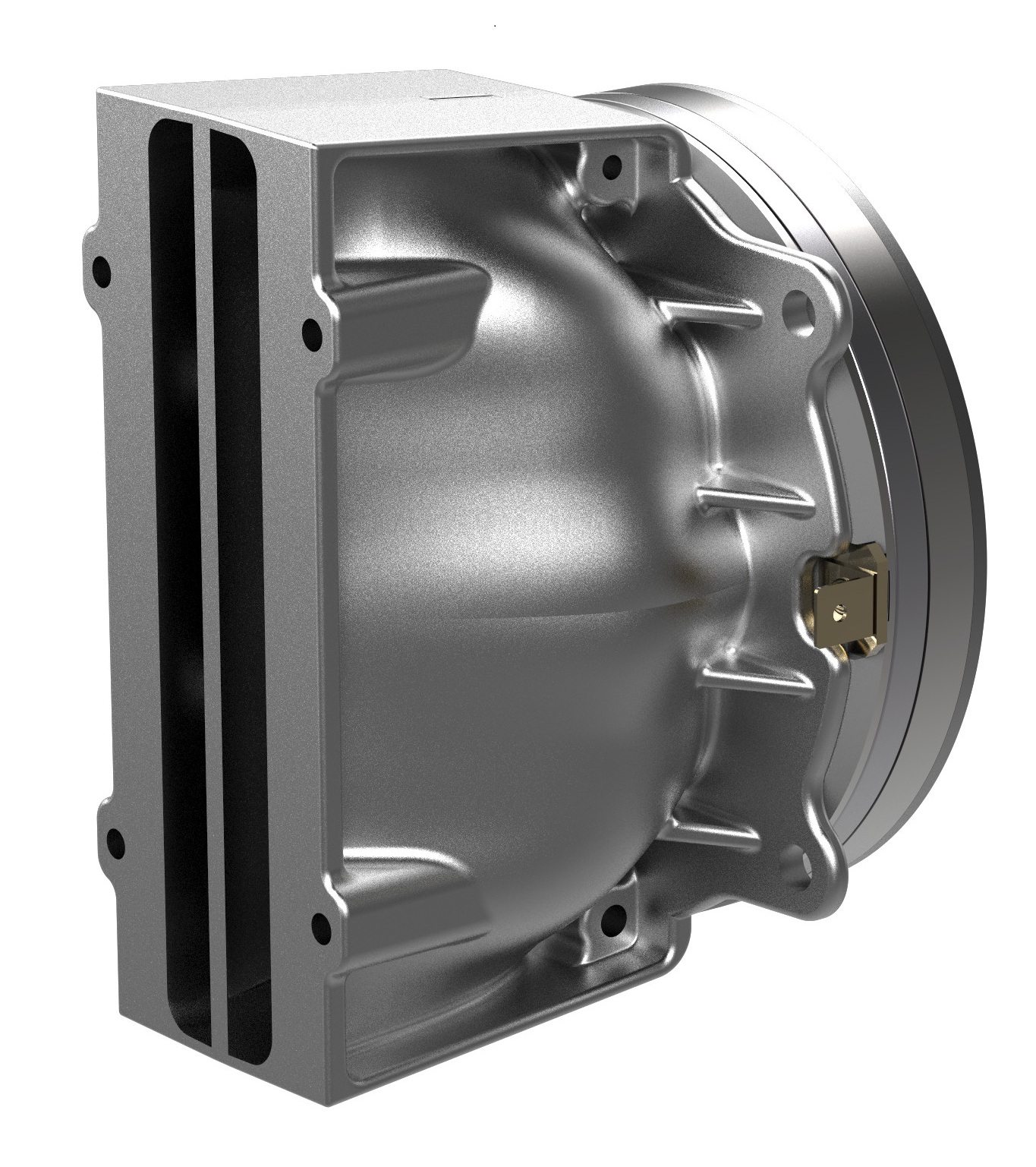

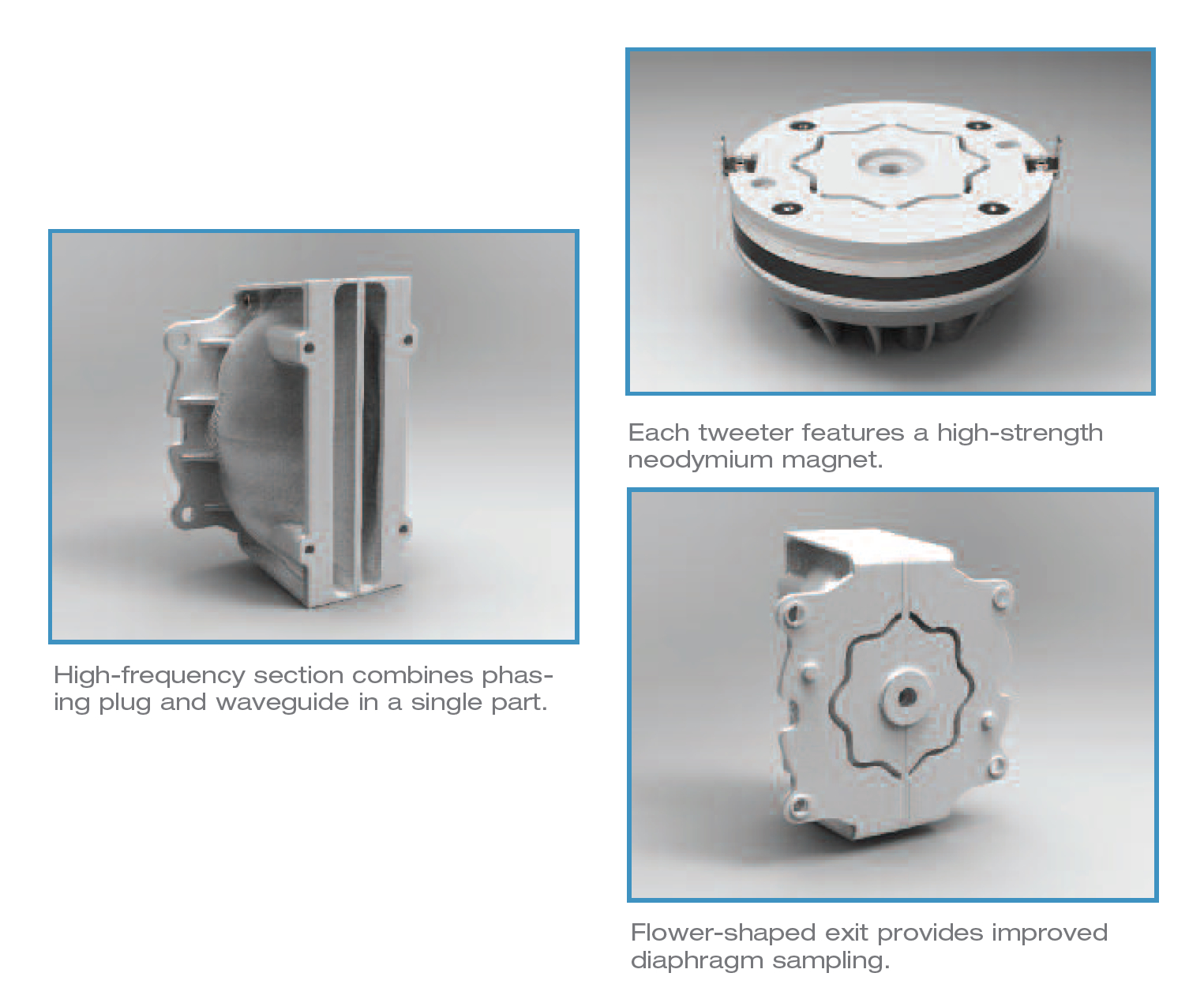

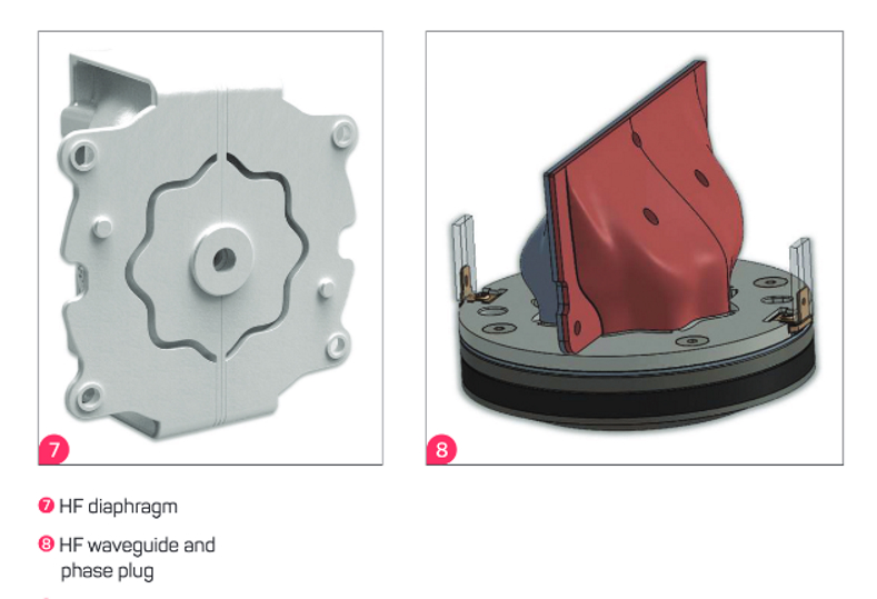

Here's the driver with "flower-shaped" exit and the phase plug of the JBL line array waveguide. These are parts of the VTX A12.

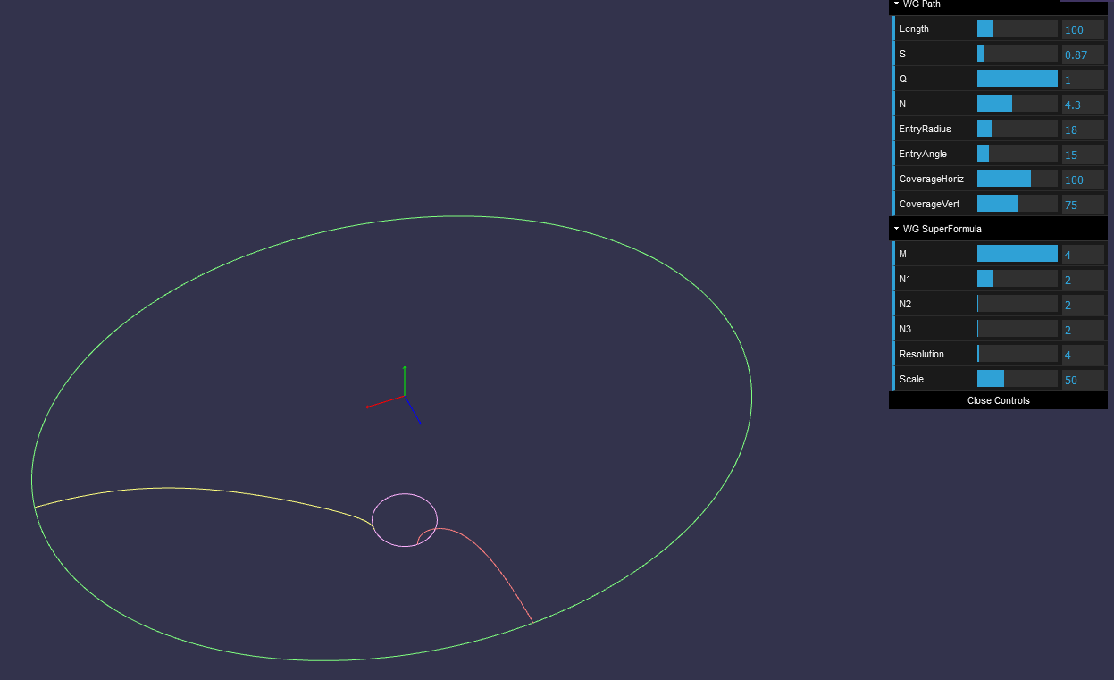

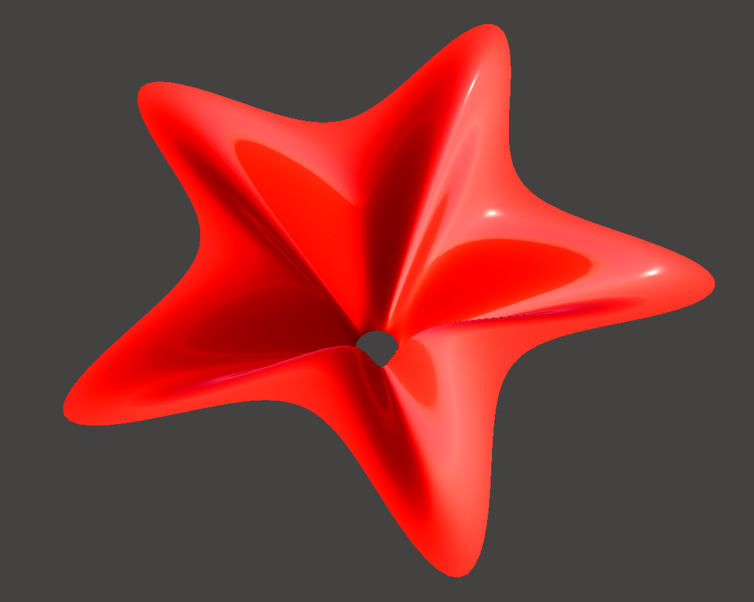

Superformula!
OK, now the fun may begin. So far the only shape-curve (see the documentation) available was a superellipse. From now on it is possible to define a superformula (see wikipedia).
See also Example 22 | Superformula Shape | Super-formula Plotter for examples of various shapes - you will need to understand this.
The definition in the script file looks like this (the numbers for SF are: a, b, m, n1, n2, n3):
ShapeCurve = SF
SF = 2,1,4,8,12,12
SF.Rot = 0
The absolute size of the shape-curve is computed from Coverage_Horizontal and Depth.ConicSectionPart. This sets the width of the shape curve which is scaled so that just fits this dimension. Parameter SF.Rot gives an arbitrary rotation of the mouth if needed. Attached are two demo scripts. The only limitation for now is that for ABEC simulation you need quarter-space symmetry. I yet have to implement full mesh export (and it will take a heck of a time to run those sims). Eventually you can still use the "raw2rect" parameter to make the mouth rectangular (and force the symmetry where it makes sense).
The download: www.at-horns.eu/release/ath-4.4.1.zip
Would it be possible to get other than quarter-space symmetry? Let's say you make the 5-pointed horn you show, then you could use 1/10-space symmetry.

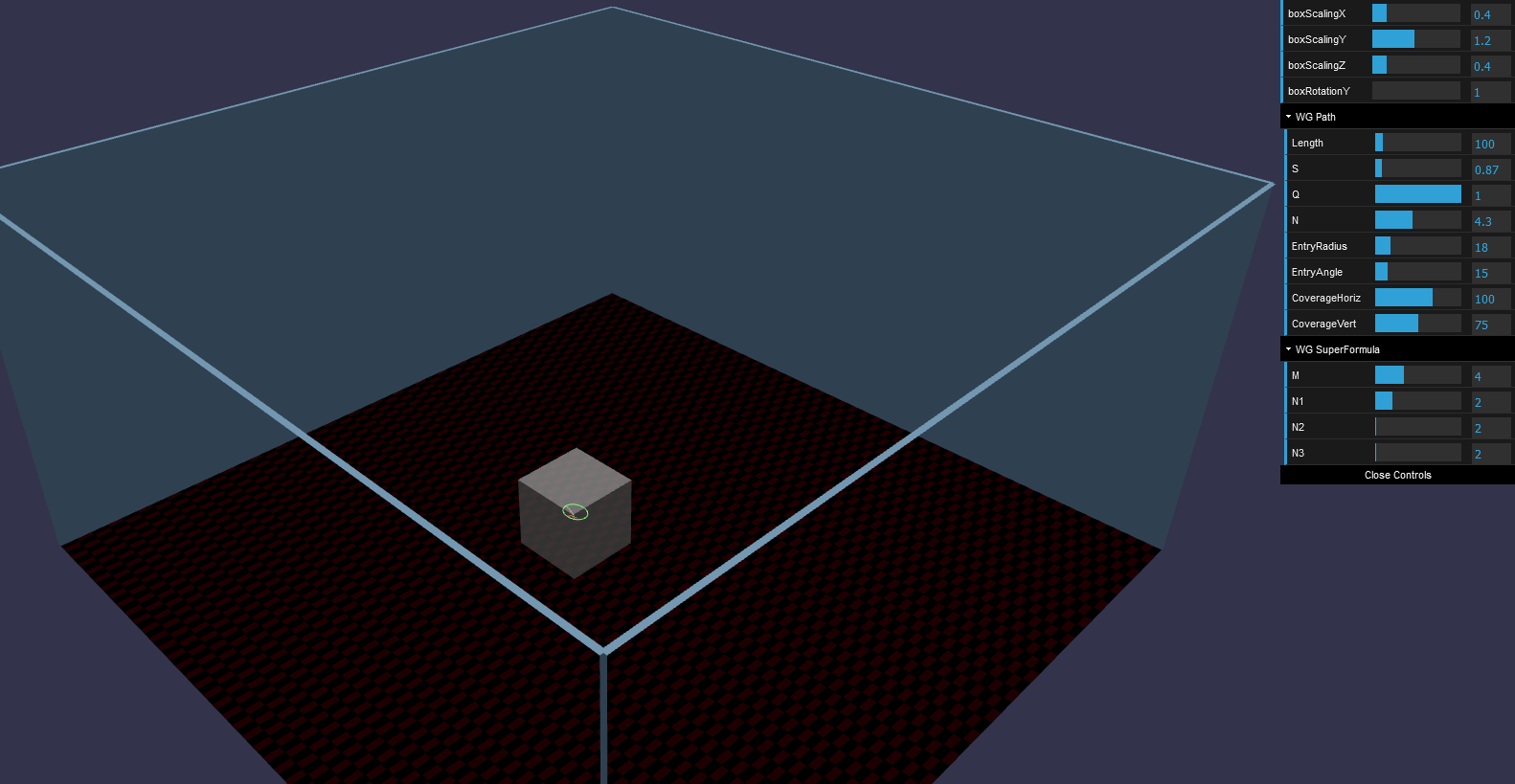

Well - setting up the 'test room'. Can drag the enclosure around the room and up and down the walls too.
Working on
i). moving horn throat position in 3D space
ii). update Mabat profile curves accordingly
iii). box radius/chamfer
iv). port hextreme
v). physics stuff
