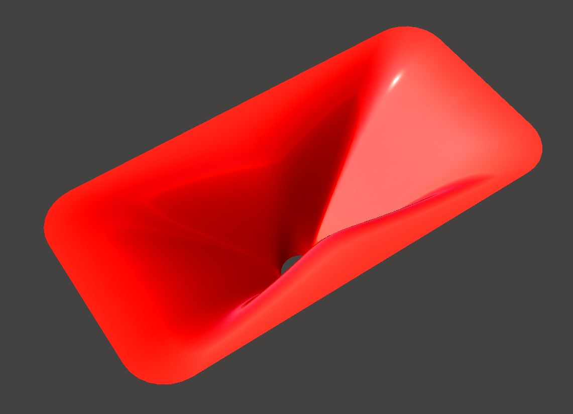

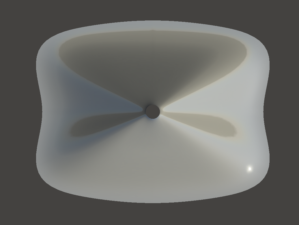

OK, now the fun may begin. So far the only shape-curve (see the documentation) available was a superellipse. From now on it is possible to define a superformula (see wikipedia).
See also Example 22 | Superformula Shape | Super-formula Plotter for examples of various shapes - you will need to understand this.
The definition in the script file looks like this (the numbers for SF are: a, b, m, n1, n2, n3):
ShapeCurve = SF
SF = 2,1,4,8,12,12
SF.Rot = 0
The absolute size of the shape-curve is computed from Coverage_Horizontal and Depth.ConicSectionPart. This sets the width of the shape curve which is scaled so that just fits this dimension. Parameter SF.Rot gives an arbitrary rotation of the mouth if needed. Attached are two demo scripts. The only limitation for now is that for ABEC simulation you need quarter-space symmetry. I yet have to implement full mesh export (and it will take a heck of a time to run those sims). Eventually you can still use the "raw2rect" parameter to make the mouth rectangular (and force the symmetry where it makes sense).

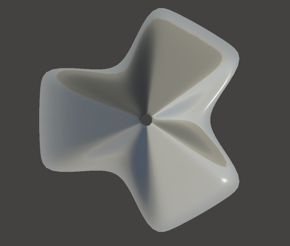

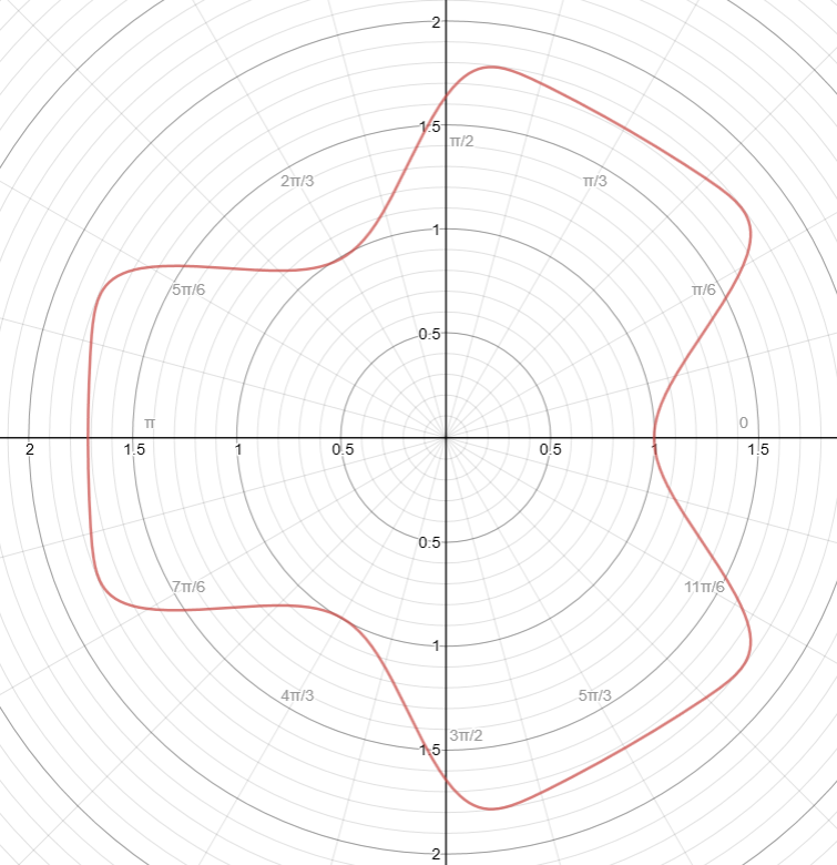

Just a picture taken from wikipedia to give you some basic guide for the SF numbers (m, n1, n2, n3). With a, b you basically set the width/height ratio here, not the absolute size (as explained above).
I imagine the second shape will be the most useful.

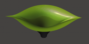

With these "DNA" arrays that I like to build, the reason that they work is basically because they're asymmetrical on the X and the Y axis.
IE, in a conventional D'Appolito array, there will be off-axis nulls at predictable frequencies, and the nulls are caused by pathlength differences. In particular, when the pathlength of two woofers is 180 degrees out of phase, you get a deep null.
So, the DNA array is an elegant solution: NONE of the drivers share the same X or Y axis, hence the smoother response.
But once all of that made sense, it hit me that another way to implement the DNA array would be to simply use an odd number of drivers in a ring. Five drivers in particular is an attractive number. It allows for spacing that's nearly as tight as four, and no driver shares the same X or Y axis. But it requires an oddly shaped waveguide...

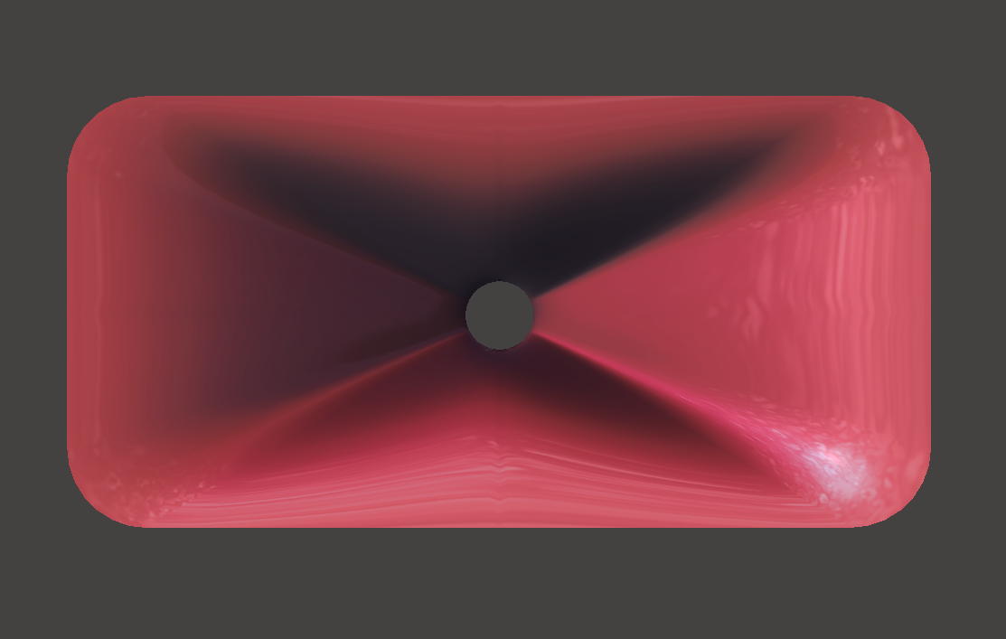

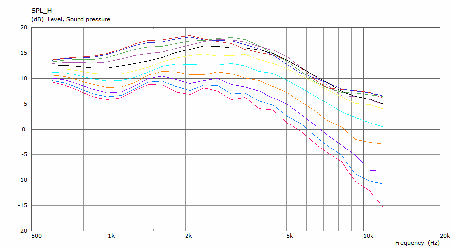

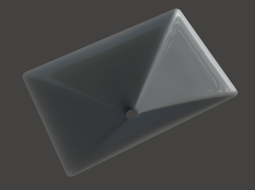

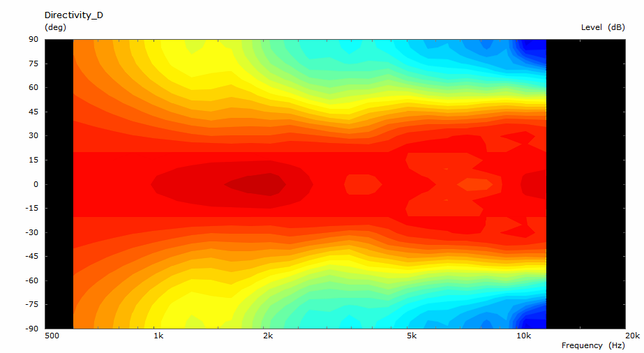

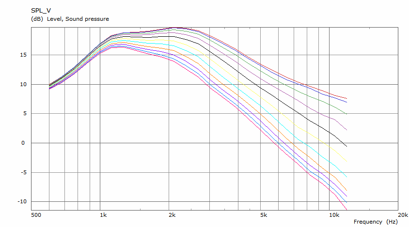

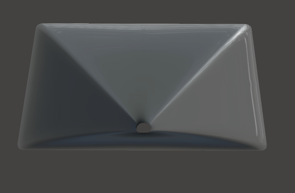

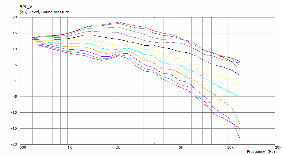

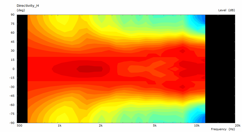

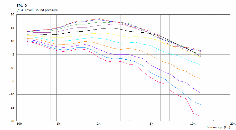

Another one tested, almost straight sides - such shape is still of reasonably constant directivity but obviously the sharp mouth edge make it less clean (diagonal polars included).
(Approx 36 x 24 cm)
We can do much, much better now.
(Approx 36 x 24 cm)
But along alpha angle there will still be nulls.
The five drivers is a good idea.

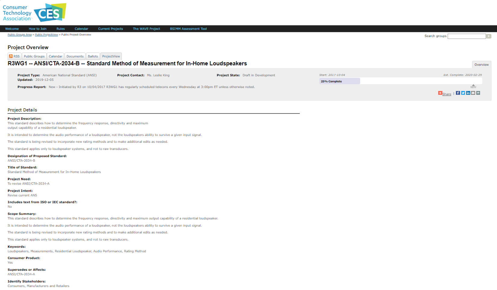

You can't, Project R3WG1 (ANSI/CTA-2034-B) is still a work in progress.
The current standard "2034-A" is attached, as well as some related documents.
Standard Method of Measurement for In-Home Loudspeakers_ANSI-CEA-2034-A_Small.pdf1.2 MB · Views: 213
Fast Loudspeaker Measurement in Non-Anechoic Environment.pdf719.1 KB · Views: 268
