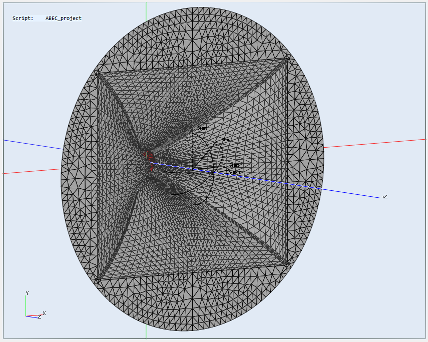

When you do this, you wind up with a waveguide that's so close to the M2 waveguide, it makes me wonder if this is what JBL was doing:
Here's a comparison between a waveguide I generated with Mabat's software, and the M2 waveguide.
Here's how this works:

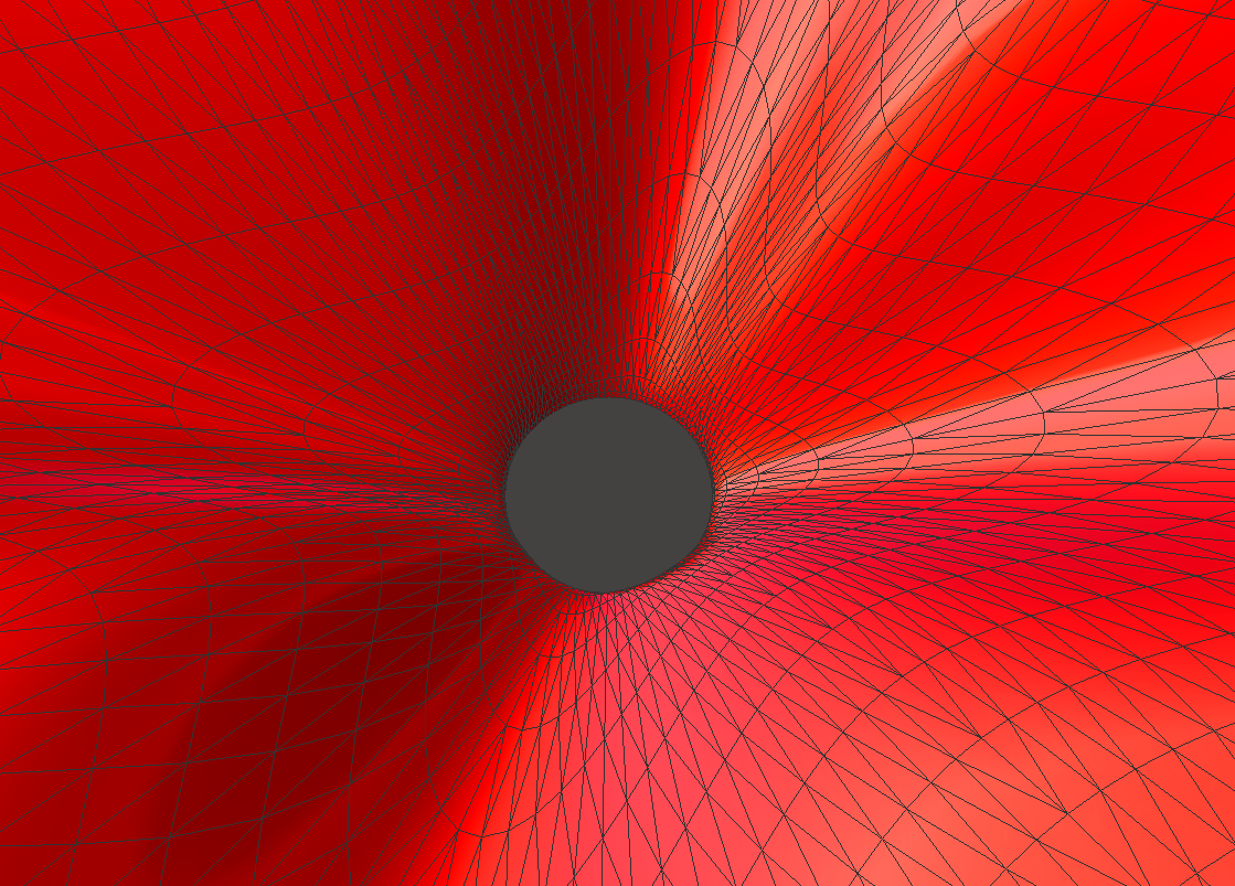

In Mabat's original software, you can 'morph' from a circular throat to a square, circular, elliptical, or rectangular mouth. This led to waveguides that look very similar to oblate spheroidal.
In Mabat's new software, you can add a shape in between. For instance, you can go "circle" to "x-shaped" to "rectangular."
Here's the config file I used to generate this waveguide:

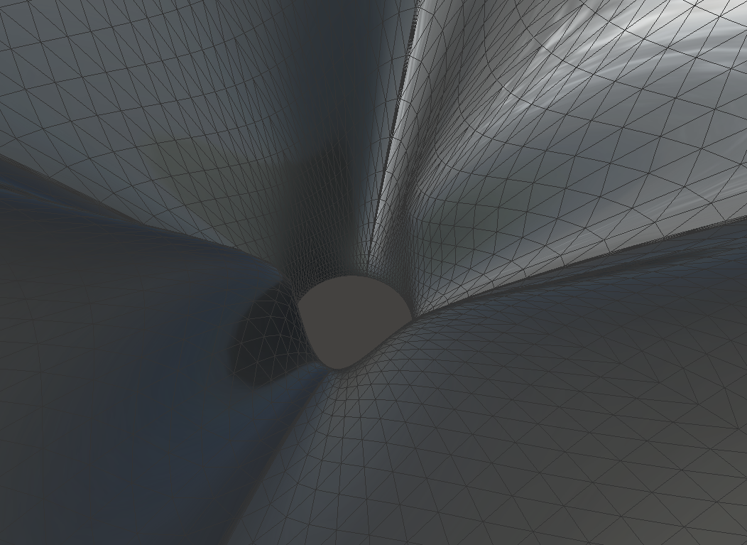

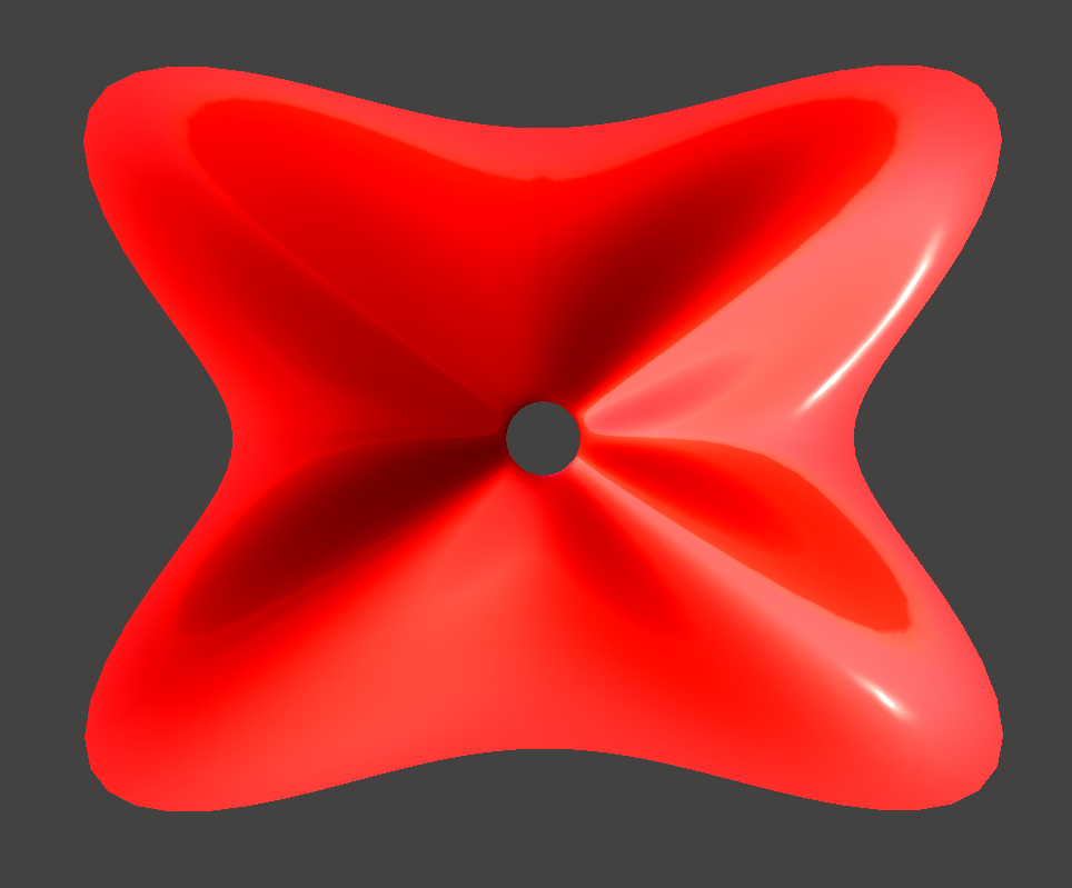

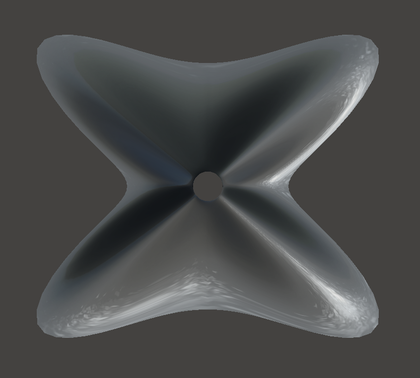

BTW, this is the original shape that was morphed (see below). It has the property of having a smoothly terminatd OS profile everywhere. It is not an OS WG because it is not circular but it has the same profile everywhere you would cut it through the axis. That's the whole idea behing this tool. By morphing to rectangular it looses this property, at least in the part that becomes morphed - here it is 50% of the depth from the throat that stays fixed (Shape.FixedPart=0.5) - the rest is gradually transformed.
Simply put, this tool connects circle at the throat to an abritrary mouth curve by (smoothly terminated) OS profiles.

By making the parameters "SE_*" functions of an angle around axis (now they are set once for all directions), the flexibility would further increase considerably. That's what I'm working on now. That will unleash your creativity 🙂

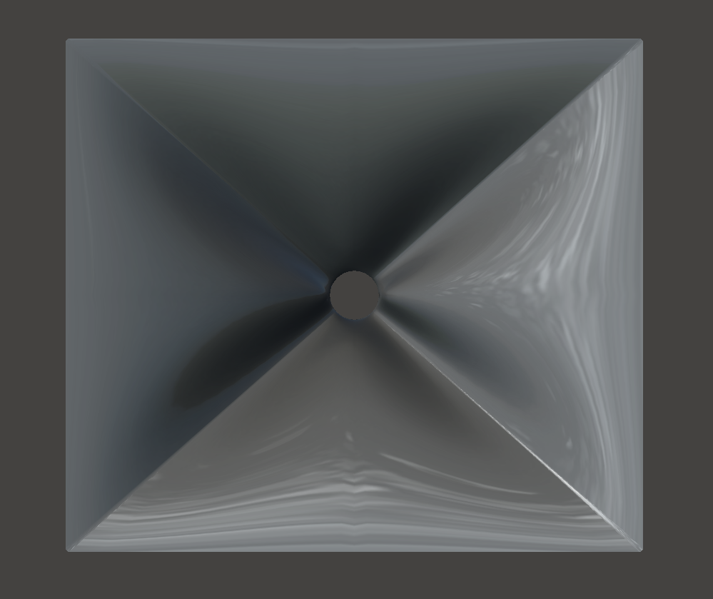

M2 contest

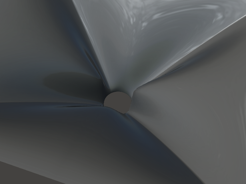

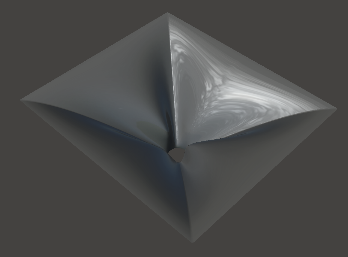

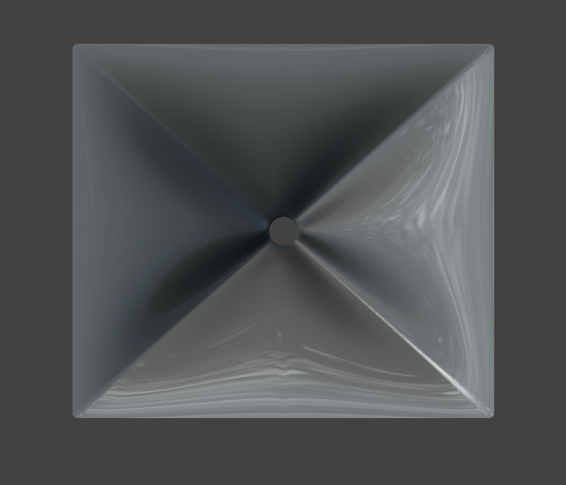

This should do the trick:
ThroatDiameter = 33 ; [mm]
ThroatAngle = 0 ; [deg]
Coverage_Horizontal = 40; [deg]
;Coverage_Vertical = 40 ; [deg]
Depth = 114.3 ; [mm]
SE_s = 0.7
SE_n = 4.0
SE_q = 0.995
Depth.ConicSectionPart = 0.6
Shape = raw2rect
Shape.FixedPart = 0.25
Shape.CornerRadius = 2.5 ; [mm]
Shape.StretchExp = 1.5
ShapeCurve = SF
SF = 0.88,0.65,4,0.66,9.2,1.73
SF.Rot = 0
; Mesh Setting
Mesh.AngularSegments = 120
Mesh.DepthSegments = 28
Mesh.LipSegments = 6
Mesh.CornerSegments = 4

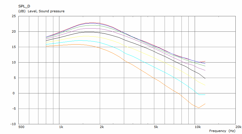

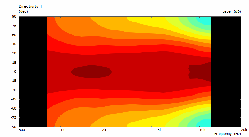

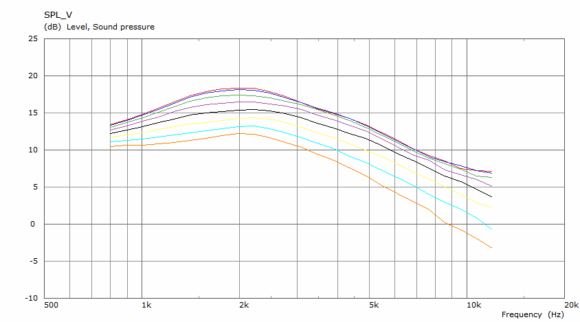

'Shape.StretchExp' plays a crucial role here. The default is 3 which makes too gradual morphing in this case. It wants more abrupt deformation at the "knuckles". The depth of those is set by 'Shape.FixedPart'.

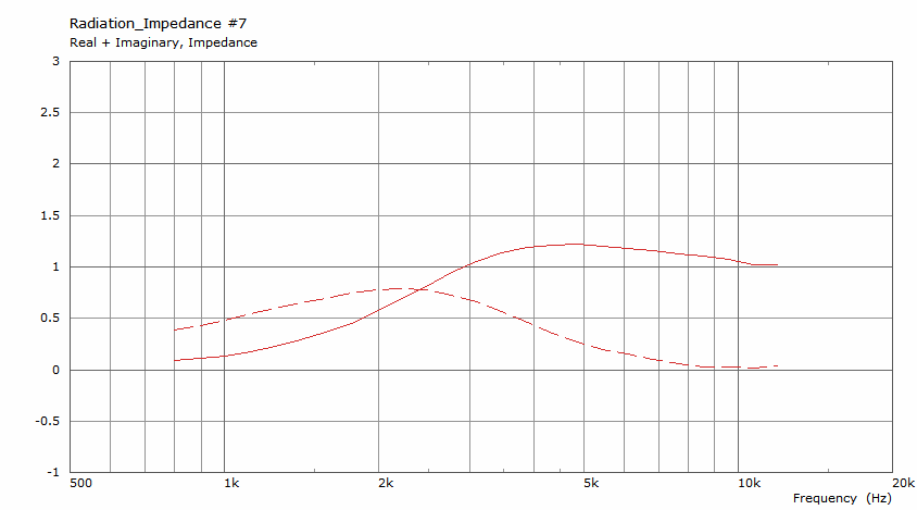

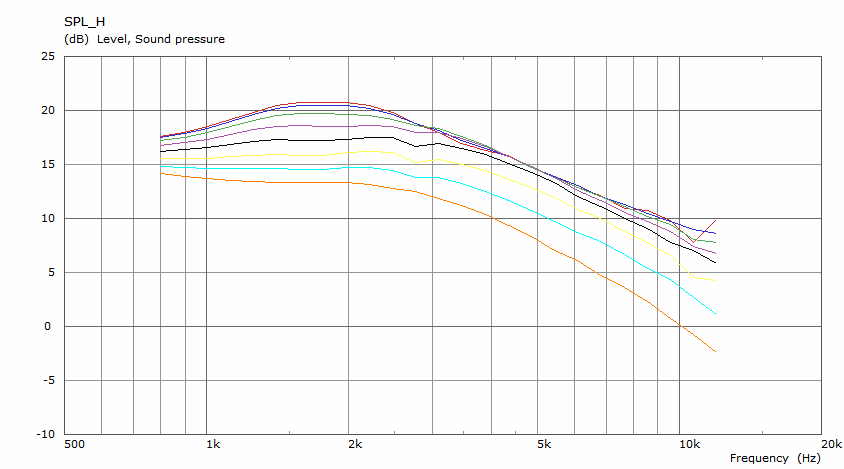

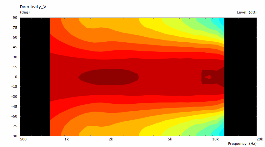

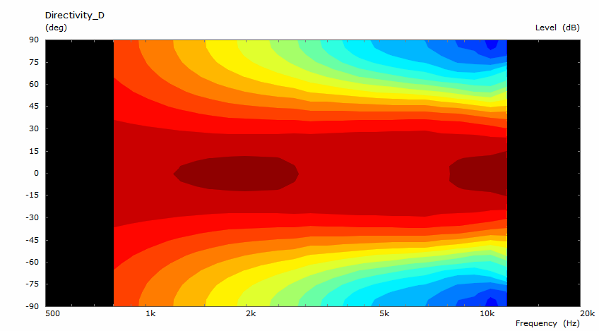

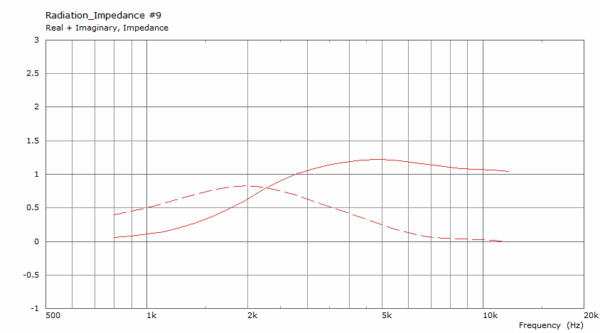

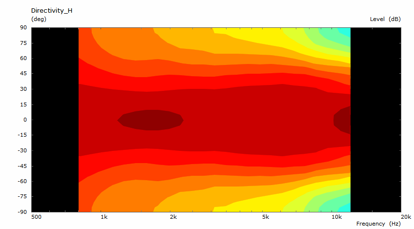

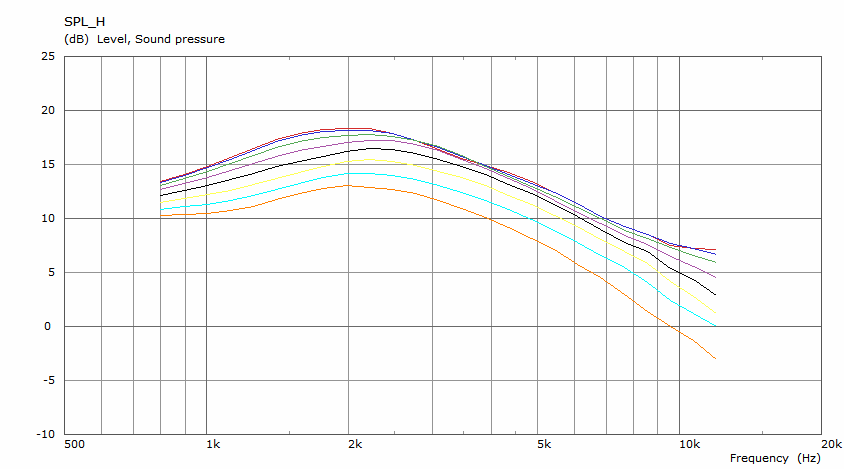

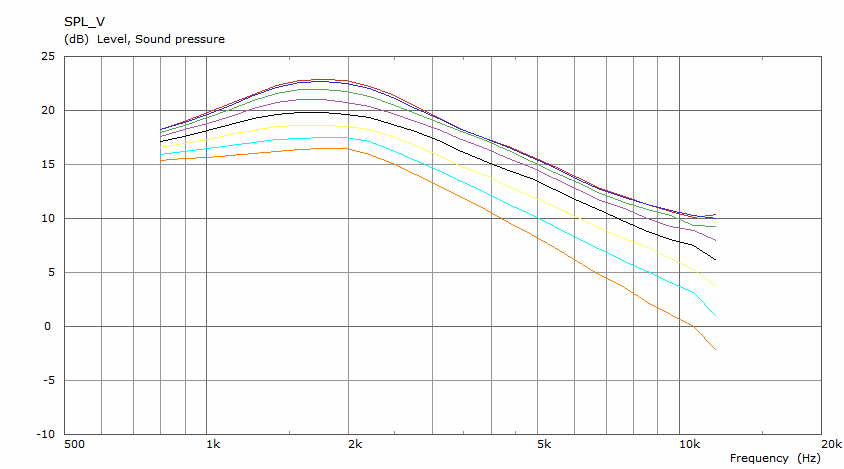

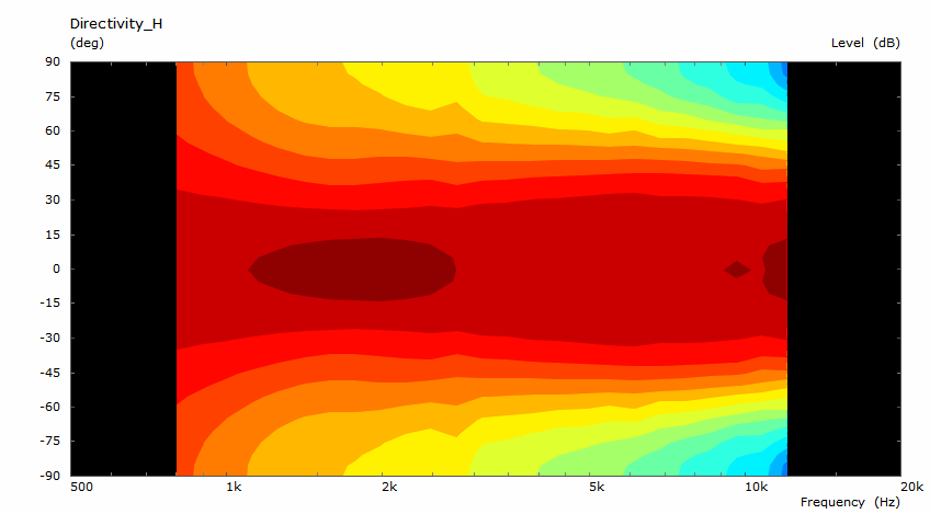

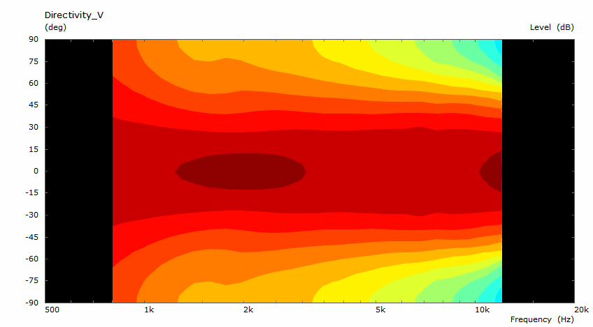

ABEC results -
(2 dB per color division; polars à 7.5 deg@2m)
Size of the horn is 340 x 302 mm, throat diameter 33 mm. Not bad at all but I'd say we have seen even better.

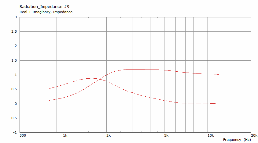

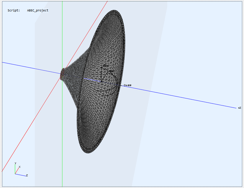

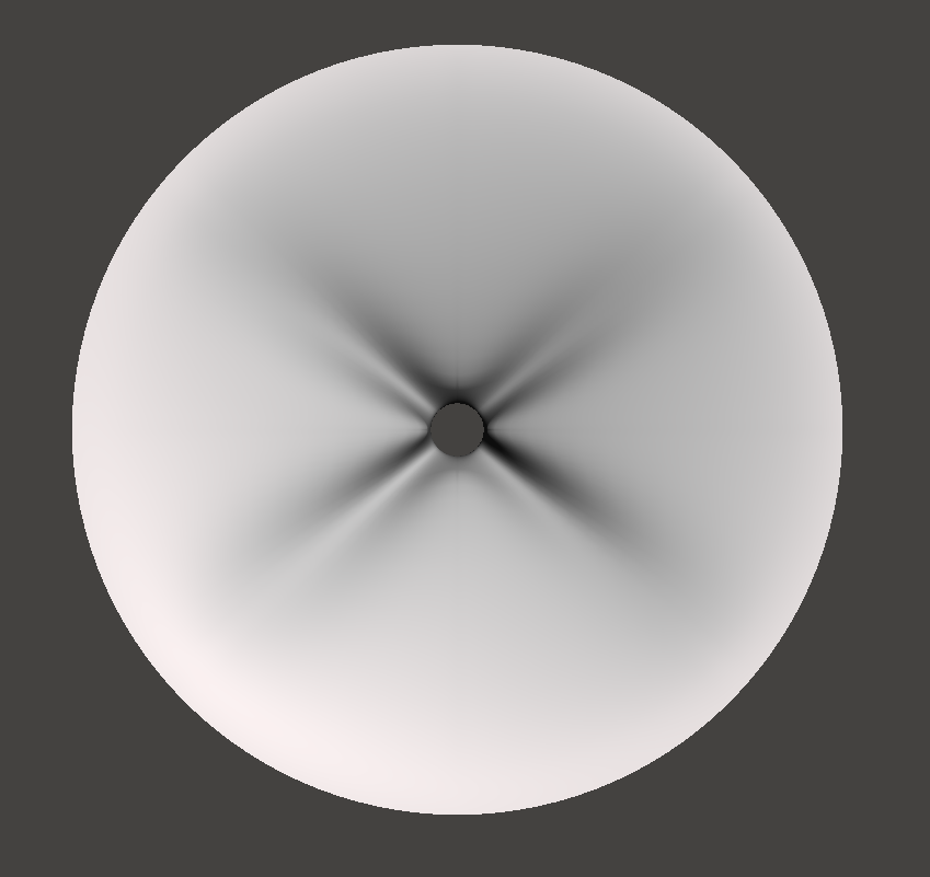

To stay in context, this is an OSWG of the same throat, about the same size and coverage (380 mm / 105 deg), everything else equal -
It's actually wider above 10 kHz. There's more pronounced narrowing in the midrange in the case of circular WG, as we already saw several times -that's where the rectangular mouth seems to come handy.
