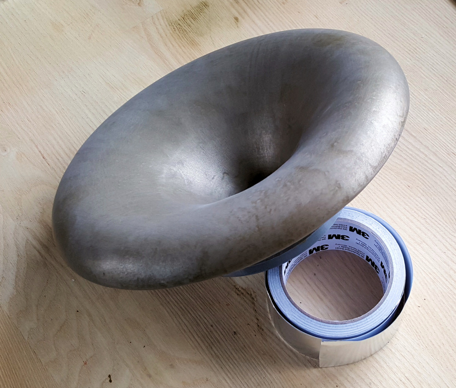

- Working on the old brass finish of the ST260. Not easy 🙂

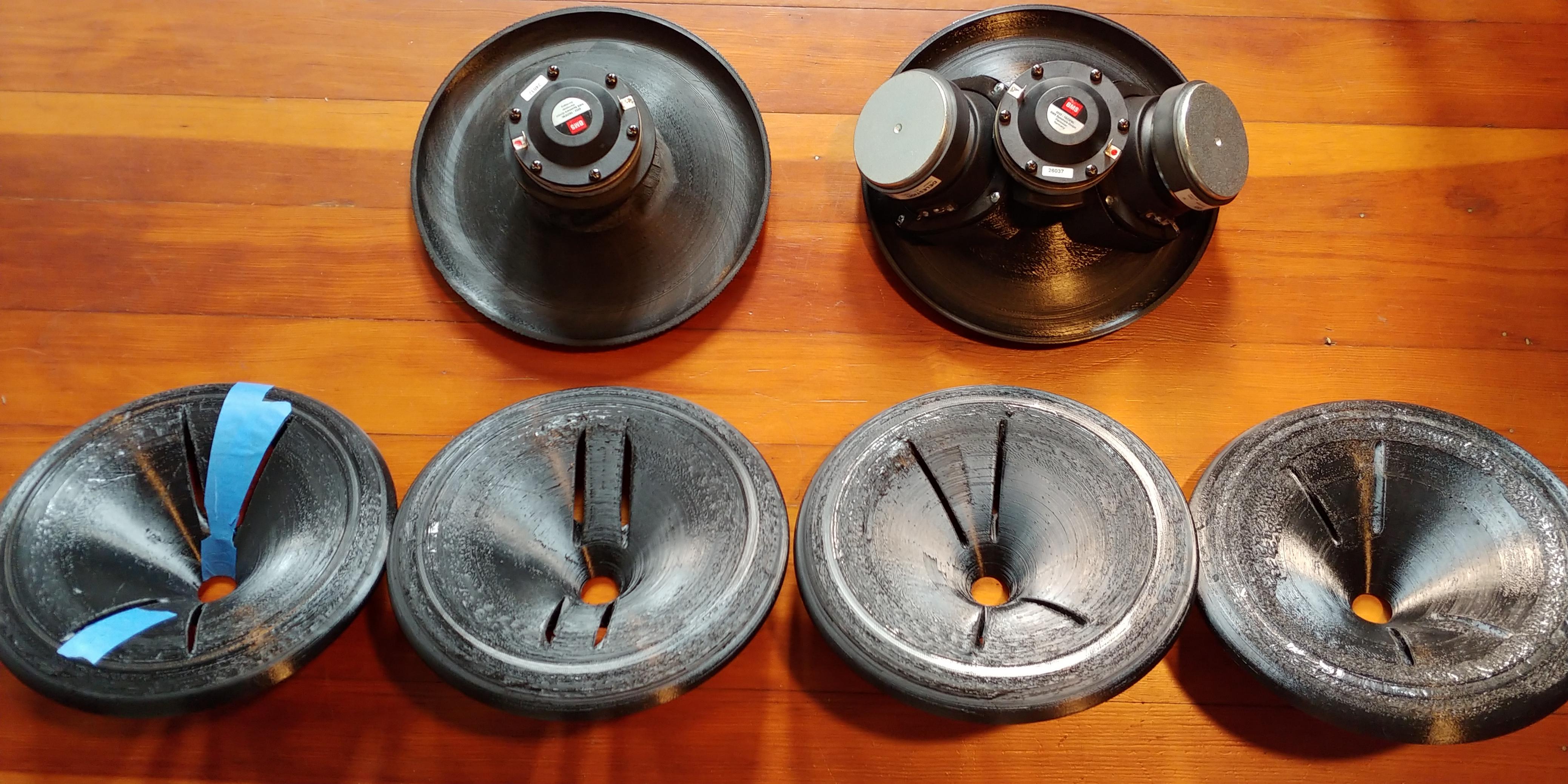

This is my 5th printed revision since downloading the file in ~mid April. This is the smaller, technically ST252, version of the ST260-30.
These are all printed in one piece facing down. I put little to no effort into cleanly removing support materials, hence the ugly. Will probably print final versions face up to make finishing easier. Loving mabats brass finish!
Very influenced by PatrickBateman (stolen perhaps?) on the slot port idea.
First attempts yielded poor midrange response shape and too much impact on the tweeter polars. Came up with a port layout that didn't muck tweeter polars up too badly and crash coursed on Hornresp MEH usage to solve the midrange response problems I was seeing.
This 5th version may be final but I won't get to taking polars until next week.
