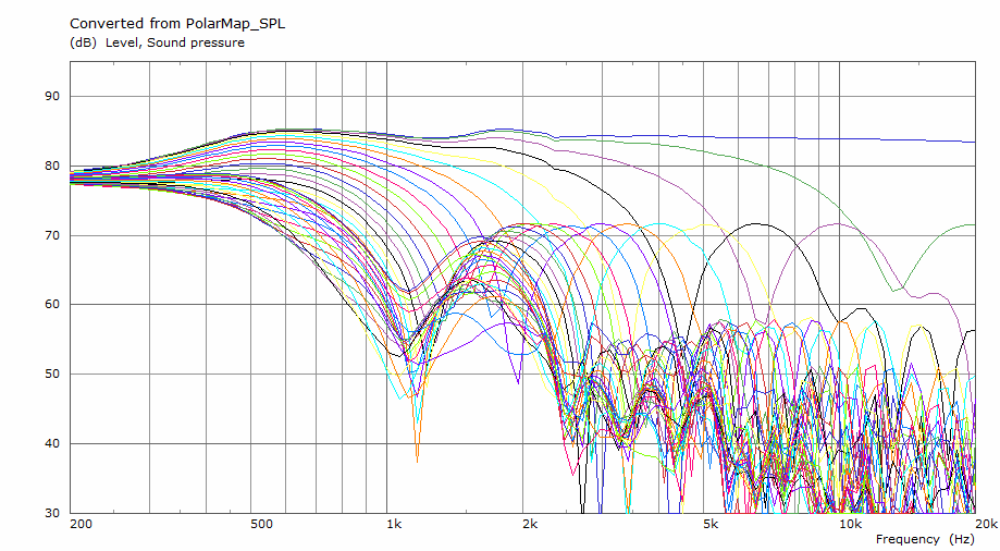

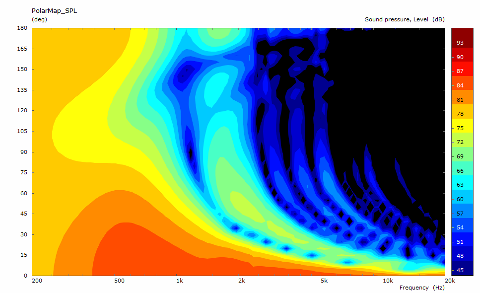

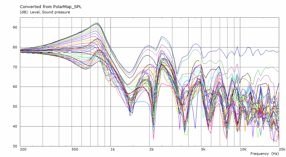

The design is based on a 300 mm diameter 1.4" exit waveguide anticipating use with HF1440. Crossover to the 4 or 8 front 5" mid woofers is at 700 Hz. There are additional 4 or 8 side woofers that provide cardioid response down to just over 100 Hz. There, the side woofer contribution is brought back in sync with the fronts to extend the low end responnse where it is excursion limited.

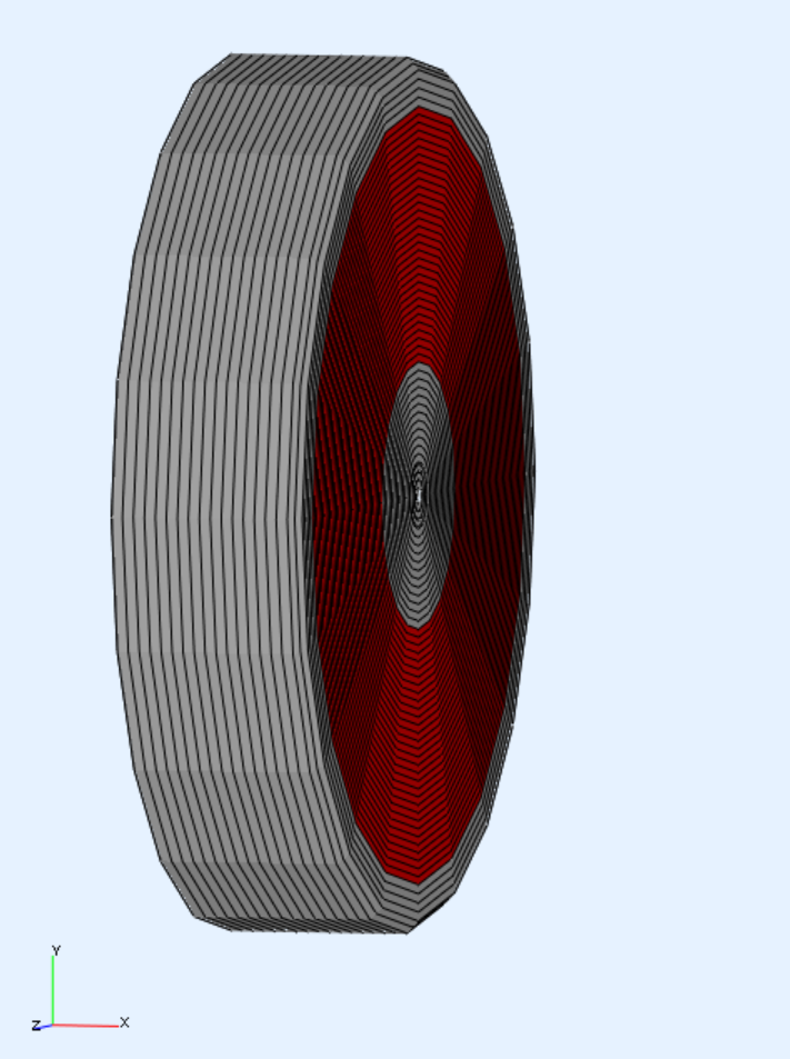

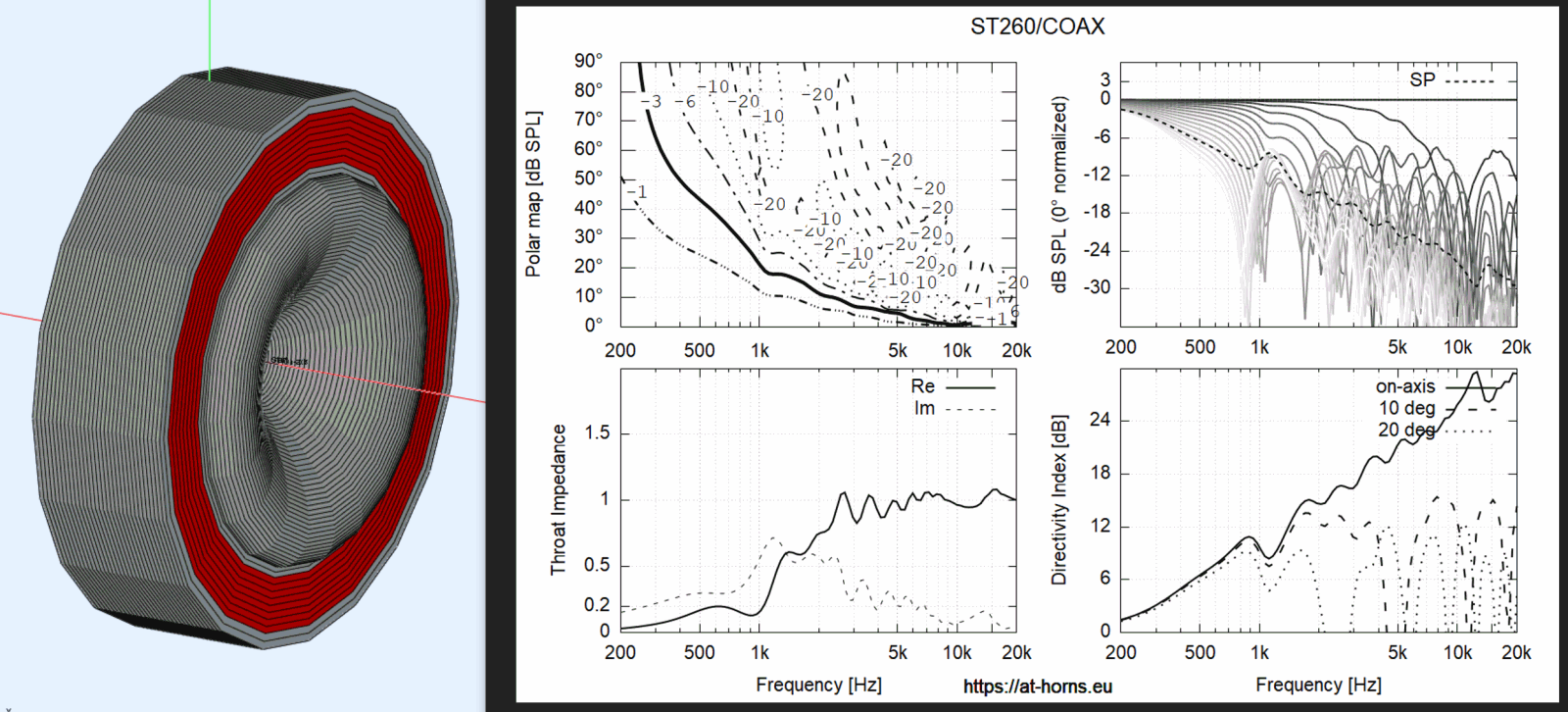

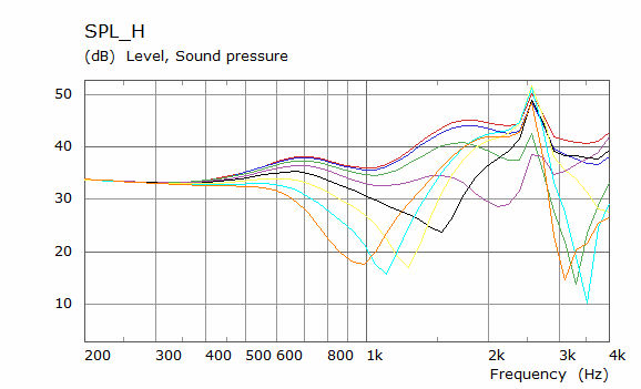

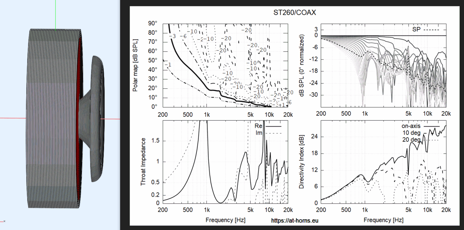

Here's just a quick simulation using an actual waveguide body considered. It's not the same as several discrete transdurers but at least axisymmetric (acoustic source is the red area) -
Seems like ~ 800 Hz would be the limit, which would fit nicely.

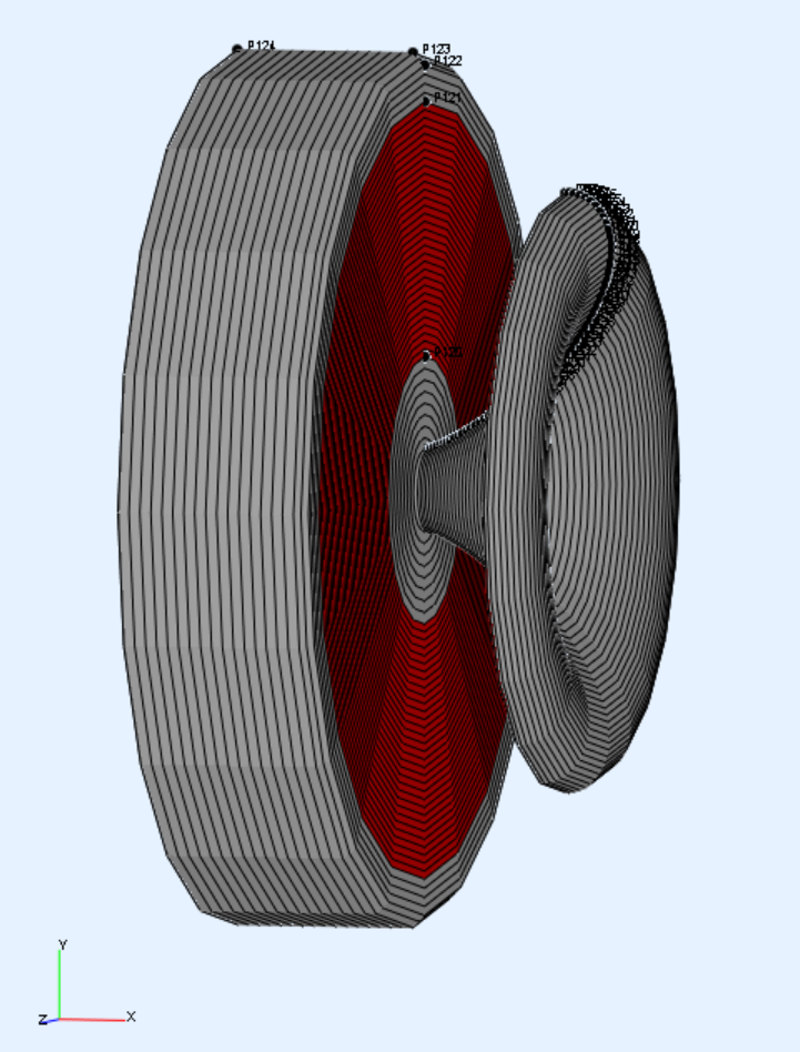

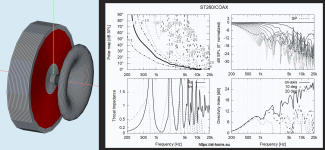

Moved the waveguide closer to the wall -
I don't think it has any advantage. Certainly that's not how I would do it - too many small speakers spaced too far away from the CD. The acoustic integration would be unnecessarily difficult (especially in a passive crossover), IMO.

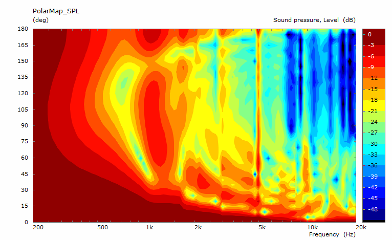

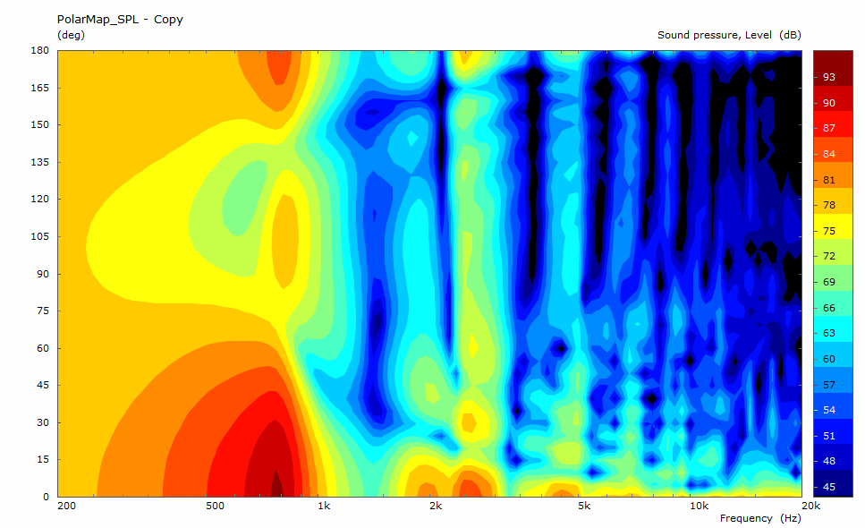

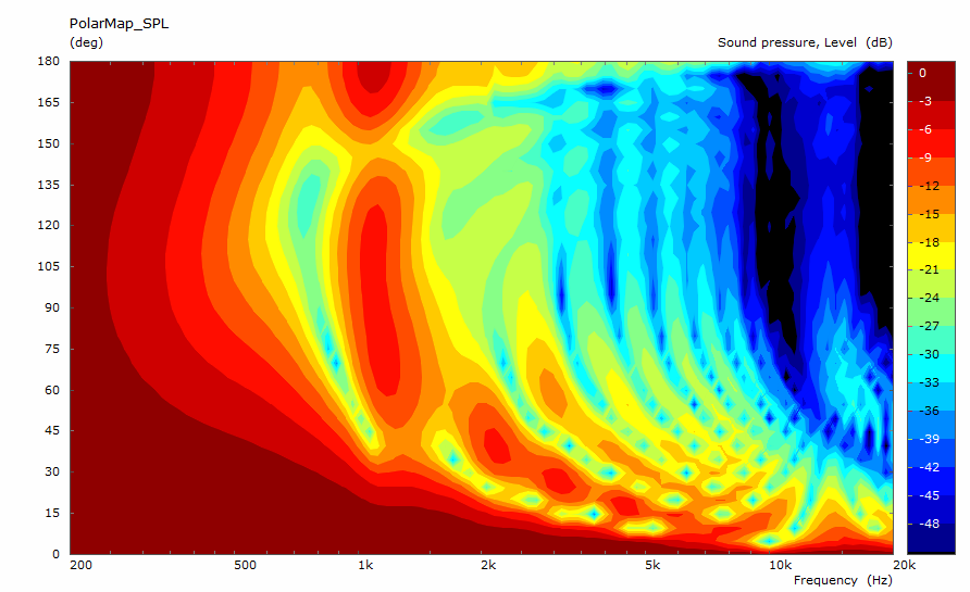

the question is does it have any disadvantage? I got an abec sim of the rollback against the baffle by modifying your node.txt file to model a large disk at the edge of the rollback. This made very little difference to the sim results, although I can't now find the directory where I did that work.
I don't think the CD will "see" the small drivers surrounding the waveguide. The question is to what extent the waveguide rollback will disturb the pattern of the small drivers. that is a question I have yet to ask ABEC
That's what I showed in #7730, that's with the rollback flush to the baffle. Yes, these things are very easily done by modifying the nodes manually (nodes.txt and solving.txt), 5 minute work. That's the nice thing about axial symmetry, I wouldn't bother with full 3D. One could also as easily remove the waveguide and try it just for the midrange source, to see the influence of the waveguide as an acoustic obstacle.

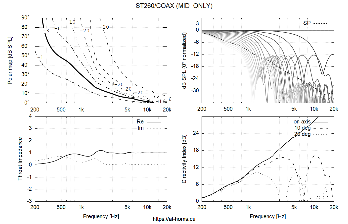

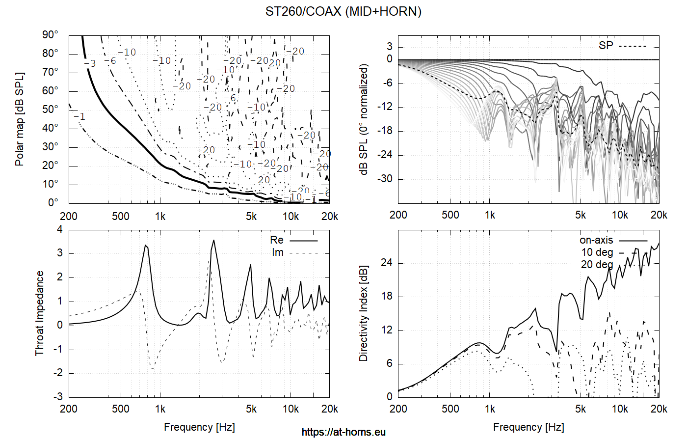

My point is only that it's better/easier to have the midrange drivers in the same plane as the compression driver. (Or not?)
I would personally be very interested in the effect of the waveguide on the midrange polar response - not an easy thing to do without numerical computations.
