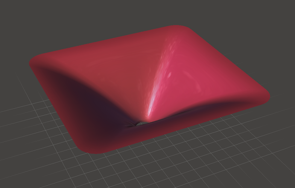

Hi mabat,
I am playing with your great tool a bit and still learning, how it works.
I have a question: I have some difficulties with building the waveguide you showed in #941 with the current version of ath. I am sure that I did something wrong.
Would it possible that you publish the script for the current ath version?
Raphael
Raphael

Try this. It's really a very basic shape (not bad at all).Would it possible that you publish the script for the current ath version?
Code:
; Waveguide from post #941 adopted for Ath 4.7
Throat.Profile = 1 ; OSSE
Throat.Diameter = 33 ; [mm]
Throat.Angle = 0 ; [deg]
Length = 114 ; [mm]
GCurve.Type = 1 ; superellipse
GCurve.AspectRatio = 0.952
GCurve.Width = 130 ; [mm]
GCurve.Dist = 0.5
Term.s = 0.7
Term.n = 4.0
Term.q = 0.995
Morph.TargetShape = 1 ; rounded rectangle
Morph.FixedPart = 0.0
Morph.Rate = 3.0
Morph.CornerRadius = 35 ; [mm]
Mesh.AngularSegments = 100
Mesh.LengthSegments = 24
Mesh.CornerSegments = 8
Mesh.ThroatResolution = 4.0 ; [mm]
Mesh.InterfaceResolution = 9.0 ; [mm]
Mesh.InterfaceOffset = 0.0 ; [mm]
ABEC.SimType = 1 ; IB
ABEC.f1 = 800 ; [Hz]
ABEC.f2 = 12000 ; [Hz]
ABEC.NumFrequencies = 24
ABEC.MeshFrequency = 1000 ; [Hz]
ABEC.Polars:SPL_H = {
MapAngleRange = 0,90,19
NormAngle = 10 ; [deg]
Distance = 2.5 ; [m]
Offset = 115 ; [mm]
ABEC.Polars:SPL_V = {
Offset = 115 ; [mm]
Inclination = 90 ; [deg]
Output.STL = 1
Output.ABECProject = 1
