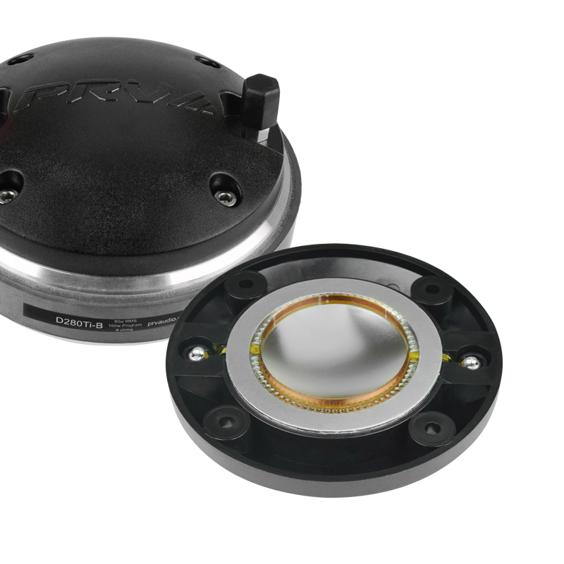

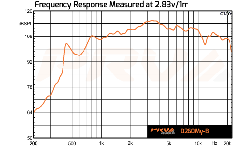

Cheaper options: Dayton Audio D250P-8, PRV D280Ti-B, possibly the new D260My-B ring radiator and several P.Audio drivers, among which the cheap DE34.

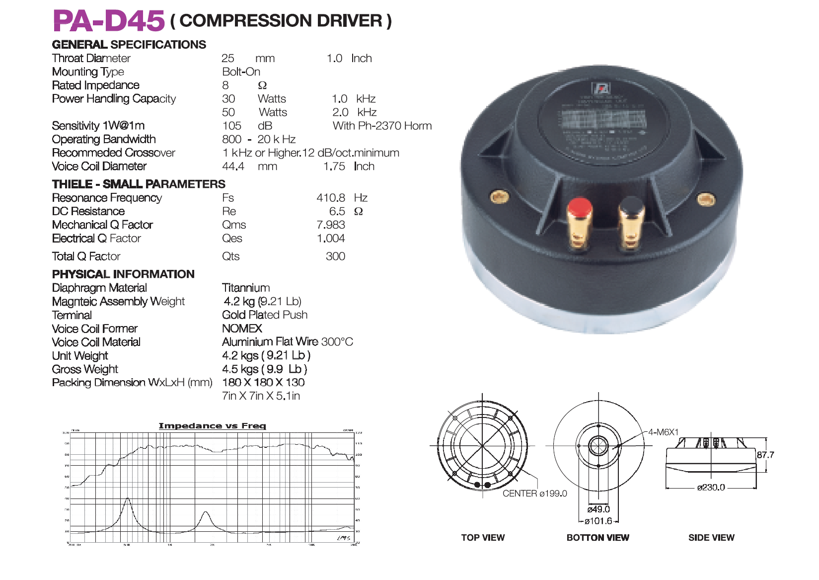

If I remember correctly, the man who created this 2 way crossed the cheap P.Audio at 600 Hz. Marcel can probably confirm this.

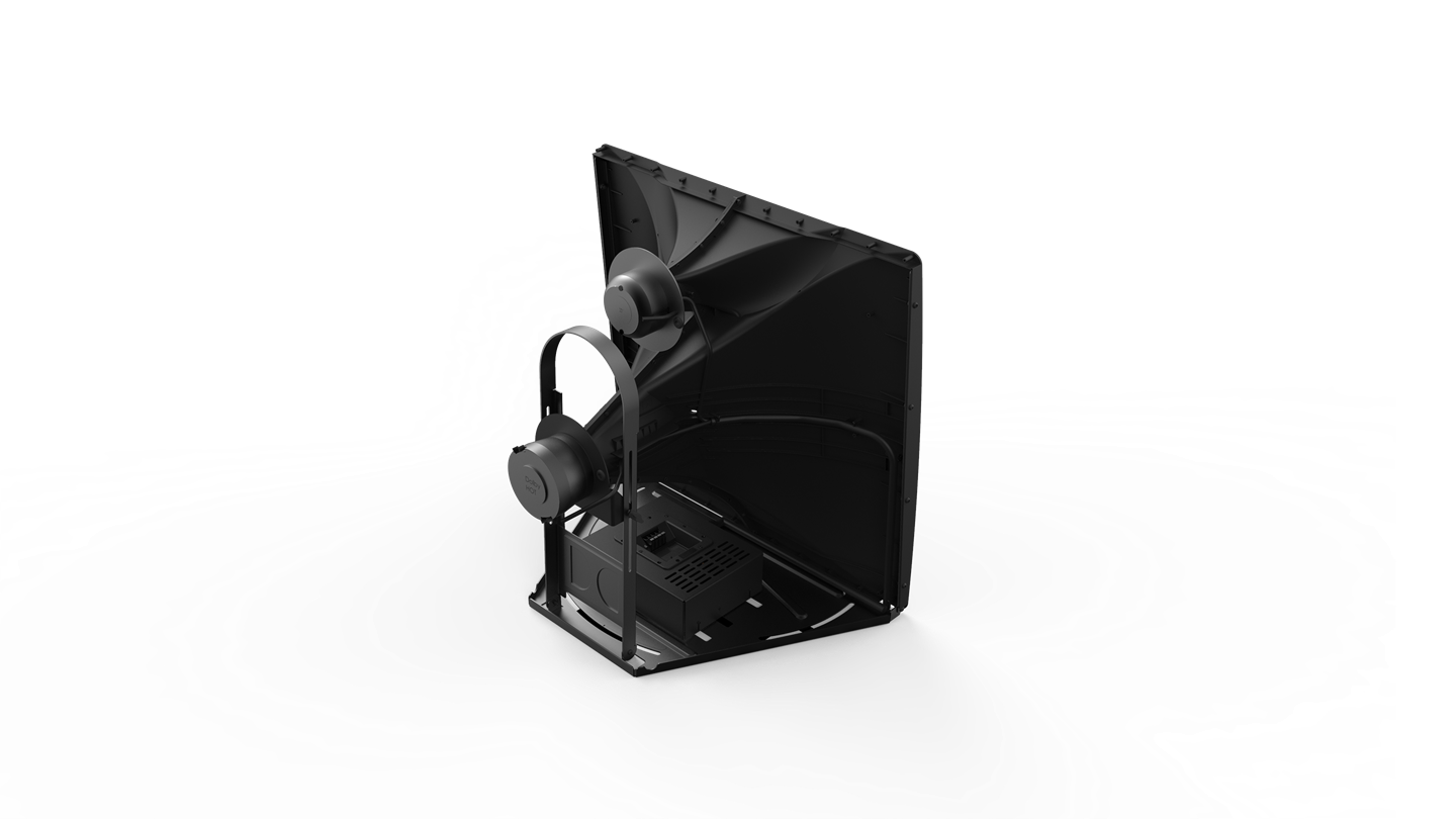

The B&C DE360 is definitely an interesting driver, at least on paper. I can't comment on the performance.

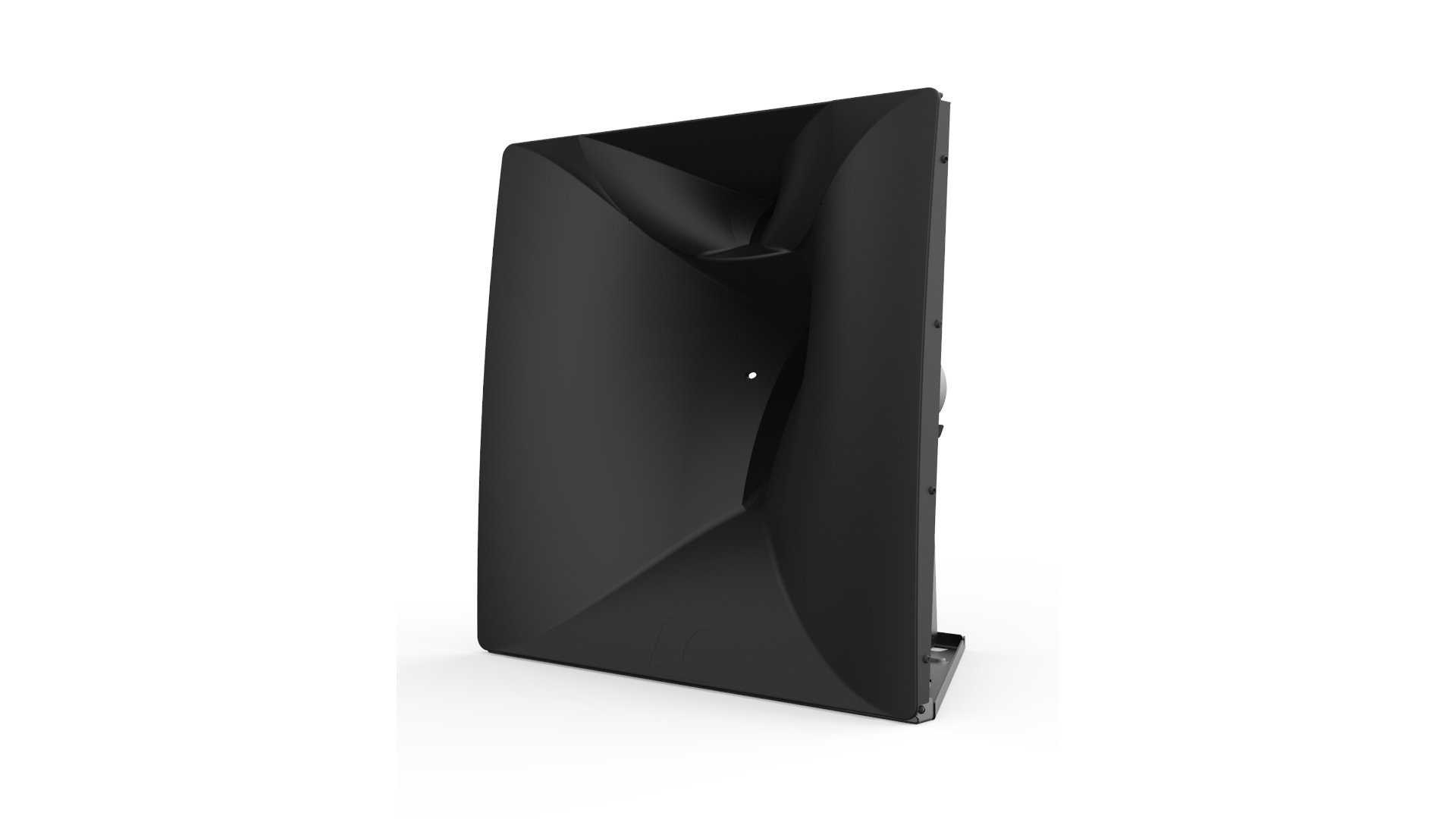

It seems the ideal complement to the DCM420 for this horn - Dolby's 2 way take on Keele's Bi-Radial 2360. The tweeter's entrance is 1.4" though.

It was the PA-D45, quite a special driver. The aim was around 700 Hz, crossed to an 18" woofer, full active. The enclosure was acoustically dead as a piece of rock. As far as I know it was never finished.If I remember correctly, the man who created this 2 way crossed the cheap P.Audio at 600 Hz. Marcel can probably confirm this.

@Ro808, can you specify which type this Dolby horn is? Quite an interesting device.
EDIT:
Never mind, I found it:
Dolby System 136 Screen Channel Speaker - Dolby Professional
Thanks!

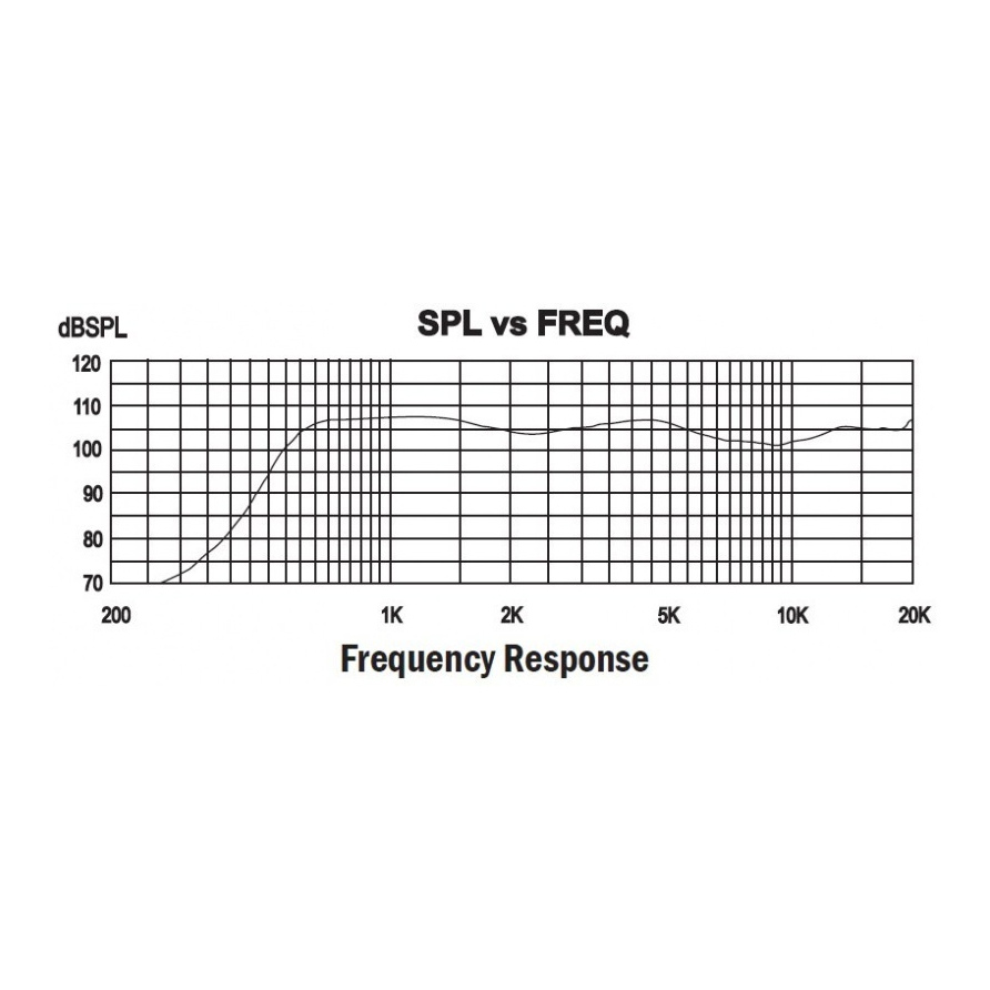

Axi2050 on 700w x 380d 17sides
I made a new horn that's a bit ugly, so no pictures... but here are the responses. (1/6 octave smoothing and no EQ)

This is a respectable result for a single diaphragm driver, I think most of us will agree.
If only you could squeeze out that last octave > 200-400 Hz 😉
It may not be worth the hassle and will likely come at the expense of DI.
You may want to read this thread describing the aforementioned PEQ at 18 kHz.
Thanks. I think it illustrates nicely how the non-flatness of the input wavefront affects the performance above ~ 7 kHz (mostly between 8 and 12 kHz), in agreement what has been calculated for a 2" throat earlier (#7022).I made a new horn that's a bit ugly, so no pictures... but here are the responses. (1/6 octave smoothing and no EQ)
