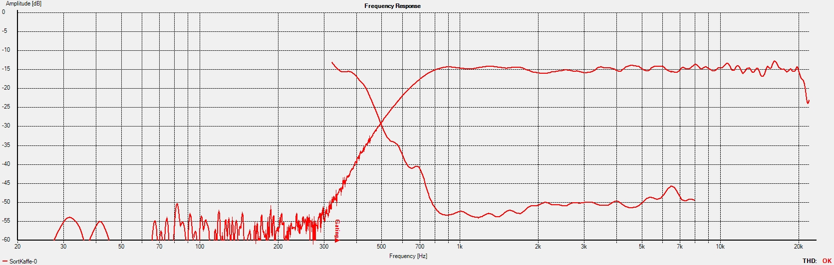

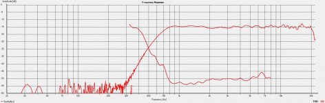

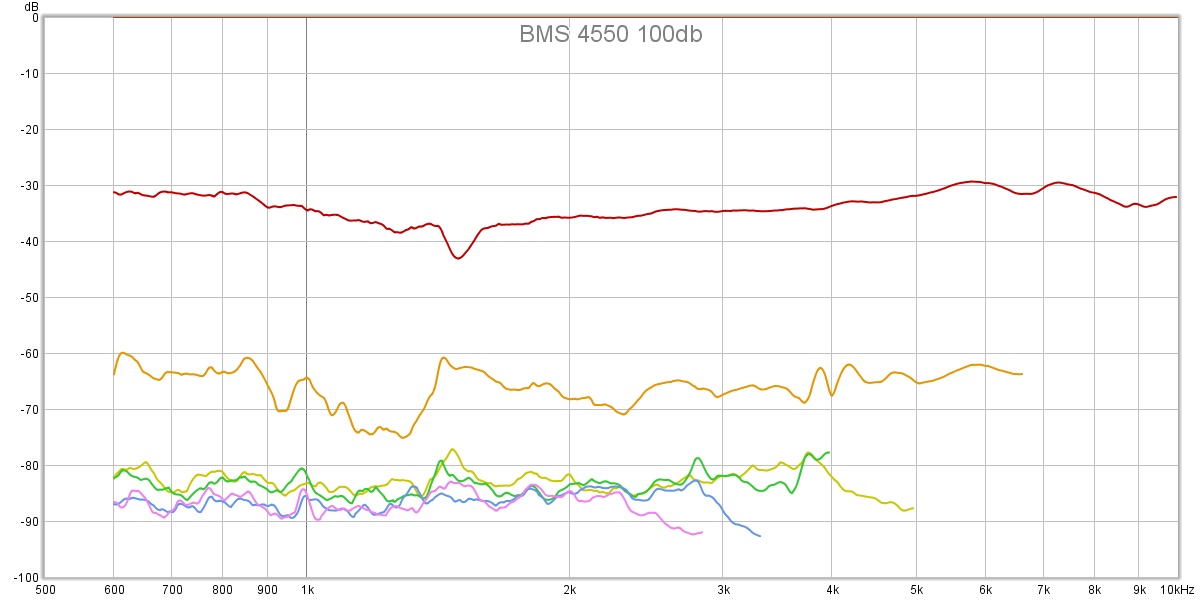

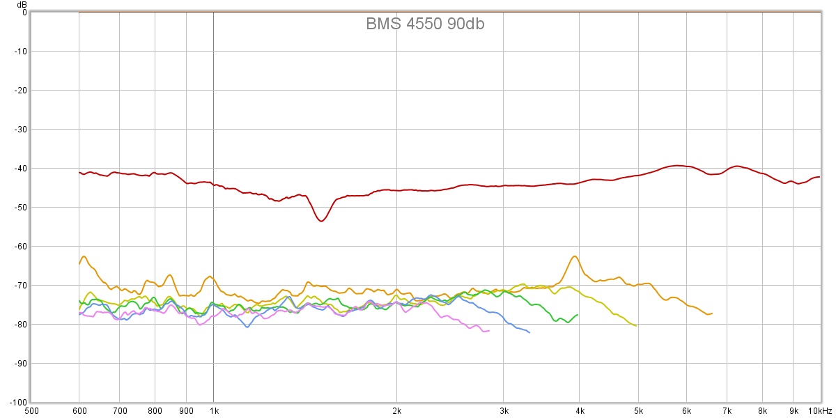

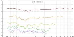

I think the problem with crossing small drivers low is not that they will break, but that they start producing a lot of distortion.
Here's a measurement of the recent horn I 3D printed. Amplitude vs THD.
Now I'm not sure if this rise of distortion could be related to the material property of the horn (the actual horn ringing below 600)
Or if the increase of THD is a result of the decrease in gain below 700
Yes, with that horn.
I'll try to stick something heavy to it to dampen the ringing and repeat the measurement.
Maybe it's just the horn ringing.

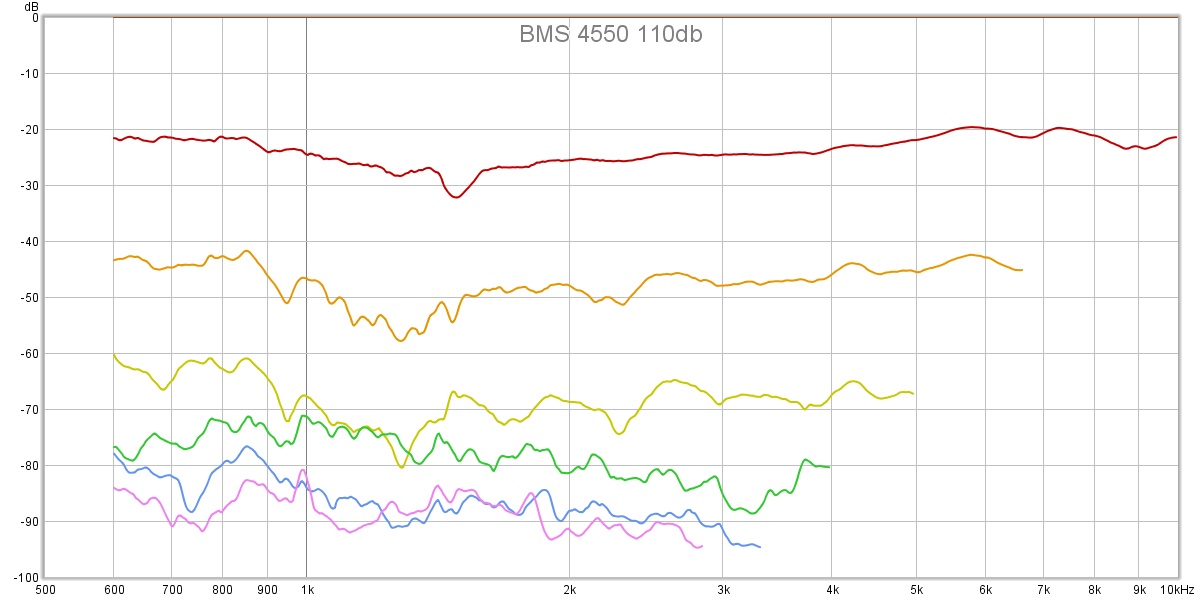

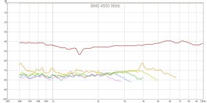

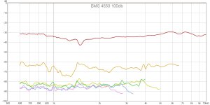

It is that only the BMS 4550 has "Recommended crossover" below 1kHz in the datasheet.

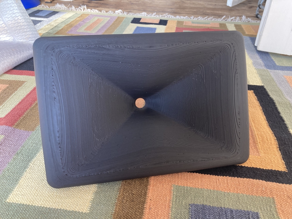

Did you also measure distortion of the other horn, the deeper one with slot?
You may want to check the diaphragm + coil for damage and the gap + mounting plate for dirt. Assuming you've got a pair, you can try the other driver.
I've used the 4554 (the 1.4" version of the 4550) with the XT1464 from about 900 Hz. Distortion did increase below 800 Hz, but more evenly.

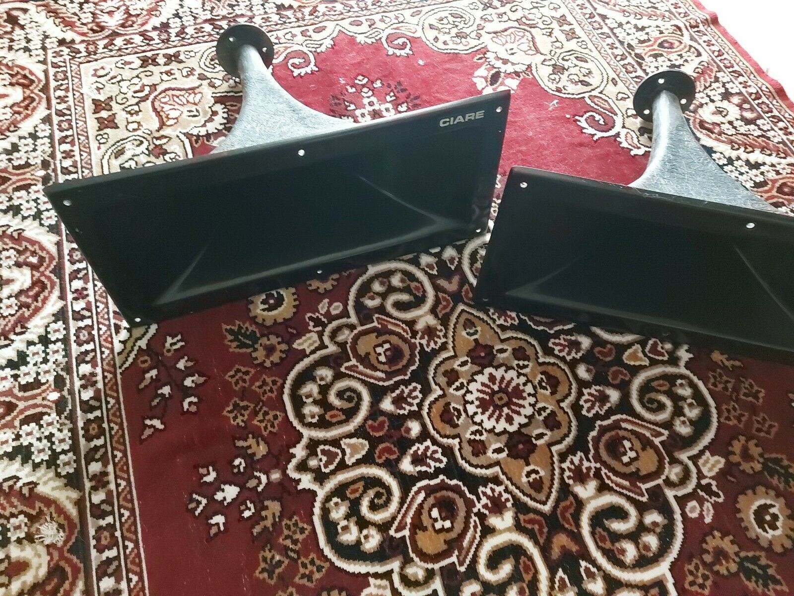

That said, I still regret missing out on a pair of working 802s + vintage Ciare horns that were offered for € 25, years ago. At the time I didn't immediately recognize the drivers because instead of the usual decals there was only a serial number on the back covers. When I found out they were Altecs, they were gone.
The Ciare horns in question, clearly different from the average ATH4 horn.
The Ciare horns in question, clearly different from the average ATH4 ̶h̶ ̶o̶ ̶r̶ ̶n̶ .
