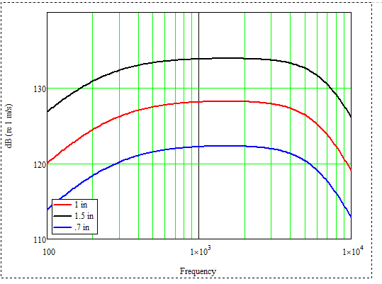

Here is a sim changing the diaphragm area while the plane wave tube remains constant. The compression ratio would be 4:1 down to almost 1:1.
This curve demonstrates why I say that most of a waveguide systems gain comes from the compression ratio and not anything having to do with the waveguide.

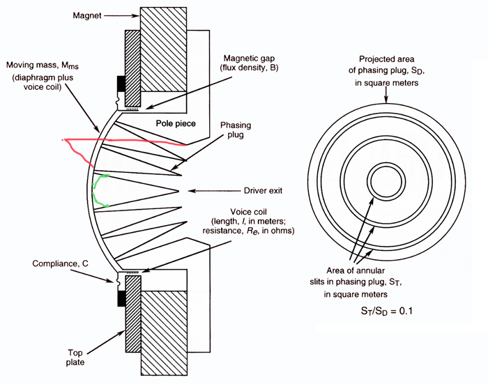

For example in the picture attached, the red lines point to abrupt change in cross section variation. Why not have smoother transition as shown as the green lines illustrate?I can't really comment since I have no idea what you are talking about.
Earl, may I take the liberty to ask a question related to the picture in post 6712?
It has always struck me that CD diaphragms are relatively flat (for pseudo domes that is). That is understandable from the perspective of creating a flat wavefront with the help of the phase plug.
I had this concern many years back - that the sharp corners would create turbulence and degrade the sound. But testing this showed it to be insignificant. Making the radius on the inner gap larger increases the volume in front of the diaphragm - composed of the area times the gap. This volume is a LP filter and acts to lower HF response as it gets larger. Hence, your idea would not do much more than lower the HF response.

Interesting point, seems like experiment to do if there are no published data and reports. Less slots would also reduce volume. But I guess a smoother throat transition between the compression and expansion side would be a plus.I had this concern many years back - that the sharp corners would create turbulence and degrade the sound. But testing this showed it to be insignificant. Making the radius on the inner gap larger increases the volume in front of the diaphragm - composed of the area times the gap. This volume is a LP filter and acts to lower HF response as it gets larger. Hence, your idea would not do much more than lower the HF response.

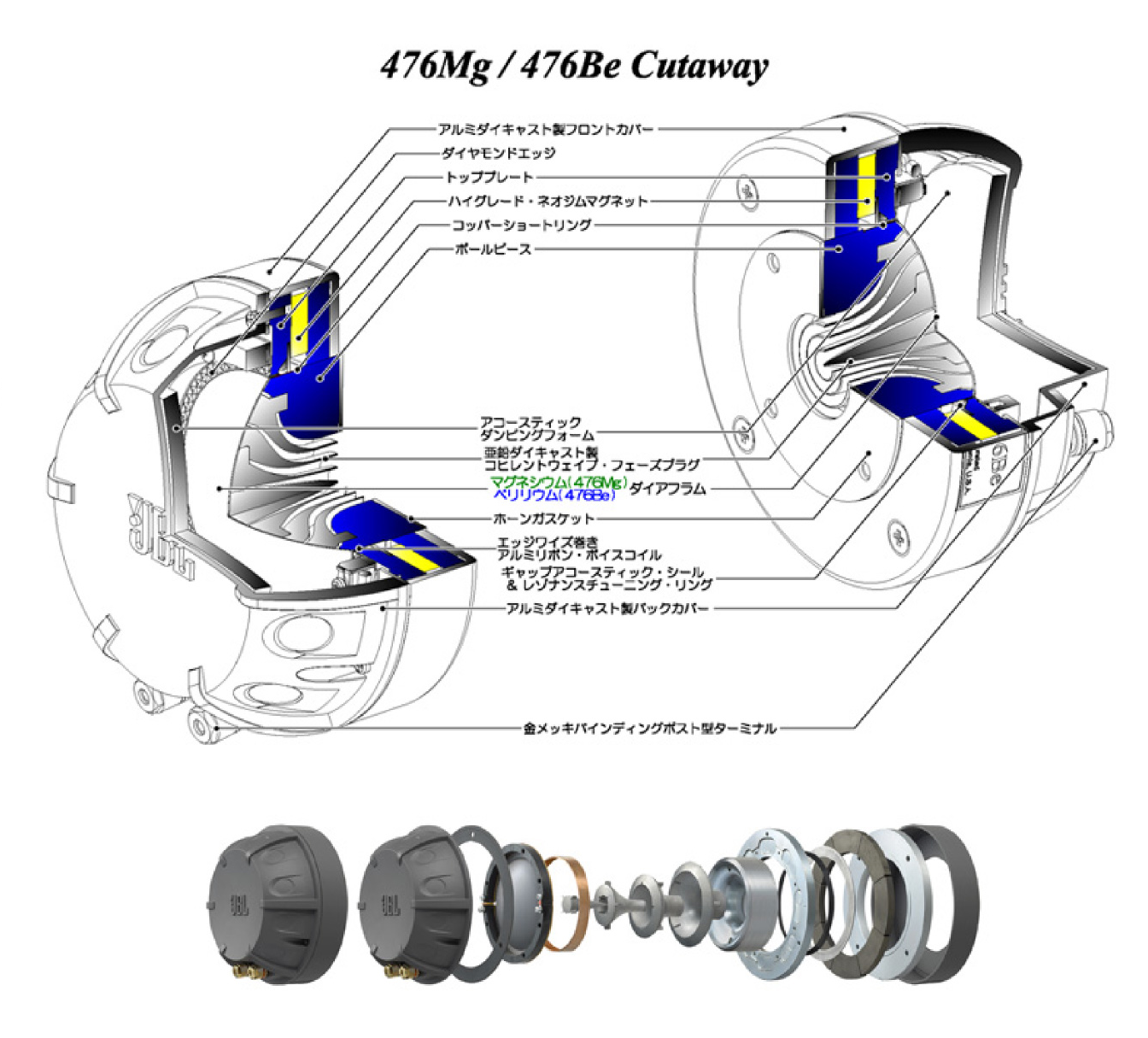

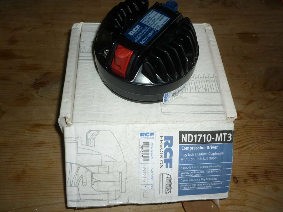

Both JBL and RCF have developed phase plugs with coherent/curved/optimized geometry.
