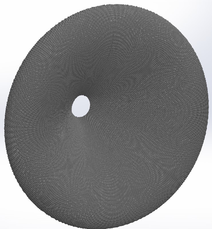

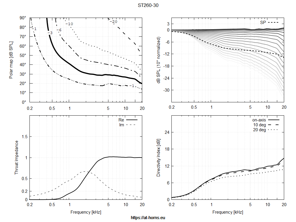

As the QQ-S is specified at 255mm, here's a slightly smaller version (~252 x 80 mm): https://at-horns.eu/ext/ST260-30S.zip..I think I have my delta printer, Flsun qqs w/260mm round build area, ready to print this in one piece.
Incredible! Thank you very much for the modified models. The slicer software profiles I use are set to 260mm. I'll run some test circles to see where the limit is at before starting. Probably no real difference between the 260 vs 252 but the compulsion to max out my printer is strong.

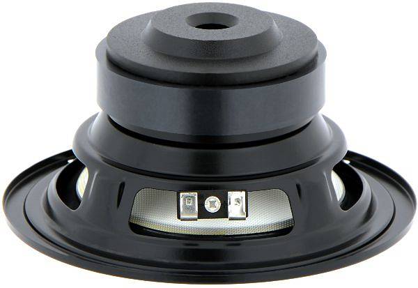

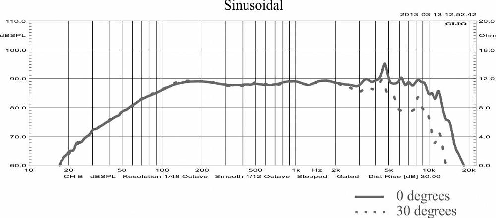

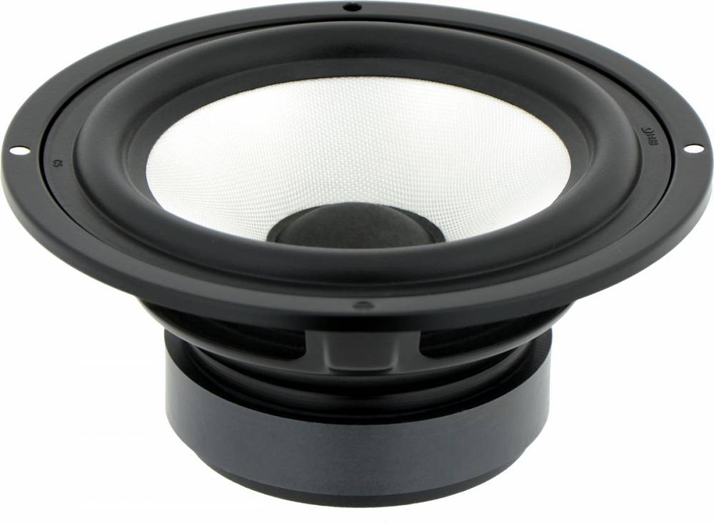

That's an impressive hifi woofer considering the low price (€ 27).
Demodulation and symmetrical rings + copper "faraday cup" included.
Can't figure out why the 260mm slicer profiles don't let me actually print 260mm.

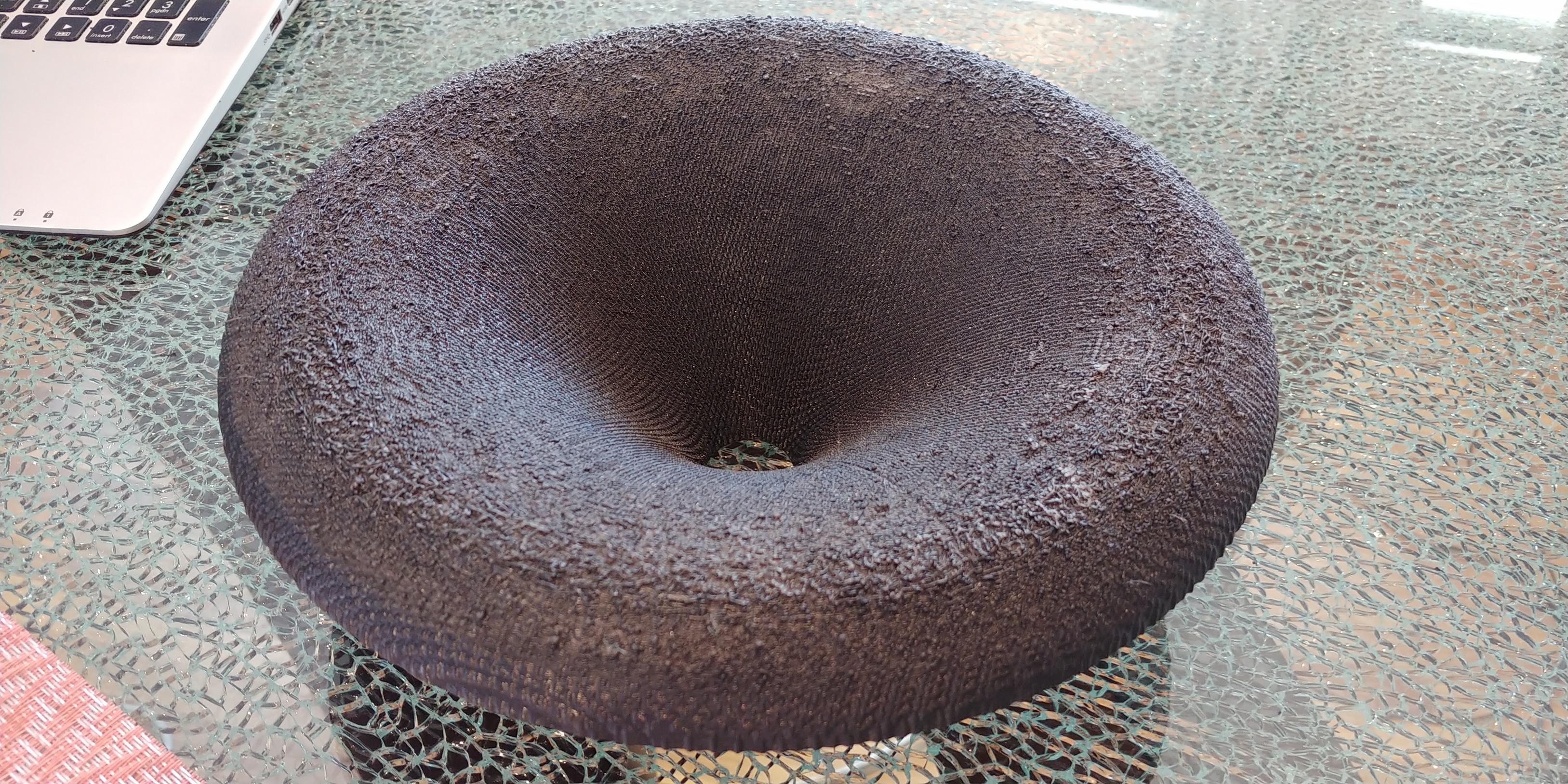

I applied a knurl to the 252 and pressed go just a moment ago. Image has a moire effect that isn't part of the model. Looks like about a 24 hour print. My longest yet

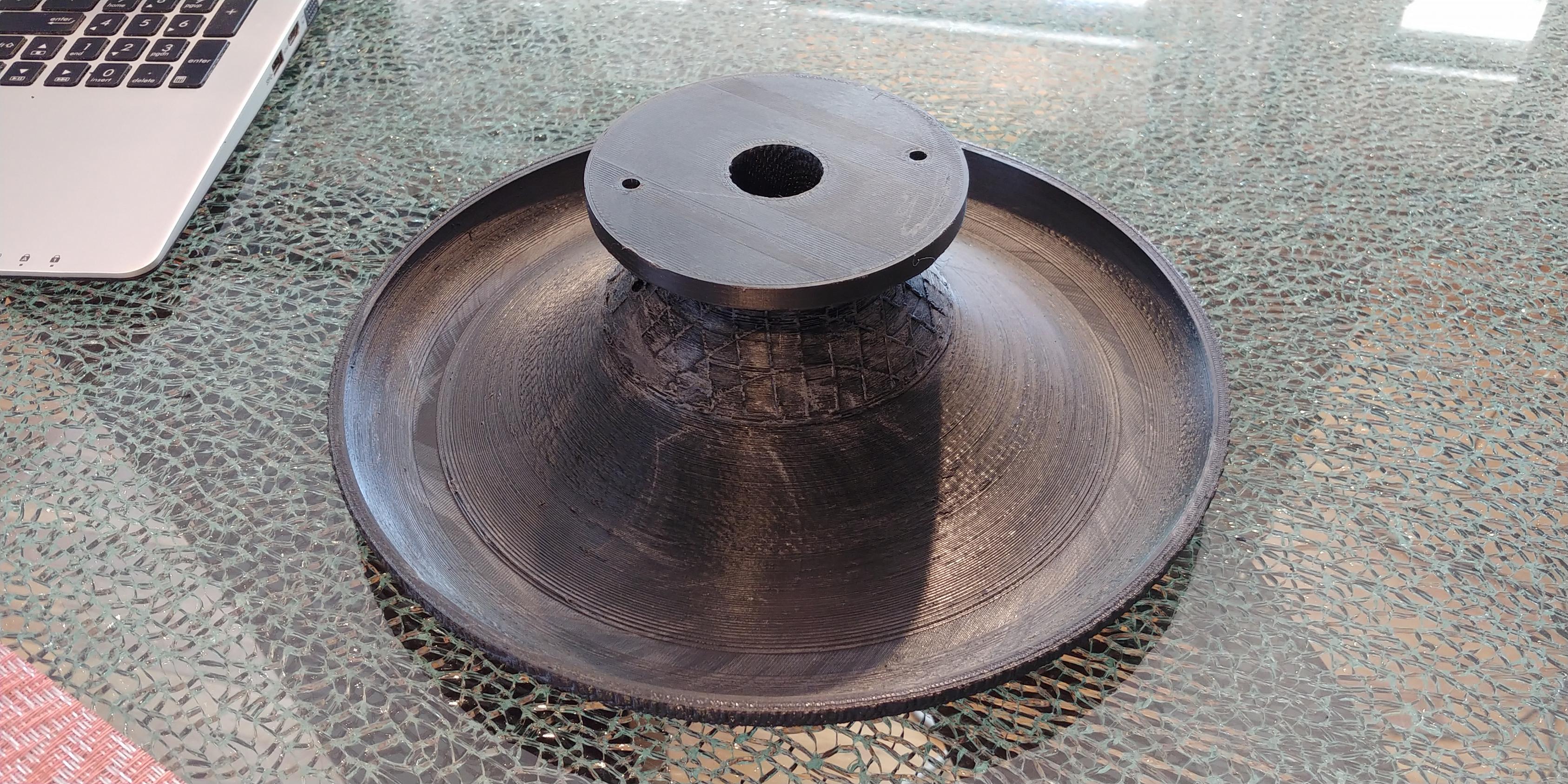

35 hours later. Support structure didn't play very nice with the knurled texture. Overall looks pretty good. Should get some measurements done tomorrow.
