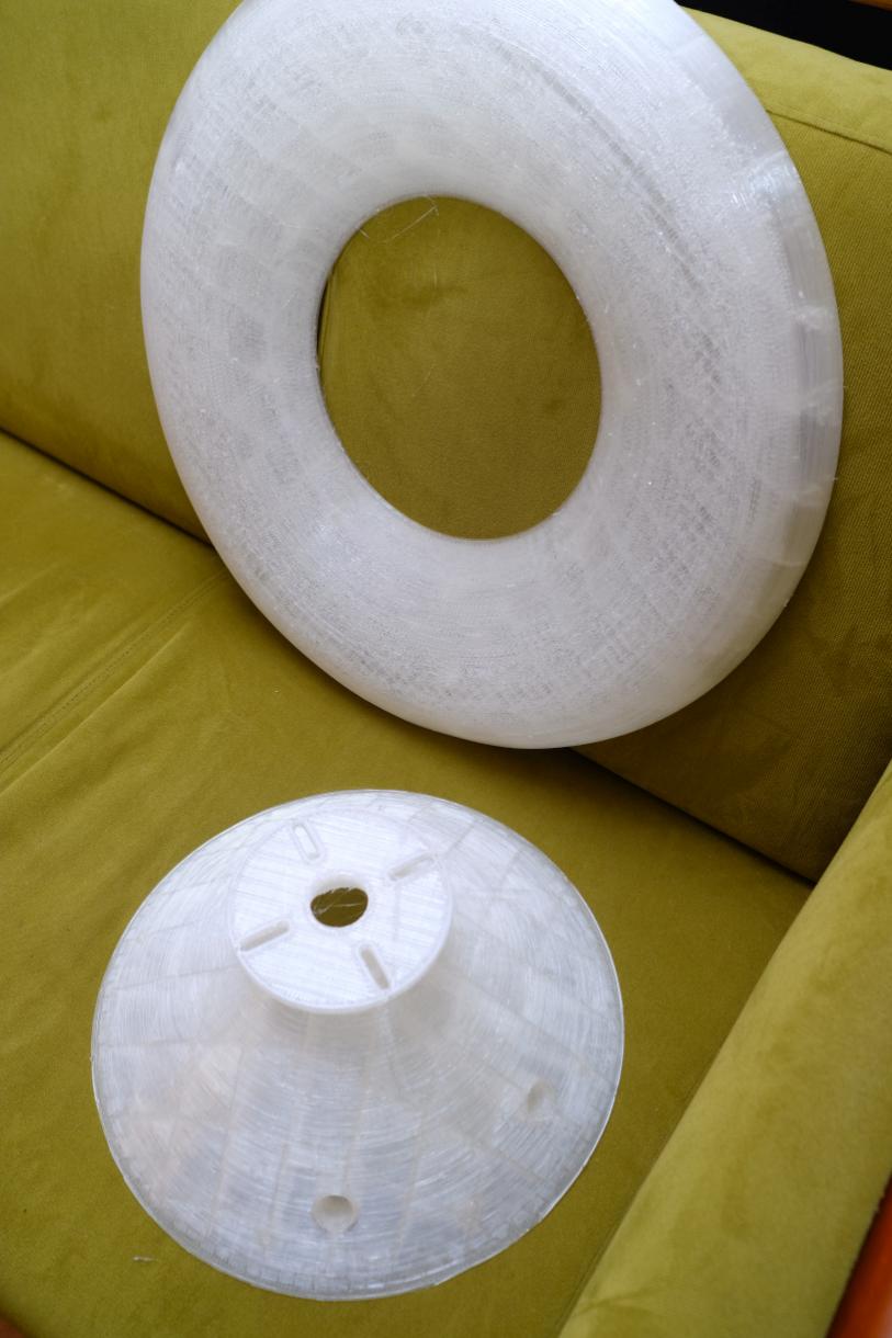

Found an "easy" way to print horns with rollback. Print them in 2 pieces and weld them together with a soldering iron at 200 degrees 🙂

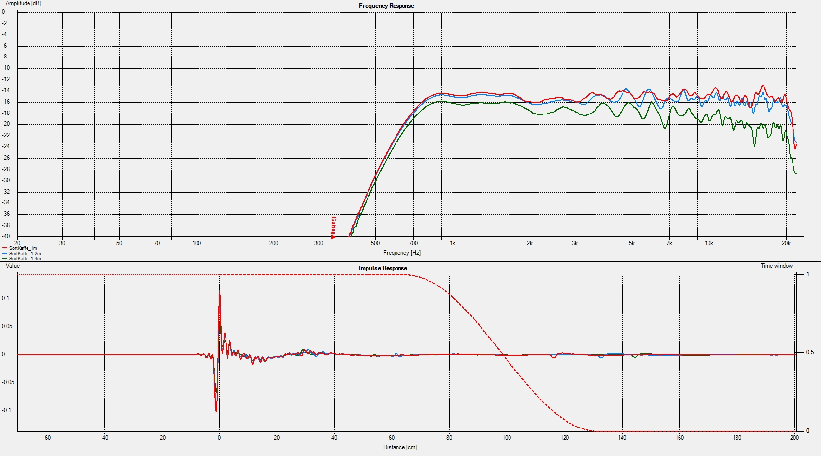

It should be good from about 800 Hz.
What are the dimensions?
Thanks guys!
I feel like it was a lucky guess playing with the morph rate and corner angles.
It's approx 38cm x 20cm and about 16cm long. I can't remember the exact specs.
Did like a 20 itterations and this is number 7 or so.
This is most impressive, especially for a non-symmetrical fanboy like me! It looks like I'll have to get myself a 3d-printer at last 🙂
Would you care to elaborate on the above? Being completely ignorant about this, I don't even see or understand the problem you seem to have solved with the 'welding' with regards to roll back issues.
Well, 3D printers have a hard time printing in free air and if one is to use supports print time at least double 🙂
Ah, (I think) I see. So the idea is to print the mouth-part upside-down so the back is flat on the bed and the 'welding'-point is as deep down the horn as the roll back extends? Sometimes I need a little help, lol.

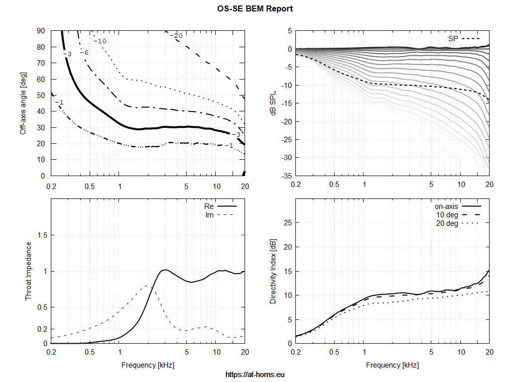

At the moment gnuplot is used for creating reports (as attached). See chapter 6.12.May I ask how Gnuplot is supposed to work with ATH? I have downloaded the latest version gp541 and the ATH config file is pointing to the gnuplot.exe
