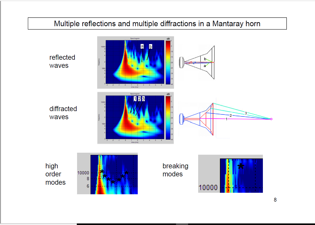

Higher-order Modes
Definition: transverse modes of a resonator or waveguide, excluding the fundamental (axial) modes
I believe you guys are looking at these via location in the polar radiation field...You might have to measure them at their location...
the power of linguistics.....
Higher order mode .....Higher order Harmonics to follow?
I was right!
Higher-order Modes

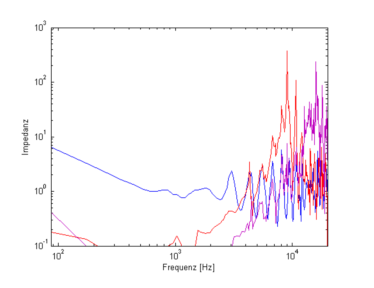

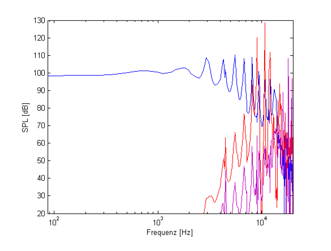

Introduction
When developing horns for effective midrange/treble reproduction in public address systems, next to the conventional prototype construction, the numerical Simulation with BEM (Boundary Element Method), FEM (Finite Element Method) or similar methods as fast and resource-saving alternative has been established. The application of the well-known four-pole description to the acoustically coupled system horn driver / horn allows both systems at the common interface to separate. Due to the one-dimensional nature of the acoustic distribution, the transition between driver and horn cannot be recorded in general. The applicability of this methodology, based on a wave in transition, has already been shown and statistically secured for one limited frequency range.
The limits of this procedure are particularly evident in the higher frequency range in which the radiation of the systems are dominated by higher modes.
The restrictions due to the quadrupole description around, a modal multi-port should be introduced. The description is then possible in the transition between driver / horn through a system of orthogonal eigenfunctions.
Representation on a modal basis
The sound pressure and possibly the sound velocity in the interface between driver and horn are described as linear combination of basis vectors, from the orthogonal eigenfunctions of the cylindrical tube. The associated participation coefficients are derived from the measured pressure or distribution decomposition. This representation allows a description of the systems regardless of the specific distribution of the measurement positions in the cross section of the driver's exit.
Makarski used a four-pole LTI system for his measurements.
Fig. 1. Fundamental mode of the source pressure (blue) and the first two radial modes.
Fig. 2. Source impedance for fundamental mode (blue) and two radial modes.
Fig. 3. Frequency curve of the four matrix entries of the Four-pole representation of a horn driver.

I don't think so. He used "HOM" as a joint term for "high order modes + breaking modes + HF resonances of the driver", without even attempting to investigate what are the respective contributions. It's quite possible there were no actual horn HOMs observed - much of what is shown there will still be some other issues, IMO. Also the plots of group delays are pretty meaningless in that report, as we have just discussed here.
BTW, as JMLC states in that report:
"A good horn should provide the less amount of reflected waves, diffracted waves and unwanted high order modes."
- Add "constant directivity" to that list and I would agree.

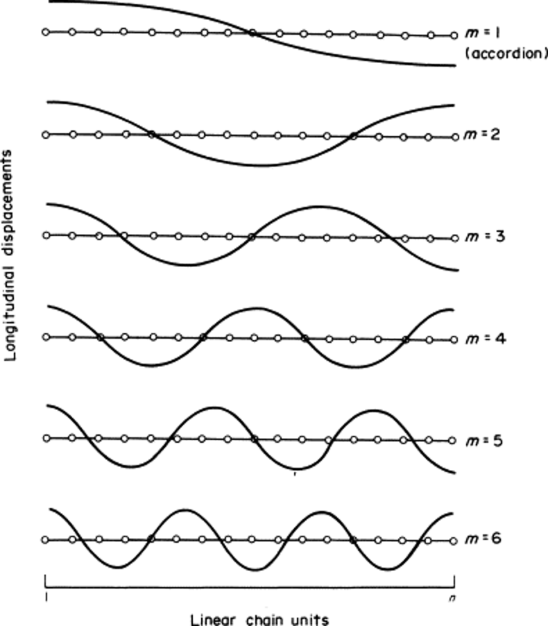

A mode is like an exaggerated or cancelling resonation isn't? In the CSD wouldn't this show as exaggerated decay or cancelled decay? I believe this HOM discussion is aimed towards horns/waveguides? So direct energy measurement of the bare driver is normal and the direct energy measurement with horn/waveguide attached, is the difference via CSD?
Looking at my own previous tests, it seems to me the modes are hidden in the CSD and quite difficult to see. However, wavelets can show quite clearly the reflection back from the mouth. As Earl also mentioned, modes may not be resonances, which are often also seen in the wavelets plot. One thing I was not able to do at the time of previous testing, was reduce the length of the CSD. For some reason, using a same dome driver with a horn always had a much longer decay time than the clean driver.
