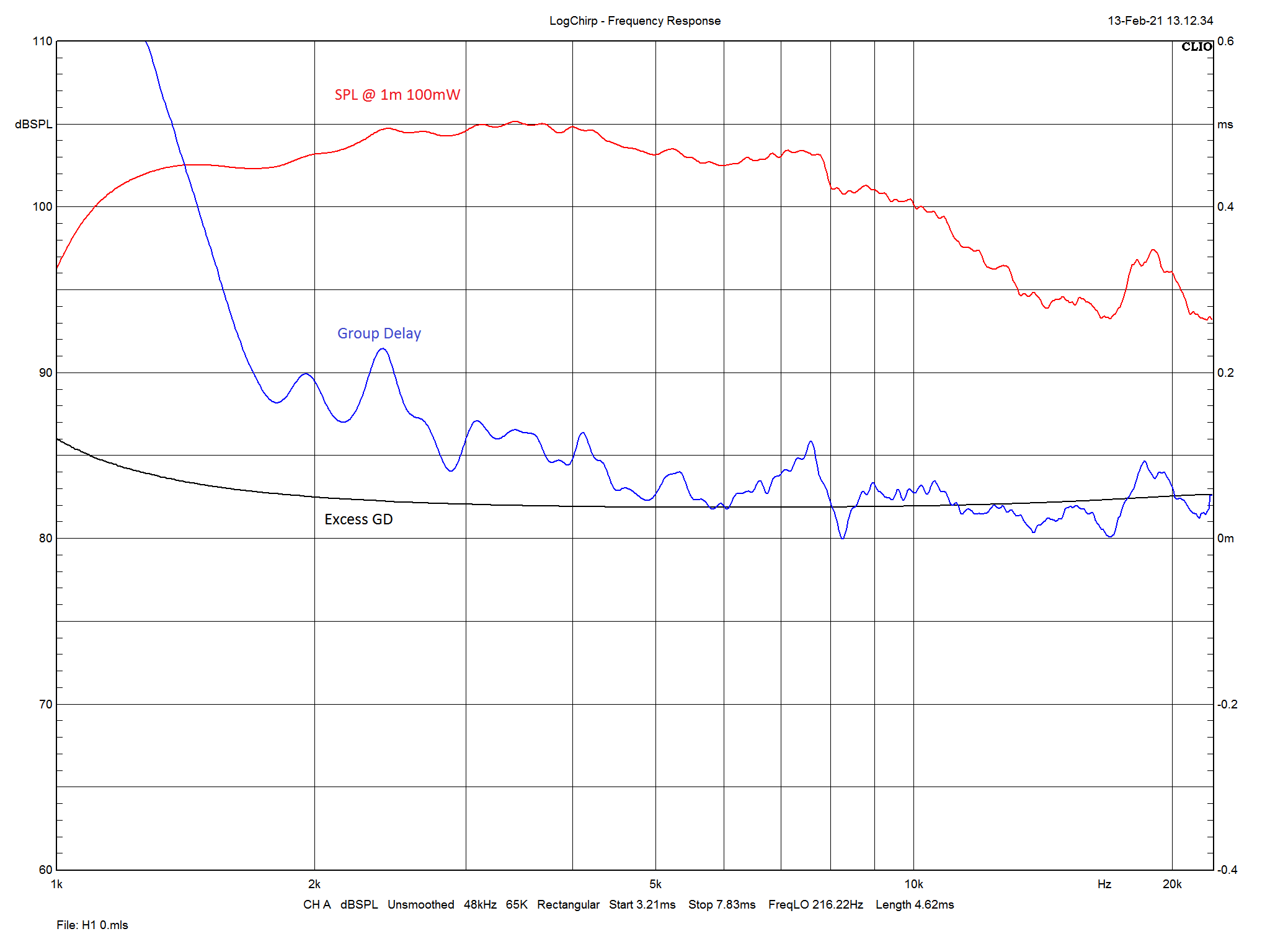

Graph
This is a BMS 4538 on a Celestion H1-7050 "No-Bell".
Free standing.
Excess group delay is the part of flight I DIDN´T remove.
Looks quite minimum phase to mee, no?

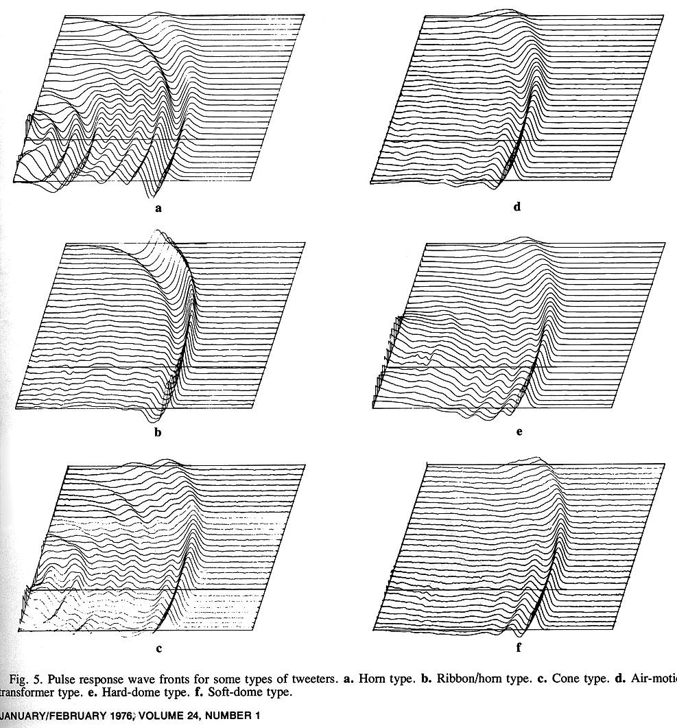

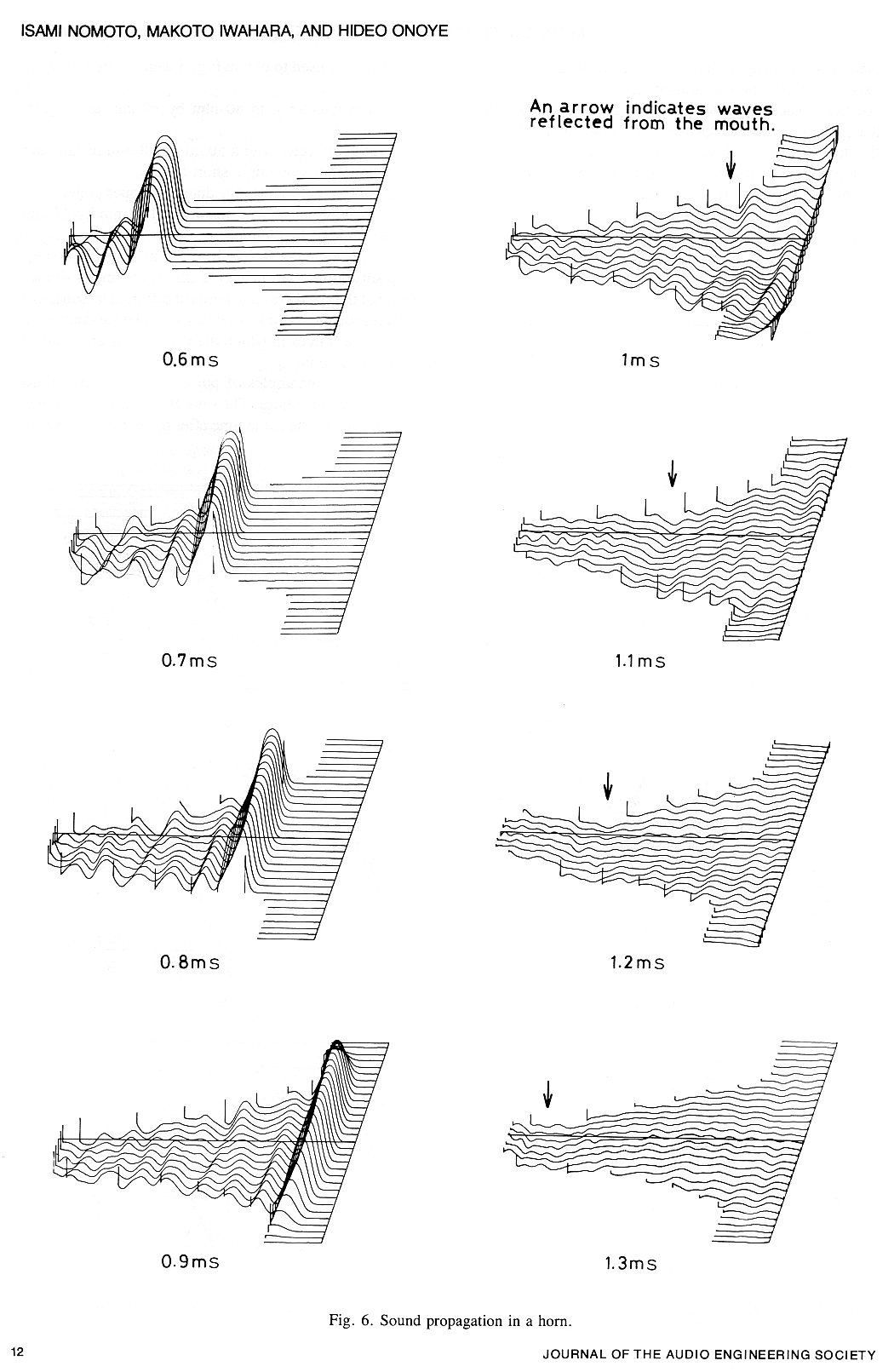

Attached are two samples of the only laboratory experiment that - to my knowledge - has ever been executed to visualize wavefront propagation and the inherent artifacts of different high freq. transducers. A raised-cosine pulse was used as the input signal.
HOMs are buried somewhere in the sea of ​​wobble after the initial wave front (pulse).
Conclusion: if you are looking for relatively clean high freq. reproduction use an AMT, ribbon or soft-dome tweeter.

That's not the same thing as a HOM propagating in the waveguide that originated due to the waveguide. As you can see in the above measurement, with a common CD and IIR filter of sufficient complexity you could in principle correct the frequency response of the driver completely. You can't do this with HOMs in a waveguide (other than to attenuate them with a foam, relative to the fundamental mode).
Fortunately, HOMs in waveguides, those that would propagate outside the device, seem to be non-existent to any measurable degree so far. We are still waiting to see some.
