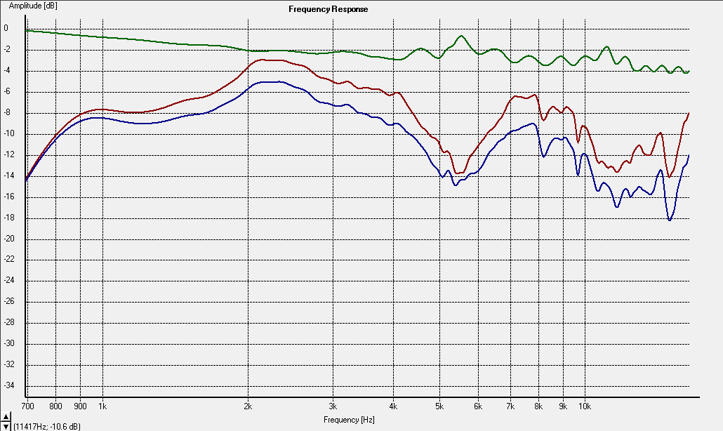

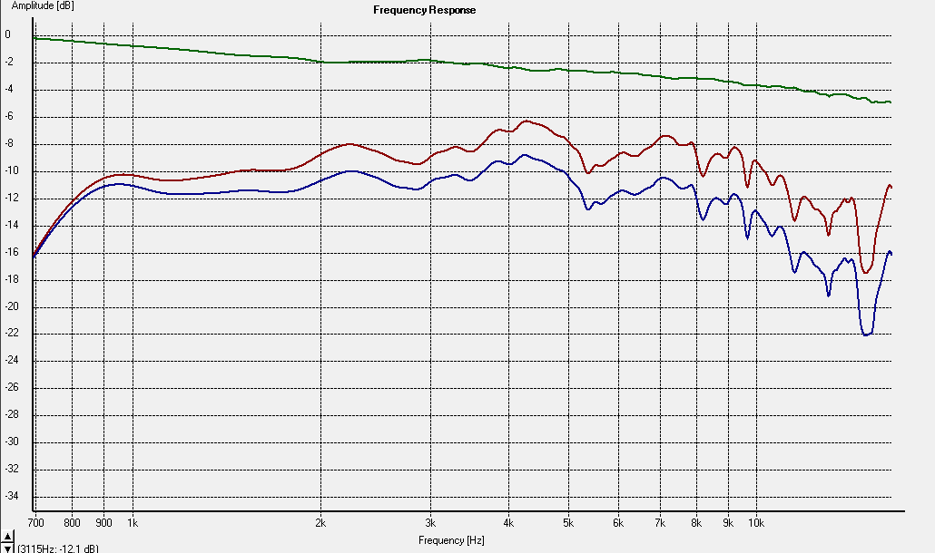

In the past I measured the effect of the foam plug on my 12" OSWGs (quite a lossy one in fact). I still don't know what exactly to take from that.
Unfortunately I probably won't find the original data anymore. I could try some more analysis.
On axis (green is the difference):
30 deg off-axis:
