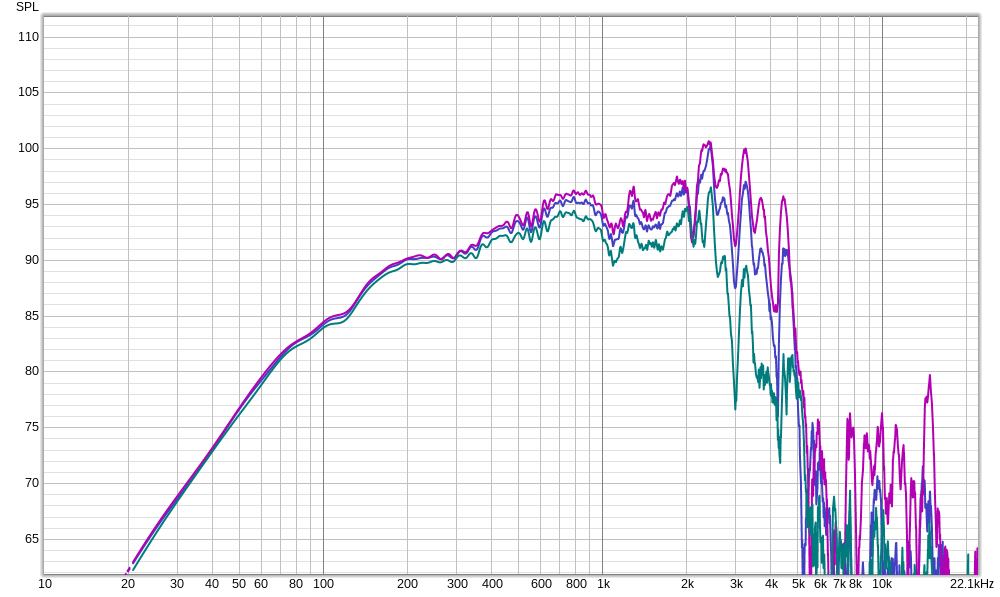

I've attached some ground plane data of the woofer in the cabinet. The first graph is the raw response and the second is with a bit of EQ. Angles are approx. 0, 15, and 30 degrees (I'm pretty sure I did a couple more measurements further off axis, but I guess I didn't save them).

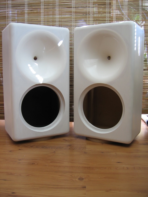

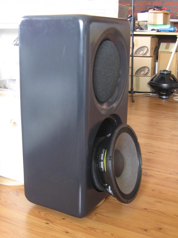

I tried to find the data but found only some photos - phew, already 10 years. I think these could well be the first DIY OS waveguides in Europe at that time - basically all done based on "Geddes on Waveguides" thread 🙂 If I remember correctly, these were the waveguides that Jacek and Autotech later used in their "Mummy" speakers. As you can imagine, these were still not well terminated - done completely blind at the time.

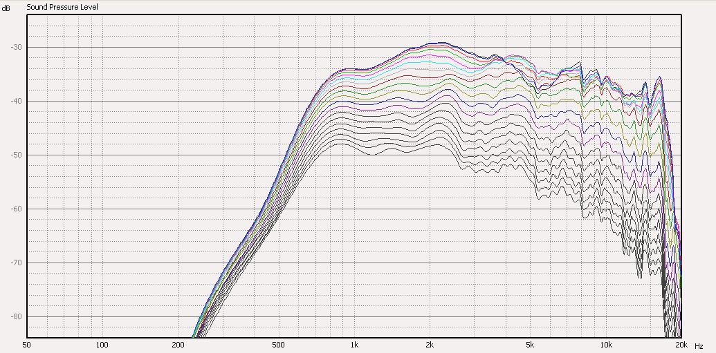

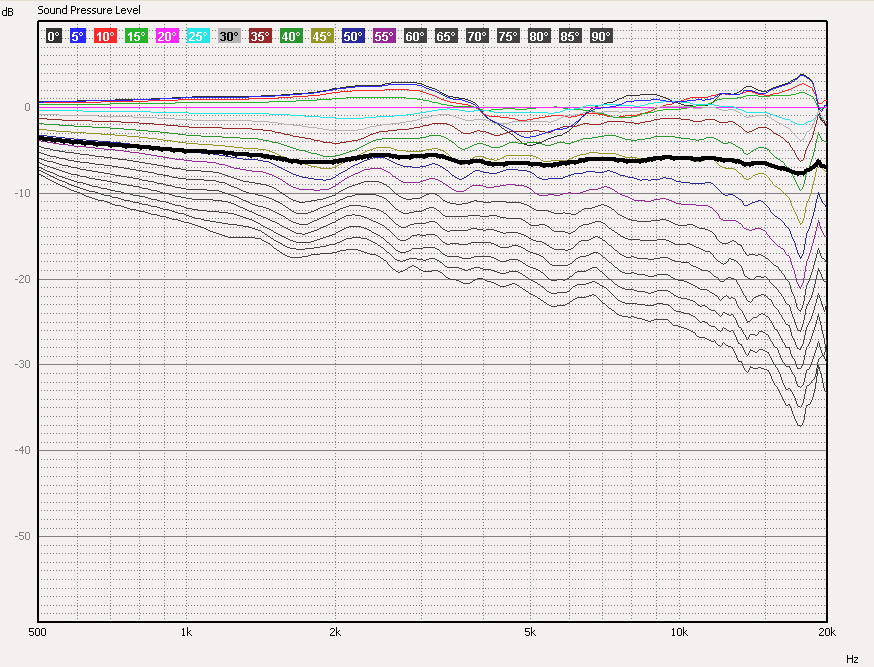

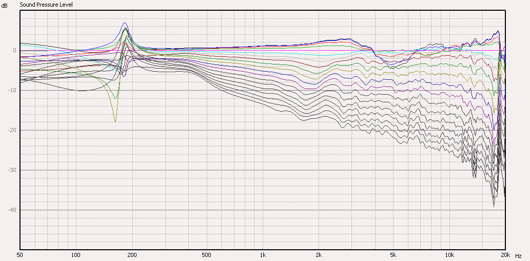

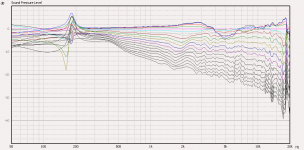

Finally I found at least some measurements of the waveguide with DE250 - raw and normalized to the listening axis.
I think the bold line on the last picture was the power response.
