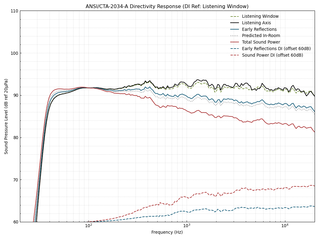

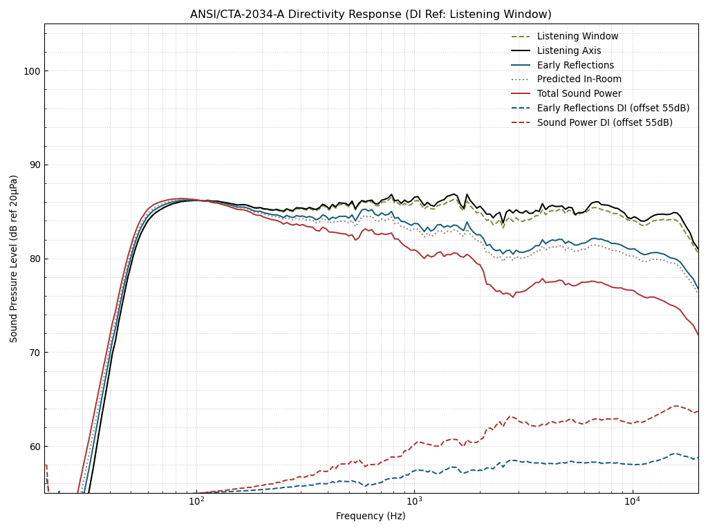

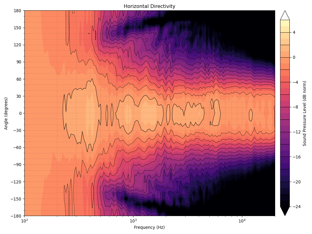

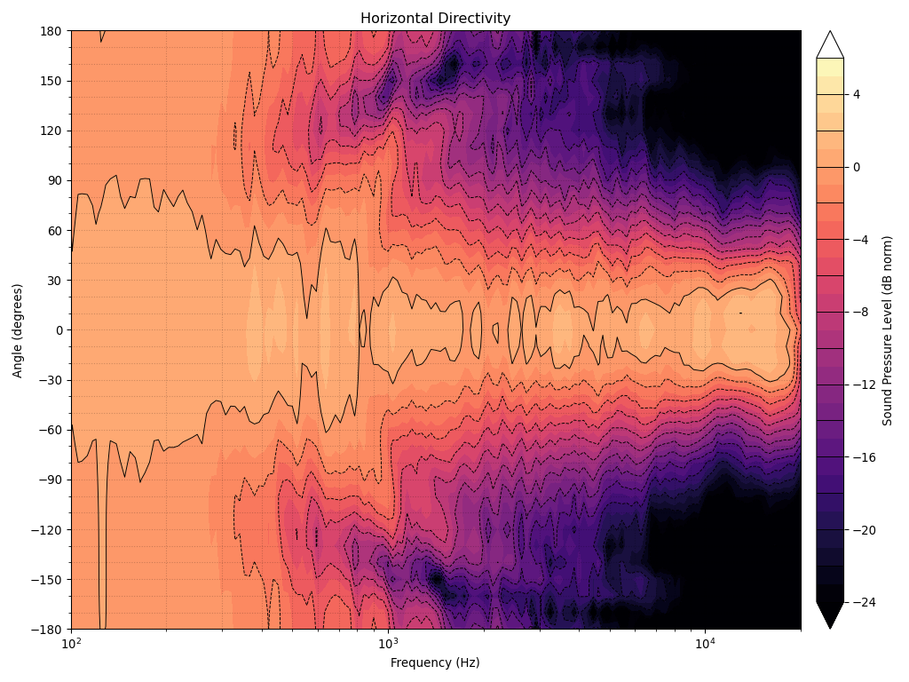

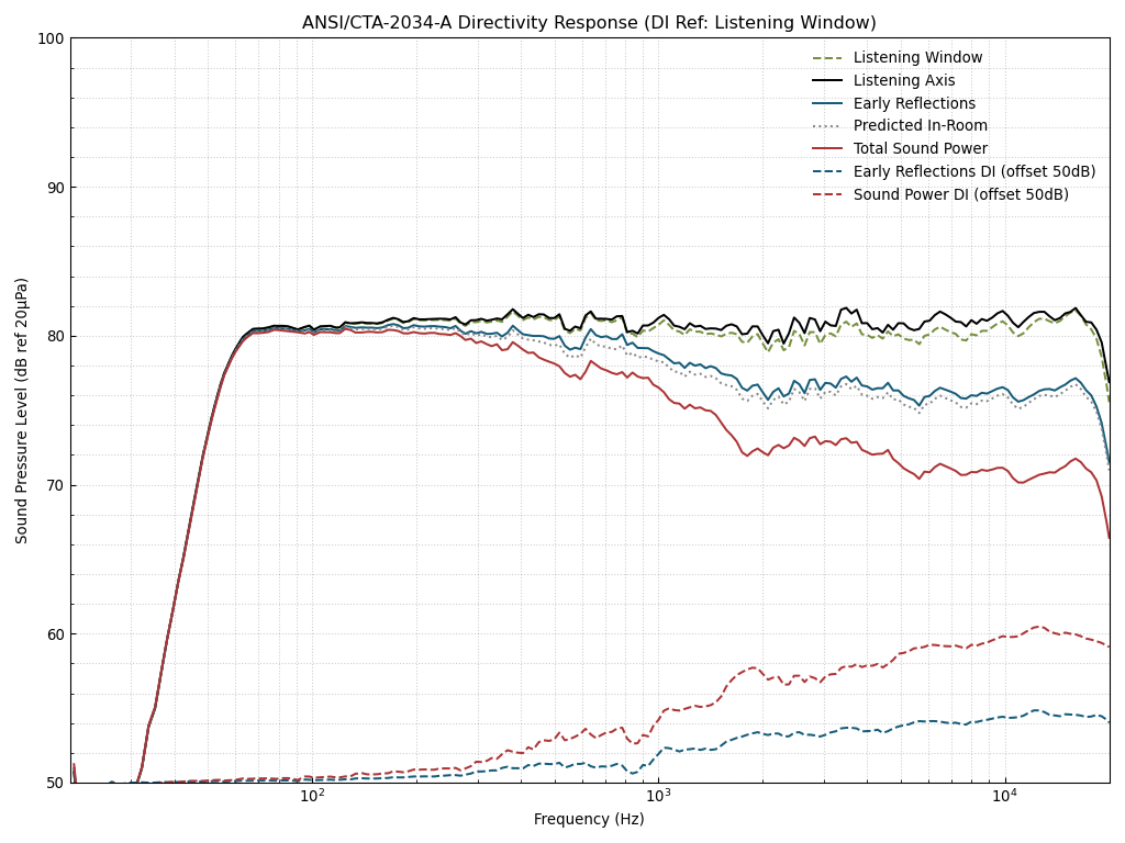

BTW, one of the best rated (according to the Olive metric) speakers measured at ASR is the Genelec 8341A. It's remarkably flat and smooth above 4 kHz but overall and below that it isn't as smooth as it could be. Now the DI is slightly more than 2 dB higher at 10 kHz compared to 1 kHz. Would it be rated even higher with a smoother waveguide with 3 dB/decade DI rise? That is the question.
Curiously enough, also a very highly rated is Genelec 8030C.

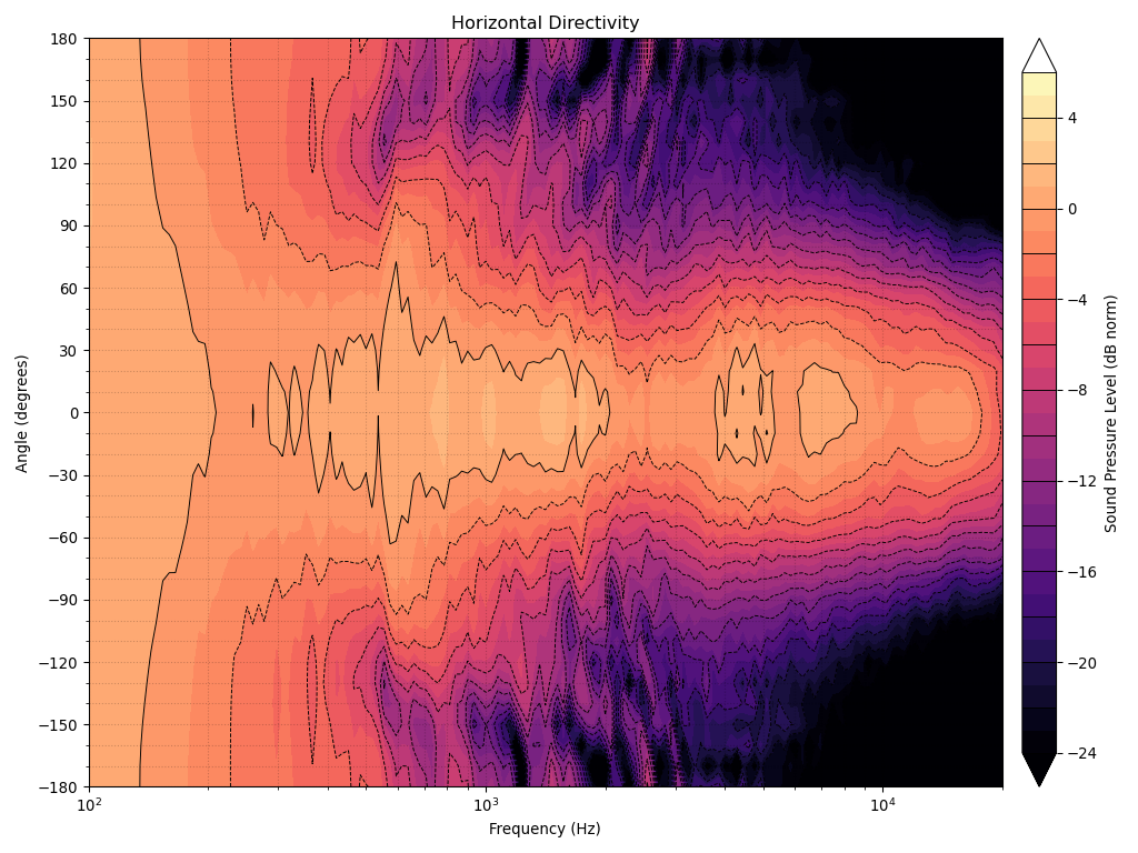

If you ignore LF performance, the three highest preference ratings belong to the Genelec 8030C (8.5), Genelec 8341A (8.45), and Neumann KH80 DSP (8.42). I've attached the spinorama (ANSI/CTA-2034-A) and horizontal contour plots I generated from ASR's data.

My suspition is that the 8341 got worse rating because it would be too bright in the midrange.
Is there a way to input the k parameter in Ath?introducing the parameter "k" OS-SE Waveguide II
It might be interesting to see the scores after equalizing all of them for a flat listening window response.I think you're probably correct. The NBD_ON metric (narrow band deviation, on axis) is markedly worse for the 8341A.
BTW, one of the (according to the Olive metric) speakers measured at ASR is the Genelec 8341A. It's remarkably flat and smooth above 4 kHz but overall and below that it isn't as smooth as it could be. Now the DI is slightly more than 2 dB higher at 10 kHz compared to 1 kHz. Would it be rated even higher with a smoother waveguide with 3 dB/decade DI rise? That is the question.
That's a good question, but hypothetical. As it stands with this data, it looks to me like a non-rising DI is preferred. Doesn't that support my contention? A few dB rise is fine, but smoother and flatter is still the goal.
The mid-range diffraction in the first speaker above is very pronounced. I would suspect this to be an audible problem. The second one also has the lowest diffraction, which should also add to its preference.

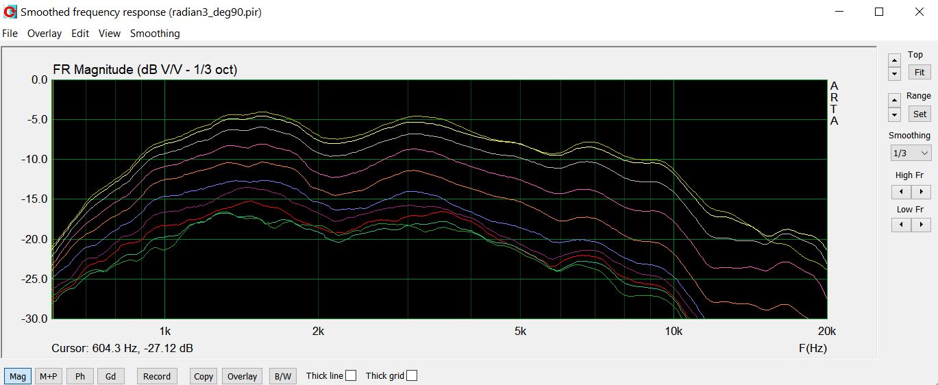

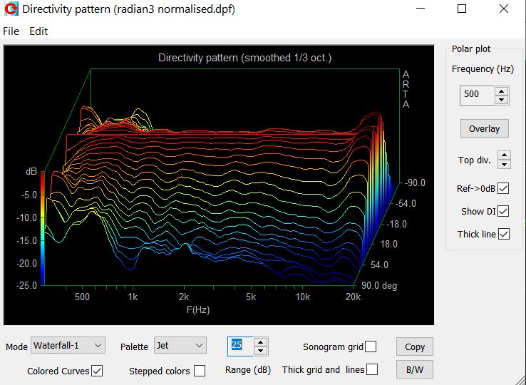

first attempt at polar measurements

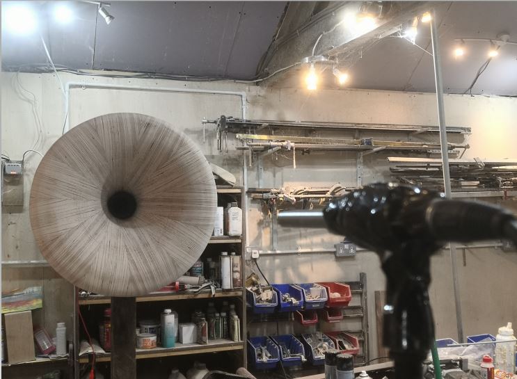

This is my first attempt at taking polars. It's a small Ath4 'magic' horn with a Radian 475be. Promising?
I'd be happy if anyone had any comments.
Here we go I only don't understand what horn was measured - on the photo is that already the huge one with a 2" throat I designed? That Radian is a 1" driver, isn't it. Are you using some throat adapator, or...?
For the start you need to get rid of the reflections by applying a time window on the measured impulse response(s). In ARTA this is done in the "IMP" mode, after an impulse response is measured, by clicking the left and right mouse buttons before the FFT (frequency response) is calculated. This sets the start and end of the window, which should start just before the impulse and end before the first reflected sound arrives. Then you will have proper polars. (I'm not sure now about how to get a correct phase information as I haven't used ARTA in a long time but that's not important for now - it will be important for crossover desing).
