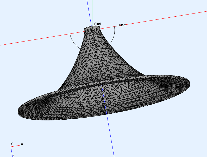

Working on just that. 😉 A freestanding one, to be precise.
Cool man, did I miss it? 🙂 Fast moving thread...
It's not that better. Obviously, the axial symmetry is still detrimental to axial response.
Now the interesting part will be to find a way how to make it better still, without losing the directivity too much.
It may help to increase the depth slightly and reduce the opening angle somewhat. The previous ones are 90°?

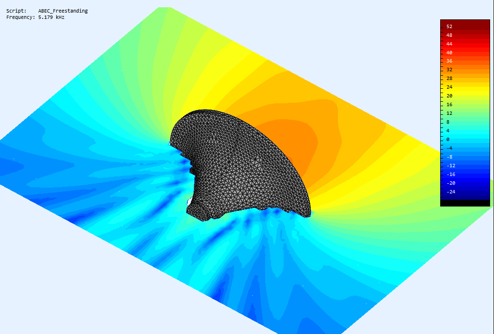

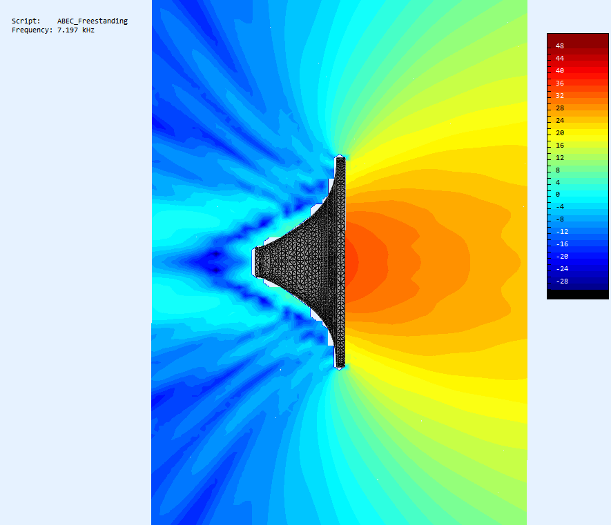

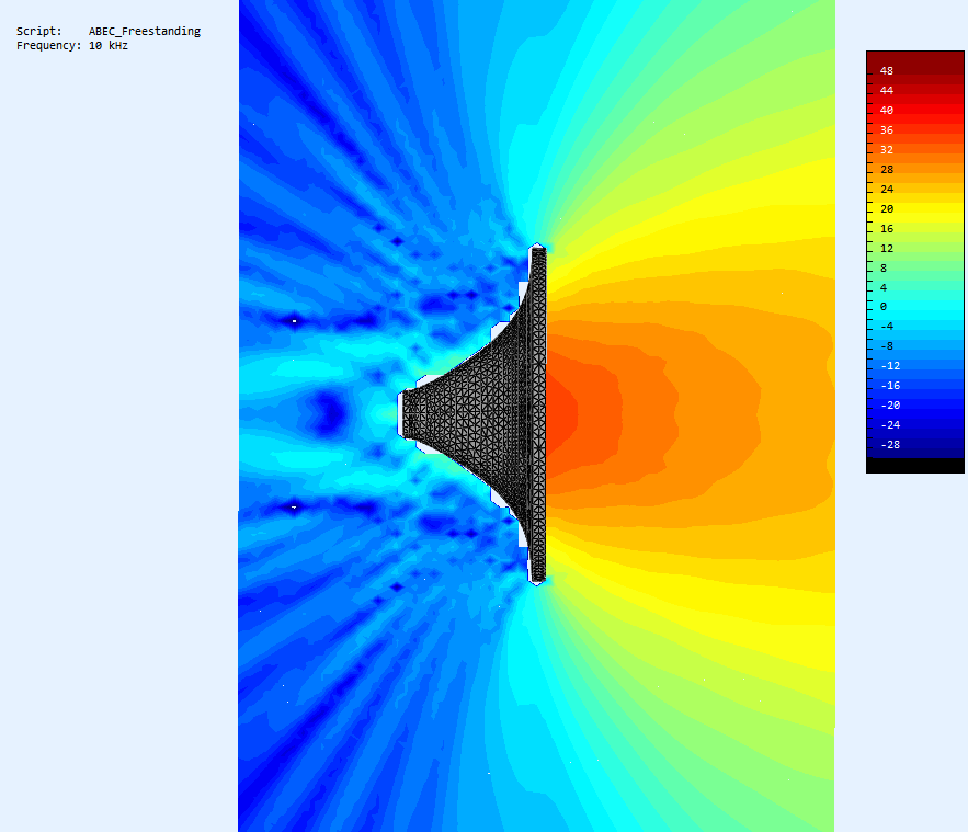

The rear side scatters the sound quite a bit -
(Elliptical waveguide with 15 mm thick wall.)
The question is whether the scattering is problematic / bothersome, since the level seems to be quite low.
It might be interesting to simulate a free-standing axisymmetrical exponential, tractrix or spherical horn of similar size and with a similar mouth for comparison.

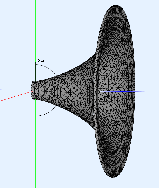

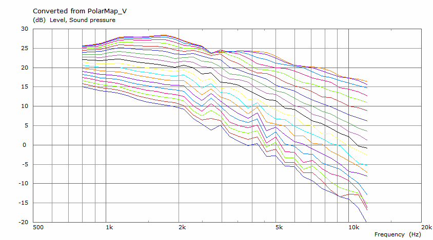

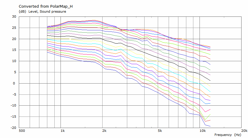

These are the polars, BTW.
In reality this would still be excellent, and the difference between this and 'perfection' might negligible.
The increased depth seems to push the resonances further off-axis.

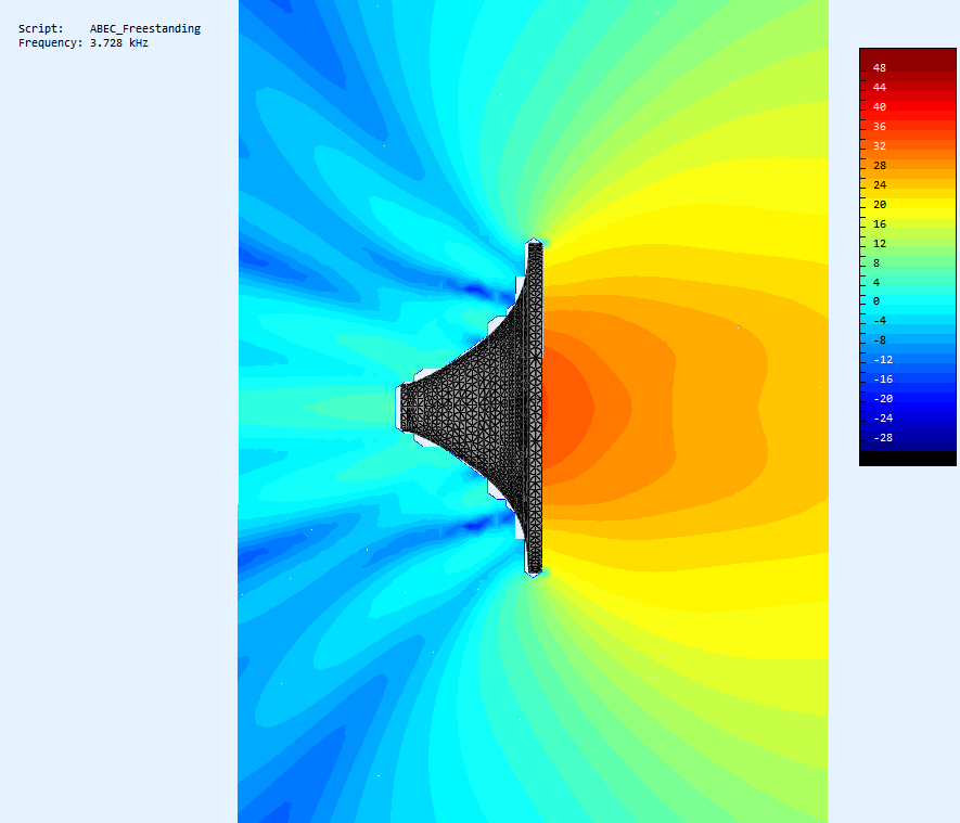

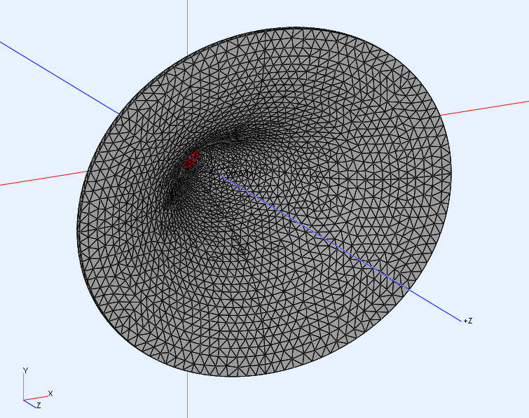

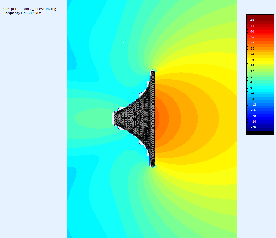

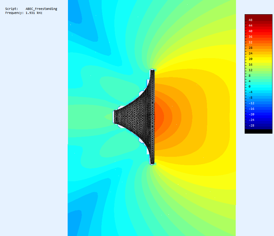

So, here is a comparison of a flat and "fully modeled" rear side of a free standing waveguide. Axisymmetric, ⌀300 x 100 mm.
Flat rear side:
Fully modeled rear side:
That is a very useful comparison experiment, thanks for posting it. There is the expected diffraction but the levels are low. Very nice work.
Also very good pics, the wavefronts are well behaved. IMO that scattering is low and is expected to be greater at lower freq. Maybe a round over would help. What were you aiming for ?

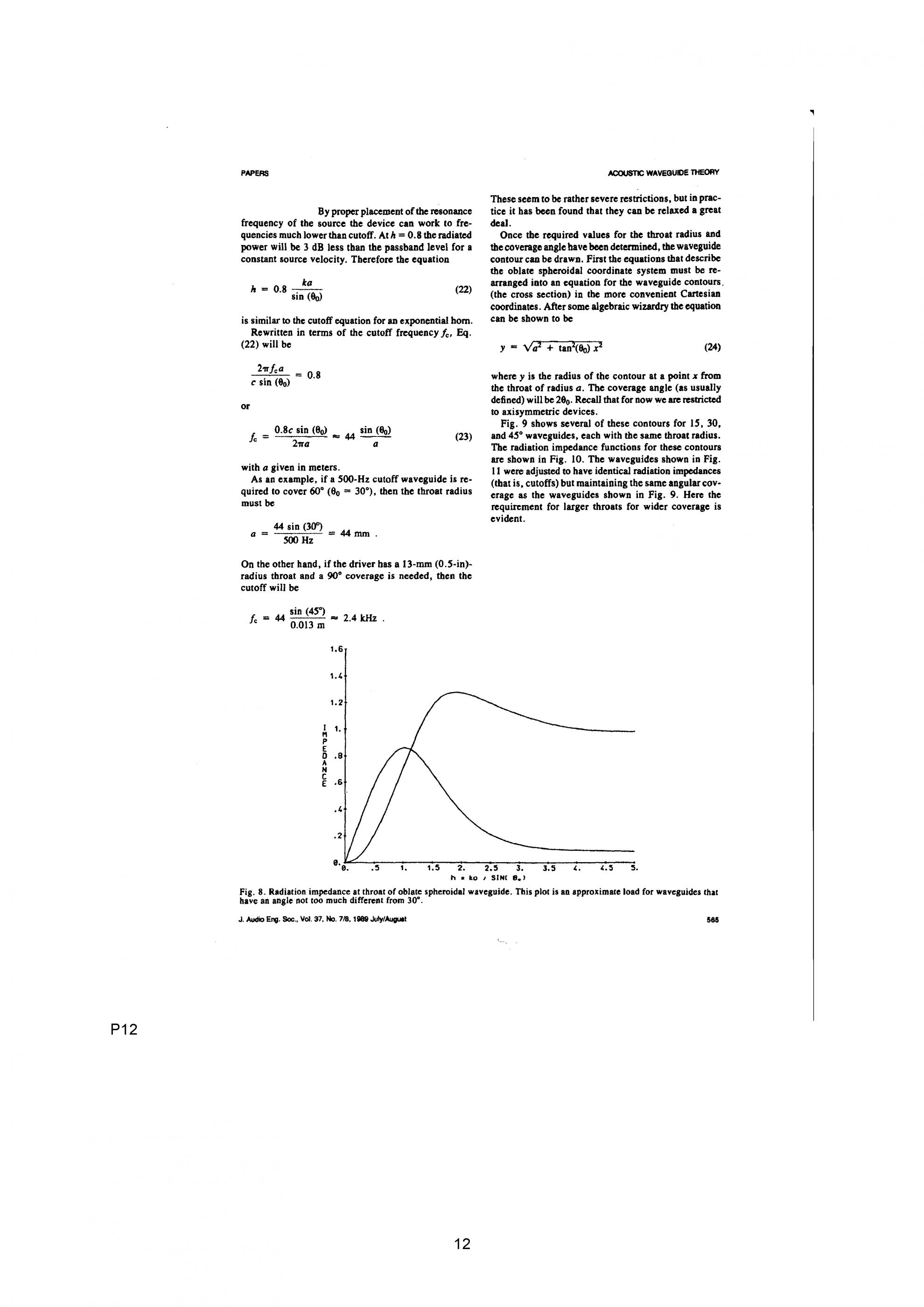

Cutoff of Acoustic Waveguides:
Do you have a larger image or a reference.? I'd like to actually read it.
I usually post such pictures when I have some new functionality, as in this case (the automatic generation of the rear side). No particular aim, just random examples.
That paper appears in JAES in July 1989.
