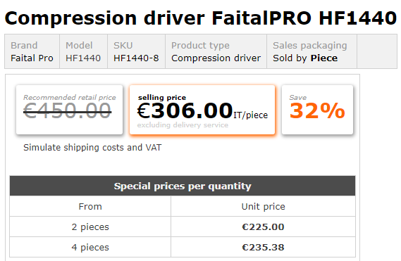

Slightly off-topic - I've just ordered new Faitals HF1440 for €225/piece. Hope they are worth it! :)
Nice!
I'm sure they are worth it.
You've ordered here, I assume?

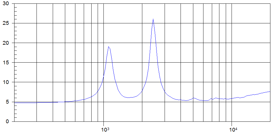

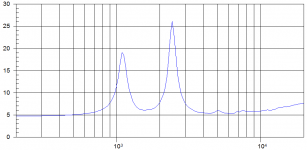

They say 700 hz but watching the impedance curve, 700 hz is 40 ohms... are they not a little bit optimist and should have said 900/1000 hz cut-off for this driver:confused:
I wouldn't hesitate to use this driver from 600 Hz and 450-500 Hz is probably ok, as is for it's smaller brother, the HF200.
The HF1440 has a 3.4" diaphragm compared to 2.91" of the HF200.
Impedance plots are a bad indicator of compression driver capabilities.
Some people use this 1", crossed at 800 Hz for livesound applications at very high SPLs:

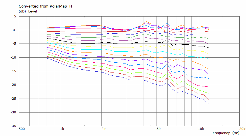

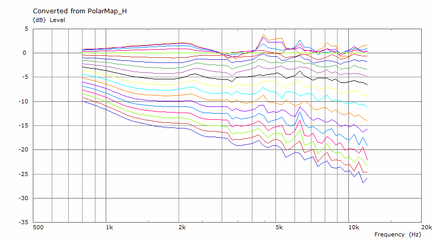

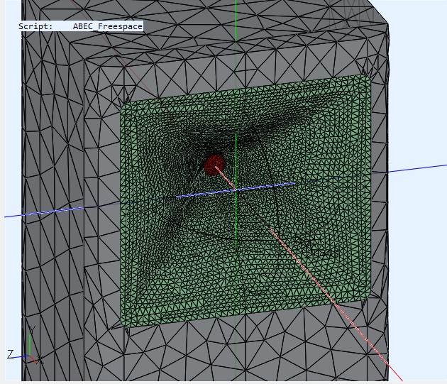

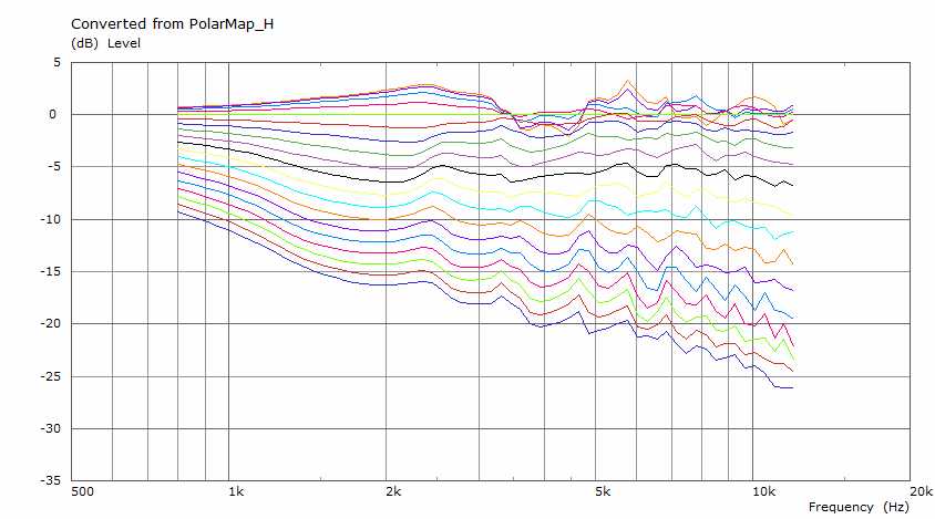

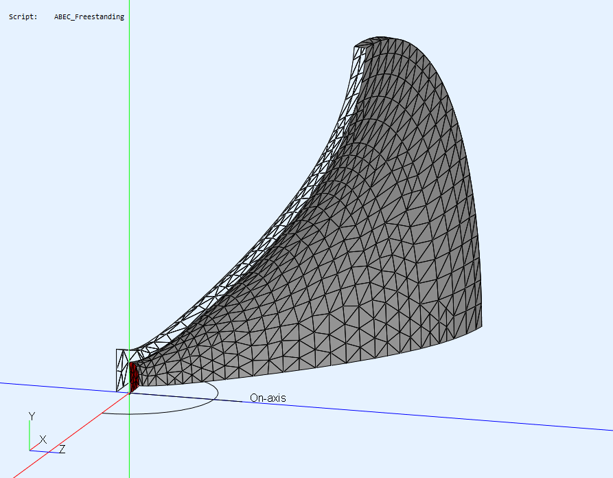

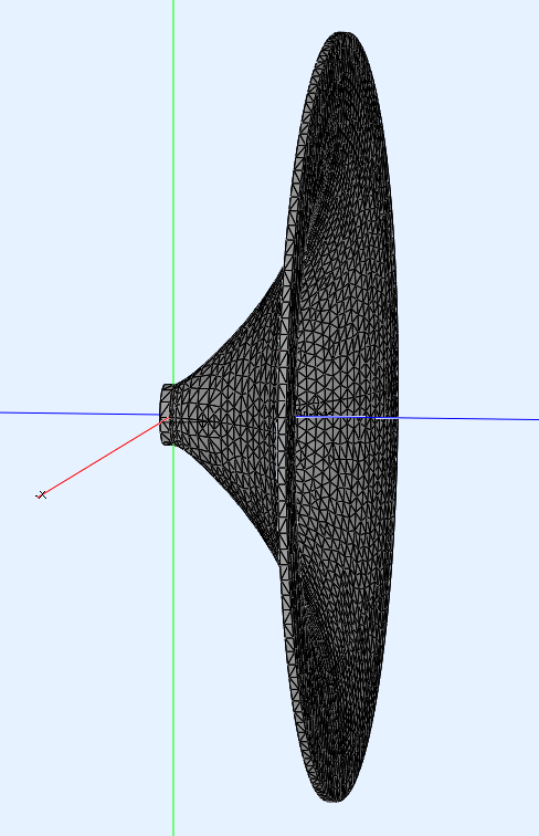

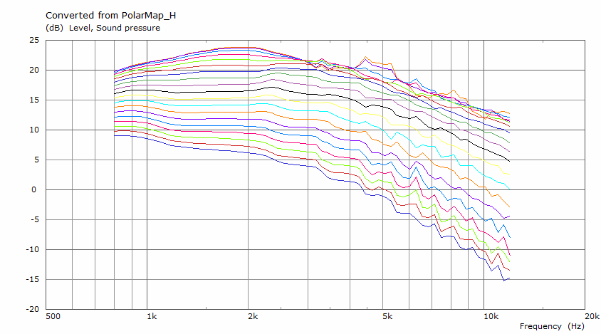

So, here is a comparison of a flat and "fully modeled" rear side of a free standing waveguide. Axisymmetric, ⌀300 x 100 mm.
Flat rear side:
attachment.php
Fully modeled rear side:
attachment.php

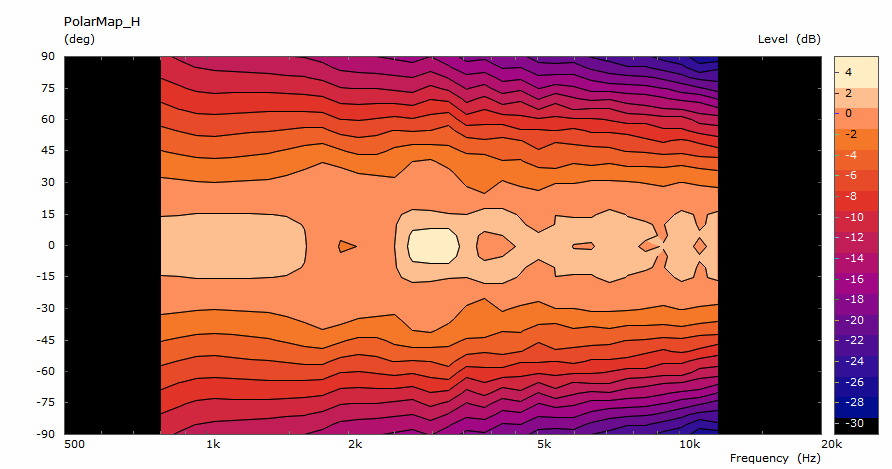

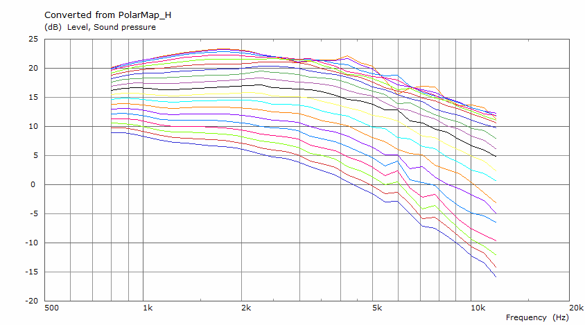

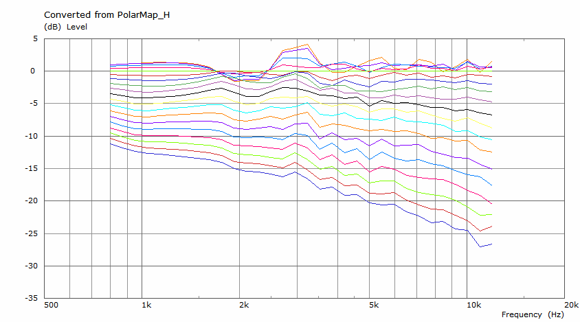

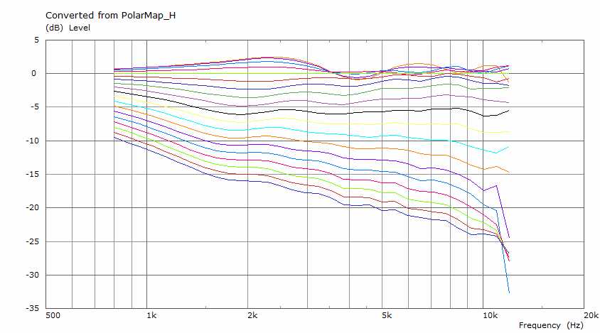

A bigger still - ⌀360 mm (q from 0.995 to 0.999). Now it would be helpful being able to measure the real thing. Although noticeably smoother, there are still apparent some high Q resonances and I wonder how real they are.
The last two examples are for a modeled rear side.
attachment.php

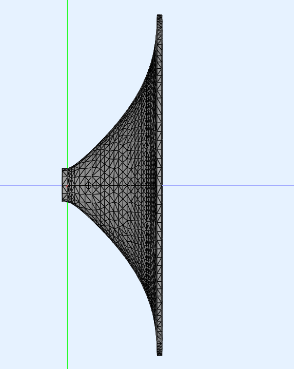

It's not that better. Obviously, the axial symmetry is still detrimental to axial response.
Now the interesting part will be to find a way how to make it better still, without losing the directivity too much.
attachment.php
