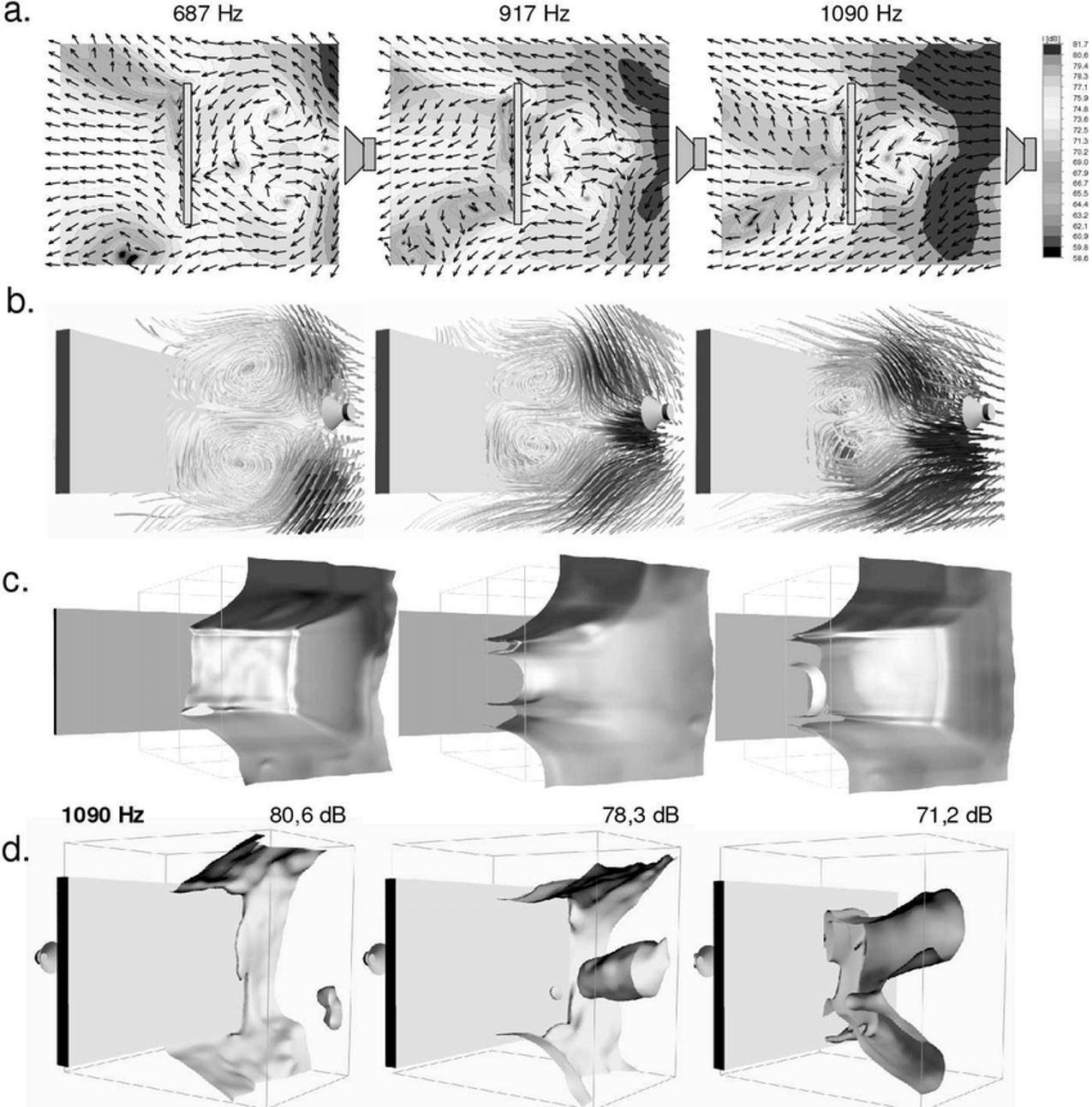

We are looking at Intensity (power / unit area) which is the product of the Velocity vector and the pressure. Just like electrical power is the product of current times voltage.
Mabat, Normalizing may be very misleading, I'd try log. Or just show a few planes closer to the mouth unnormalized.

Well it is a little more complicated, as the intensity is a complex quantity, at least in this case, as is the pressure. It's still not clear to me how to visualize that. All the above graphs display the real part (in the x and y directions, forming a vector). Is that what we should look at? I'm really not sure about the physical interpretation.

- Finally I have the OS coordinates (it took me a while to realize the relation between the throat radius and the foci distance). I can now draw them as a background grid and/or display the two vectors as mentioned before. But I guess I should take a damping-terminated waveguide to remove the mouth related issues, is that right?

I could make it purely real by using only the magnitudes of the averages and differences of the pressures that are used in the calculation. I may try that. I'm only not sure it would tell the whole story.
