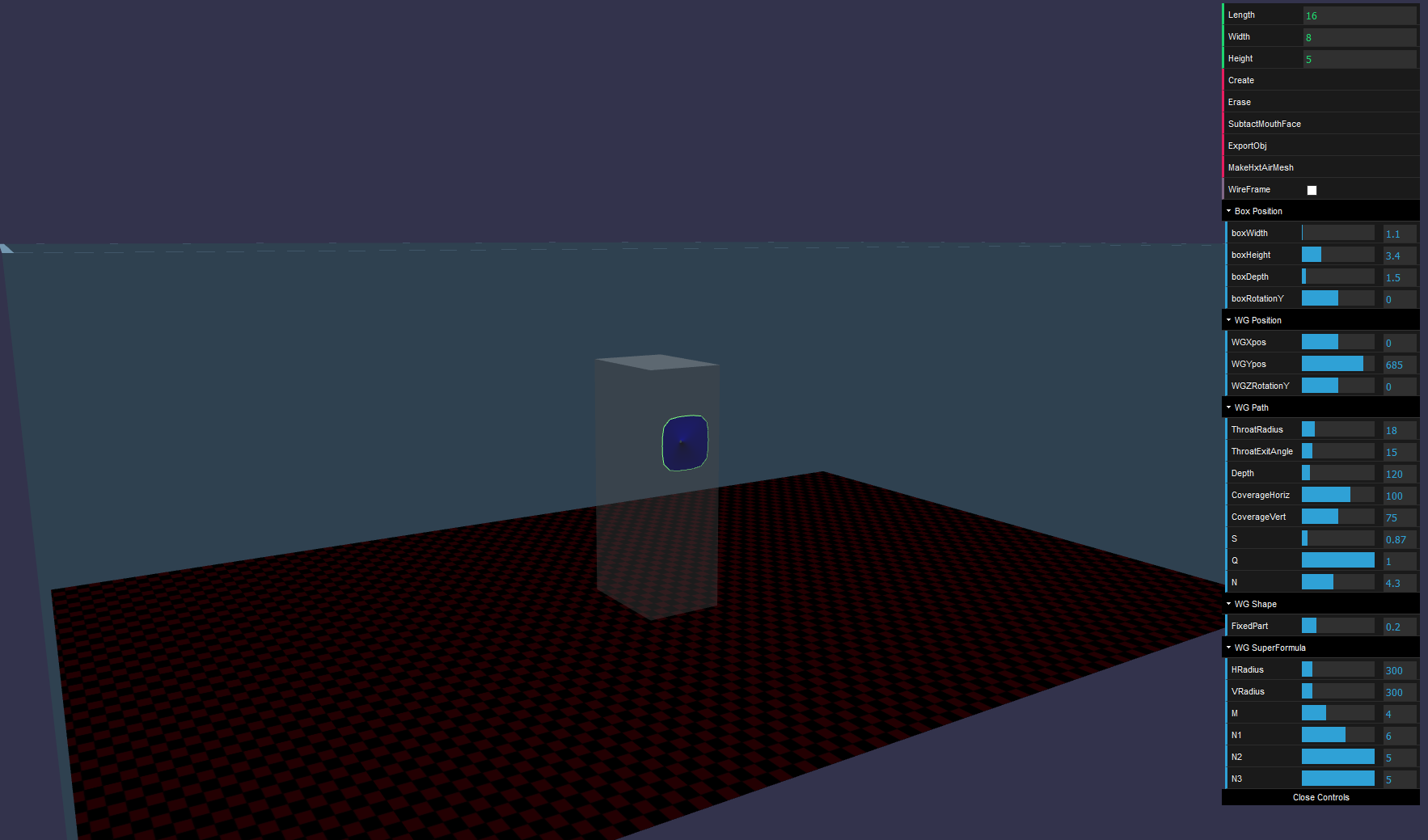

Hey all.
I've been away for some time but making progress on a BabylonJS waveguide editor and simulator based on earlier ATH4 ideas.
1). tetgen compiled to js with emscripten.
2). subtract speaker from room = air
3). create a tetrahedral mesh of the air
4). use babylonjs AmmoJS physics engine to apply soft body physics to each tetra.
5). apply a vibration to the throat facet
Theory is we will see a wave emit from the speaker. Will share the code on GitHub soon.

Are these physics engines really capable of solving equations of acoustics? I would think they are for the real-time mechanics of solid bodies (like games, etc.), but acoustics?
ammojs is a compile of "bullet physics" to js for ue with BabylonJS
GitHub - bulletphysics/bullet3: Bullet Physics SDK: real-time collision detection and multi-physics simulation for VR, games, visual effects, robotics, machine learning etc.
We have some tools at our disposal such as particle ray casting and colision and reflection

I'm heading in the direction of small pockets of air (tetrahedral) being a soft body and applying a vibration of thee throat surface, ie 26mm a flat round facet. So should see a "shock wave" propagate. I can change the colour of the tetra based on the "energy" contained within the soft body.
I'm not expert by any means. Hobby coder that likes to dabble.
