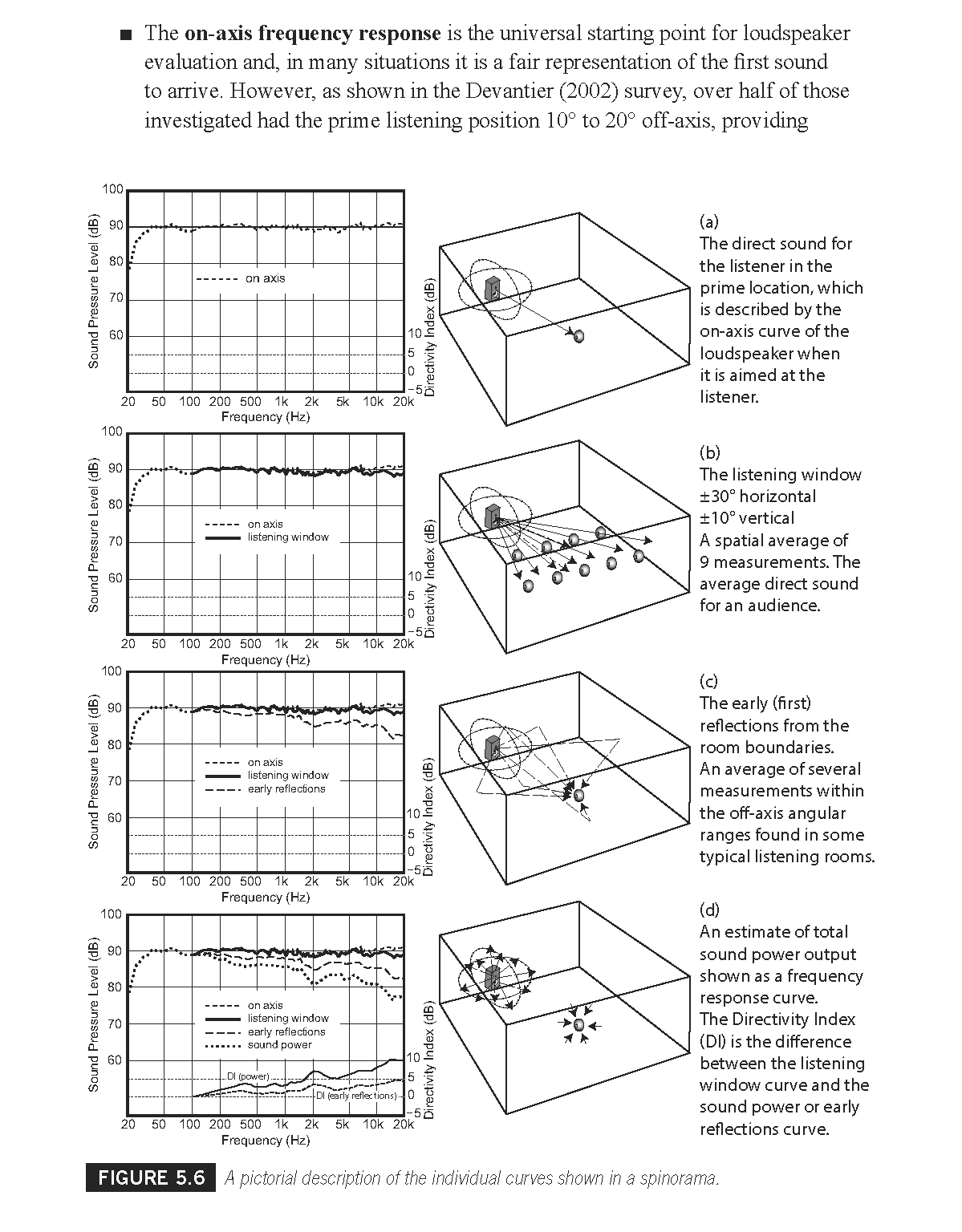

According to Toole:
Directivity index (DI).
Traditional DI is defined as the difference between the on-axis curve and the normalized sound-power curve. It is thus a measure of the degree of forward bias—directivity—in the sound radiated by the loudspeaker. It was decided to depart from this convention because it is often found that, because of symmetry in the layout of transducers on baffles, the on-axis frequency response contains acoustical interference artifacts, due to diffraction, that do not appear in any other measurement. It seems fundamentally wrong to burden the directivity index with irregularities that can have no consequential effects in real listening circumstances.
Therefore, the DI has been redefined as the difference between the listening window curve and the sound power. In most loudspeakers the difference is small; in highly directional systems it can be significant. In any event, for the curious, the raw evidence for the classic DI is there to inspect. Obviously, a DI of 0 dB indicates omnidirectional radiation. The larger the DI, the more directional the loudspeaker in the direction of the reference axis. This is illustrated in Figure 5.9. Because of the special importance of early reflections in what is measured and heard in rooms, a second DI is calculated, the Early Reflections DI, which is the difference between the listening window curve and the early-reflections curve. Because of the importance of early reflections in common sound reproduction venues, this is arguably the more important metric.
All of this is summarized in Figure 5.6.

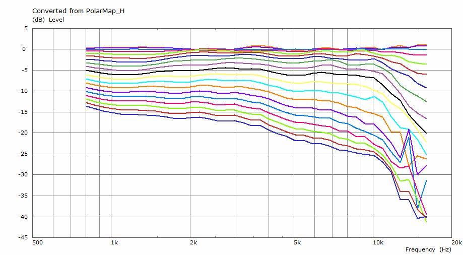

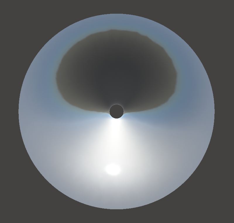

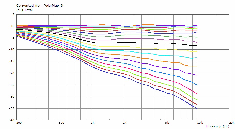

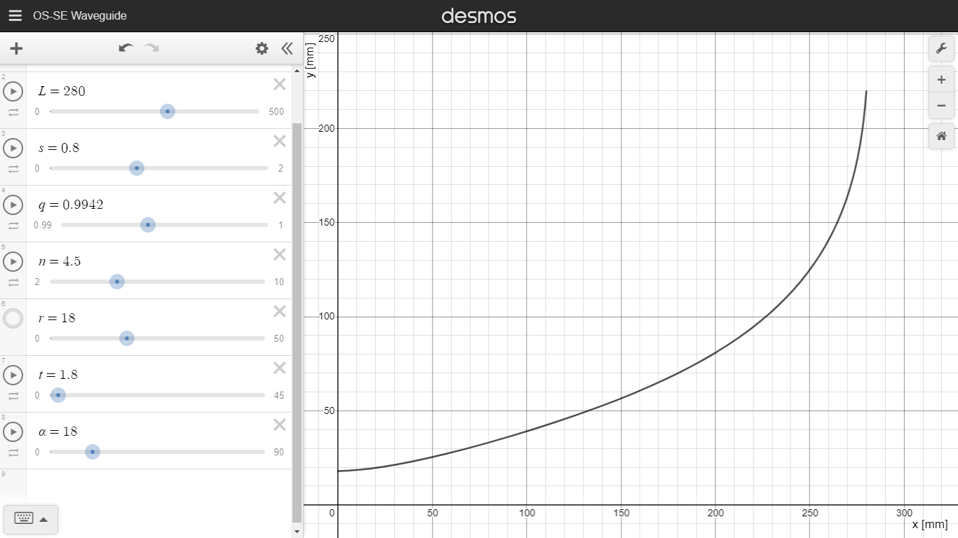

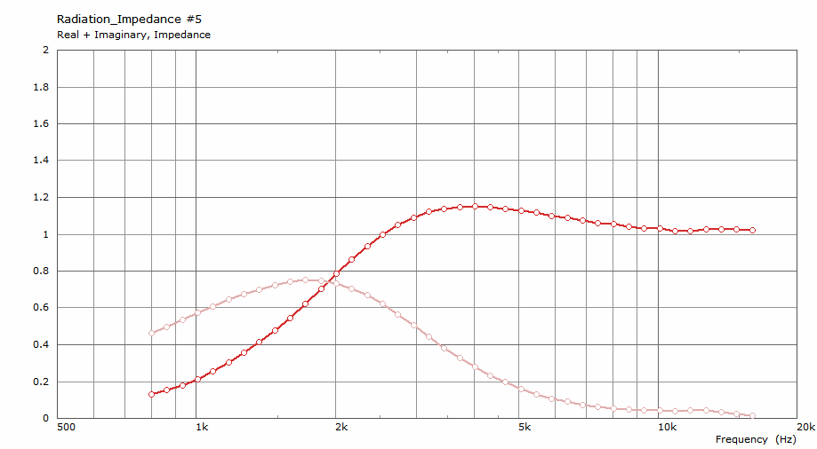

Out of curiosity I've tried the Tritonia waveguide freestanding - just the bare waveguide (1,4" throat):
The impedance is still without a hint of reflection which is what strikes me the most. I almost have doubts if I set up the simulation properly. Either I do something wrong or are doing so all the guys with those terribly wavy impedance curves...
Can't wait to see it measured in an enclosure.

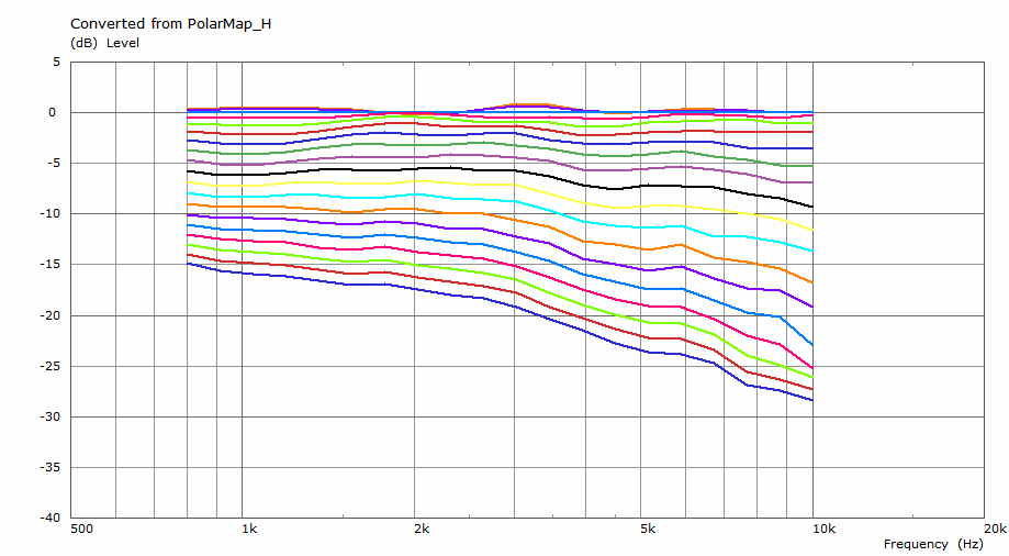

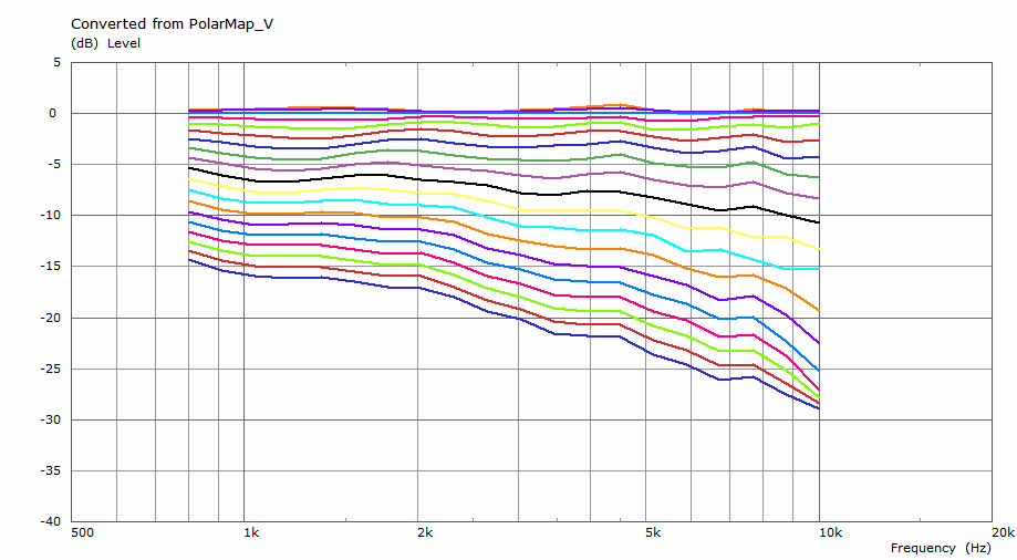

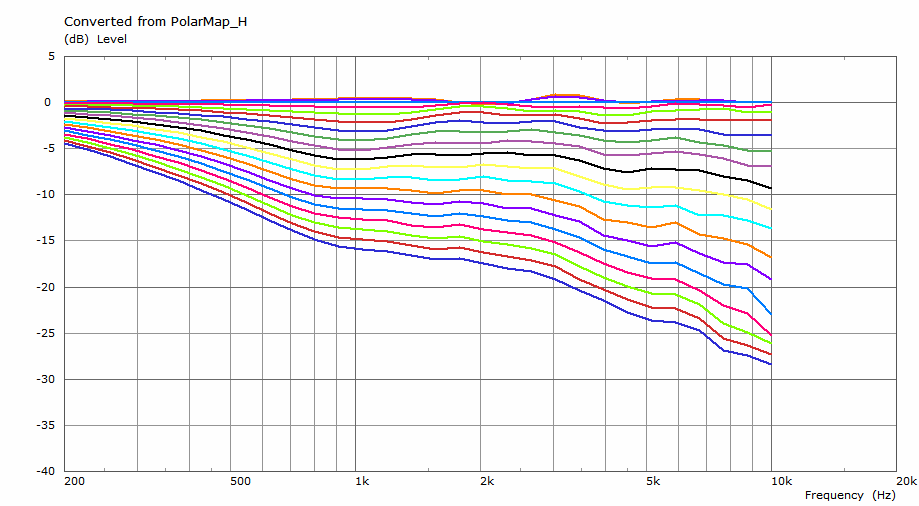

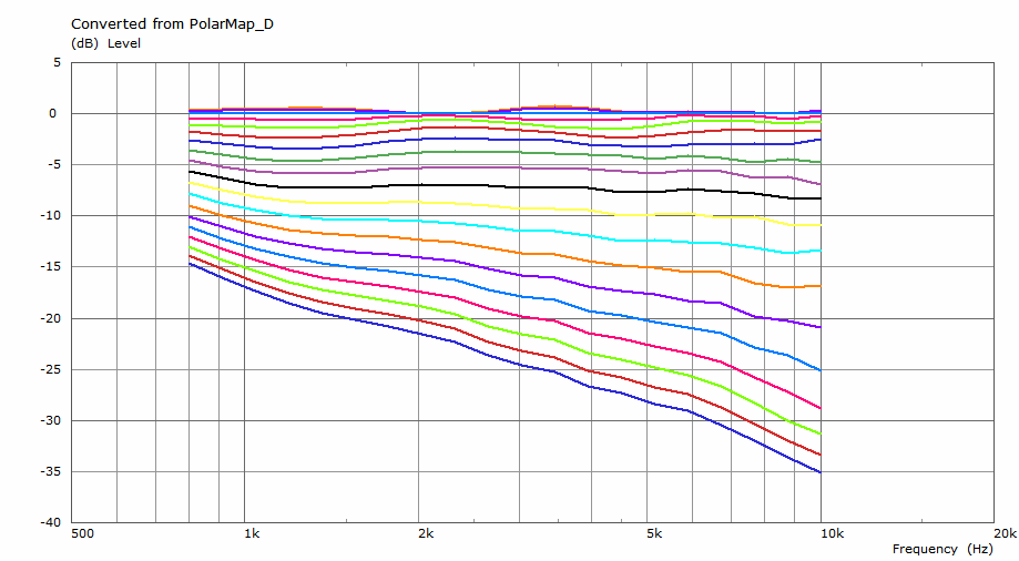

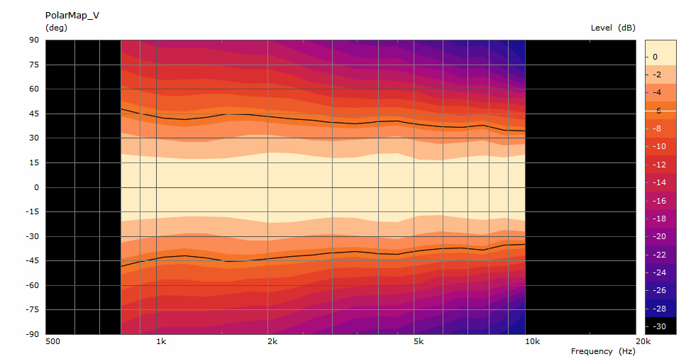

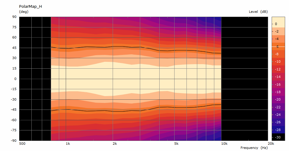

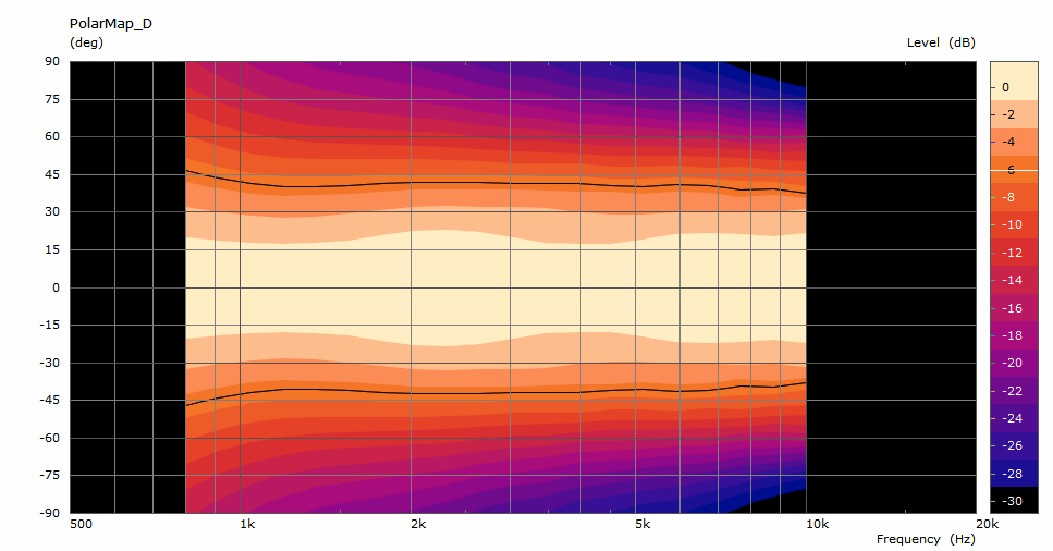

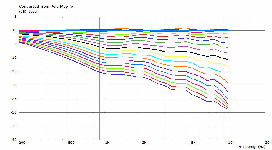

Made a little longer (180 mm) with coverage more like 85° (the previous was wider, around 100°).
Horizontally, vertically and diagonally - the DI would be pretty flat in this case.
