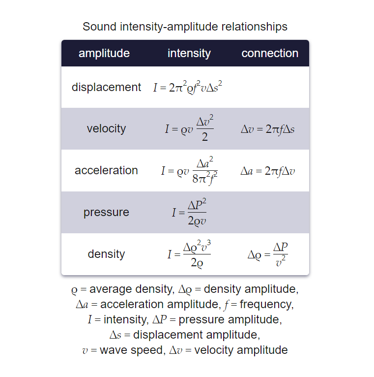

Well it does display the intensity along an arc
Is the plot truly intensity? You said earlier that it was SPL. The two are not the same. I'd love to see a plot of intensity flow in the waveguide.

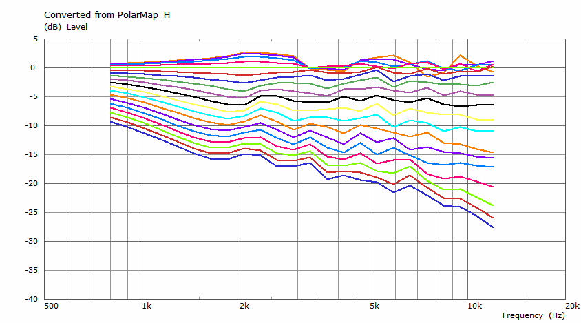

These are the corresponding far-field polars. It is 2x45 deg nominal coverage (the black line) so I'd say it's just about right (?).
It does seem just about right.

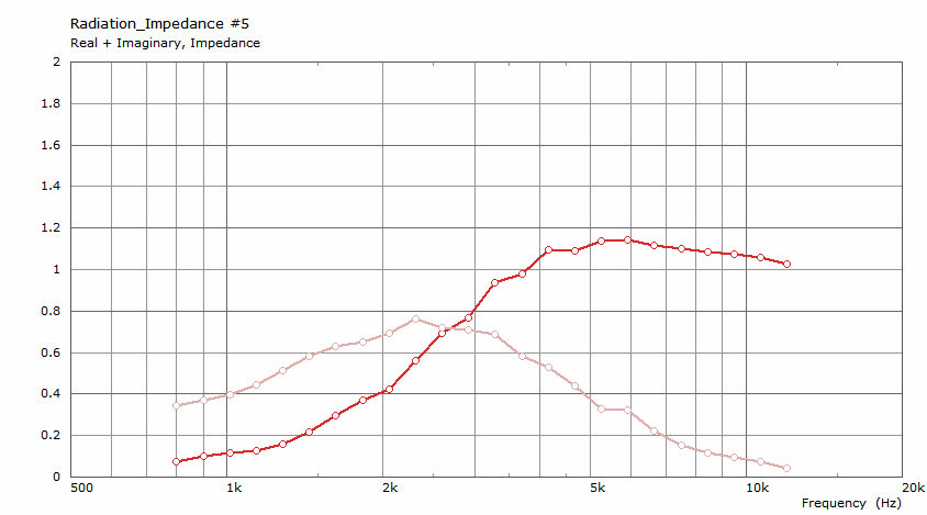

Maybe the above are just some numerical problems, I don't know. It's hard for me to believe that longer cylinder would be worse. Or could the two more separated diffraction points cause this?
The plots would indicate that more energy is actually reflected back down the throat. Like if there would be a stronger impedance mismatch at the first edge (maybe caused by the second edge?).
