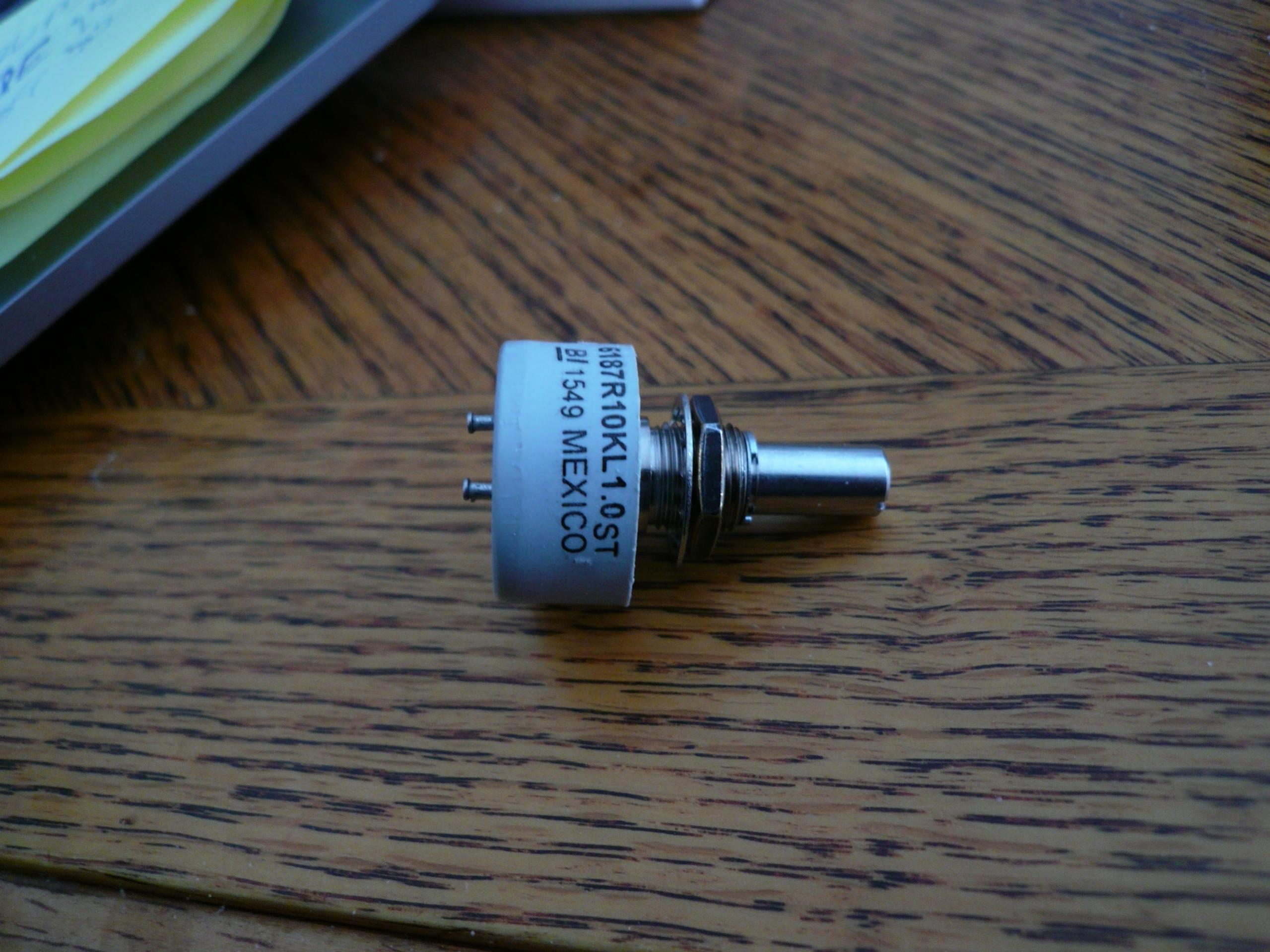

Wondering if anyone can advise on power rating for volume and tone pots on the DD Servo OTLs. They're a bit scratchy and I want to replace them. Right now they are 1watt pots. Available quality upgrades are quite a bit lower in rating, like typically 1/4watt. How critical is it? TIA

Try some Nu-trol control spray cleaner for the pots. Give them a shot of the cleaner in the openings where the 3 terminals are. Power off of course;^)Wondering if anyone can advise on power rating for volume and tone pots on the DD Servo OTLs. They're a bit scratchy and I want to replace them. Right now they are 1watt pots. Available quality upgrades are quite a bit lower in rating, like typically 1/4watt. How critical is it? TIA
thanks. I have deoxit but these are now 40 years old. I bought some new ones. I have 3 pairs of these amps and I'm noticing they vary in the action of the pots in that one may feel smooth while another feels like a spike digging and dragging as I turn it. Time to change them🙂
