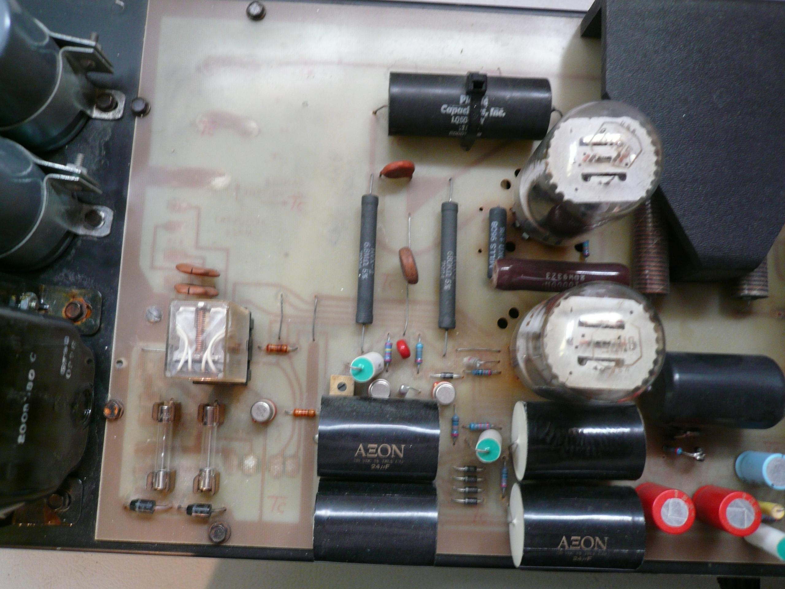

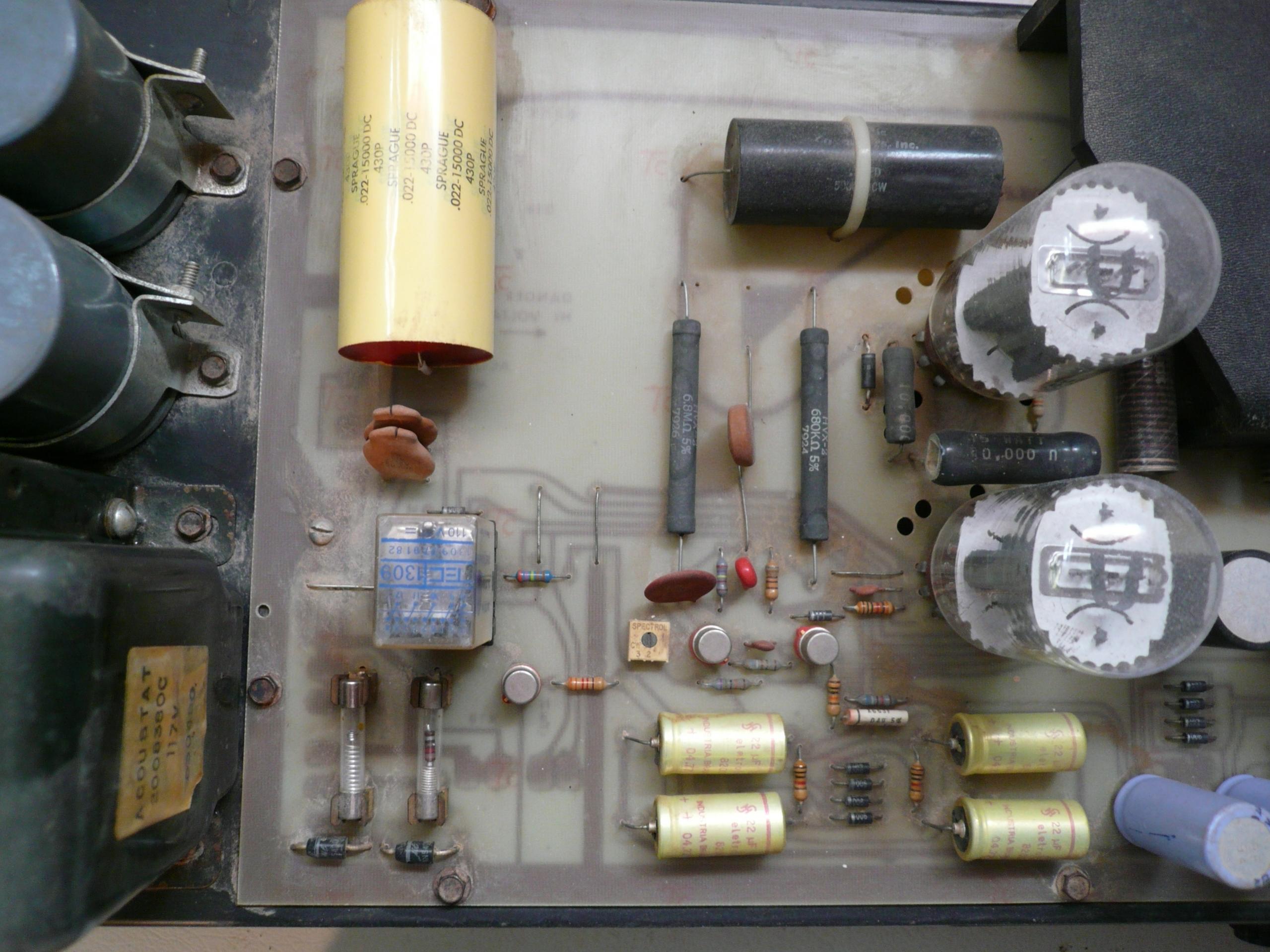

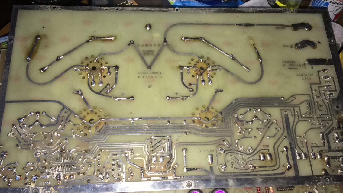

Andy, can you lend some insight on possible issues with two of my servo amps. I have the trouble shooting guide but it does not deal with, I'm hoping the obvious. I've got 4 hooked up with the same signal. One pair(consecutive #) exhibit not really the white noise described in the guide but more of a low key scratchy noise. It's not loud but I can just hear it at my listening position 12' away between tracks and until they go back into standby. Not after that. If I turn the volume pots back and forth quickly it's better/worse, louder/softer, popping, like a dirty pot. One of them goes quiet on full volume, the other somewhere lower. Just dirty pots? My concern is that it's in one of the 'pairs'. Both pairs have been rebuilt with better parts in the past but to spec and they are a bit different in terms of specific parts count. They otherwise function as they should. Curious pots would go bad simultaneously in the same pair. TIA

Low key scratch noise can be from the high voltage feedback resistors.

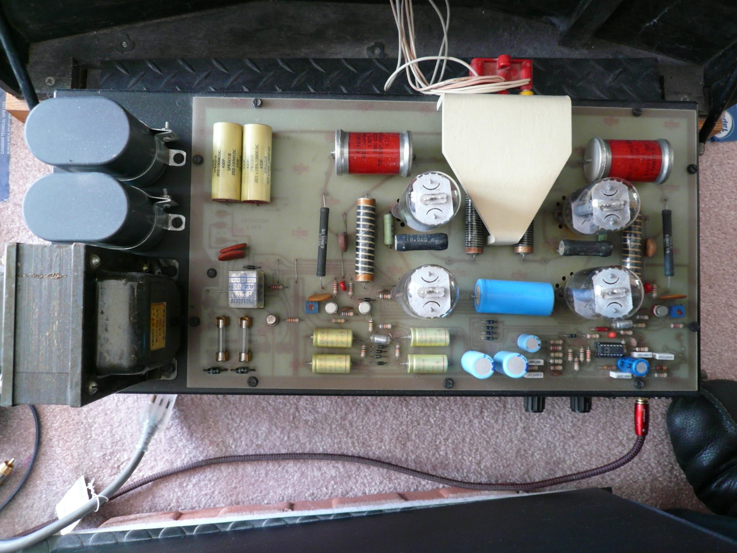

Do you have pictures of the amps so i can see what has been done on them?
Because of micro arcing there can be loss of conductivity on some HV parts causing crackling noises.
Also dust and humidity (especially this combination) can give problems here.

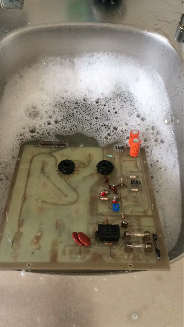

I had many amps to restore (some modified to death) and somethimes could save a set by cleaning them and replacing all vital components.

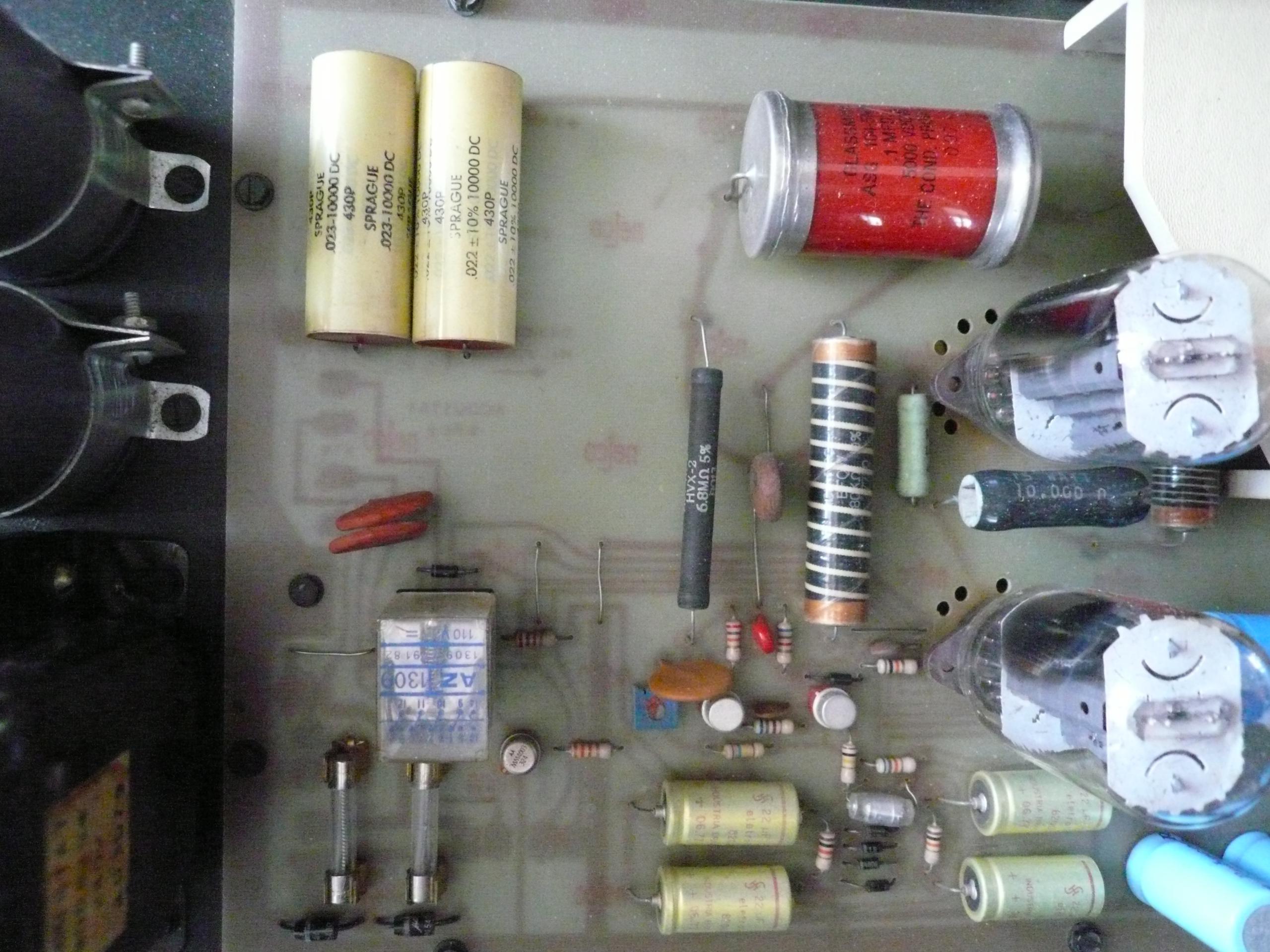

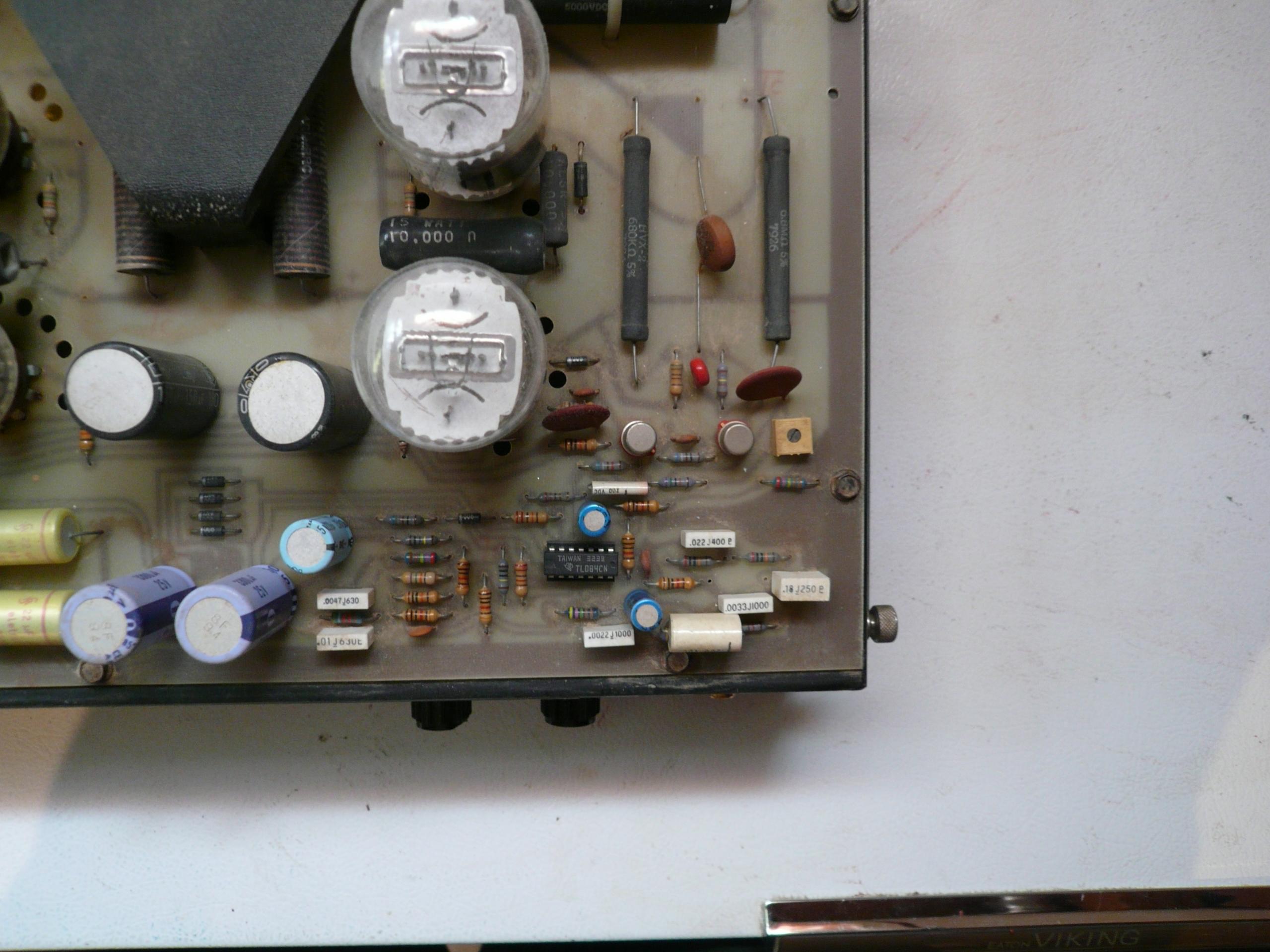

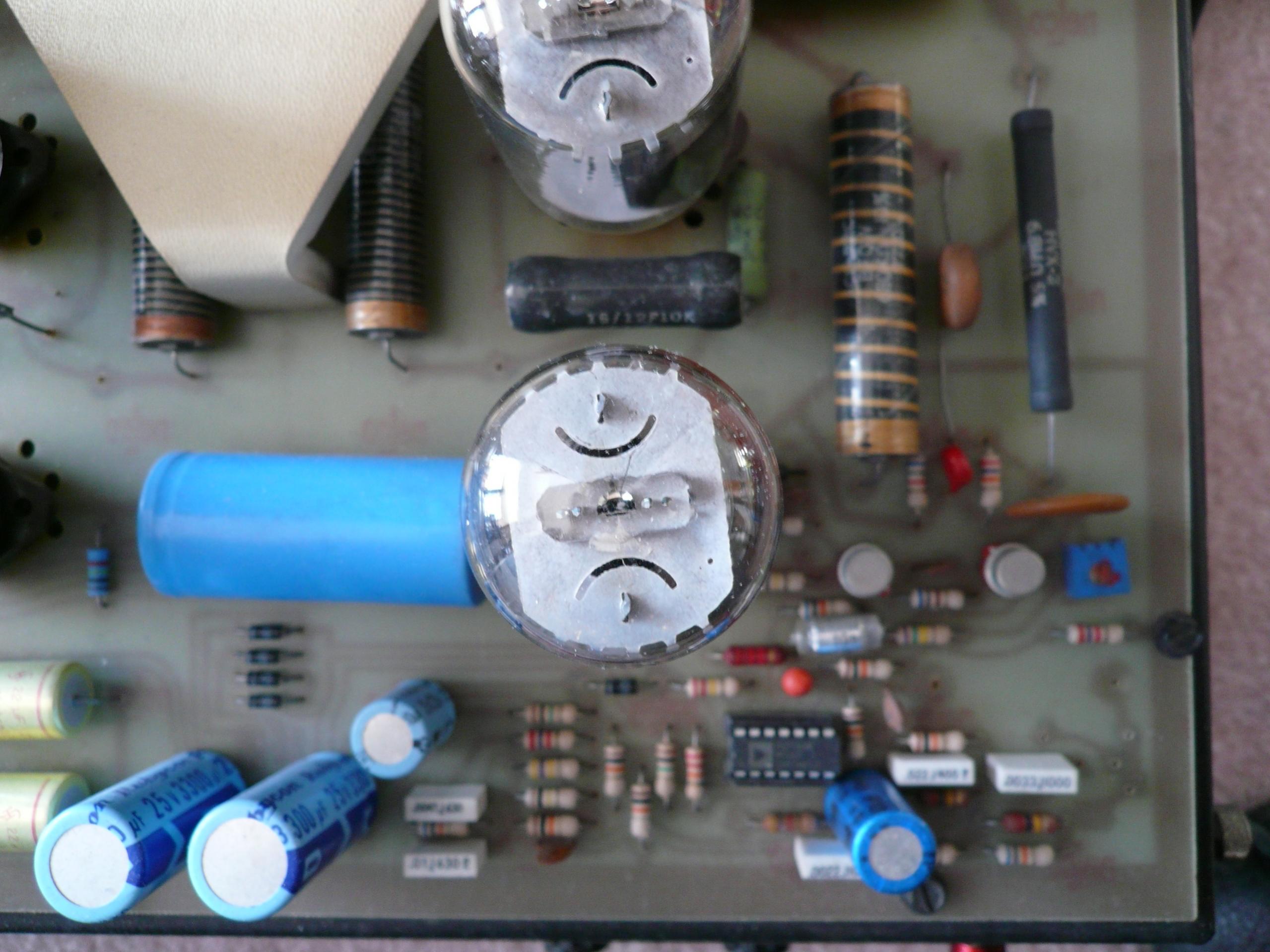

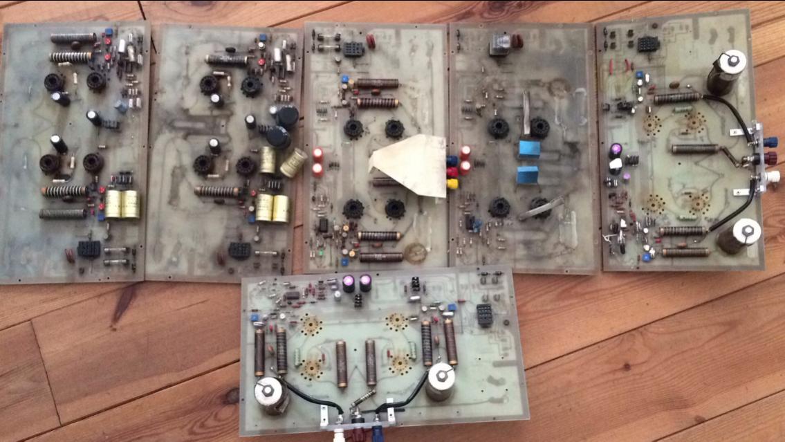

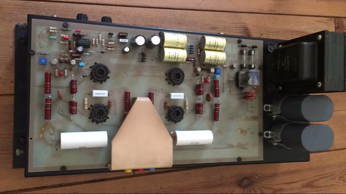

Could this be the case even when the pots behave as if dirty? 1-3 is of one pair, 4-5 is the other. The last pic is of a non functioning 3rd pair
If pots behave dirty then it will be gone while moving them a bit (or scratch when moving). I do not recall ever having a bad pot in any of these sets. The original pots are of great quality. That is why i think it is not likely. You mentioned the same behavior on both amps at the same time...
It sounds to me that it is caused by your preamp (source) not the poweramps. Can you test this first?
The first amp has the "old" HV resistors i have mentioned that will slowly die... the other amps use different (black) HV resistors (maybe already replaced). So it is unlikely that these show exactly the same issue at the same time.
Think about a common situation they share like a mains cable or as mentioned before the sources.
Do you switch them on/off manually or is the autoswitch circuit still in service (as it should! )?
