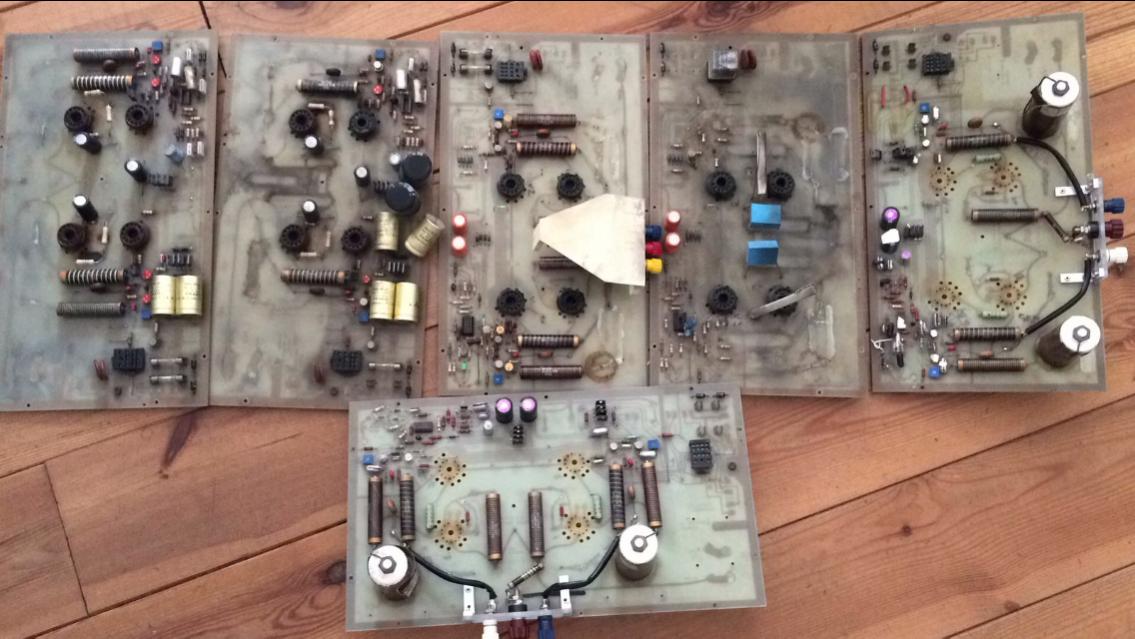

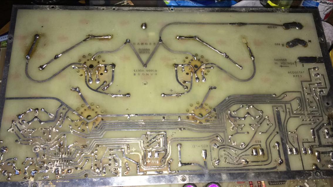

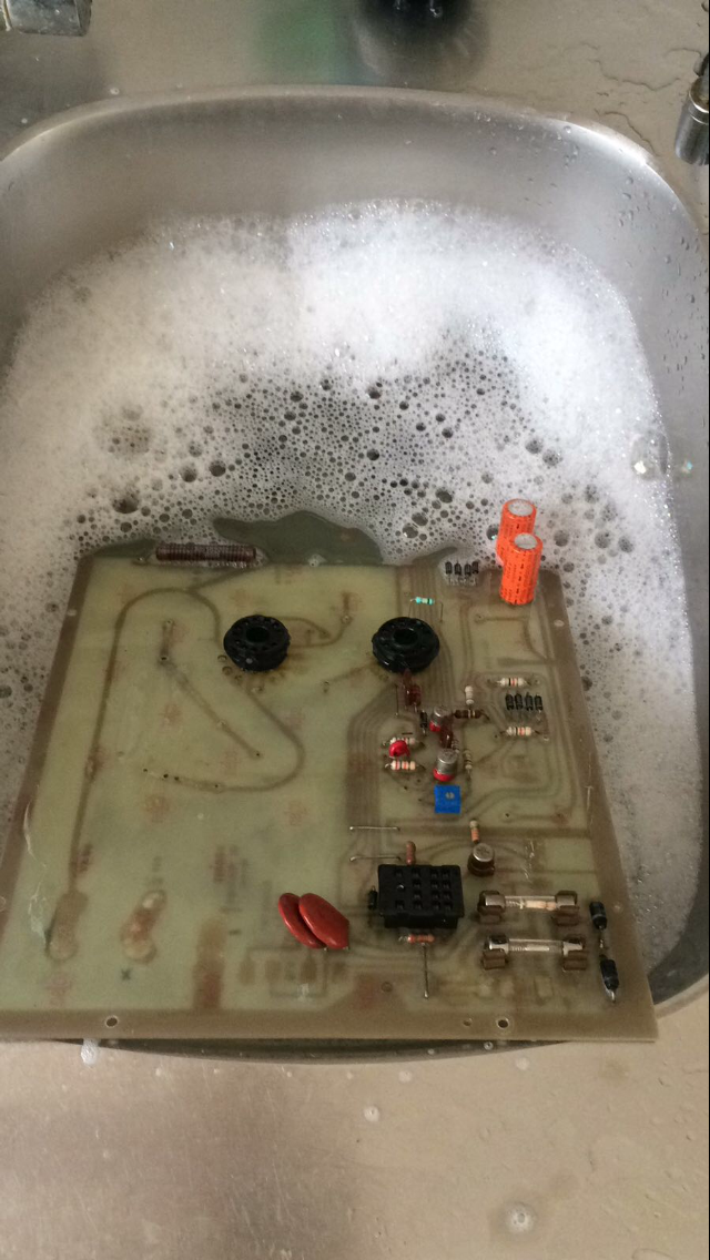

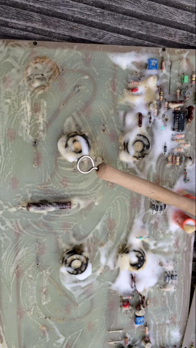

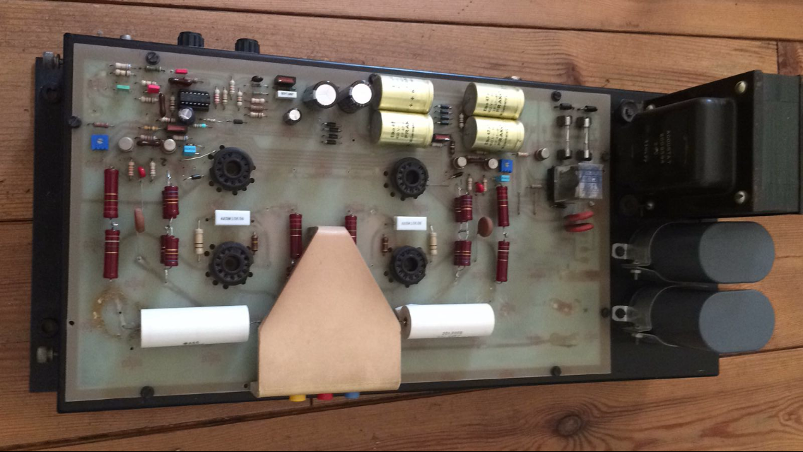

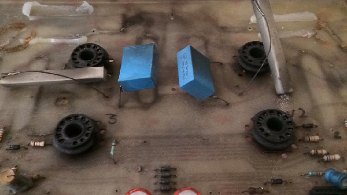

Some pictures of old Acoustat amps before and after cleaning (some beyond repair).

That's an interesting thought! I presume you're talking about cleaning up the interface unit on the back of the under-performing speaker? Can I do that with my Office Depot "Duster" that fires compressed air at my computer keyboard when needed? The whole soap-and-water routine looks a bit scary, plus I'm not sure about taking that sucker apart beyond disconnecting, discharging, and dismounting.
The "high voltage soot" will not blow off with compressed air. If you see an accumulation of black on the printed circuit boards, there are commercial spray-on chemicals specifically designed for cleaning printed circuit boards. You'll probably also need to scrub with a stiff non-metallic brush.
But...a small amount of the "soot" is normal and may not be the issue with your interfaces. I suggest you replace the 5 capacitors in the bias voltage multiplier. These caps may be going off-spec when the humidity is high. And, since these caps don't last forever anyway, I suggest replacing them in both speakers.
