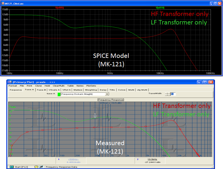

I've got some leftover parts and am itching to make a pair of poor-man's Spectra 11s: I plan to use Mk-121C non-medallion HF transformers alone driving 8" panels, along with a single Velodyne Impact-10 subwoofer. The sub has a claimed range up to 140 Hz but the control on the back goes from 50-200 Hz, so not sure what that's about. I was thinking of maybe splitting the panels in half, Spectra-style, and using 330K resistors to to drive the outer halves. To maintain the low-budget aspect, I'm going to use a single HV supply if I can find a surplus 500-1000V transformer to bias both left and right panels using 22ga 10kv wires.
I expect balancing the crossover frequencies to be the hardest part. If anybody has tried anything like this, or just has any suggestions, I'd love your input.
Or is the whole idea nuts?
I think you'd be disappointed with the results. The equalization provided by the MK-121, either in-full or from a portion thereof, would be all wrong for the Spectra technique. For Spectra, the HF drive needs to be 'hotter' due to the reduced area of the half-panel.
If you want to make a hybrid, single panel speaker, drive the panel with the full MK-121 interface, suitably crossed over to the woofer. The HF transformer alone does not go nearly low enough in frequency for the the scheme you describe. You can try crossing over in the 100-150 Hz range.
Thanks for the quick answer. I'm assuming that the graphs I've seen posted here showing the HF transformer covering all the way down to 20 Hz (in the pre-C version) relatively flatly are just the transformer output, not what the actual panel would reproduce due to the panel's EQ requirements to get flat output? And that deficit is made up by the LF transformer summing to bring it up closer to flat?
The HF transformer working to 20 Hz? Don't know where you saw that. Although the two transformers do overlap in their operation, the HF transformer isn't much good below midrange frequencies. Operation below that would result in distortion, including transformer saturation and even possible transformer damage. And transformer damage can often lead to amplifier damage. Just don't do it.
It looks to me like the HF transformer is relatively flat down to 20 Hz, but to maintain actual flat response from the panel, it needs summing with the output of the LF transformer which itself is greater output than the HF below around 4 kHz. But in the "C" version, the equality point is about 1600 Hz.
