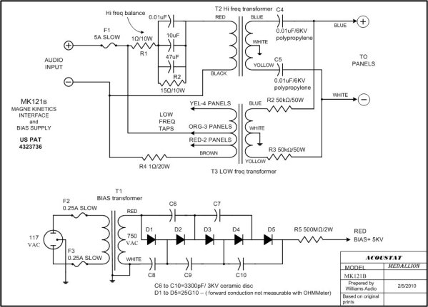

I don't remember any numbers associated with the HF equalization peak - that was 25+ years ago! But I seem to remember that changing the HF Balance Control would alter both the frequency and Q (sharpness of peak) of the equalization peak.
Thanks for info. Any idea where that peak is located? I was very pleased with the effect of increasing the HF balance, because it was just what I needed: boosting only the extreme highs. Since I did not recall what we had heard ~30 years ago when we "voiced" the system with fixed resistors, I had been reluctant to make changes because I was worried they would affect upper midrange too. Very pleased that I don't hear any effect there at all.
Of course it would be much easier to achieve desired balance if I had a variable resistor setup. Still considering whether I want to go that route, but I am not convinced it will sound as good. My recollection is that the fixed resistors were an improvement over the variable resistor with strap that came with my 1+1's. I actually found I still have those resistors--but not the straps--though I would switch to a pot if I went the variable route. I am still planning on replacing the 30 year old Wonder Caps with newer tech when I get a chance to study up on the huge range of available caps to figure out which can fit in the 1+1 interface (and which I want to pay for, multi-hundred dollar individual caps??).
Look at post number 2388, (page 239) and the few after that. A member posted a graph showing the flattest response to be around 3.3 ohms. I still have and use the variable control and set mine as close to that as I could. I was already pretty close, but dialed it in even closer.
Sounds great to me, (in my room and with my gear, of course).

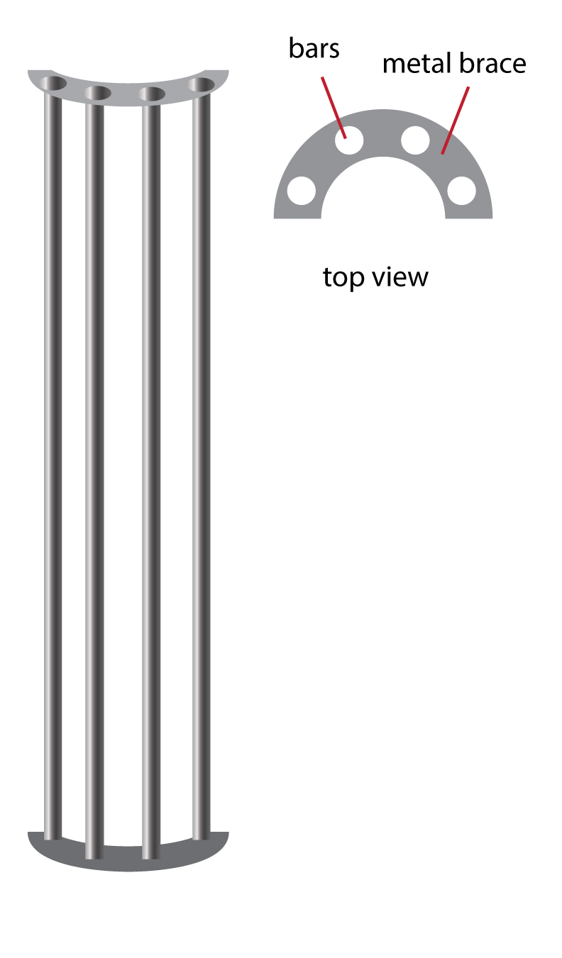

I have a cat who is a climber. My 6600 has frayed cloth from claw marks on the sides going up to the top. It hasn't affected the speakers and no one has commented or noticed them but it pisses me off to see them. I am thinking to making some kind of guards with metal rods on the ends maybe only 1/4 of the height of the speakers.
If they are used to climbing on them they may attempt to jump up past the barrier. I tried this and that's exactly what they did which resulted in a lot more damage immediately. I then did the "shciiitzzz!!!' thing and that's what stopped them.🙂
maybe if the guards were charged from the HV bias... 😱I have a cat who is a climber. My 6600 has frayed cloth from claw marks on the sides going up to the top. It hasn't affected the speakers and no one has commented or noticed them but it pisses me off to see them. I am thinking to making some kind of guards with metal rods on the ends maybe only 1/4 of the height of the speakers.
Kidding!
