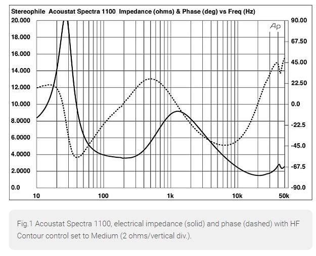

The following plot is not for your speaker, but it shows what a typical ESL load looks like. The combination of low impedance with large capacitive phase angle at higher frequencies is what some amplifiers have difficulty driving. From about 5 kHz and up, impedance is low. From 5 kHz to about 12 kHz, phase angle is also relatively high. While this impedance plot isn't as bad as some, if you cut the impedance in half by driving two interfaces in parallel, it winds up being a pretty tough load. The load in the bass region isn't super easy either, but at least the impedance is higher.
Acoustat Spectra 1100 loudspeaker Measurements | Stereophile.com
"Impedance-wise (fig.1), the Spectra 1100 offers no surprises. The sealed-box woofer is tuned to a low 27Hz. The HF contour switch was set to Medium for this graph; switching it to "High" drops the top-octave impedance to an amplifier-punishing 1.1 ohms at 20kHz. The upper bass impedance minimum is a still-demanding 3.6 ohms at 200Hz. Coupled with the low sensitivity, this implies that Spectra 1100 owners should avoid wimpy solid-state receivers, classy tube amplifiers, and the like."
mattstat: I'm not sure you could classify the Spectra 1100 as a typical electrostat because it's a hybrid with an 8" dynamic woofer. Does anyone have a plot for a pure 'stat Acoustat?

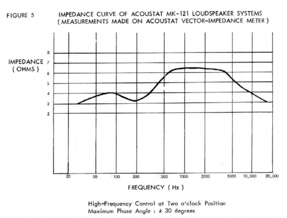

Acoustat impedance plot below is from the white paper "The Technology of Full-Range-Element Electrostatic Loudspeakers" by Strickland.

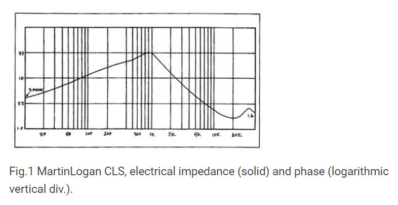

And here's a Martin Logan CLS plot. It's from an old review, so image quality is poor, and it's lacking phase data.
MartinLogan CLS loudspeaker 1987 Measurements | Stereophile.com
Looking at the amplifier load factor, the impedance curve (fig.1) is typically "electrostatic." Low at low frequencies, and with no visible signs of the 50Hz diaphragm resonance, it climbs steeply to a harmless 33 ohms by 1kHz. Above this level, the load is almost purely capacitive, falling with frequency at 6dB/octave, reaching 2.5 ohms at 10kHz, and finally bottoming out at a value of 1.6 ohms at 20kHz.
