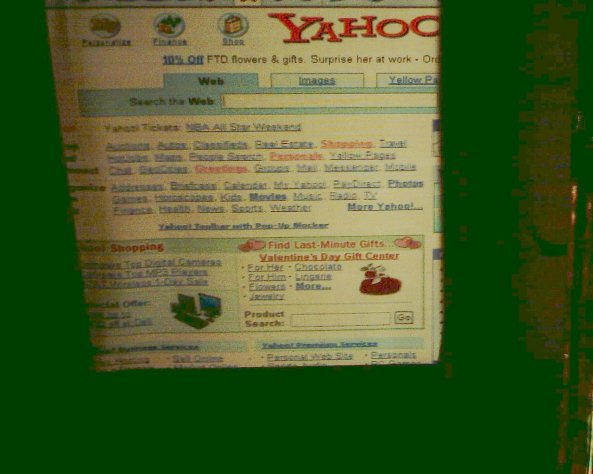

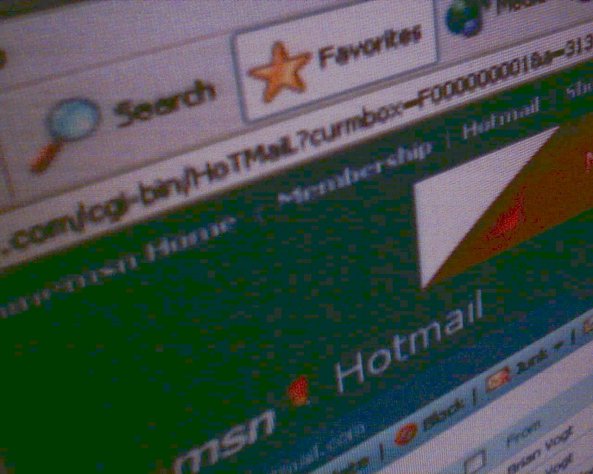

Ok here is another shot, the abnormalites are the cam fooling around with my paicents, and its dark from the cam, its not the whole image just some as this is taken out of a doorway because in this room there isnt any room lol, its darker on the left due to me causing a shadow while i was taking a pic, this is also not on a proper screen either but still fully watchable with a 100w light on 1m away from the screen.
Trev
p.s i hope u get the idea as these pics sux bigtime! lol and for some reason its yellow instead of white. also this pic was taken with no tripod so the blur is from my shacking hand.
Trev

but get urself a good cam and give us some proper pics; can't wait to see them *gg*

hehe yeah my cams bad as man, even for day pics outside its dark, ill get a new one as soon as i can aford it, ill try to get somthing with an ajustable shutter and a big lens ect, should be ok then for the night shots, the lens on this cam i have now is not much bigger then a bee's dick lol, so it cant let enough light in for night shots, that and the fact its got a fast shutter speed, i think 200 000 from memory thats not ajustable.

i will not judge the pictures neither urs nor the guy have taken. there's no comparably basis eg same exposure time, use of a tripod a.s.o.

Heya buddy, i realise of your english and i was saying it out as a joke lol, as for the screen shots yeah none are acurate there are too manny varibles with exsposure isues ect, pics are just a guide, mines a bad one i must admit lol.
