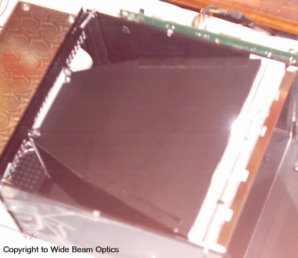

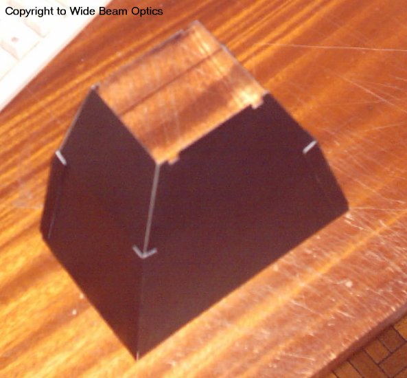

Ok guys a couple of shots of the pyramid, i had a few things come up so its not finnished, i just have to cut and shape the secondary condenser and make another 4 angles, but yeah not much work in it. As u can see in the first pic how shinny the mylar on the inside realy is, its like mirror.

here is a shot of the inside, as u can see the flash is eficiently reflected back at the cam, that is what we want, i put a roll of tape in the middle of the pyramid, but yeah too bright to see it lol, the way the payramid is designed with the step is so the light can only go one way, also it has more surfaces to reflect off, instead of just 4 we now have 8, with the roll of tape in the middle this adds upto about 12 - 16 reflections of that roll of tape, this is because of the angles of light reflecting off of all the surfaces in so manny different directions, i have tried it out without the secondary condenser and its brighter forsure.

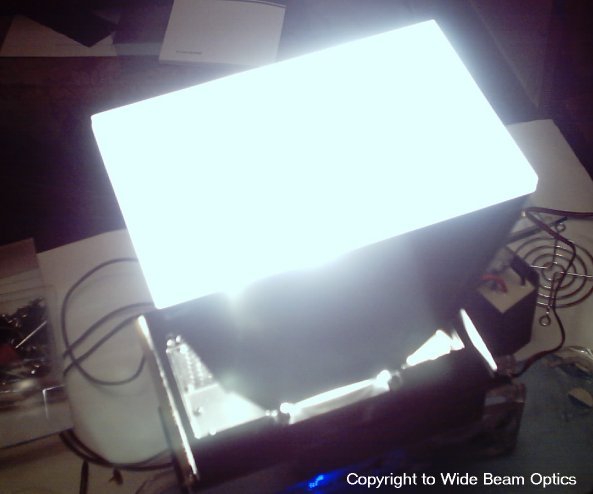

bulb just turned on, the surounding area look's pitch black, there is actually a 100w light on in the room when i took this with the cam, the cam's auto exsposure turned right down as the pyramid is reflecting so much light even when bulb has been on no more then 5sec's.

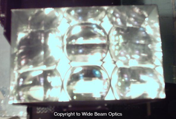

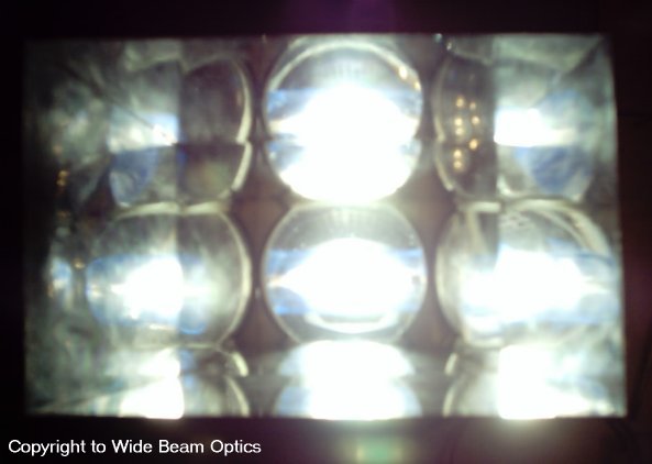

heh, this is what happends when u put a digi cam nearly in a frensels focal path while the light is on, bad for the cam i know lol as u can see the cmos wasnt very happy at all, im sure if the cam had of been inline with the focal the image would have been totally black and a dead cam, too much light for such a sensitive component not to mention your eyes, with that being said i didnt look through the veiw finder of the cam when i took this pic lol, unlike crusers buddy who tried to look at the sun with a frensel lol, sorry cruser just had to throw that in.

Ok here is a small warning if your going to be fooling with the lilliput or with the same hitachi lcd, the lcd in its holder is offset, the frensel must poject through the center, this means that light is in the center of reflector, light in the center of condenser, light in the center of frensel , light in the center of lcd and light in the center of projection lens, all centers must follow through, if one of these are out one side will be out of focus to the other, orrrrrr one side of the image will be brighter then the other, the side thats out on the lilliput is the flex cable side, its out by 2mm so a fix for this can be done in 2 ways, either u cut the frensel offset from center 2mm more one way then the other and offset all of the light gear to match the frensel ( a pain in the *** if u ask me lol ) or u can off set the lcd, im going to offset my lcd, its far easier and faster, anyway i just thought id bring this up for the guys who didnt realise.
