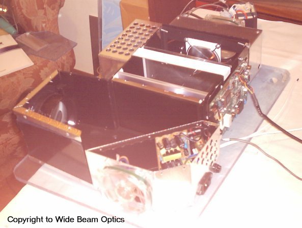

Just thought id post a pic of the projector in its pile , i took this pic last night for some reminders of what i am suposed to be building as time is dragging on lol, atleast it shows im doing somthing, the light engine u see here is a trade secret, there is a certain way on how its setup and how to get it to work right, also on what it does, in the pic it isnt in its correct position so im not fussed to post it, those who will buy the plans will see what it does and how to set it up right naturally, but im not going to say what secrets lay behind this design as im saving this for later on in another design, although its quite obvious in what its doing, im sure the smarter guys will be able to work this out lol.

That design is so cool now that i see it as whole unit.
If I had found your design when i first started this project i would have bought your plans first thing and not frigged around with the intense research need to do this right.
Any newbies out there, save your self a headache and buy Ace's plans when they are available. At this point in the game i wished i did! Too far in debt now to turn back on my design.
I got to give it to you, it's a good design.

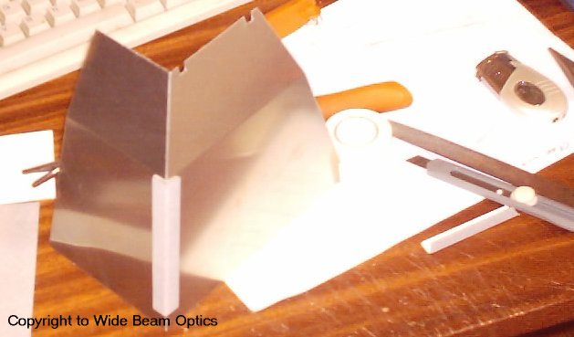

Guys thanks for the nice complements, tonight ive started work on the pyramid, this is a proto but i thought id take a quick pic to show u guys what your up for lol, this is just half but u get the idea, ill post up a finnished pic of it latter today after ive cut the lens and painted the pyramid.

Ace, your project is truly inpirational. I only hope the results justify the amount of effort work and love you have put into this creation. And if the results are indeed of a high caliber, it would certainly help you sell more plans, as if people know the results are worth it, they will definantly be more willing to spend the money. Keep up the great work man!
