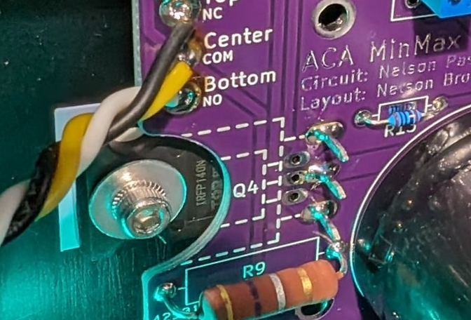

Q3 and Q4 need to have the leads bent (just like Amp Camp Amp) and are mounted to the heatsink with insulators at the same time as the boards. The metal side of the transistor goes against the insulator. They are then soldered to the PCB from the top side. Some example pics before and after solder:

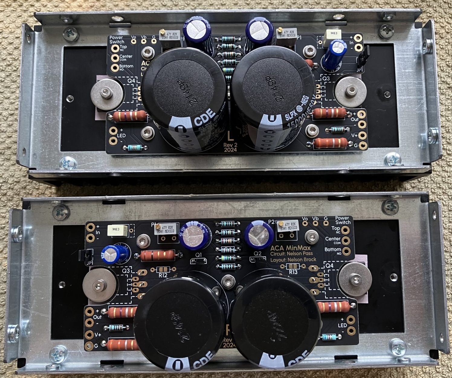

@6sX7: now that I’m focused on your photo of the soldered FETs, can you identify what that special washer/nut that you are using to attach the FET to the HS, the size, and the source for the washer/nut? It looks like it is a thumbscrew with no way to use a tool to tighten the washer/nut. Am I totally off base here?
Looks like a Belleville washer on top of the fender washer and a hex socket head cap bolt to me.
Each picture is of a different build.
The first picture is mine. Unsure who's build is the 2nd picture.
For securing the output fets I use:
M3x10mm SS screw: https://www.mcmaster.com/92855A310/
M3 SS split washer: https://www.mcmaster.com/92148A150/
and a big ol' SS fender washer for an even clamp: https://www.mcmaster.com/90313A101/
