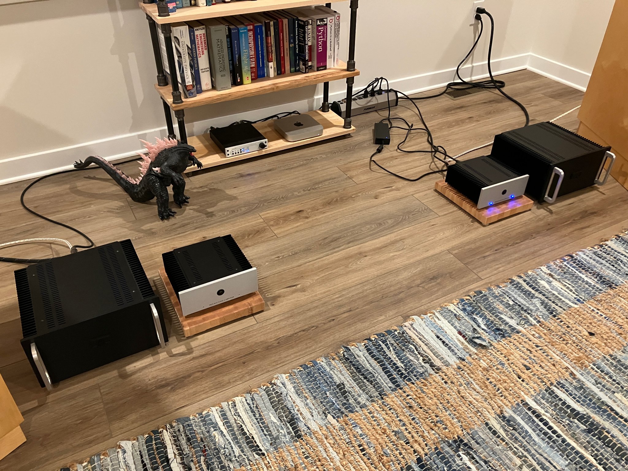

2nd unit is up and running. Had another "oh-no" moment. Forgot to turn down the pots on the right channel. SMPS went into protect mode when I turned it on. Realized immediately. Cranked down the pots and the LEDs stopped pulsing. Otherwise, biased up just fine. Now I need to get a 2nd PSU so I can actually listen to them in balanced mode.
Have the 2nd PSU now. One amp is louder than the other. Time to put them back on the bench and start troubleshooting.

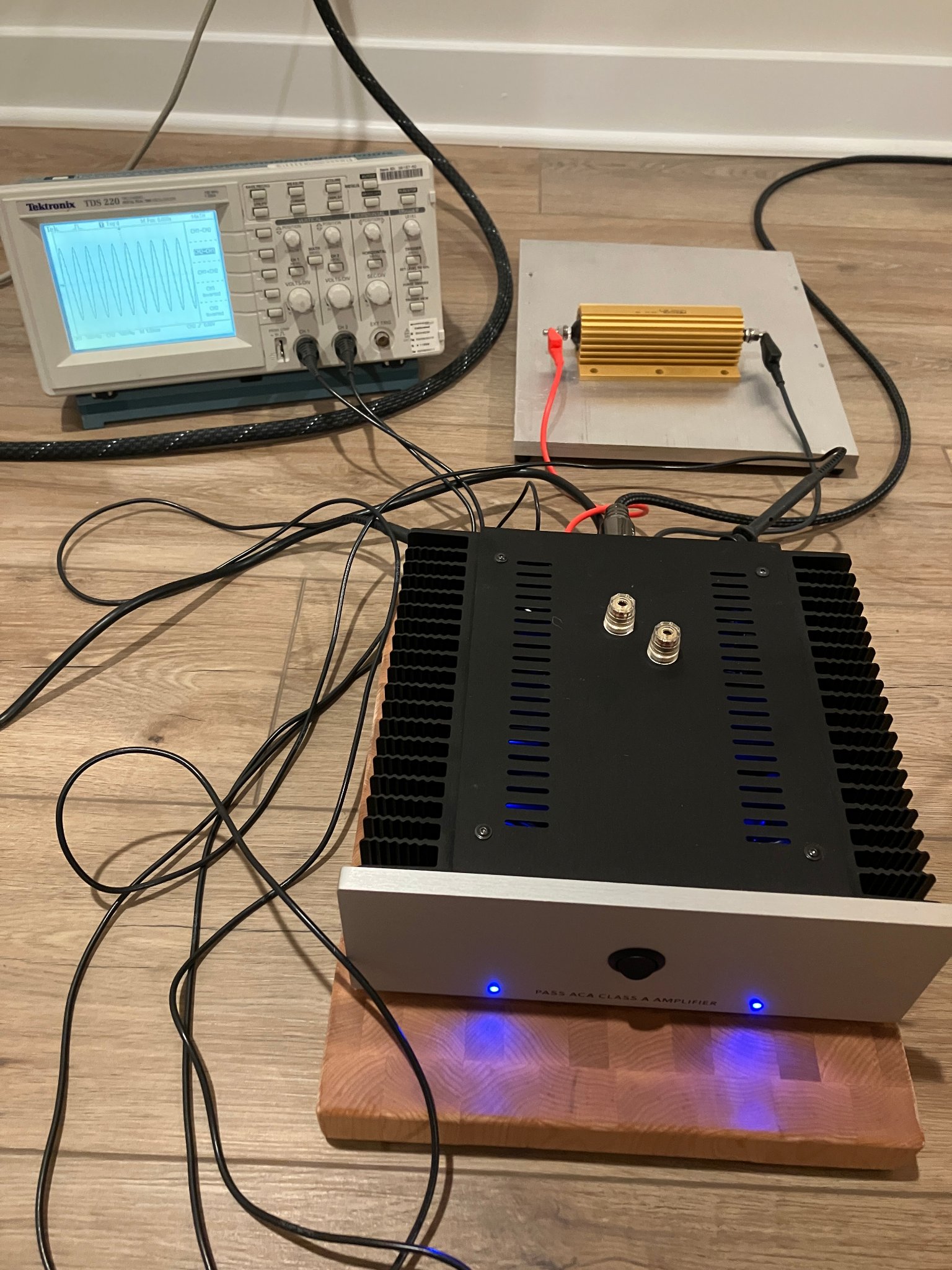

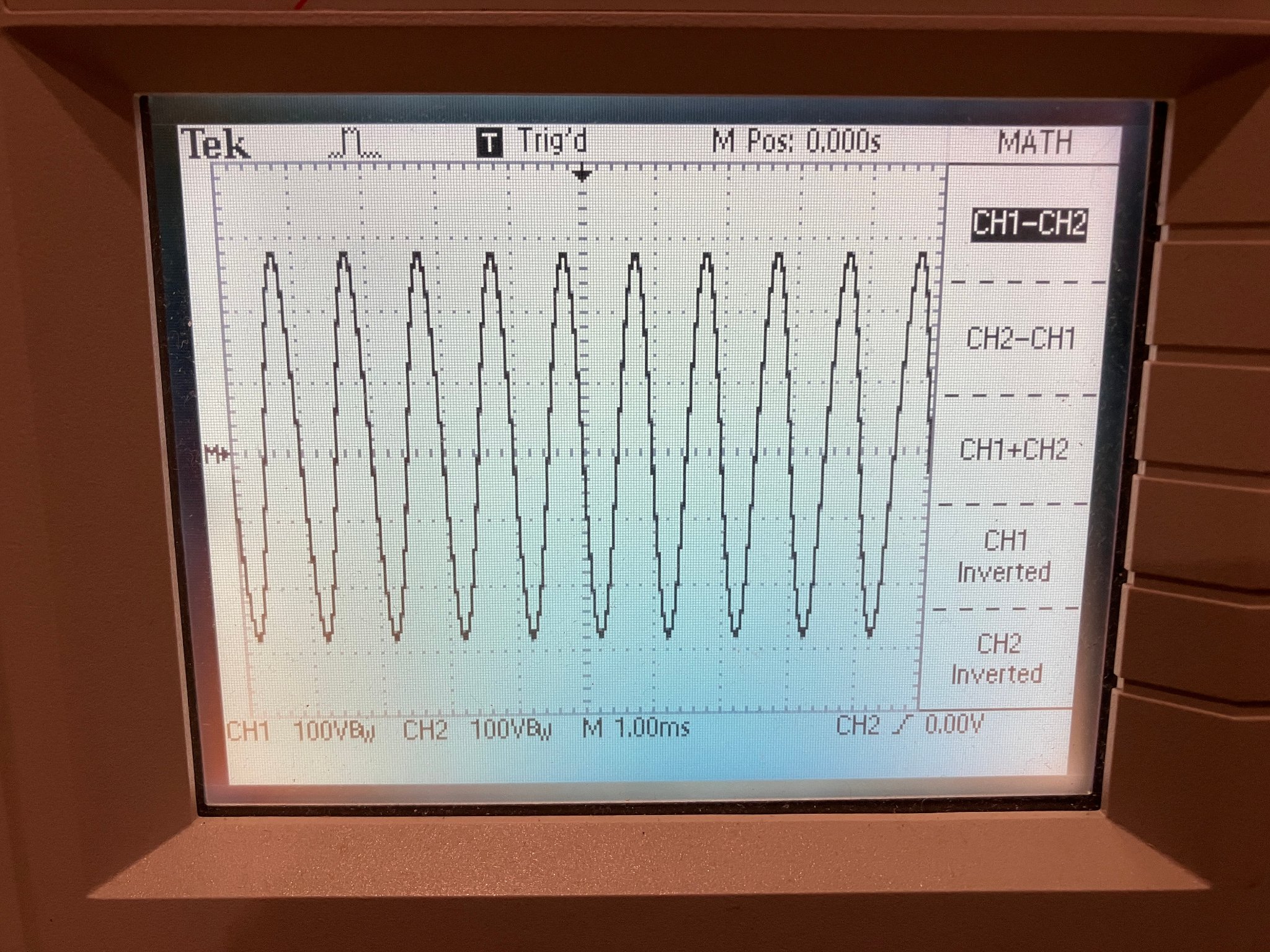

Speaking of skepticism and bravery, attempting to measure the max output of one of these MinMaxes running balanced. I believe I have it hooked up correctly (via an afternoon visit with @6L6 that resulted in a phone call to the one and only @Mark Johnson):
O-scope Channel 1 is on + output of Channel A.
Ground clip is on - output of Channel A.
O-scope Channel 2 is on + output of Channel B.
Subtracted Ch2 from Ch1 via the built-in math function.
Input is a 1kHz tone from the balanced output of my Benchmark DAC3
Output is hooked up to a 300W 8R dummy load
Pictures attached. Waveform on the O-scope is right before the sine wave started flattening ( was very excited to see it flatten out). Reading thru the manual to find out how to interpret the scale.
Fluke DMM read 19.45Vac.
The dummy load got warm, the amp heatsinks cooled down. Was way cool to see this all at work and jive with what the engineering/physics says it should do. Once I figure out the scale, can compute P=V^2/R.

ok, I think I found a measurement setup mistake. I believe I ignorantly set the probe attenuations to 100x. If I understand correctly, the demarcations are then 10V ea. So peak to peak is roughly +/-28V. RMS is 19.6 which is what the DMM told me. Rounding up to 20V rms P = 20^2/8 = 50W. I'll have to try measuring again tomorrow. In the meantime, seem reasonable?
brain churning. my Kill-a-watt is reading about a 45W draw at the outlet. So, the 50W output can't be. Silly perpetual motion machine. Retry measurements tomorrow with a fresh brain and time to read the o-scope manual.

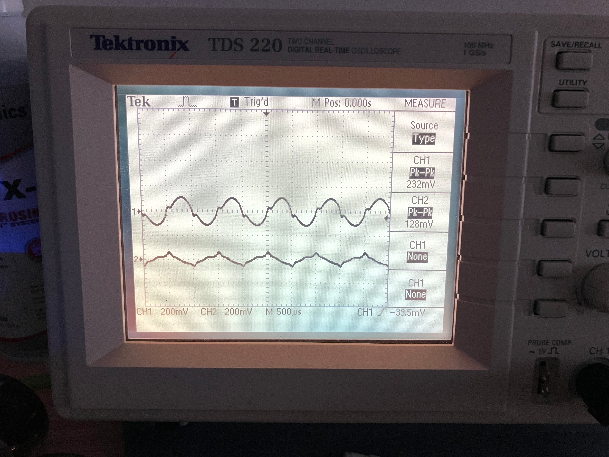

I'm a little savvier on this O-scope. I looked at the output of each channel given a 1kHz input.
Channel A of the suspect amp has something going on with it. Otherwise, all other channels measured 1.62V p-p output given a 300mV p-p 1kHz input.
Picture of Suspect Channel A output below. It biased up fine. Some more troubleshooting later this week. Input waveform changes when I hook up to the probe to the output channel. Maybe a short somewhere.

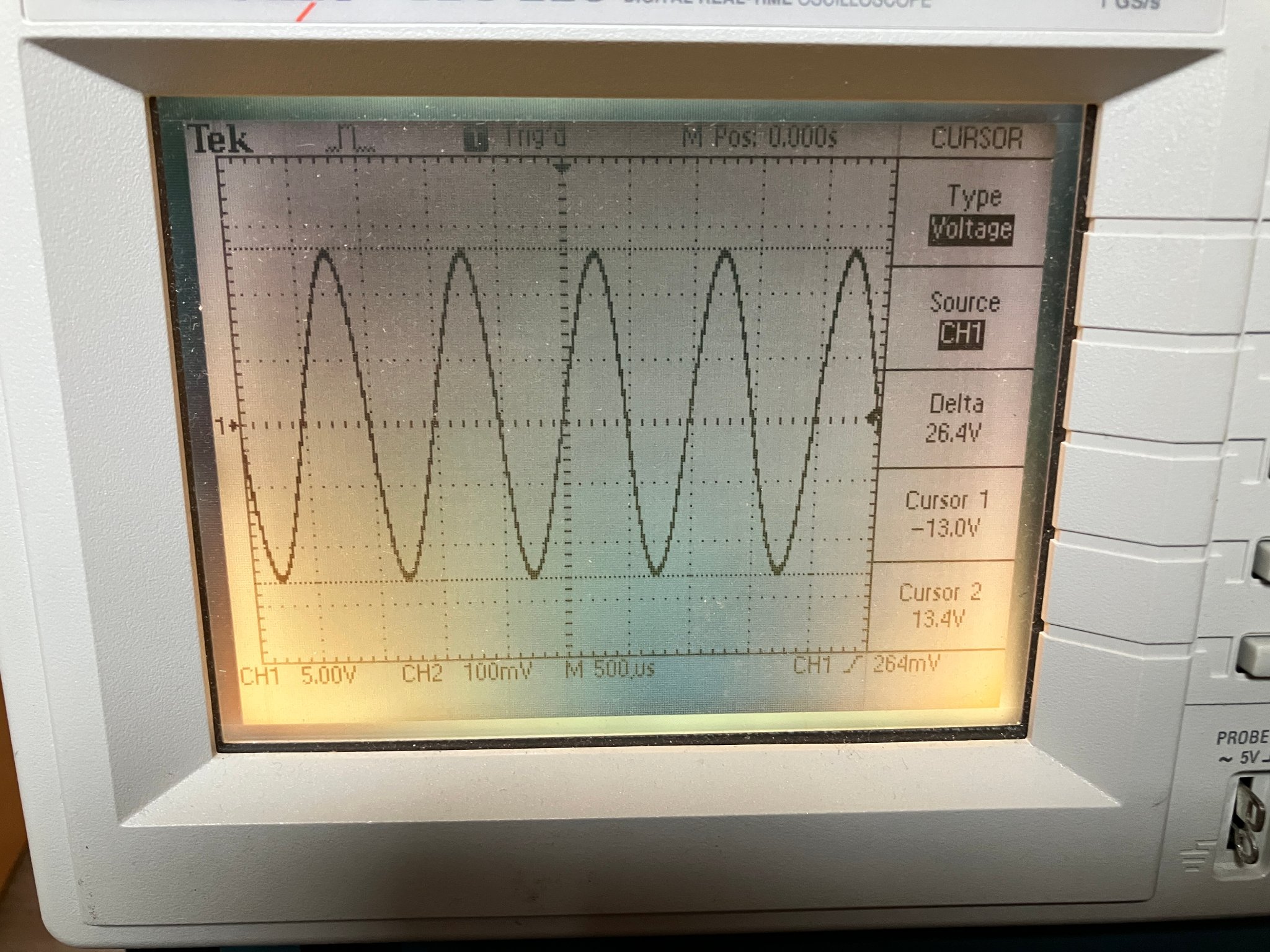

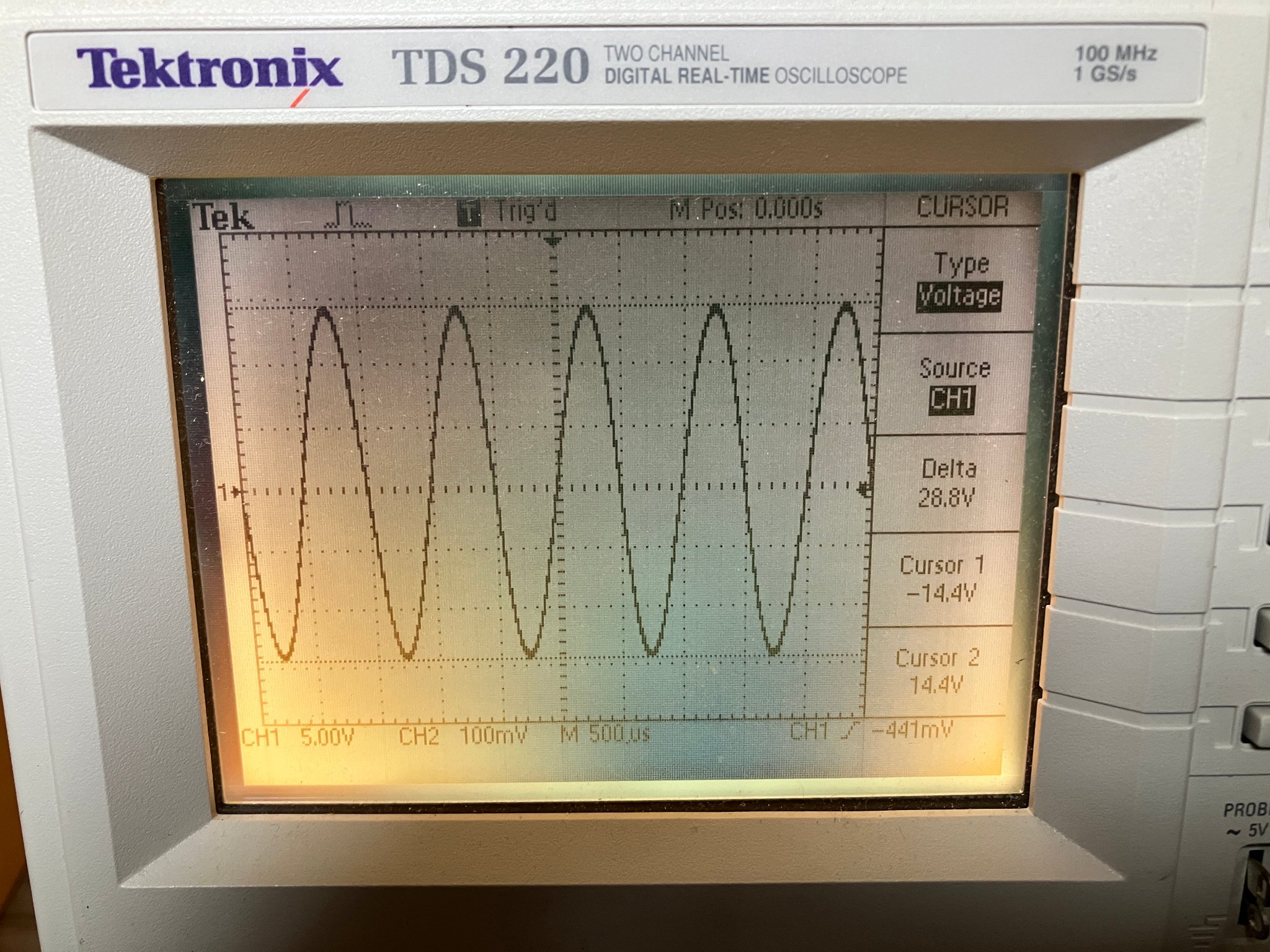

ok. learned a bit more on how to use the o-scope.
1st picture here is the left channel. There is some asymmetry between the L & R channels in the amp. Going to poke at that more later.
Vp-p = 26.4V
Vrms = 0.7071*Vp-p = 18.7Vrms
P = Vrms^2/R = 18.7^2/8 = 44W
2nd picture is the right channel. Internal L & R channels very symmetric.
28.8Vp-p.
Vrms = 20.4Vrms
Prms = 20.4V^2/8 = 52W.
I half-figured out the puzzlement with the Kill-A-Watt. "Watt" mode is "active" power. "VA" mode is the "apparent" power. "Apparent" power is Vrms * Arms. Not sure what "active" power is. Anyways, in "VA" mode, it's showing 90W which seems logical given class A operation, the measured output of the amps and the Kill-A-Watt is reading ~0.7A.
So, ya. Getting a good 50W out of these little amps in balanced mode. Heatsinks are sitting around 45C.
