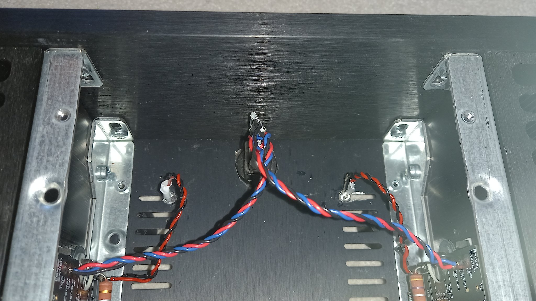

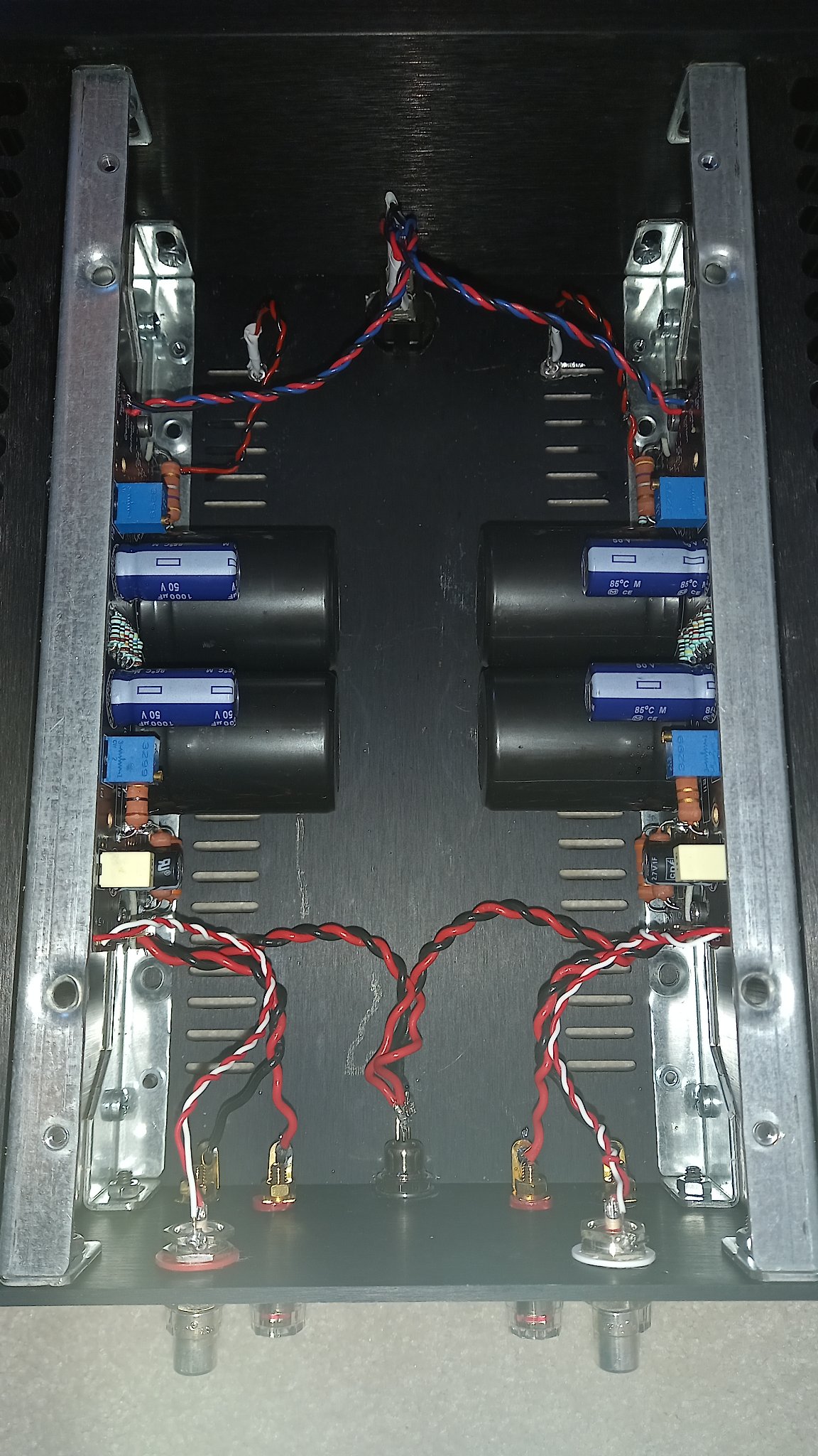

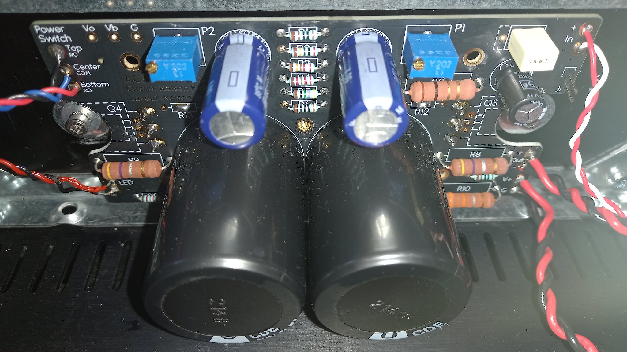

Attached are some pics inside the case
Try cleaning all the flux off of the DC input jack. Then see if you can wrap a small section of electrical insulating tape to separate the + and - terminals/leads.
Did you use a different front panel then what was provided in the kit? It looks like the power standby switch and LEDs are mounted on the floor of the chassis. Not that this would make any difference IMO or be the cause of your problem. But I would also reflux the standby switch as well.
Hi Halauhula, thanks for your persistence with this. This is the second DC input that I have tried, the original did have insulation separating the leads but I will try again. Its not a kit case just a plain one straight from Italy and to keep things simple I mounted the front switch and led's on the front bottom of the case. The wires to the switch have insulated female spade terminals instead of solder (not really clear in the photo), maybe I should solder these?

If that does not resolve your issue, then look with magnifier at the end of each wire soldered to each PCB. Identify if there are any stray wire strands that are sticking out of the cut end and not soldered. cut them off and vacuum ends out of chassis. Looking at your photos, it <may> appear the wires to the power standby with on each board may have a strand that is not soldered to the pad. Check carefully to see that this is not so. This is on the top side of the PCB so it (and the MOSFETs) need not be removed from the heat sink. Again test.
If this still does not work, then you will have to remove the PCB and MOSFET from the heat sink (keep wires connected if possible), and touch up each solder pad on the board. Verify that there are no solder bridges across pads. Who you have finished soldering, clean the board (both sides) with 99% isopropyl alcohol/flux remover and a toothbrush or other safe brush (not made of metal). Reinstall and test.
