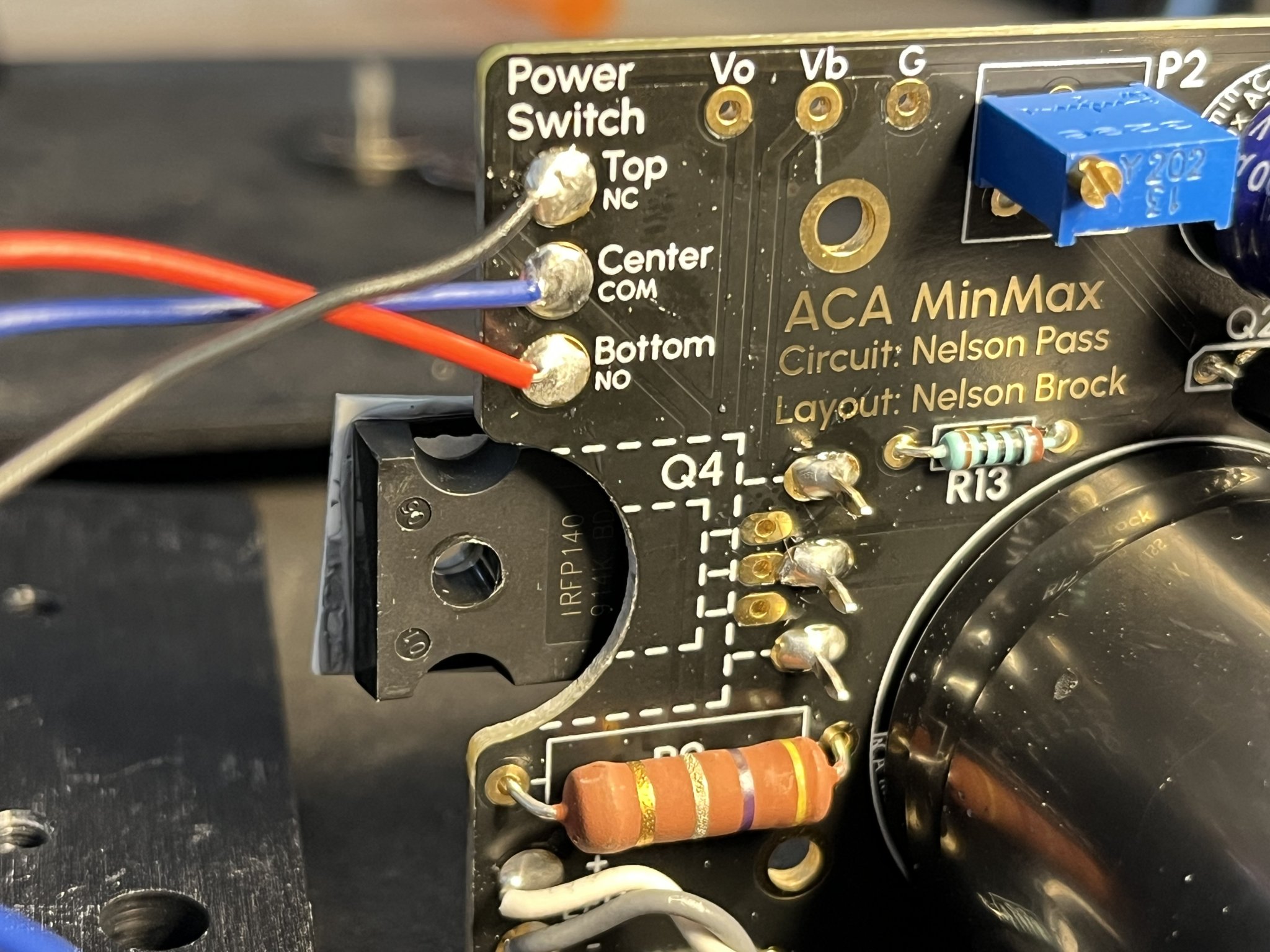

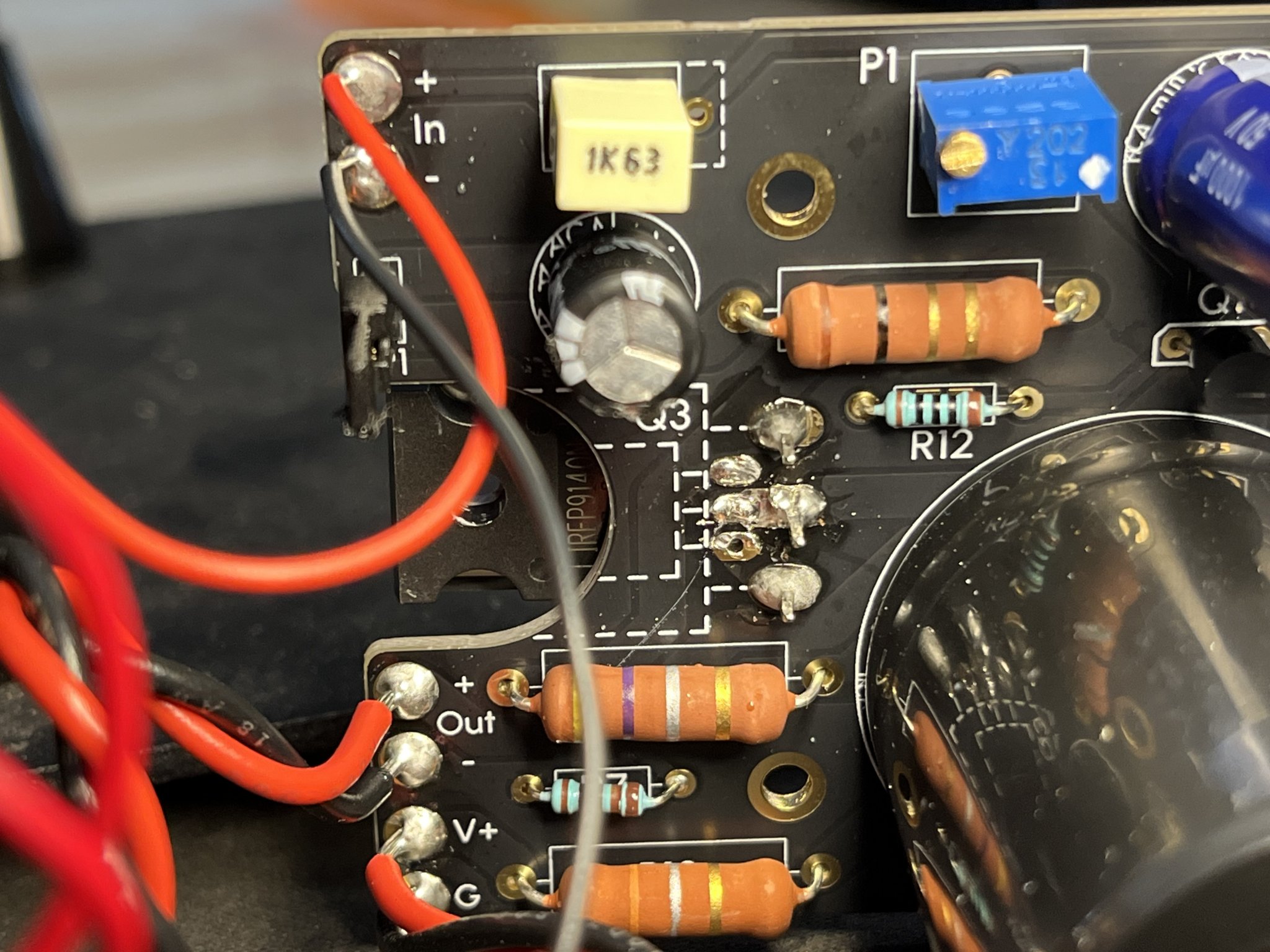

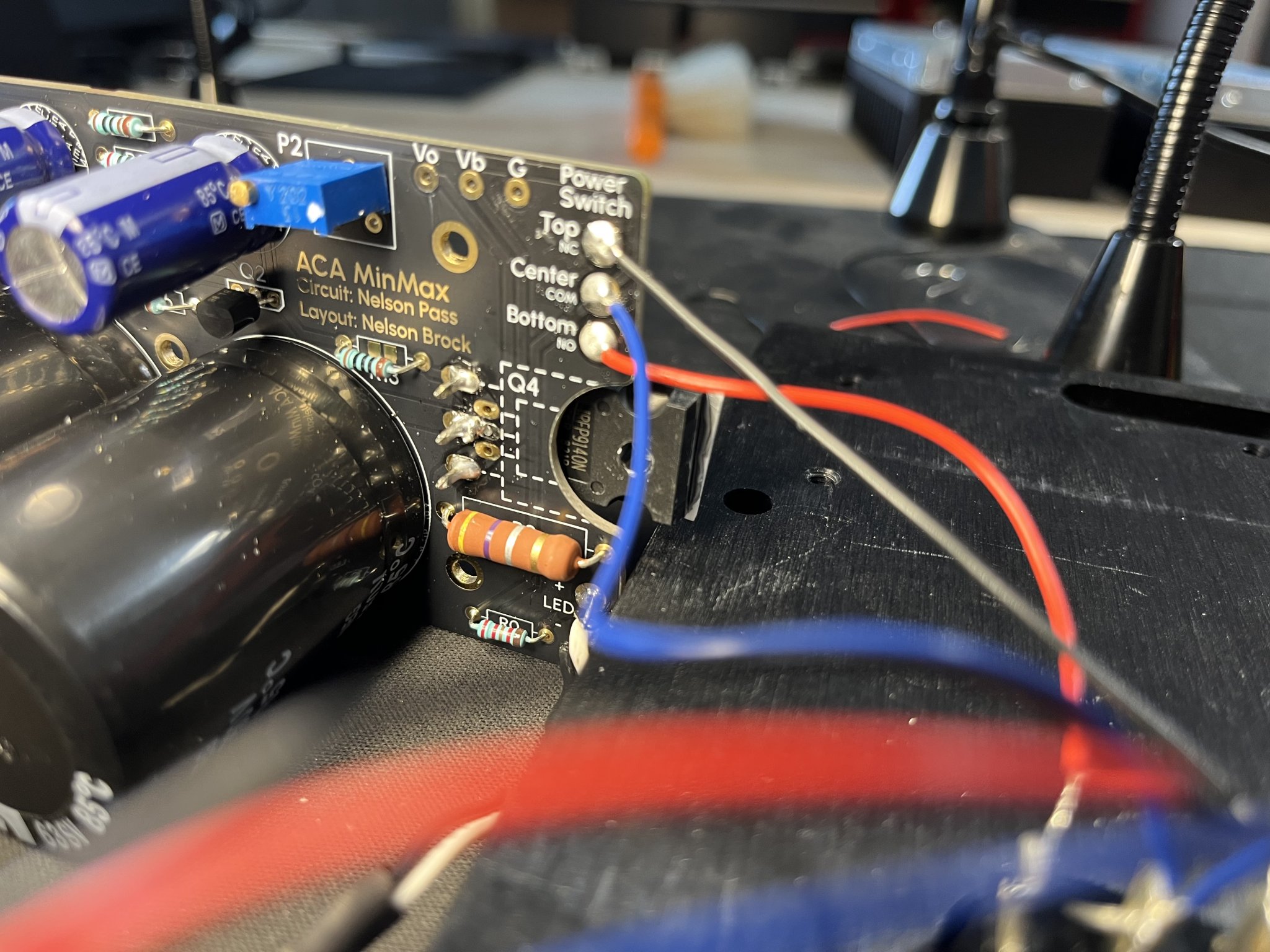

Ok..I checked my pot install and got them at 0. So I started looking around for something I did wrong. I opened up the schematic and saw that q3 and q4 were different. Q3 being irfp9140 and q4 being irfp140. During stuffing the board, I overlooked this. I know my fault. So I have one one board both 9140 and on the other board 140. So question is, did I break it, or this this fixable by just removing and replacing them in the right spot?

Swap into correct positions. Be careful when sedoldering. There's an art to it and you should have a good solder sucker. Be very patient and give plenty of time for things to cool off in-between attempts to remove the solder. You don't want to damage anything trying to just remove the FETs.

I'd suggest cutting leads of FETs shorter so it's easier to get them out.

I think there's a good chance that the FETs are okay thanks to the PSU protection mode. One simple test you can do, even with the transistors still on board, is to check that you do not have a short circuit between the gate and the other two leads (see below). Swapping them to the right spots and continuing with power on procedure is also my vote.

The mosfets can be tested with a multimeter once the incorrectly placed mosfets are removed from the pcb:

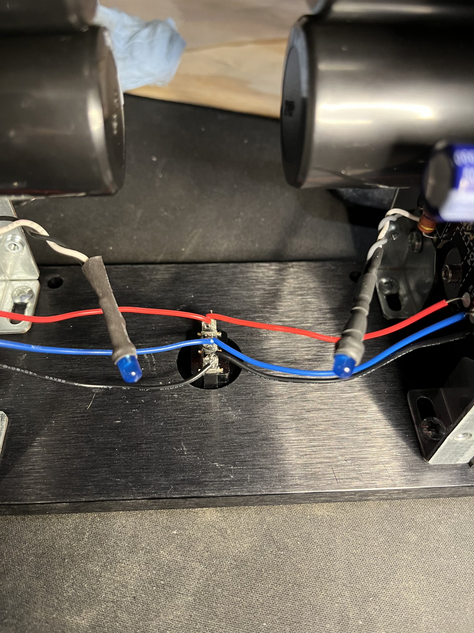

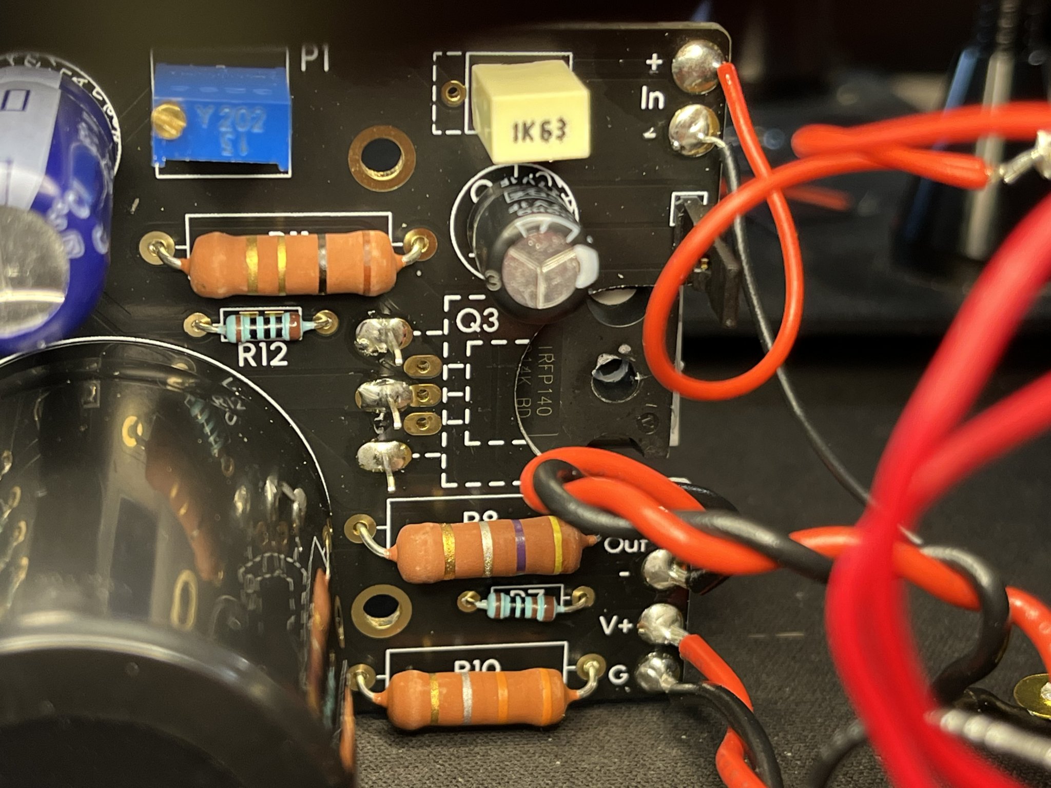

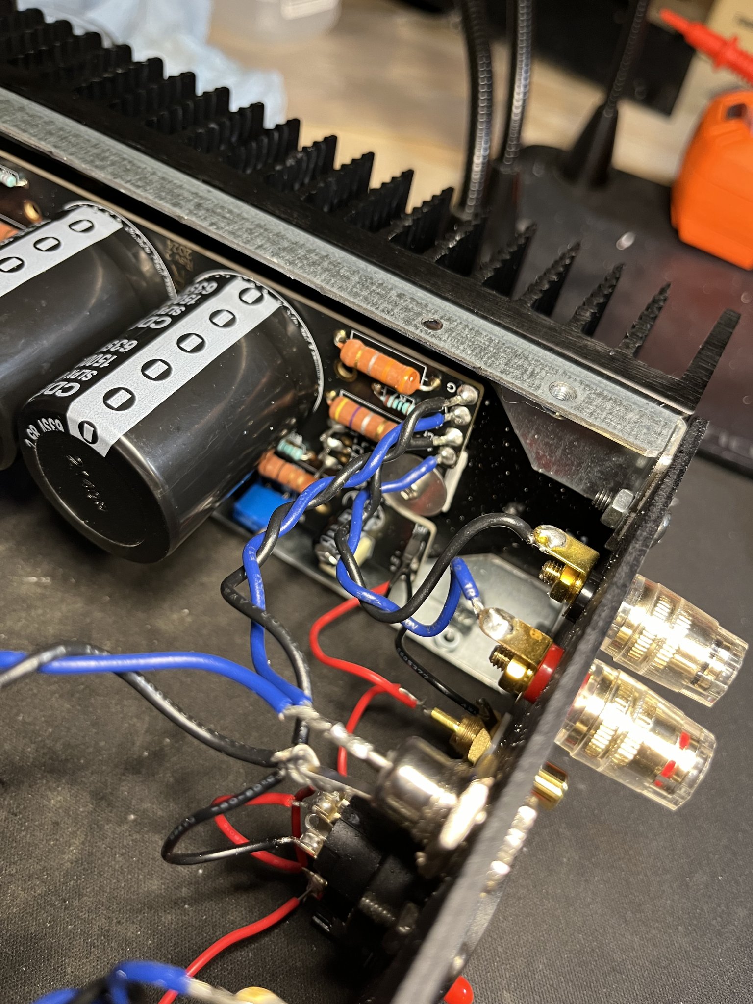

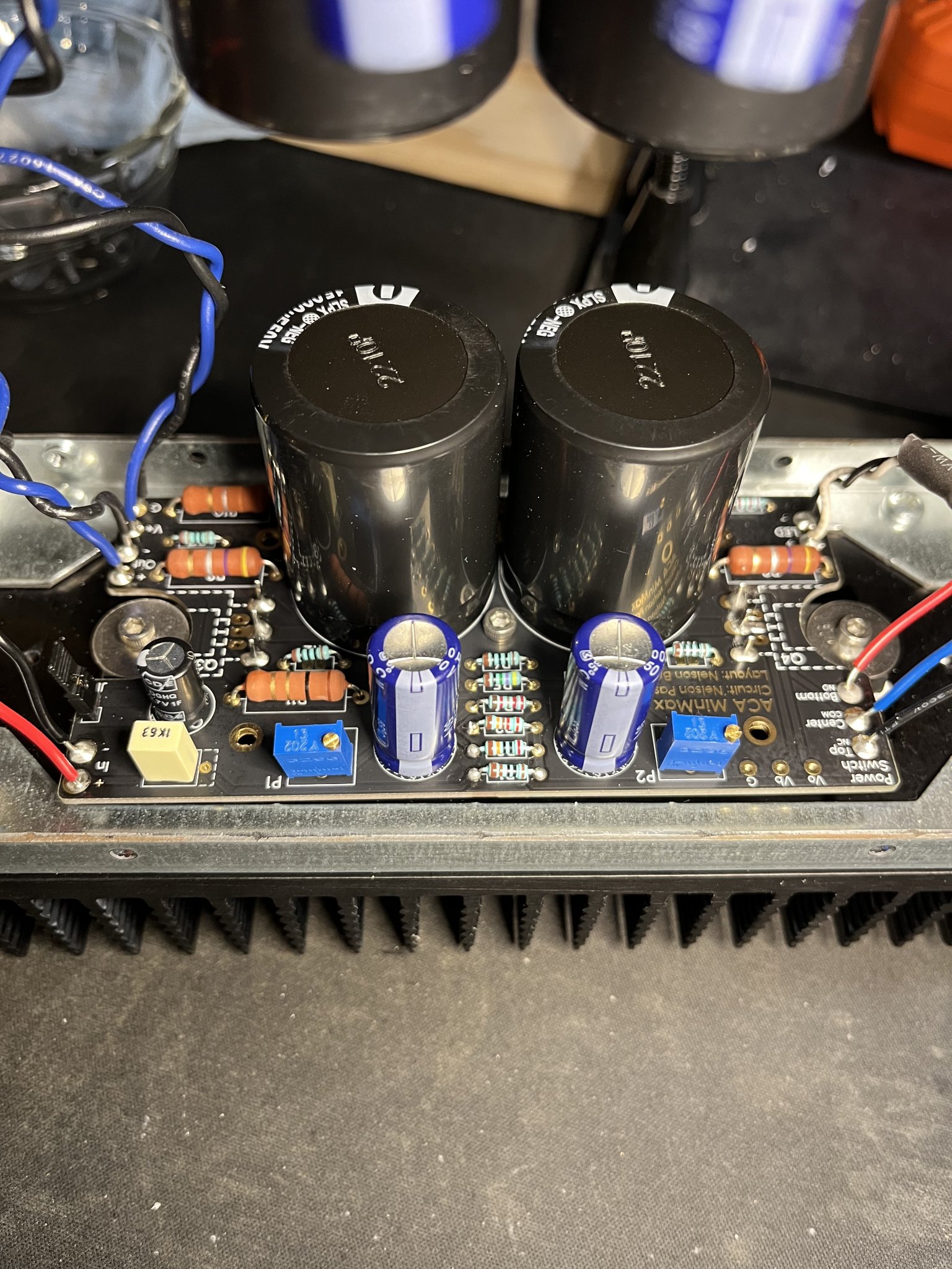

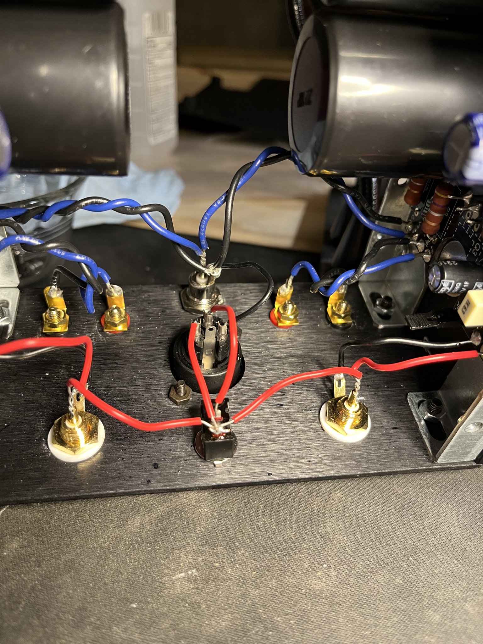

Hello good people.

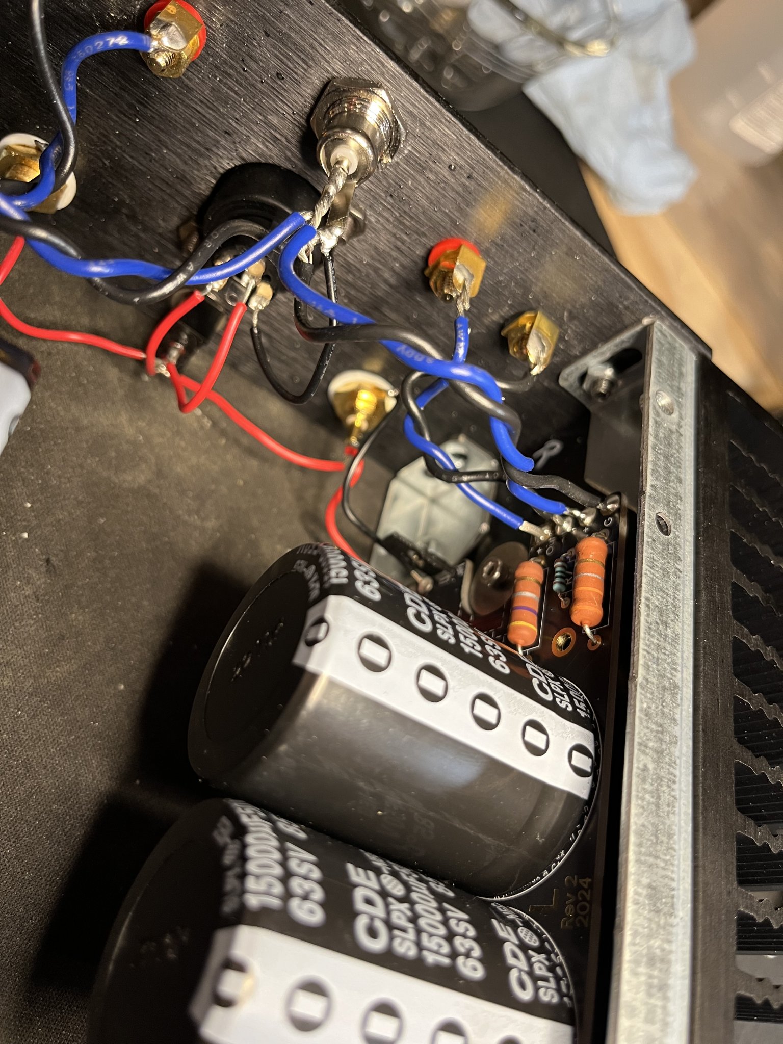

How have run into a problem building my second amp while waiting for parts on my first. I paid close attention to how I put it together. I think it’s all good. Unless I missed something. My adhd and all. Here is the issue. I have not tried to adjust anything. All I did was plug it in, and flip the switch. The leds lit up. Everything looked ok. In about 10 seconds, the power supply when into protection and the leds started blinking. I turned it off and unplugged it. Looked and looked and didn’t see anything wrong. So I tried a different power supply. Same thing. Any help would be very much appreciated. In my next post, I’ll post all the pictures I can.

Note the pics in my post. My potentiometers are installed backwards in the picture. Cross check to see if you made the same mistake as me.

Also note that the "fix" for my issue didn't require desoldering. I just had to rotate the pot the opposite direction than the instructions as 6L6 is pointing out.

My pots only went in one way. I’m not sure how I could have installed them wrong.
Being turned up all the way could might be the case. Is there a way to measure them as they sit?
Ok, you had the kit, so your installation is hard to mess up. I procured the parts myself and had the "in line 3" leads for my pots, so it was much easier to get them installed wrong. Your pictures look like you correctly install the pots at closer look.
Since you're first attempt got the MOSFETs mixed up, I think we can be sure that's not the case on your second attempt. I'm no expert, so I'll let the Nelson Brocks, Ben Mah's, and 6L6's on this site give you advice. I can only bring up the errors I made as a possible culprits.
