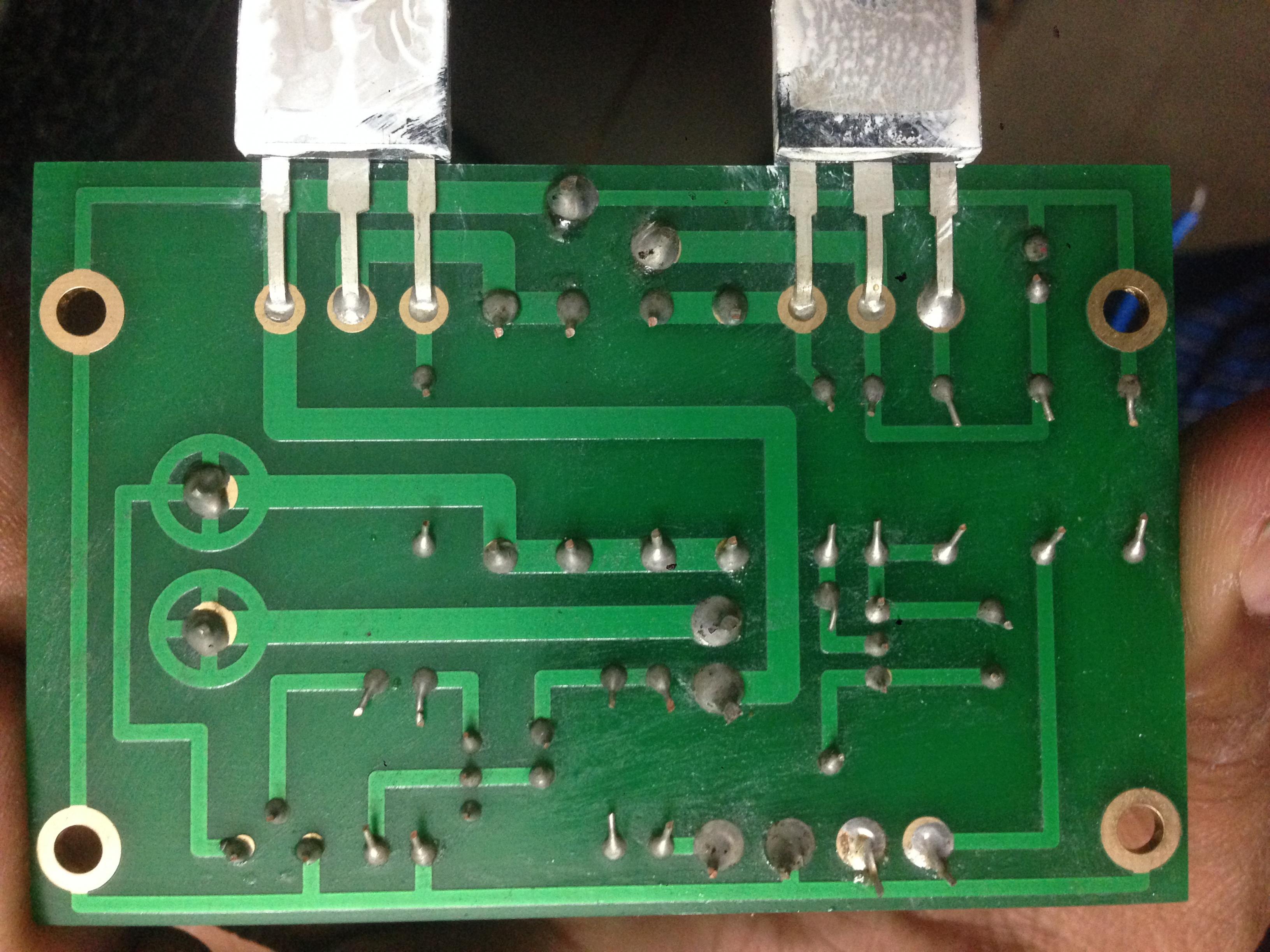

Thank you for your help, here are the pictures. What measurements you are looking for, if you could brief me on it that would be great. I use 19v 3.42 Amp adapter. The bias is set at 10v DC
triple check value of resistors and their positioning
also - be sure that signal is actually reaching pcb and that here is no some sort of short underneath
make some measurements ( few of them to check are already on schematic) and post here

Picture from behind the pcb.
It's not lead free, after solder I just cleaned the pcb with thinner it gives the neat finish :)
The output transistor is soldered in front and plated through hole. I will do it in back of pcb as well. The resistor values are correct and their placements. Would it be if any components are faulty?
I have two ACA builds, one makes a small thump at power off, the other doesn't. I've attributed this to the specific laptop power brick that each uses since they are different. Everything else is the same.
As for why kapalin's build doesn't work, check a few things. Make sure you have no cold solder joints. Make sure you didn't mix up Q3 and Q4 locations. Double check each pin on both mosfets with your DMM to make sure there is not something grounding them to the heatsink. Each should measure as an open loop. Also, check your screws/nuts where the PCB is mounted to the sink to make sure nothing is grounding or allowing a resistor tail to hit the sink.
The beauty of this circuit is its simplicity. It makes trouble shooting easy compared to the more complex designs because there are fewer things to check.
