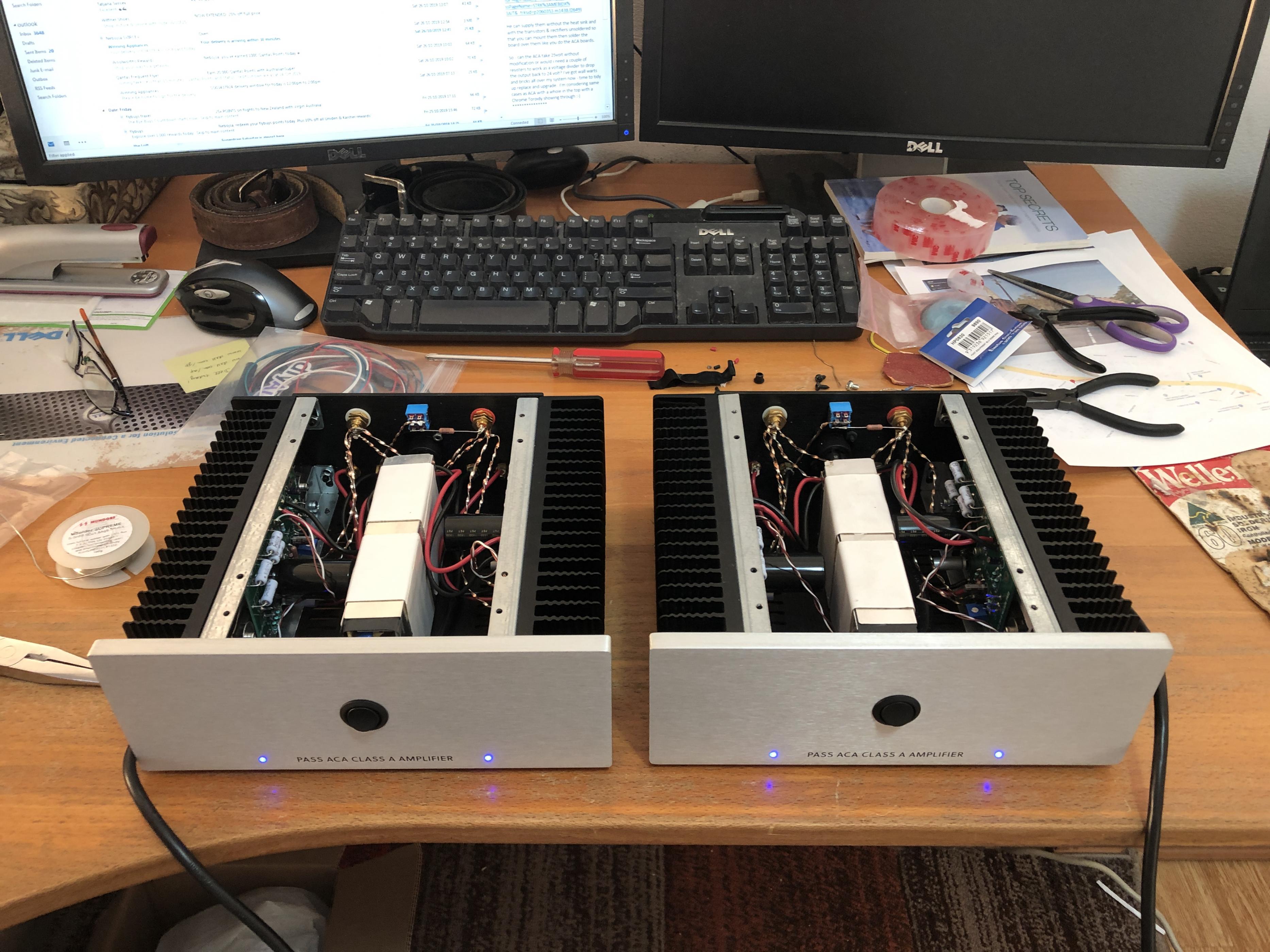

Short signal paths, short power supply wiring, local decoupling cap 0.1uF, SMPS inside the ACA's... these little beauties should be illegal 😉 .. they are THAT good!

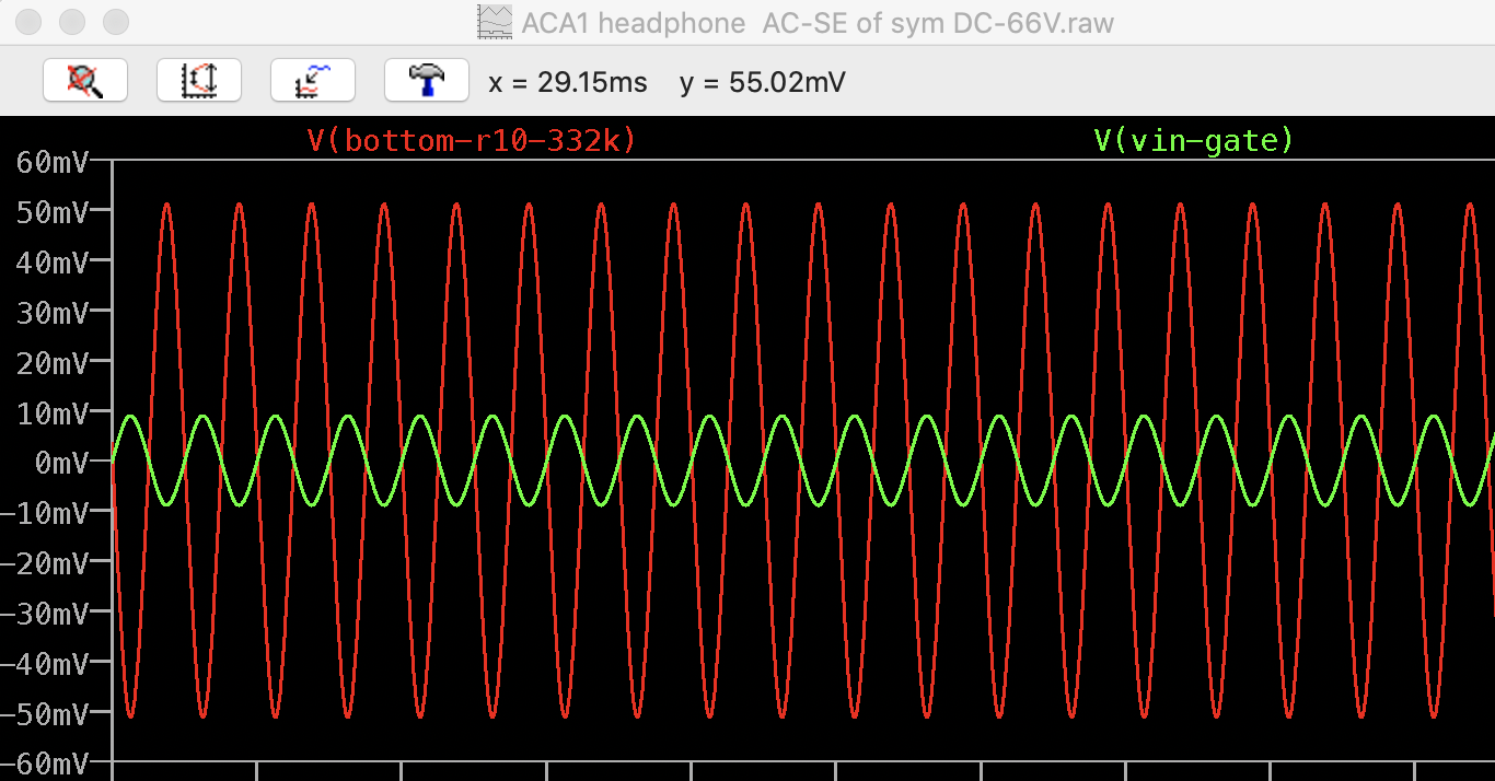

I am modelling the ACA and there I have a question on P1 and feedback.
As far as I can see, there is
  • overall R26/R25 (normal feedback)
  • feedback on both P1/R10 (DC feedback to set the DC of the output)
However, P1 also gives a variable amount of AC feedback.
Does that have influence? E.g. on the harmonics?
I am modelling because I plan to implement the ACA#1 as a headphone kit running at 100mA or so, great for 32 ohms phones. So just playing around, not there to measure anything yet.
any help welcome.
Sorry about the numbering, LTspice gives them and I have two copies of the circuit to check changes!
Anyway, here is the circuit picture; the feedback at the bottom of R10 at P1 has a very high AC signal!
Now if it is in phase then the apparent reistance of R10 is multiplied; as I see it, it can give rise to positive feedback. . . . 😱
