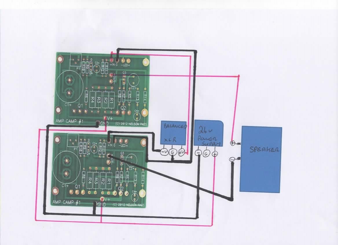

aca mono block help
hi ive had a look at the build of the bridged aca mono block and as a newbe ime a bit confused how to wire up, i dont have a kit like shown as i make my own enclosures, at the mo just heatsinks and pcbs ect as i want to have a quick listen bfore i commit to building it,, can you look at the two attachments and see if either of those wire ups would work please thanks alot

In this case, I would highly recommend building a pair of ACAmps as mono blocks. Try both bridged and parallel. There has been some discussion of this in the ACA amp with premium parts thread. For lower impedance speakers, the parallel mono blocks are probably preferred, but as always let your ears decide.
